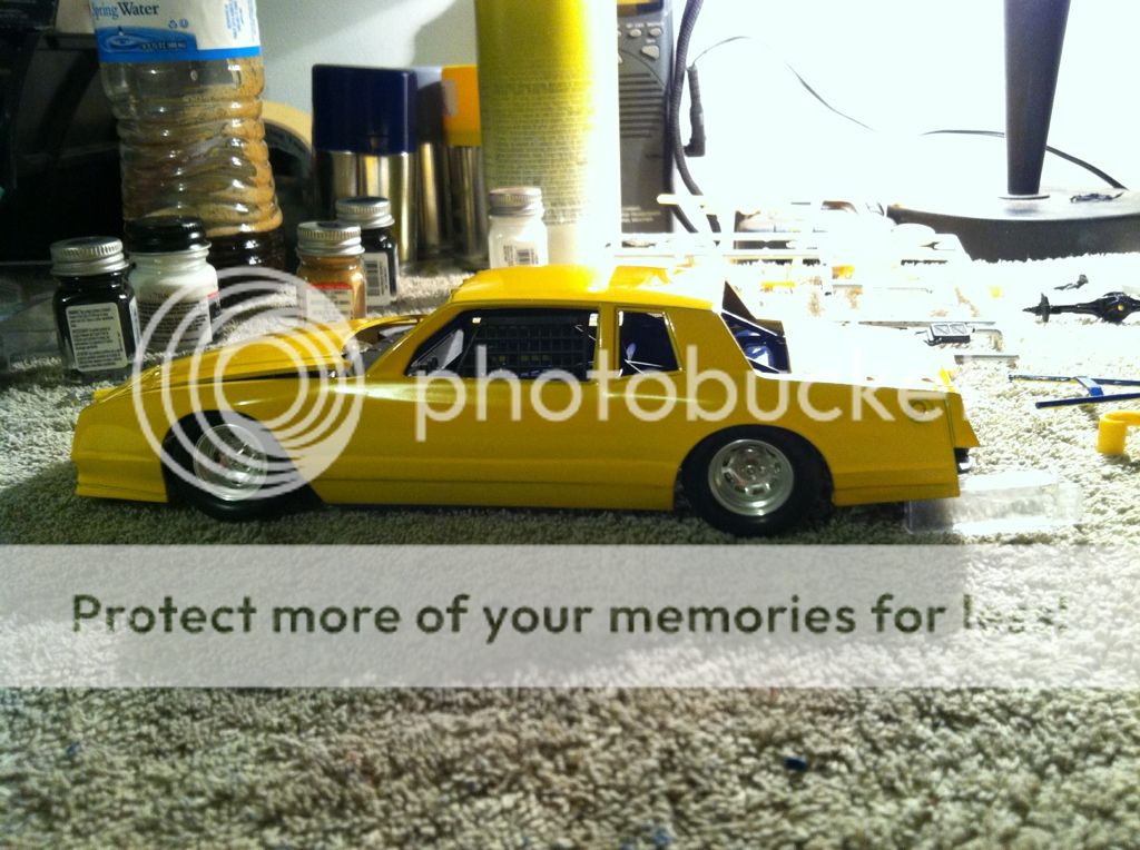

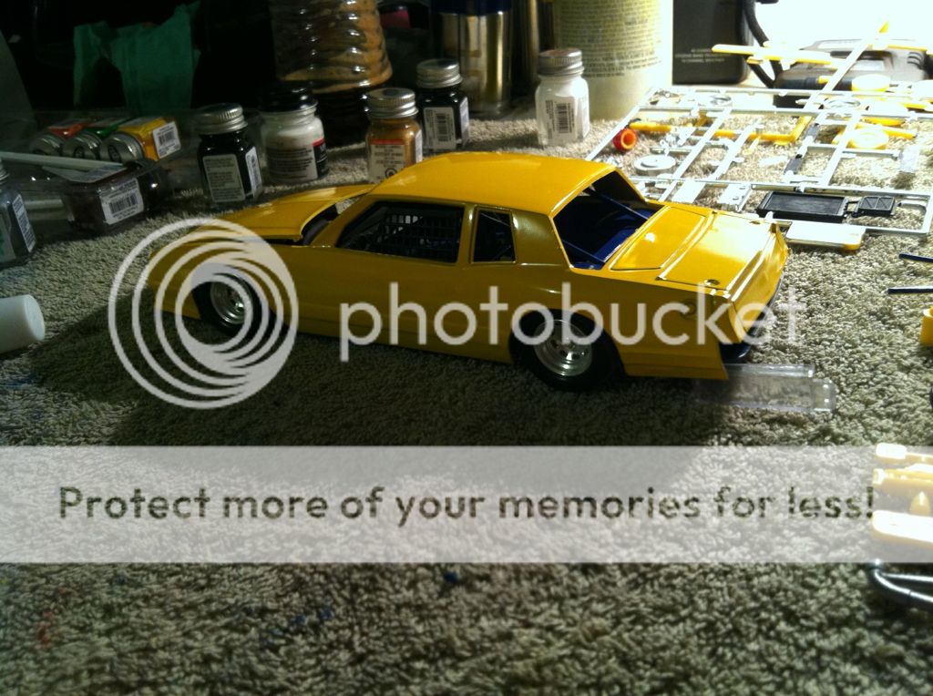

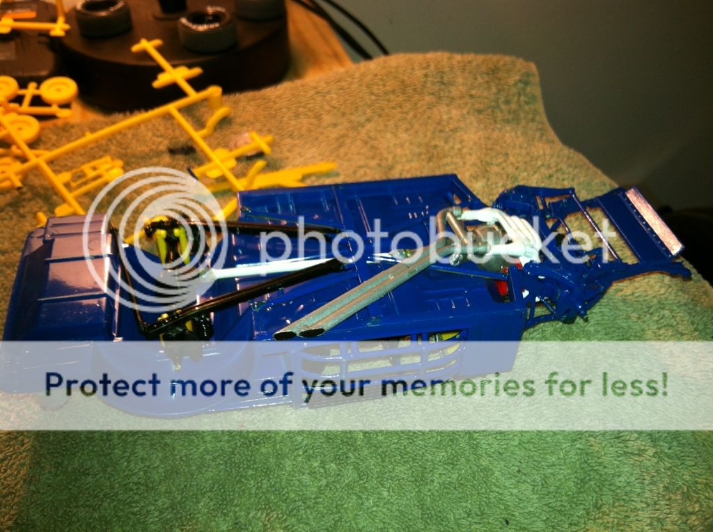

Sorry I haven't given any updates lately, had a really busy week at work. Anyway I managed to get a couple coats of yellow on the body. Still have a little way to go on the chassis but I did a little mock up. The wheels will be black eventually.

Oh I forgot to mention, I'm using testors enamel in the spray can. I put it in a cup of warm water before using and shook it really well. It seems like maybe it was too thin. It wouldn't cover sharp edges, the primer is showing through. I am planning on adding a coat or two tomorrow or Tuesday. I'm not sure how long I should wait.

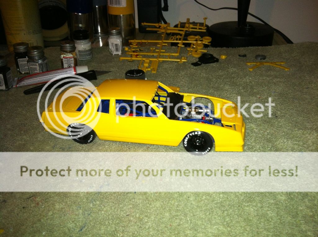

Posted 28 January 2013 - 05:59 PM

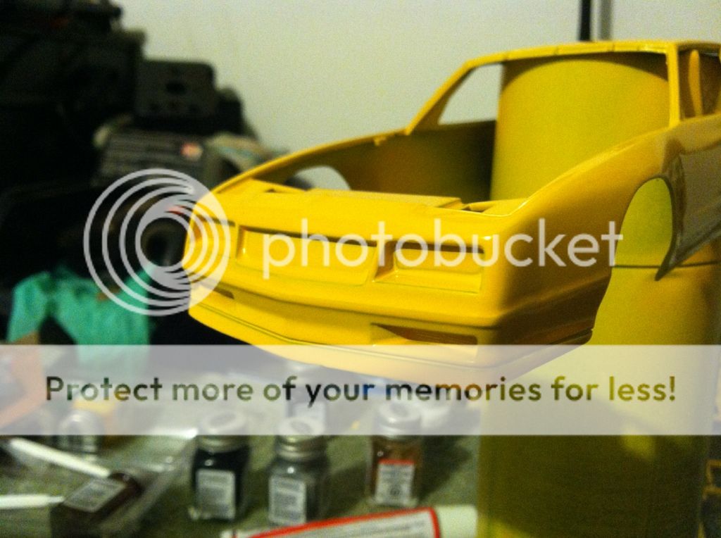

This paint is getting on my nerves. This is after a 3rd pretty heavy coat. After doing some reading I've found that testors spray enamel is not the best choice. I can't get this paint to cover the sharp edges and details. Hopefully you can see what I mean around the headlights and the body lines.
0674B4E3-C877-41FE-82B9-5570667009AD-896
Anyway, not much else to report except I got the rear suspension in:
7B7D0F98-C896-4F80-BACD-004409D17C31-896

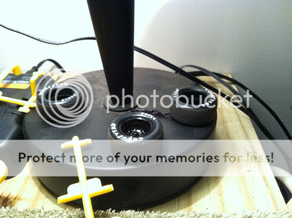

And got the wheels and tires finished, well just one complete in this pic:
7ACD78EB-4A28-4CD7-B28D-8D30592B0BD1-896
I should be done with everything except for the body maybe by tomorrow. I only get an hour or two a night so maybe a couple more days. I have to figure out what to do about this yellow paint. I may just put another coat on and call it good. Then I have to mask it all off and spray the blue. I probably have a solid week and a half before I can call it officially done.

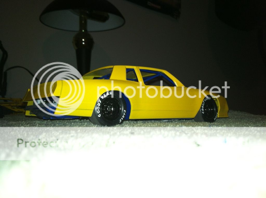

Posted 30 January 2013 - 03:27 PM
46F687EE-BC26-4561-A6D1-5F31120B950A-102
967C1748-26FE-42A9-A025-5D6EC26DF043-102
I'm really happy with the wheels and tires. Also I tested the "brand" decal and it slid off perfectly. That's a big sigh of relief for me.
Now for the two-tone. How long do I need to wait before I spray the blue? Both colors are testors enamel.

There isn't much you can do at this point with the yellow. Your only option of fixing it would be to strip it and start over. That's wonderful news I know.... in the future build the paint up in several thin coats and let it sit for 20min between each coat. I say four thin coats at least, then after you have let the last thin coat set for 20-25 minutes you can hit it with a good wet coat. You did right by heating the cans, I heat mine up between every coat. Also too, next time you use yellow try a white primer. You will be able to cover it better then gray. I use white primer for all bright colors and gray for dark ones. You have a nice smooth paint job, it looks good, shame about the corners. I would say that happened cause your coats were to heavy and time between coats were too close together. As far as time until you apply the blue..... I say a week or so. Enamels dry really slow, I use a dehydrator to help with curing times and still wait four days before I apply a different color. My fear is that when I pull the tape off the paint will come with it. Then I'm stuck stripping it and starting over if that happens. So I figure its better to give your base coat as much time as possible to cure before playing with it. I've always been told the rule of thumb with enamels is that if you can still smell the paint its not cured. I've also been told that it could take up to three weeks. I'm not trying to discourage you or say you have to wait that long, this is just information I have read and am passing it along. Like I said, using a dehydrator I've moved on to my second color in four days. Hope this helps.

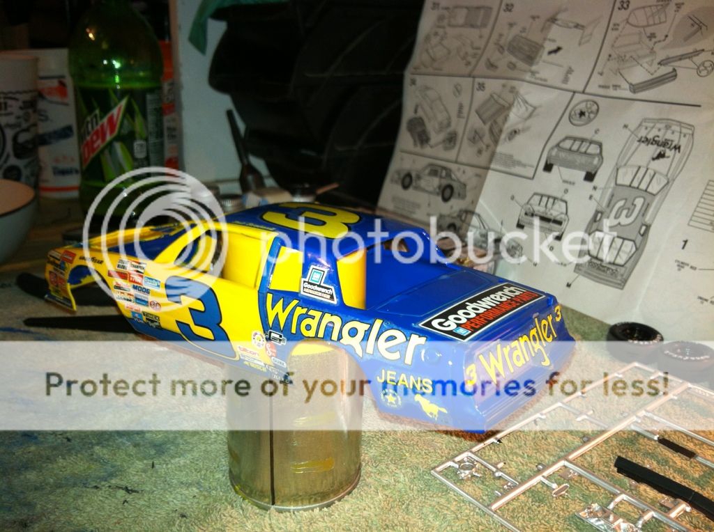

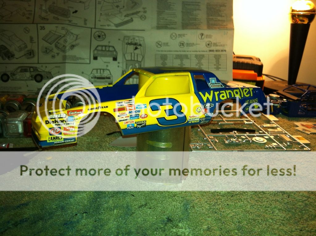

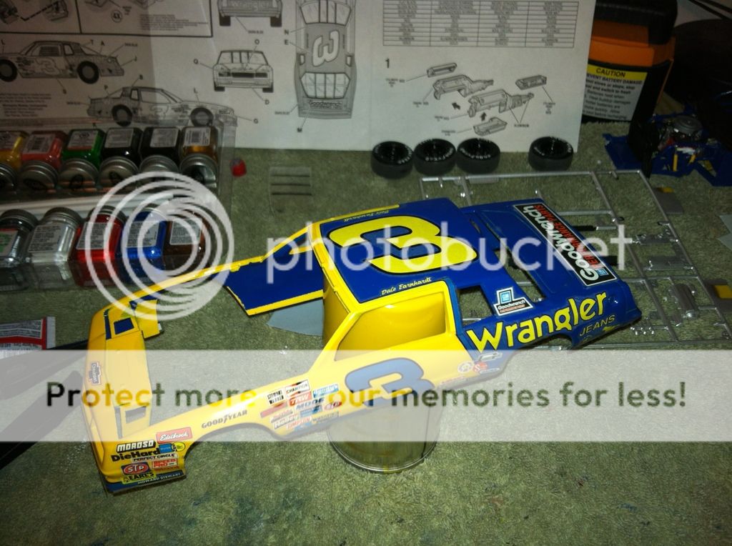

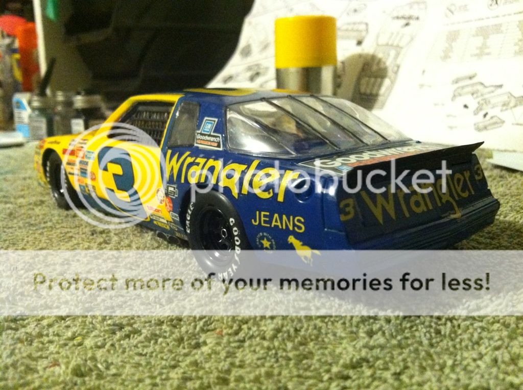

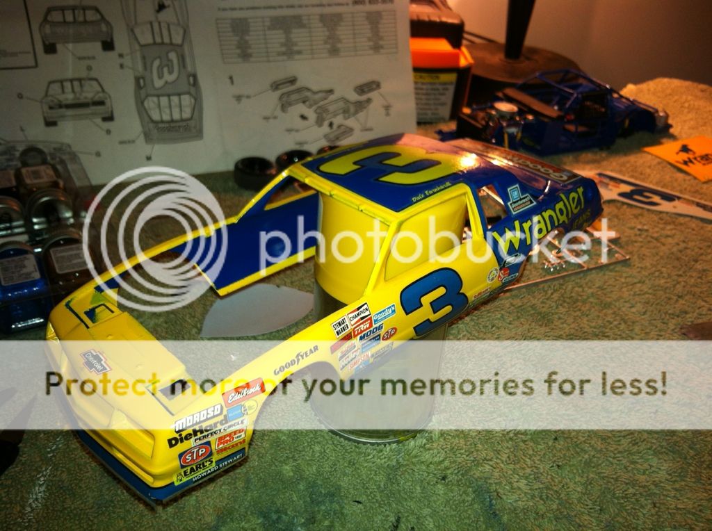

Posted 11 February 2013 - 06:08 PM

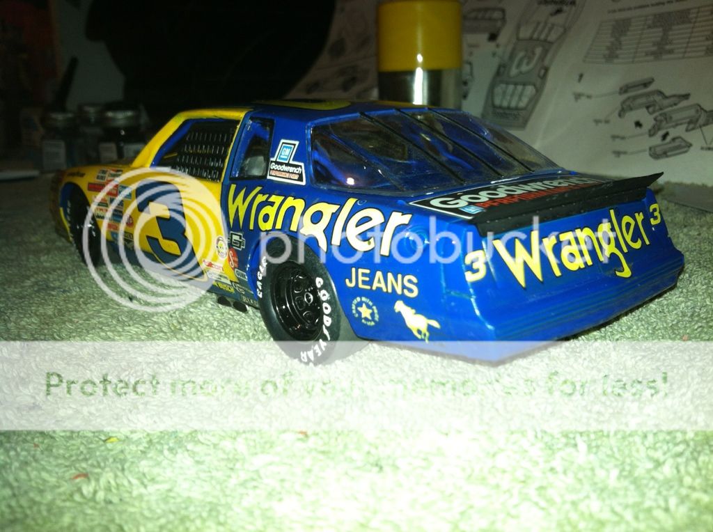

Haven't updated in a while so here we go. Finally got the blue sprayed on. Tonight I started the decals. It's gone fairly well so far, but not perfect.
Here are a few shots of where I'm at. I still have the do the other side but I want to let these dry before I handle it too much.
FE8BFC93-D858-45A1-9C4C-36A589FF3E1E-187
6DBCC245-F7F5-4CAA-A203-7E52E5E57749-187
FCF8B085-DE3E-4669-A40D-7005F25A1426-187
343421EB-8CD3-4261-B4E1-06649BF1CF6A-187
I do have a question. Some of the decals are slightly too big and hang over the body. It is especially bad around the rear wheel well. Will it be hard to trim after everything dries?

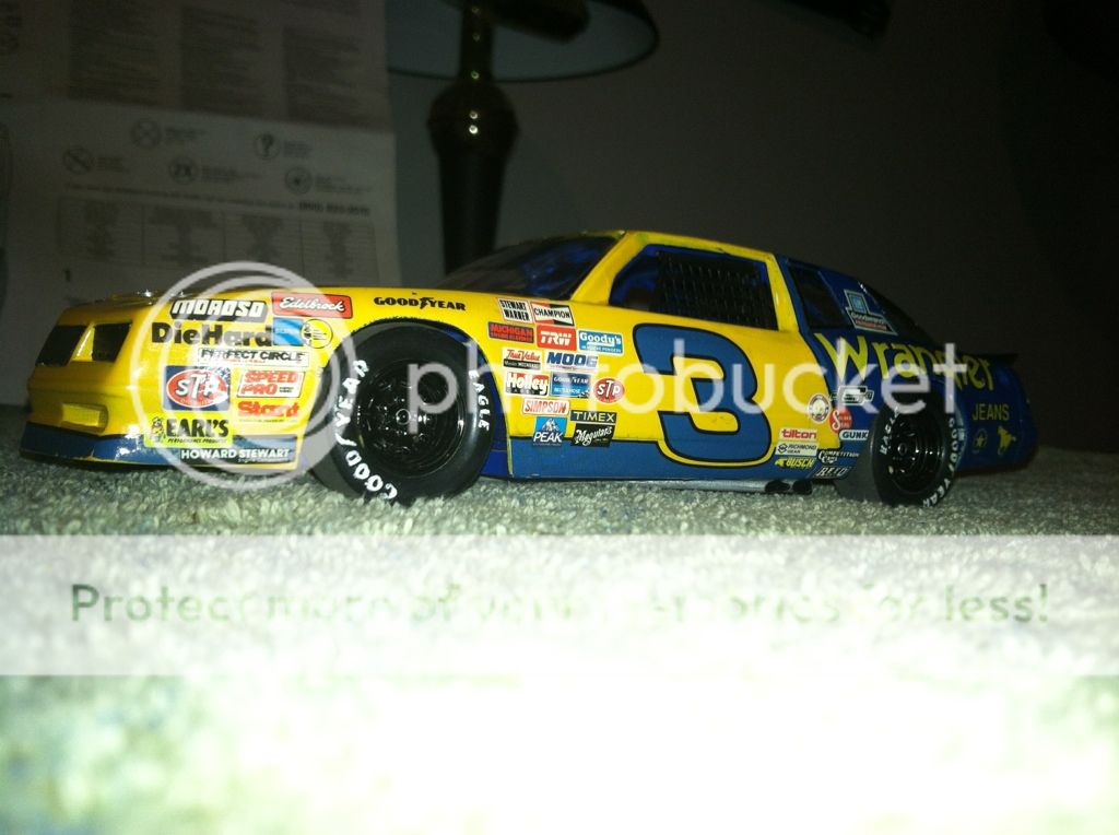

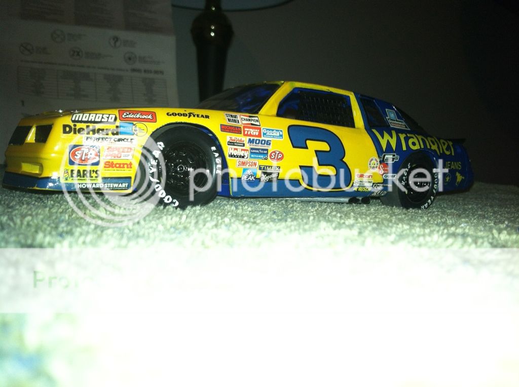

Posted 12 February 2013 - 05:59 PM

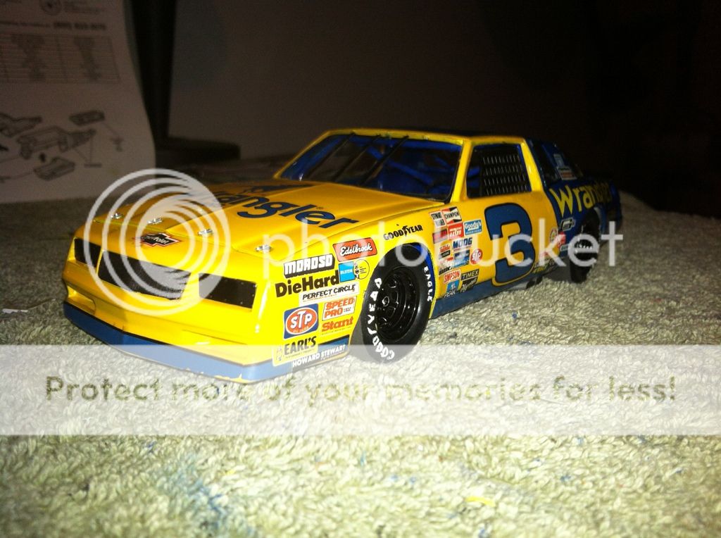

Finished, well it appears finished anyway. I'm waitin on my microset/sol to come tomorrow. I have a couple more decals to put on the other side. Ill call it complete enough to post some pics.
797410E5-4214-458B-BB66-3195E108E5B8-517
AC029A5D-4783-4287-928C-F478F6E30FDF-517
82EDA3F1-F8B6-4D52-86EA-F617760C8F78-517
DDB08879-65C7-4FA0-B7E8-4E48B89D6ADA-517
3D51DE41-417D-4EC5-979C-5D966345C66E-517
Thank you all for looking and for helping me through the build. I know I asked a lot of questions but I feel like I've learned a lot. Ill have this one truly finished tomorrow, and I can't wait to tackle the next one.
