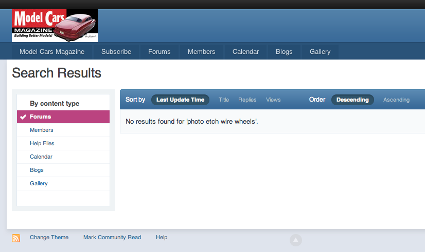

Absolutely. I would be totally lost on how to assemble MFH PE wire wheels without Andy Smith's tutorial, (which is hard to find based on a very weak search function on this forum). It would also be good to see PE tutorials on things like windshield wipers and piano hinges. Maybe we need a pinned PE section.
http://www.modelcars...showtopic=52976
