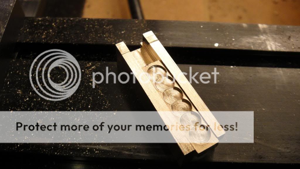

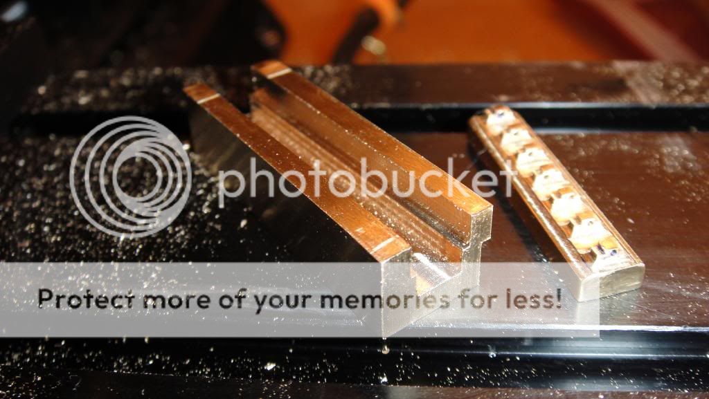

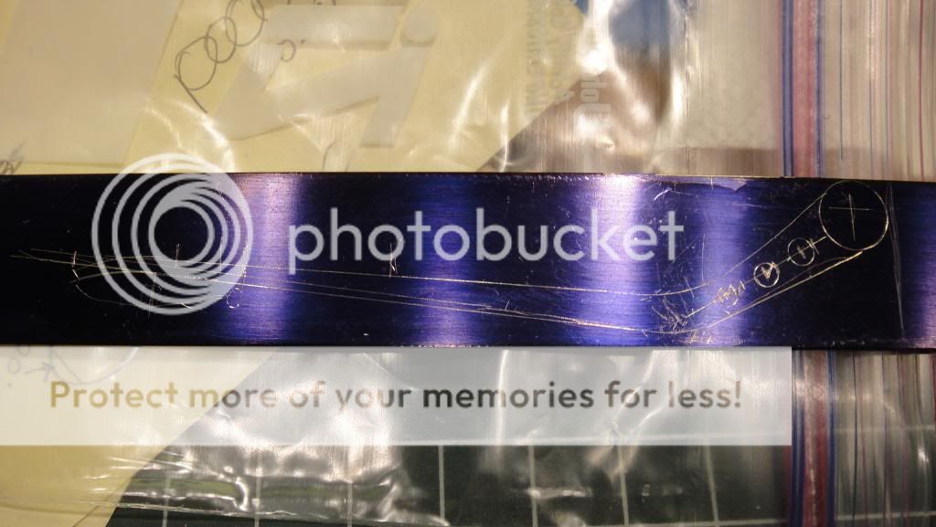

Posted 24 February 2013 - 07:29 PM
This was a bit of a challenge. I wanted a realistic hot rod front axle. I don't own a mill.....yet, so getting a real curve with the grooved I-beam look was going to be a challenge. After reviewing the options I took a page out of Mark Jones play book and did it in layers. Here are the layers. They are slightly rough because they have not been cleaned up yet. The small round things are the end bearings.
Ok, back to the bench.
Here it is all soldered up.  The round aluminum pieces are jigs I used to make sure that the bearings are soldered on parallel and at 90 degrees to the ground.  They are aluminum so solder didn't stick to them.
Edited by Pete J., 24 February 2013 - 07:30 PM.
