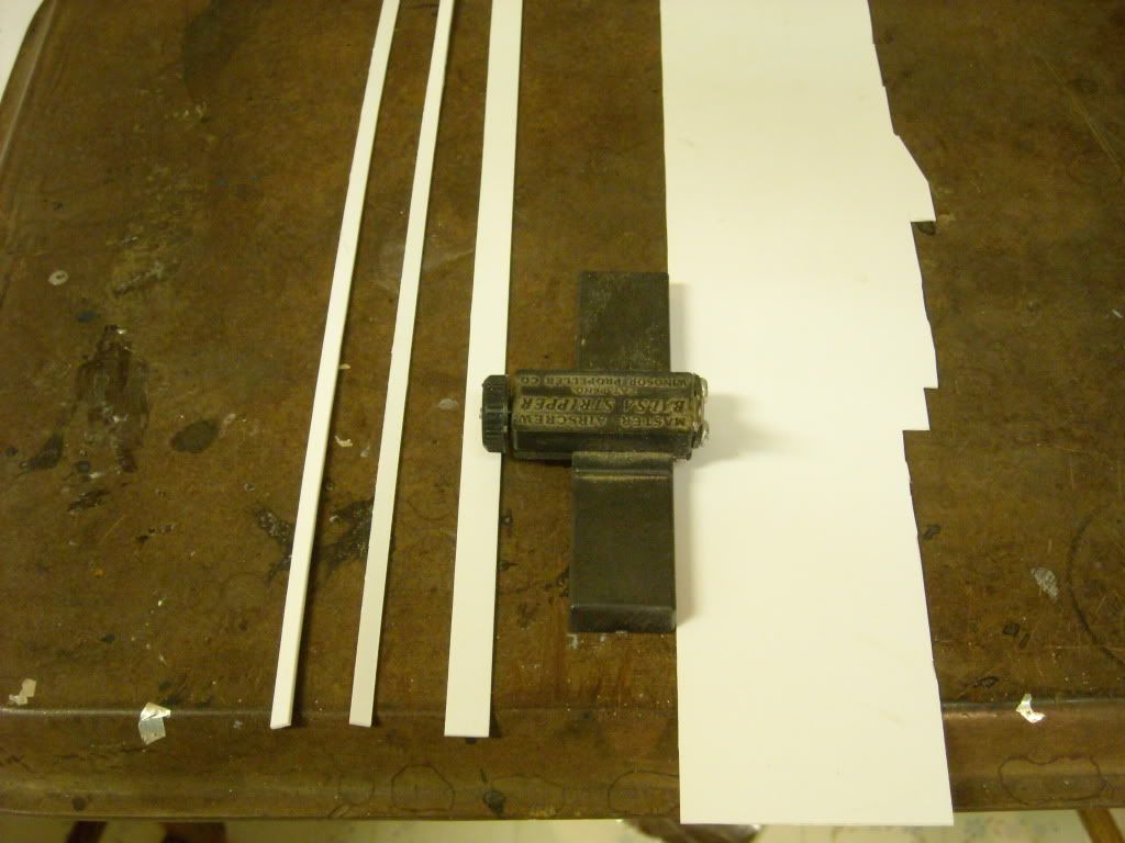

For ripping thin balsa and basswood, a Master Airscrew balsa stripper works well. As you can see, it also works on styrene.
You can make thin stock on a full size table saw by ripping a wide board and taking the finished piece off the waste side of the blade. It's difficult to make multiple pieces of consistent thicknesses this way, so it's best if you can rip a board long and thick enough to make all the lumber of a given thickness that you need in one pass.
