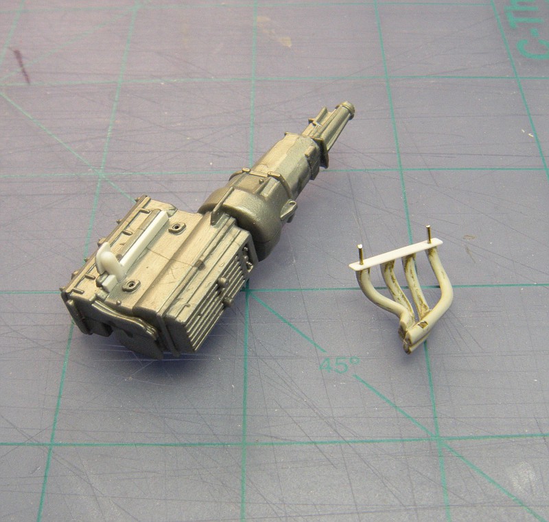

One of the pros showed me how he built his models. He designed the entire thing to assemble by pin or press fit.  He then could assemble the entire model and then take it apart to paint all the parts.  I do a lot of this now, note how this engine goes together. As an additional benefit, once you glue it together with bits of straight pin, it's not falling apart!

I'm with TomG.
I pin as much as I can.

I really like the pin idea. I've never seen that before..can't wait to try it.

I used pins and very little C.G

Here's another photo of the pin method. Look at the two mirrors. They are both just sitting on straight pins in this photo. I drilled the holes prior to paint to avoid mishap with my paint job. If you look through the interior, you can see the pin on the passenger side.  Once you figure out the length, just clip the straight pin down to size. Then you can glue it from inside the body. No chance of glue showing on your paint job!  I do this with door handles too.  And they'll never ever accidently come off!
In fact on this model I never did glue the pins. They're just holding the mirrors in place.  This truck was the box art model for the Model King '79 Ford pickup kit.  I was afraid that the mirrors and other accessories would fall off while being mailed around, so I left them off for the photographer to put on for the photo shoot.
Also I wasn't sure what accessories they'd want to photograph so every thing can go on or off. The front brush bar is on pins and the bed cover is just sitting in place. Note that the mirror isn't on in this photo.
And here it is with the roll bar pinned into the bed. See the mirror is in place in this photo.
