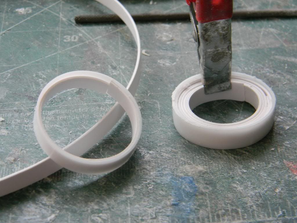

First I am using .40th thick thermal plastic. When I get done, some parts are less then .10th thick. I do end up making several parts to get the right draw on them For the pumpkin I used a deep tube for the female mold. This has a lot to do with the depth of the parts. I am finding with the more I work with the molding process I can get more complex shapes depending on the male mold(Tide stain stick cap). This is really the only thing that limits me, the male mold parts. The one thing to remember is that with the thermal plastic you get it right the first heating since it will not heat a second time. With practice you can make anypart you need this way. I am still looking for how to do the inner fenders ont he front since the shape does not fit anthing I can find. I hope this answered the question adaquately, if not let me know and I can go into more detail with photos as needed. :)
Thermal plastics are used mostly in vacuum forming of parts like boxes and packaging of parts. I learned about this from my borther,who hold most of the patents on vacuum forming methods and machines. I have helped him out building machines and watched as he designed new ways of forming parts. Granted I dont have anything like the budgets he would have and do everything with simple parts and an exacto knife,a few files, and sandpaper. Everthing is made in a space of less than 2 square feet on my desk.
I hope that the methods I use can be helpful to others in making some parts to augment the kits most people use.
Again thank you for the comments and questions. They help me in coming up with new techneques to make more elaborate parts from nothing.
Kenn

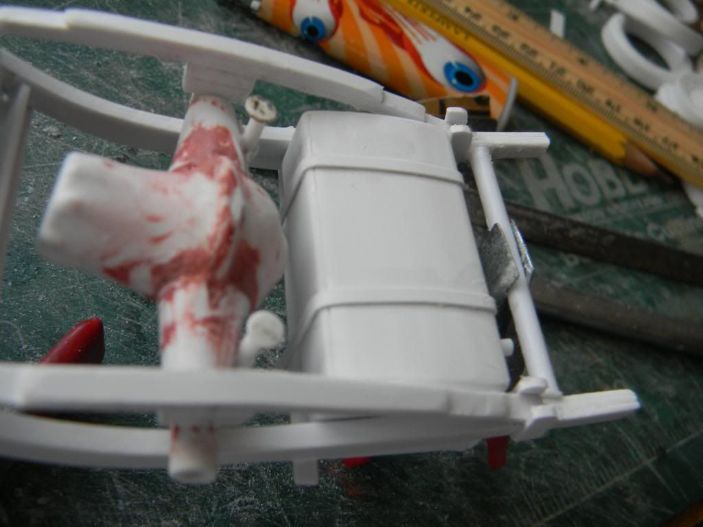

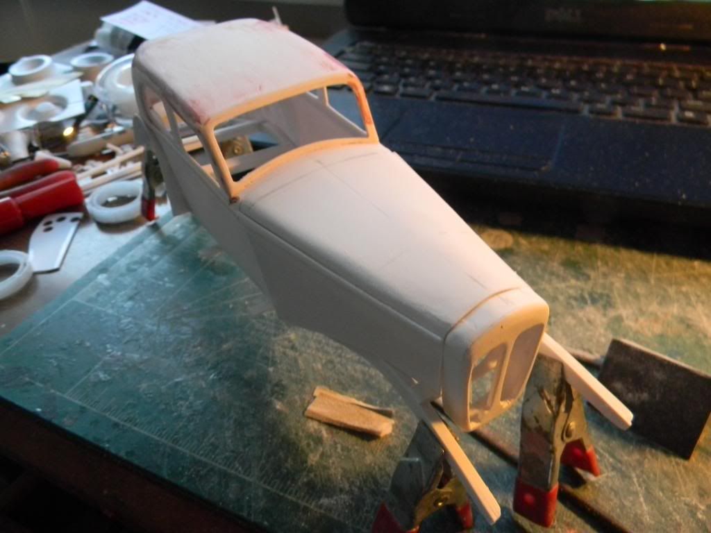

Posted 13 February 2013 - 04:05 PM

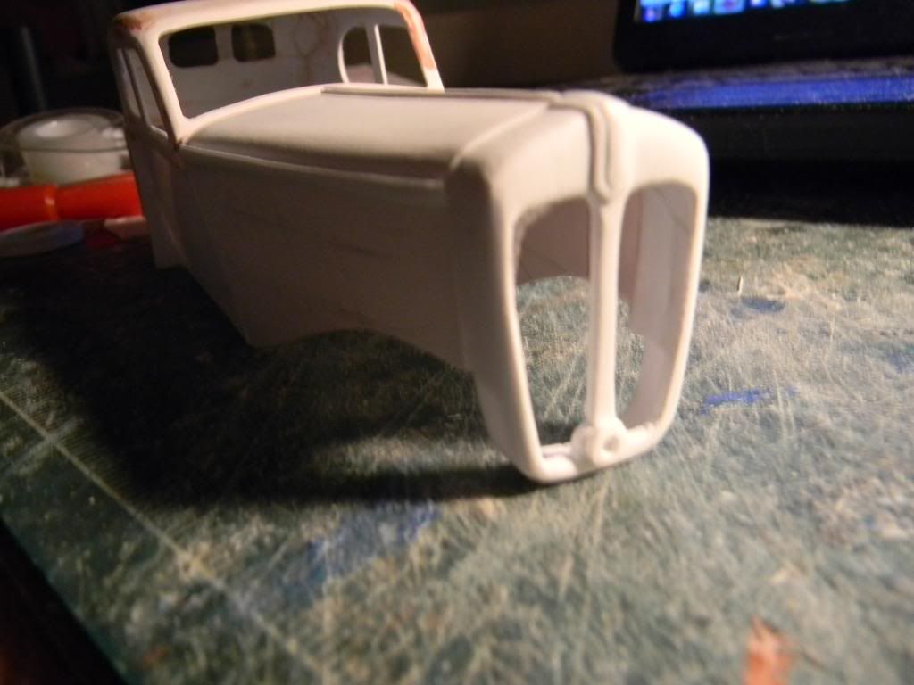

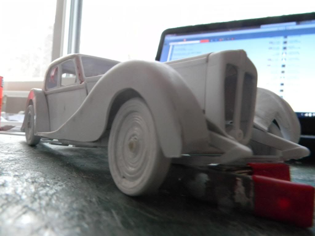

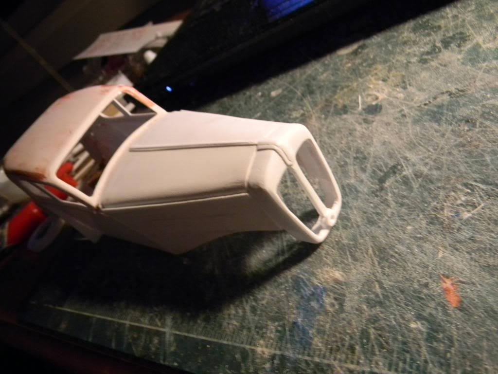

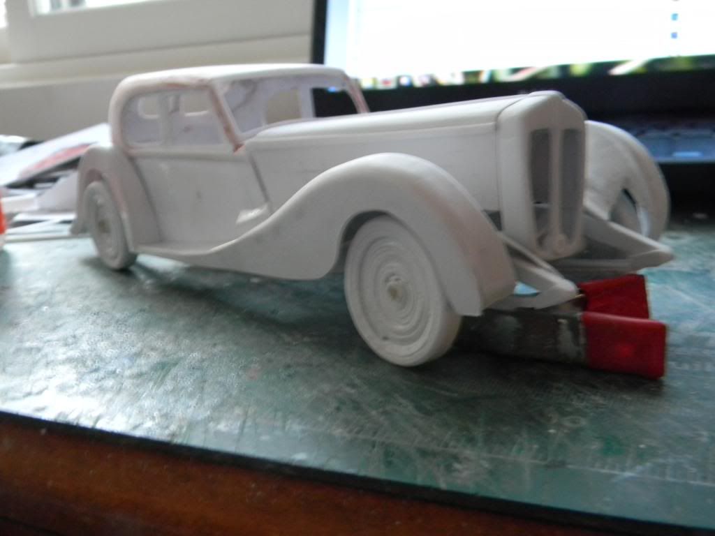

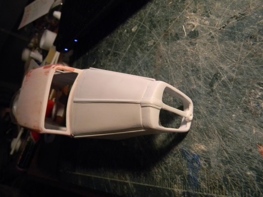

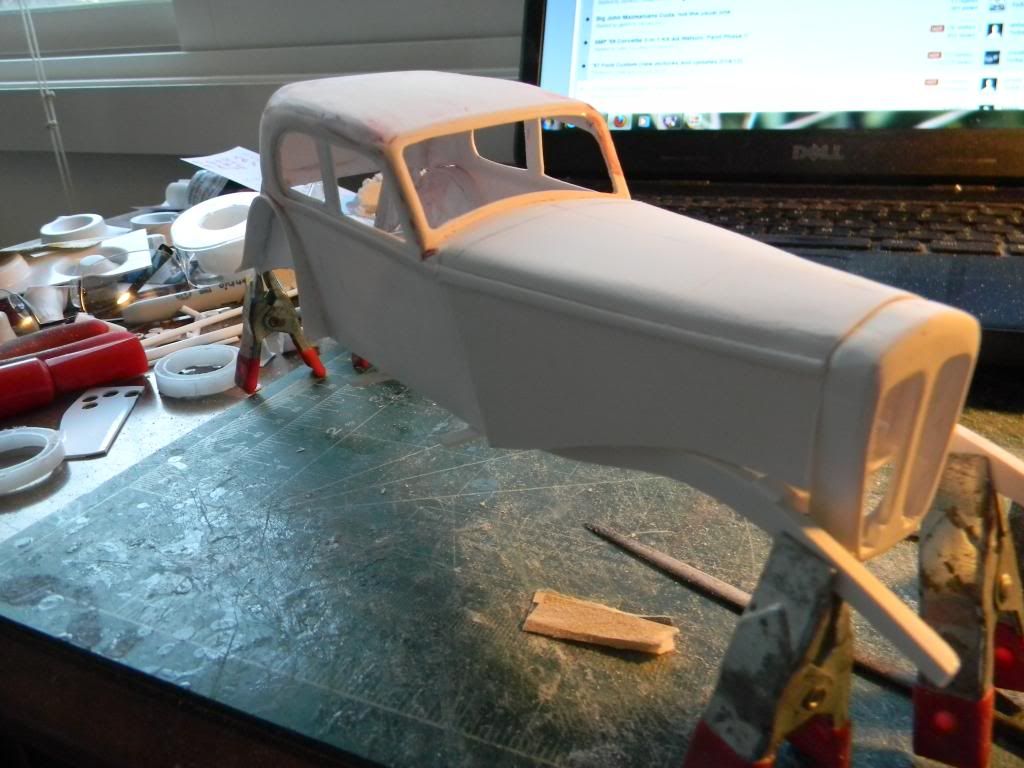

Mudding the body. I used Bondo spot putty that I picked up at wally world. I put it on with a scrap piece of plastic.
It is a little heavy and noticed that there is only about a 2 minute window of working time before it started to grab. it did take a few hours to harden and the bottom valance on the back should set overnight but it is a little heavier.
I sanded out with 220 340 and finally 400 to get it decent. Most of the putty was removed and there is a few spots to refill. nothing to sweat about though.
Thank you for looking and commenting with questions.
Kenn

I heat it over a candle until it gets very pliable and limp......I am setting up a short tutorial that I will post this week end showing how to do that and what is needed and a lot of different shapes,,,,,I am experimenting on making my wheels this way also and will show that......Thank you for the questions since they help in setting things up and what I need to include.
Kenn

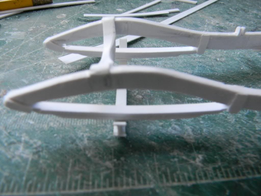

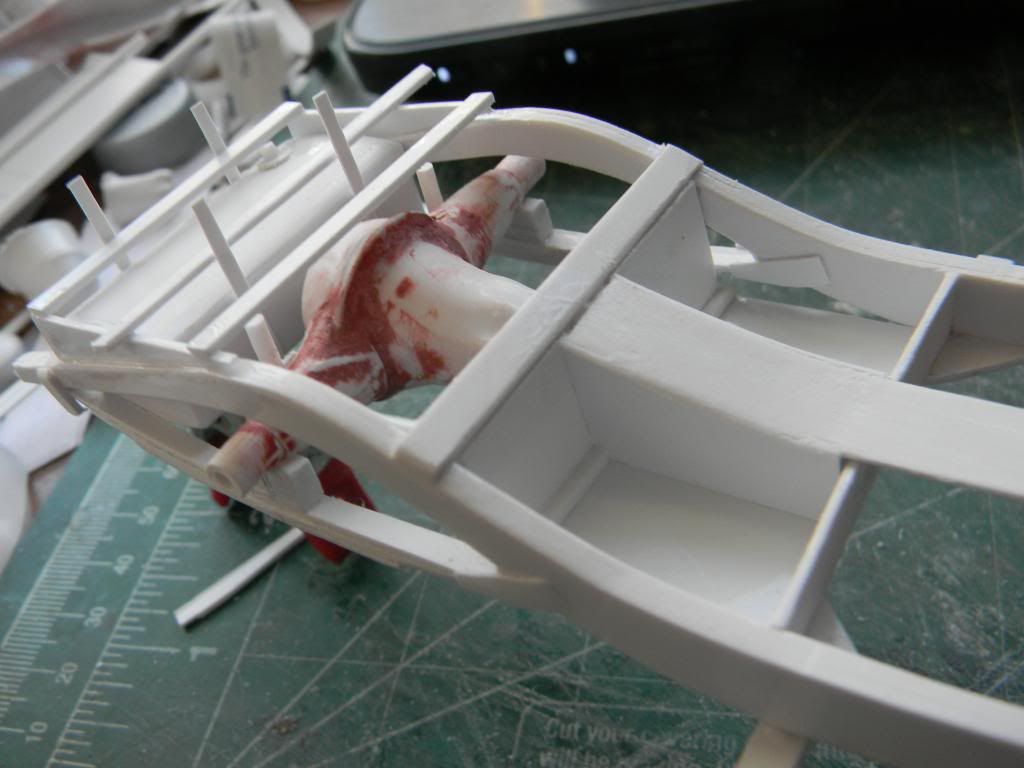

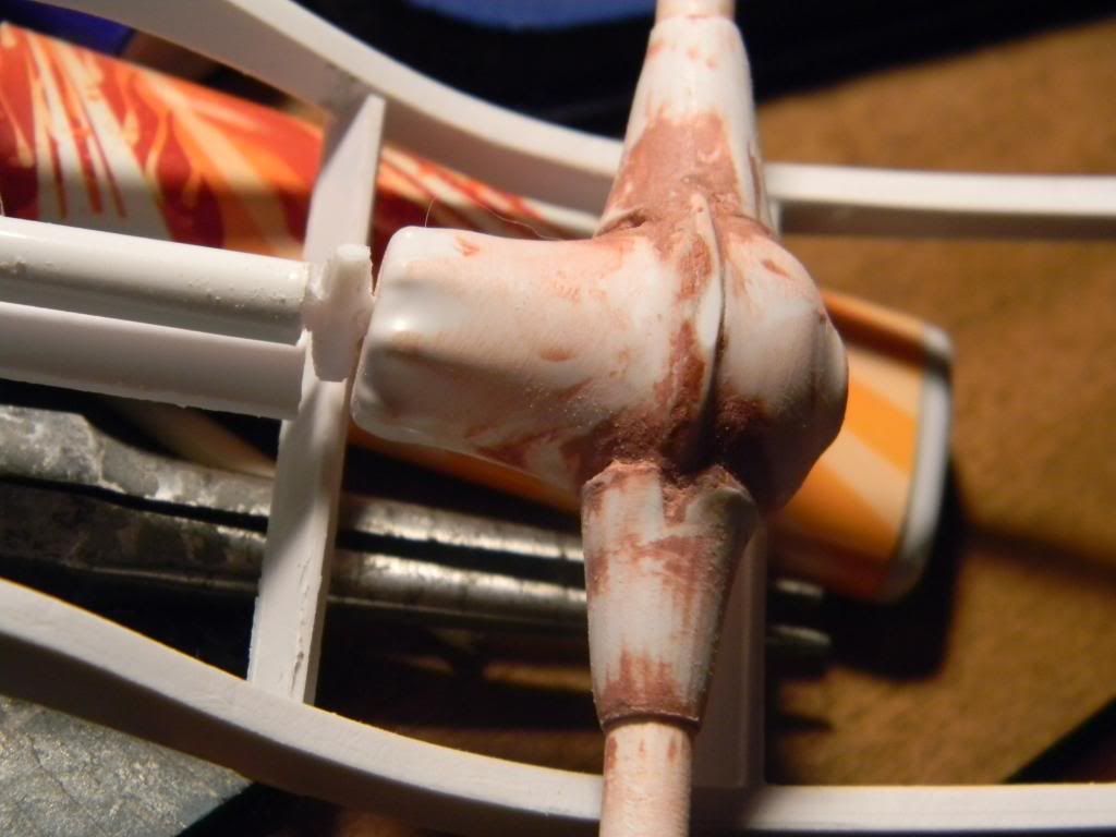

Posted 14 February 2013 - 04:41 PM

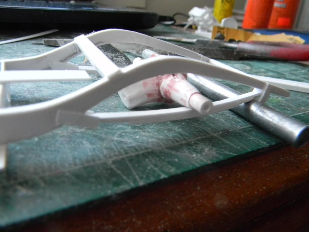

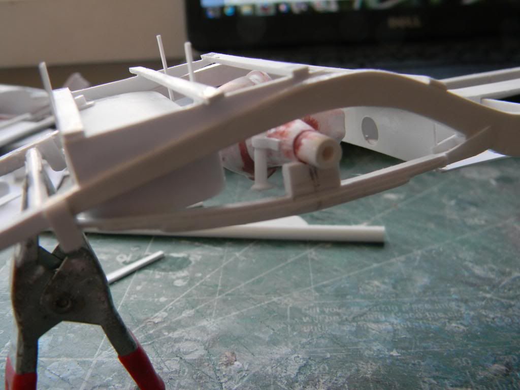

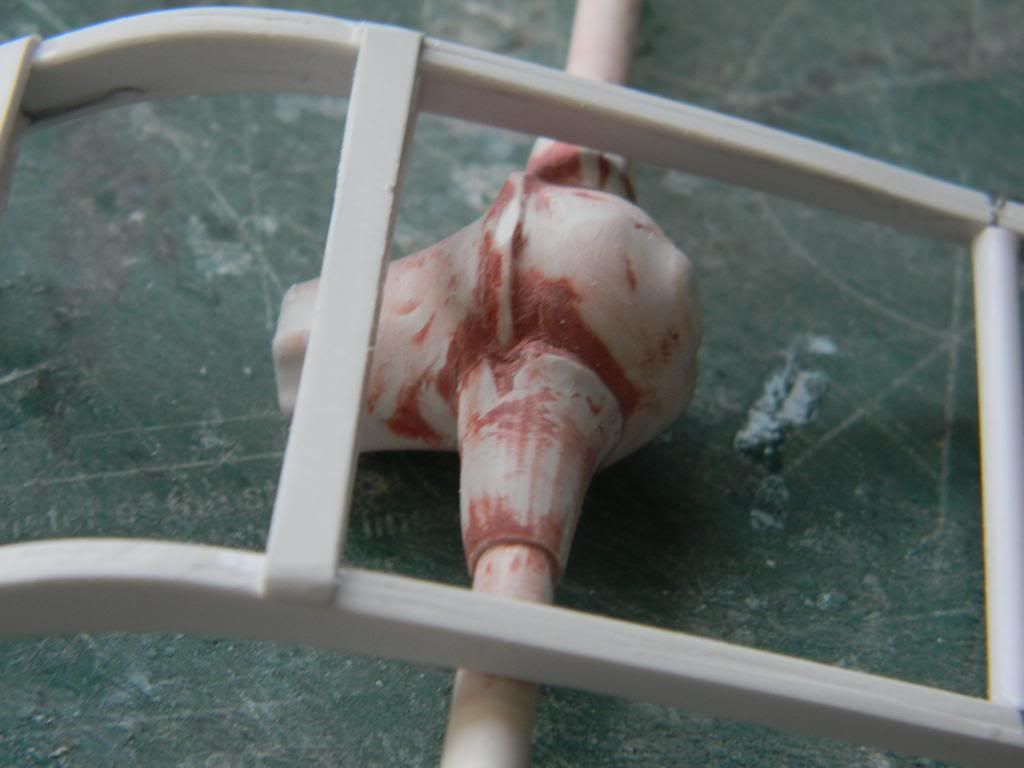

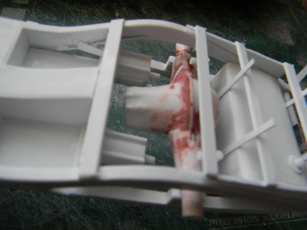

Here is the nearly complete rear end for this car. I will be going into detail of the construction in the thermal forming tutorial that I posted part 1 of tonight,
It still needs some clean up and the springs, brakes and jacks need to be made.
Kenn

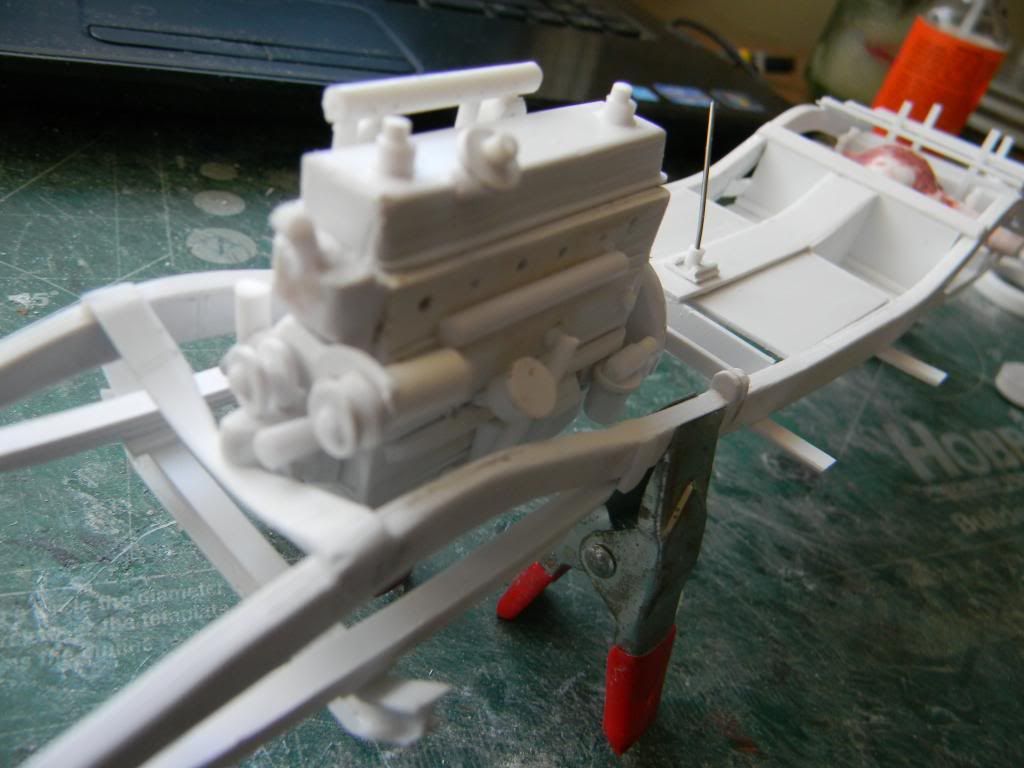

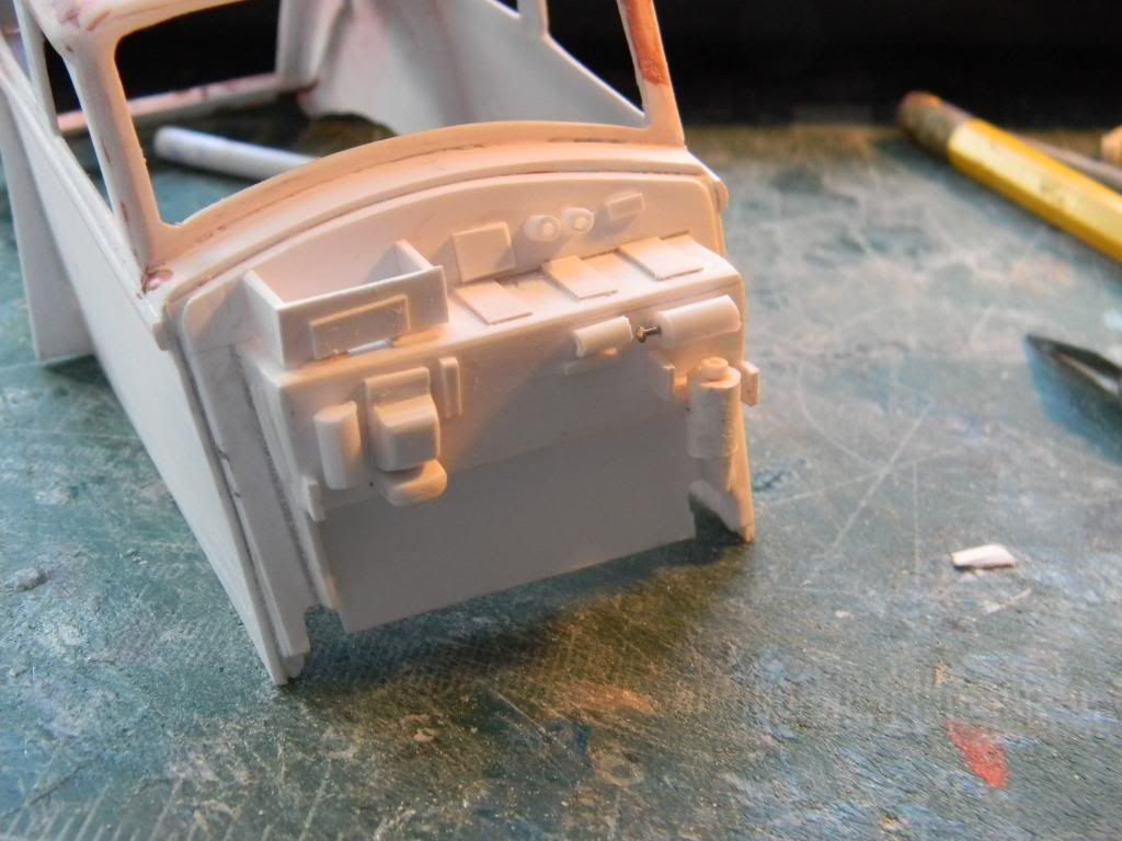

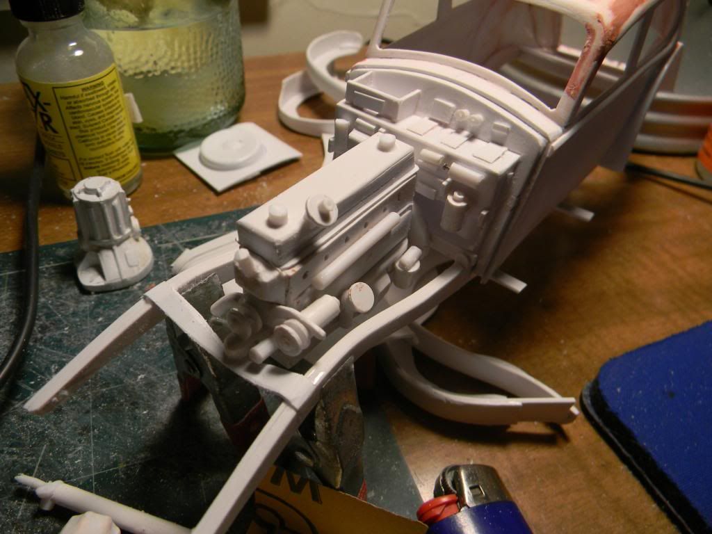

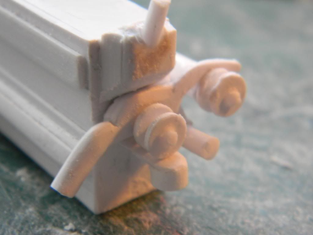

Posted 16 February 2013 - 03:22 AM

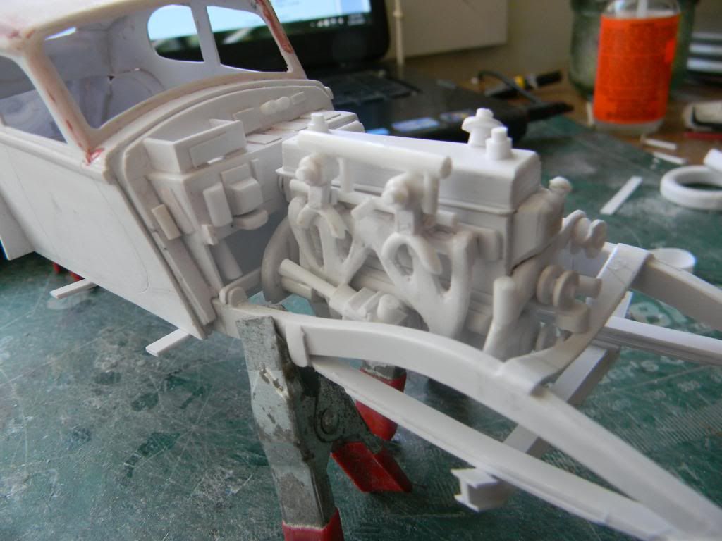

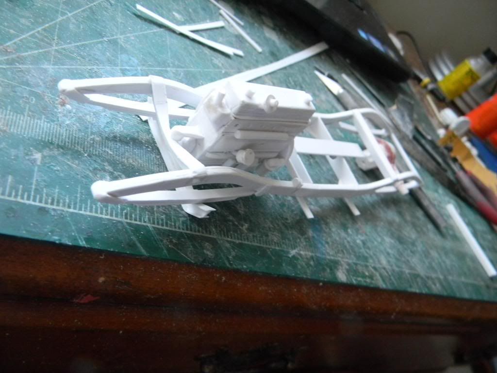

I took yesterday to add a few bits to the engine and firewall. I use the photos to get shapes and general layout on what I can see but end up faking in the bits I cant see that I feel need to be there to fill in spots. Theree has to be a certain level of detail parts to give the impression that you everything there whether you do or not.For this i use tubing, built up shaped parts like the water pump and stamped parts like the pullys. I feel that if you have enuff of the layers of parts that show and add some here and there to sujest what you can noy normally see it looks more finished and if you hove something out of place a bit or not just right it will not show unless you find someone who has an intimat knowledge of the particular car you built up.
i still have the right side to fill in with the steering and manifolds. After all the painting is donw the 3rd layer of detail goes in with the wires and piping here and there. I will most likely have a lot of futtzy wires going about to make it look conplete.
I only have pictures to go by and the dont show all areas very good.
Thank you for looking and the comments and questions.
I did start the Thermal forming thread 2 minutes before the forum crashed on Thusday, :rolleyes:
Kenn

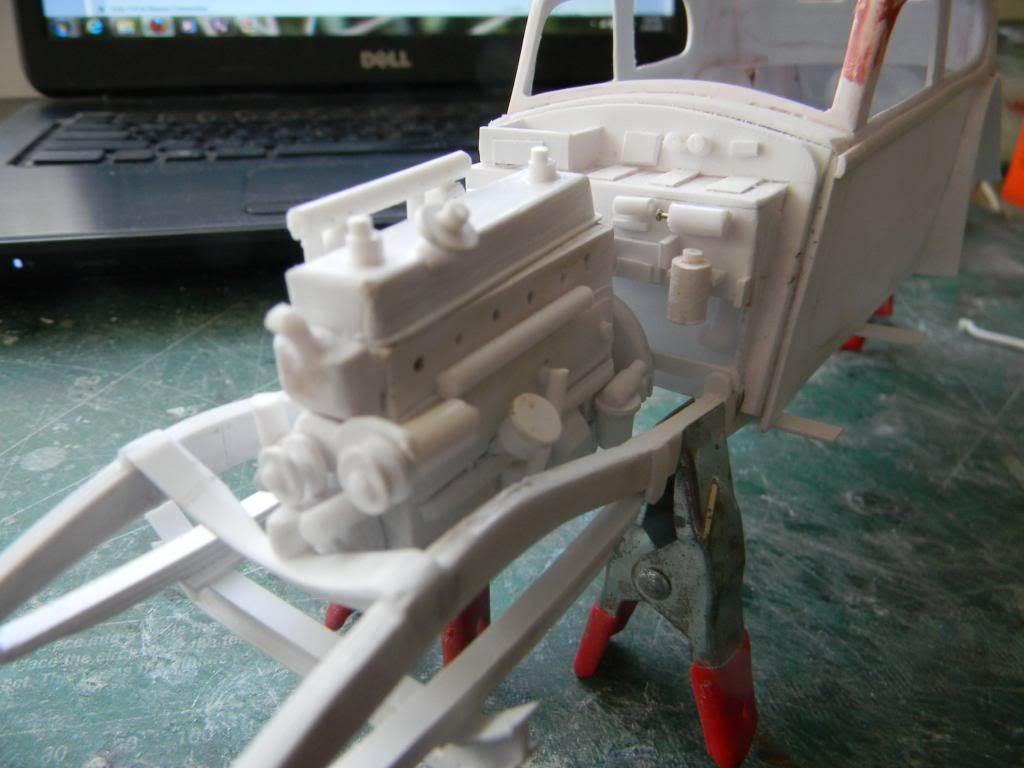

Posted 16 February 2013 - 10:01 AM

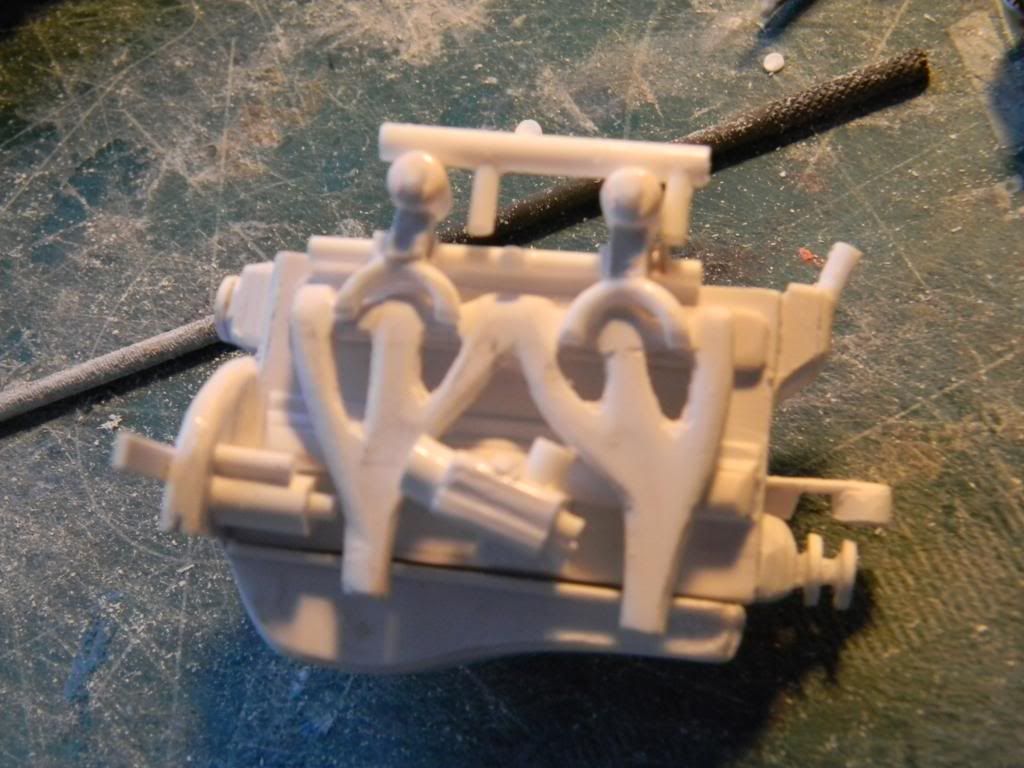

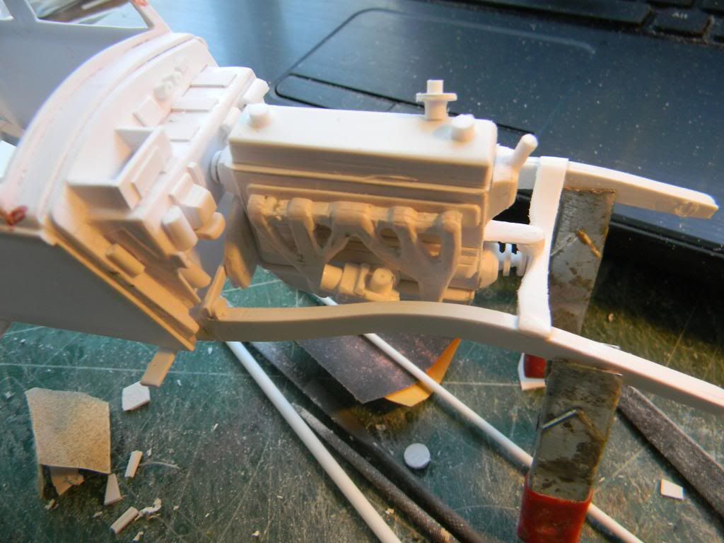

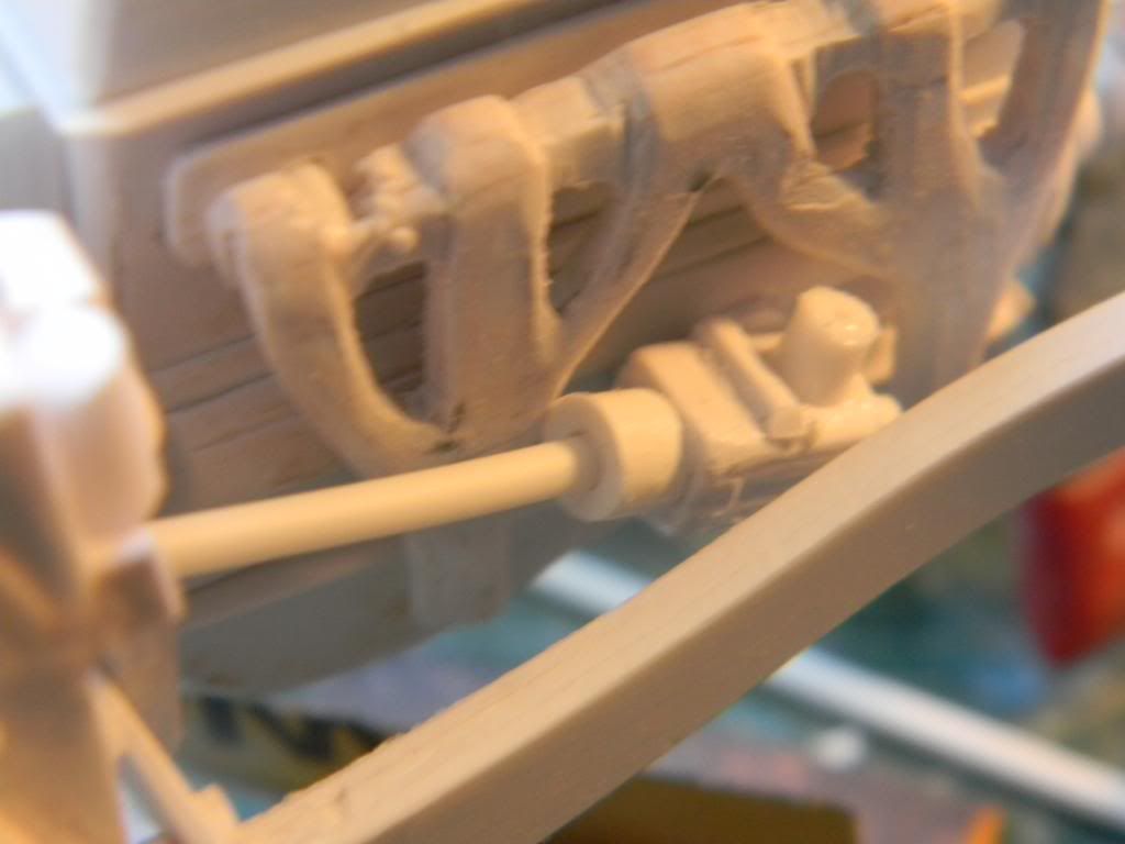

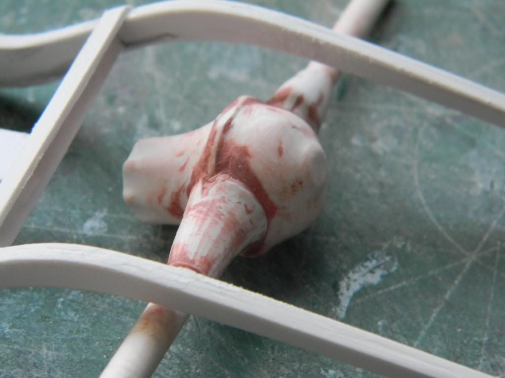

I have the exhaust manifold started and the steering box finished and installed. The manifold is pinned so I can get it in and out while working on it,,,The intakes go between the exhaust as shown in the picture.
36-MG_SA_2-5Ltr-DV_12-AI_e04_zpsc78a0c60
Kenn

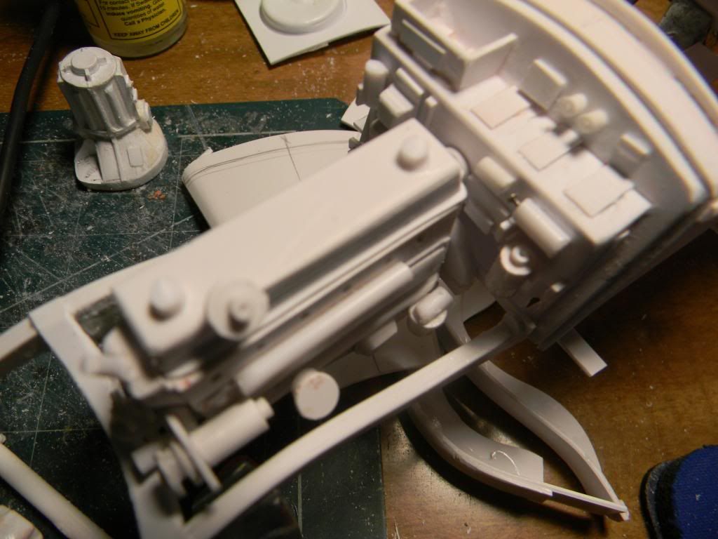

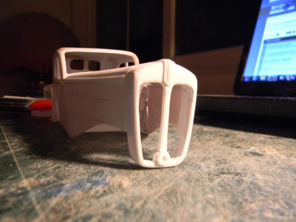

Posted 16 February 2013 - 01:26 PM

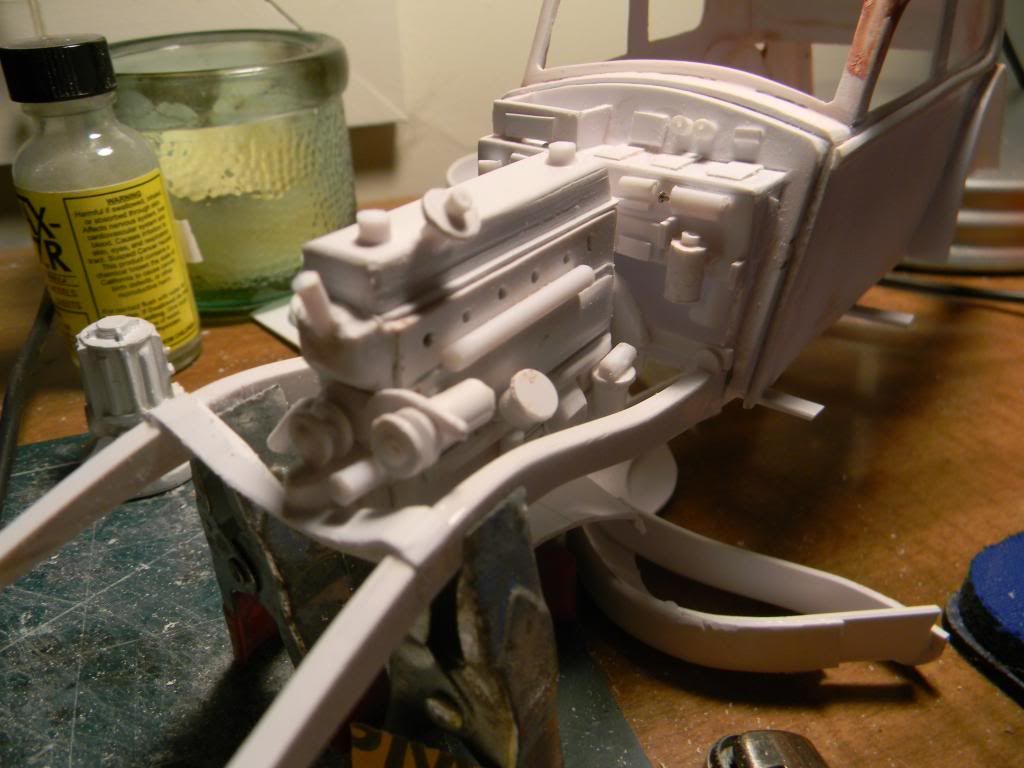

started getting the intake manafold put togehter, and getting the front sheet metal aligned and closer to finish...Guess I am going to have to get the frame brought up to speed next........all the comments are welcome, thank you.
