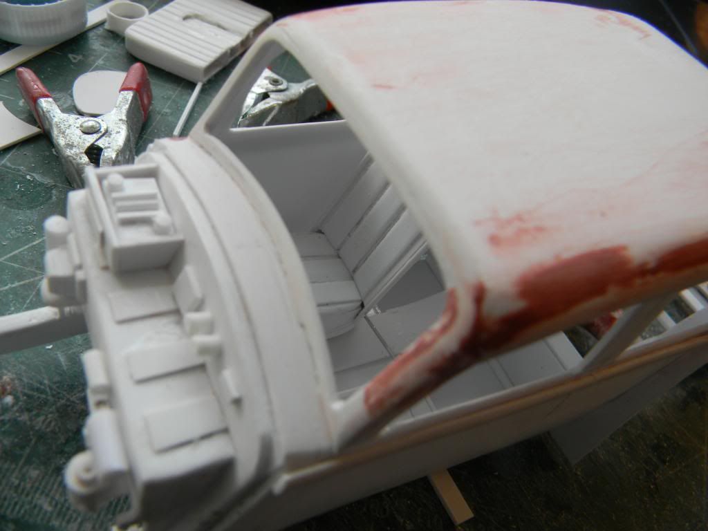

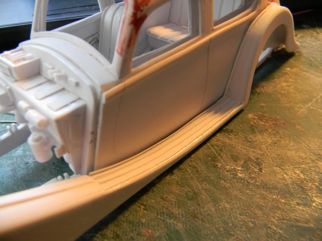

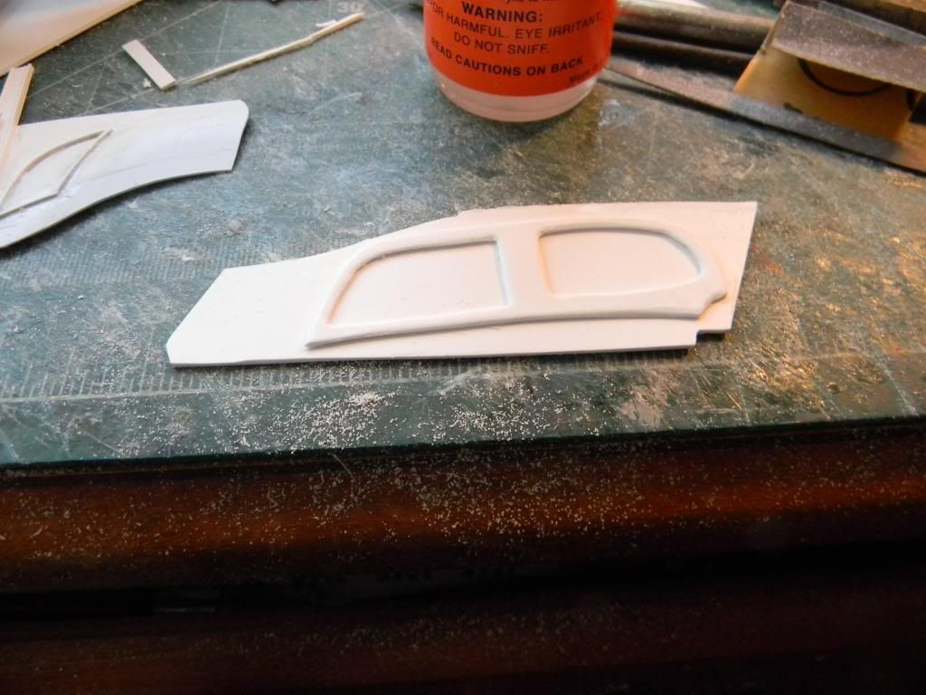

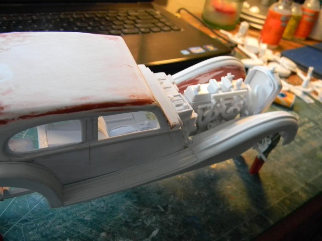

Front sheet metal is complete and ready for the paint shop. I added some detailing to the radiator and top of the hood. Not quite true to the car but I think it needed some details that were common to the period.
Thank you for looking and commenting.

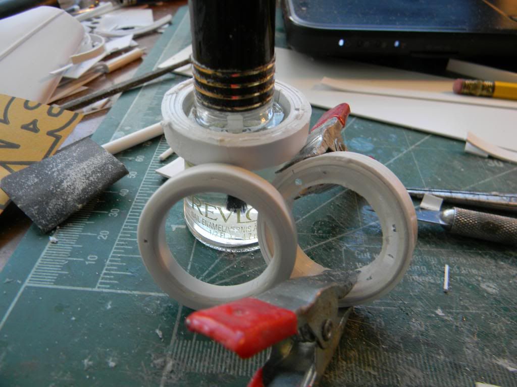

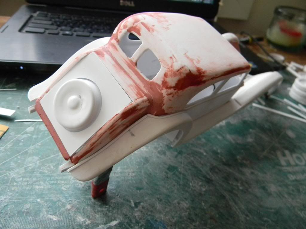

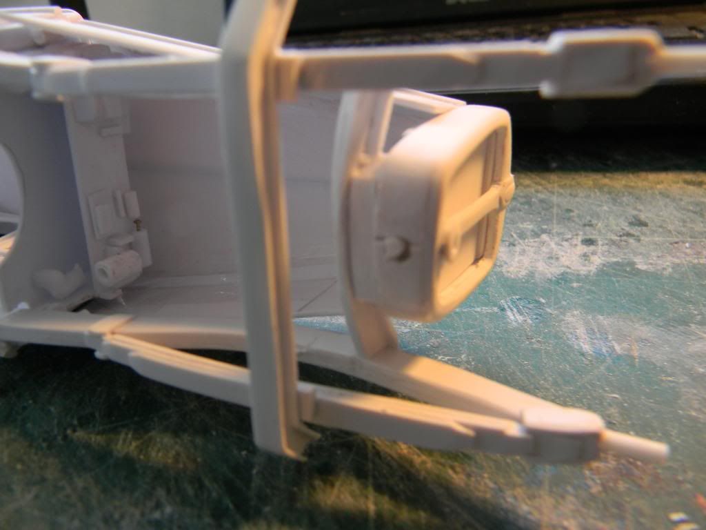

Time to get to the suspension but have to get some wheels fo this.Checked the read axel and had to remove a cross member to relocate it.
on to the wheels. I used an empty tape enter for the molds to make the solid wheels out of 1/4" stripps aboit 13 1/2" long colied inside.
After some sanding they are starting to look like wheels. Need to make some temporary centers until I can make up the wire rims for it.
Thank you for looking.
Kenn

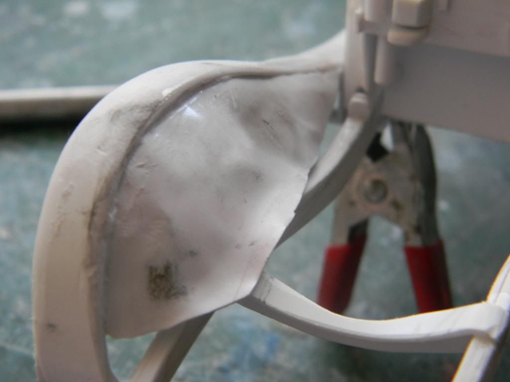

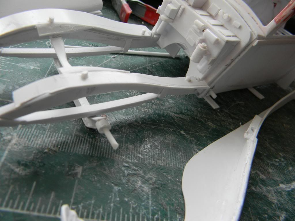

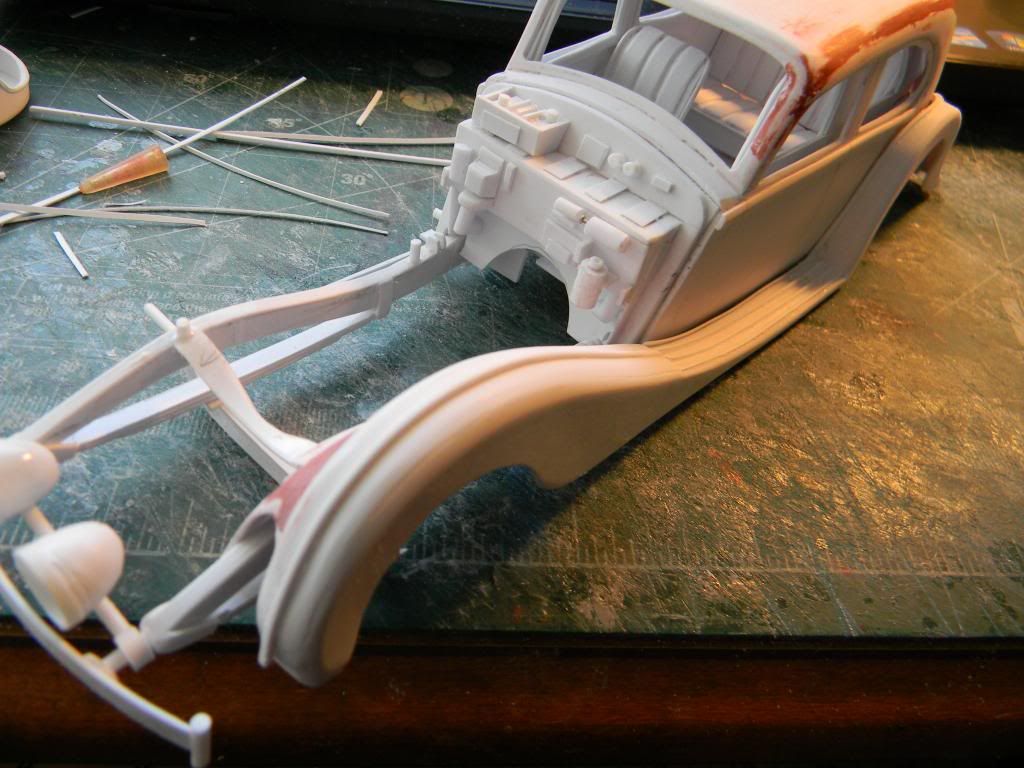

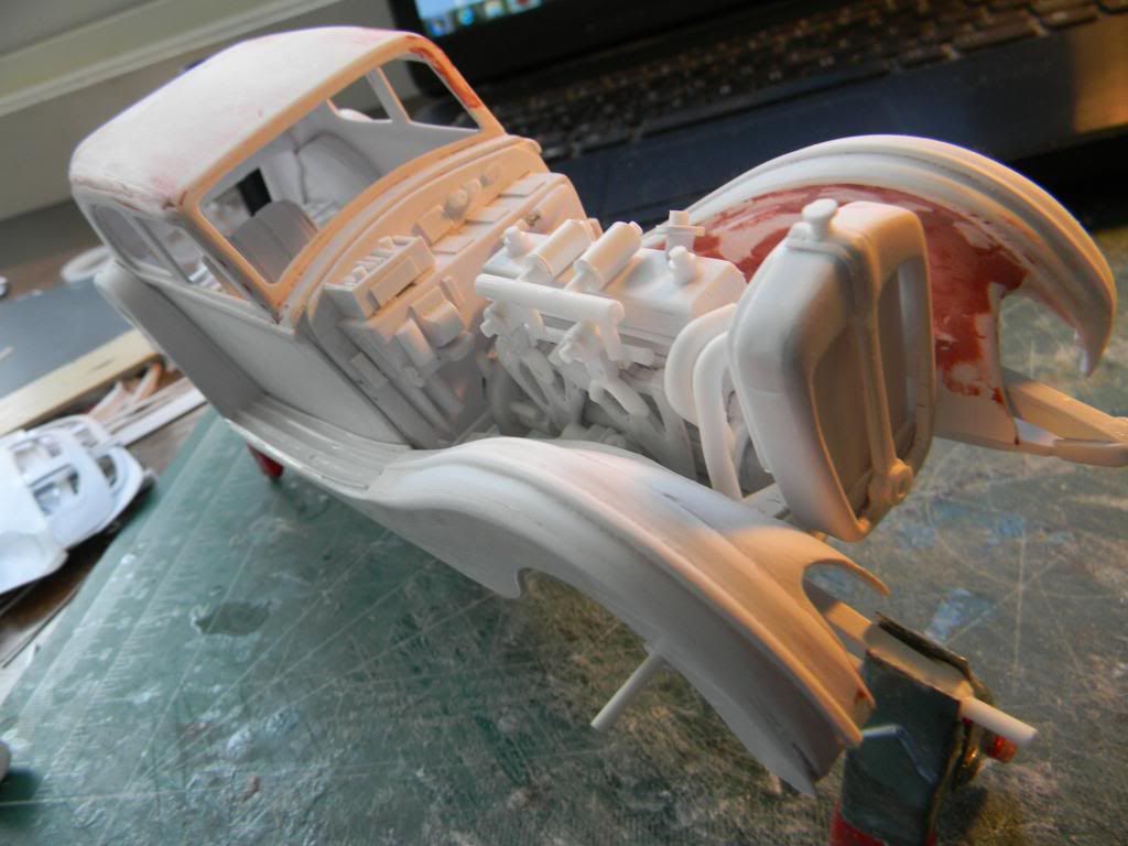

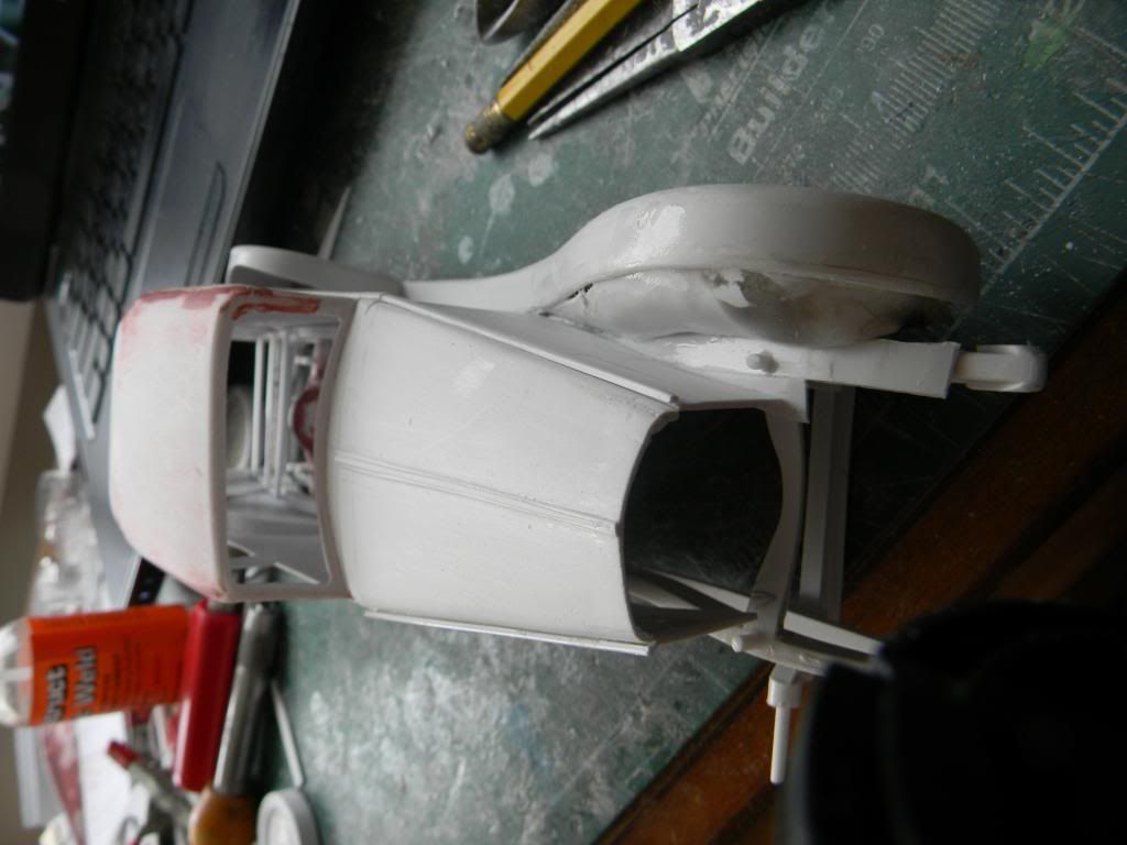

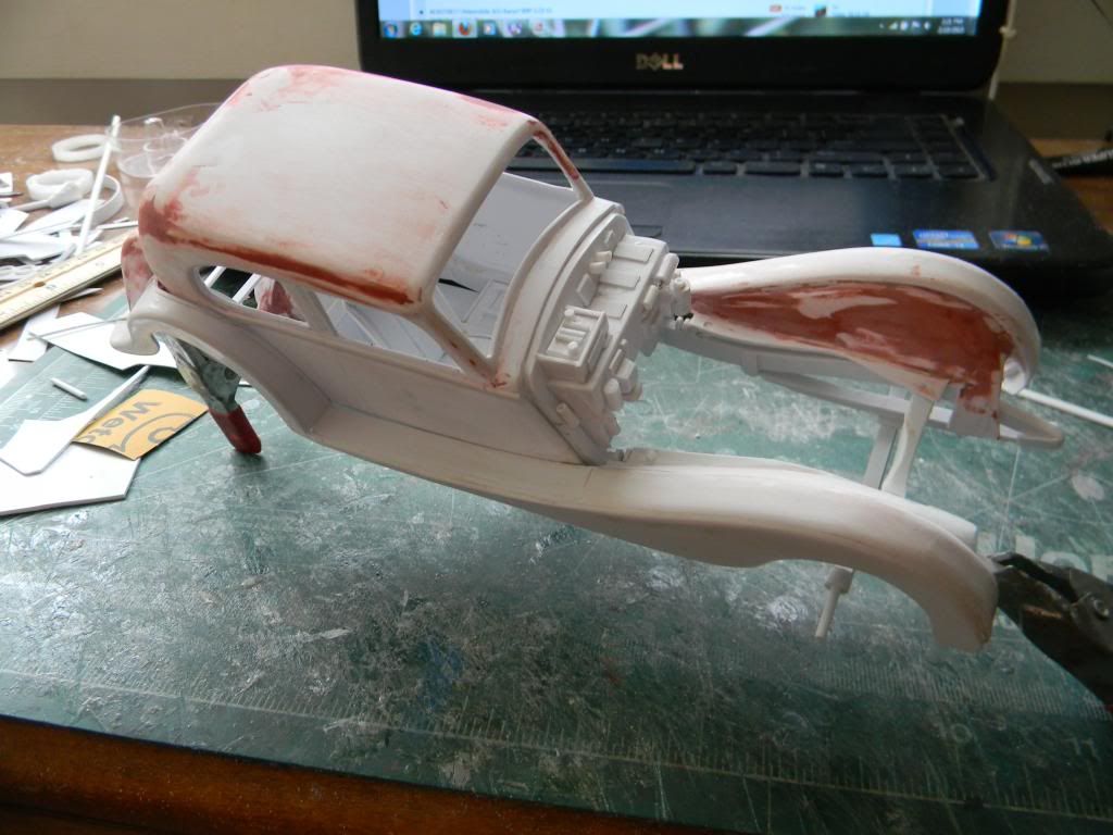

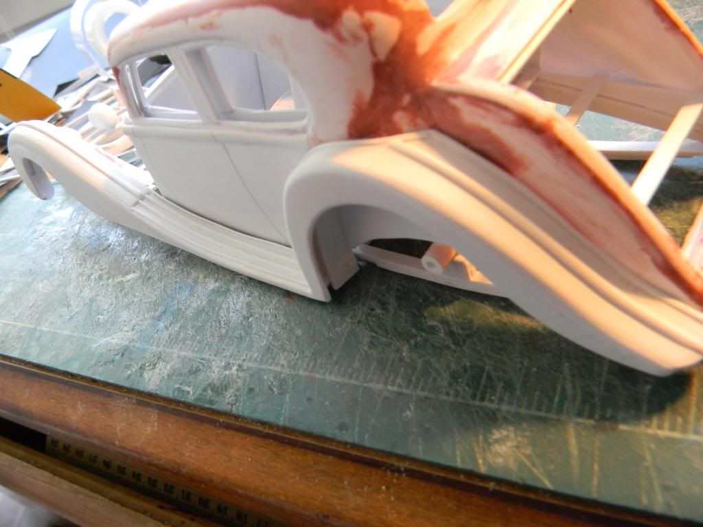

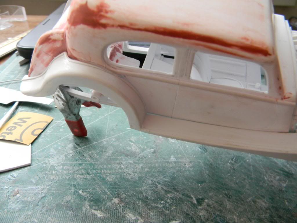

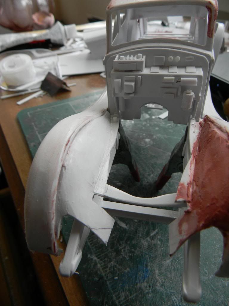

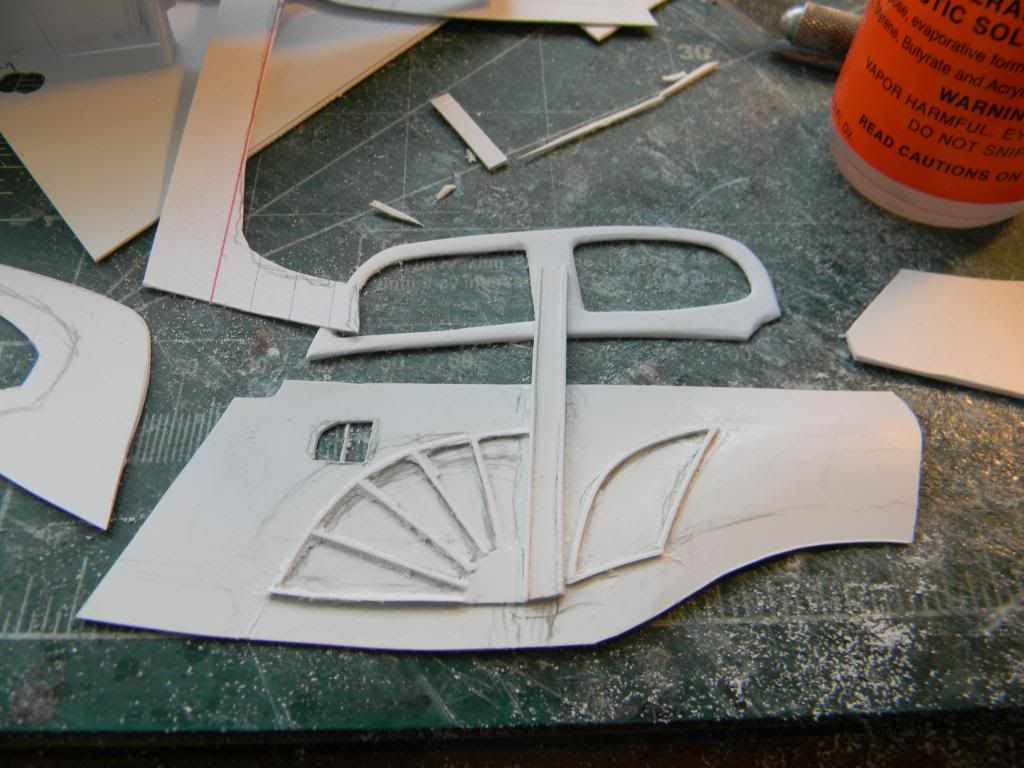

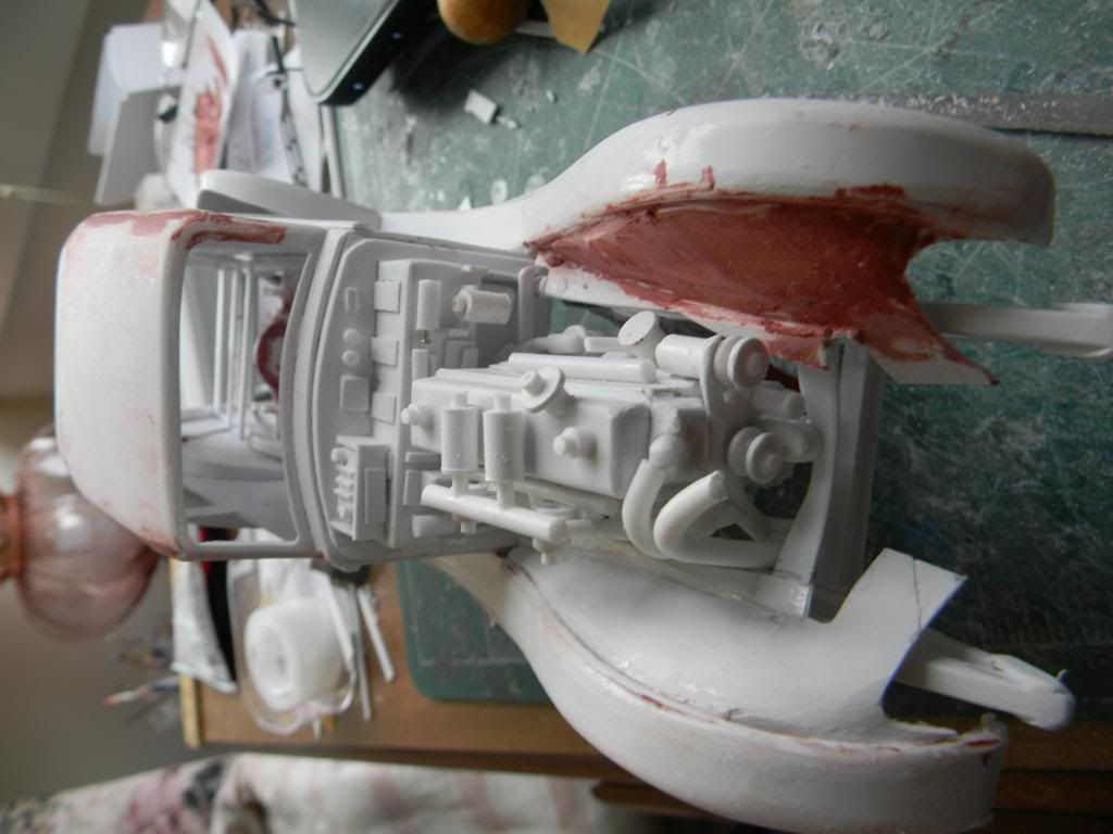

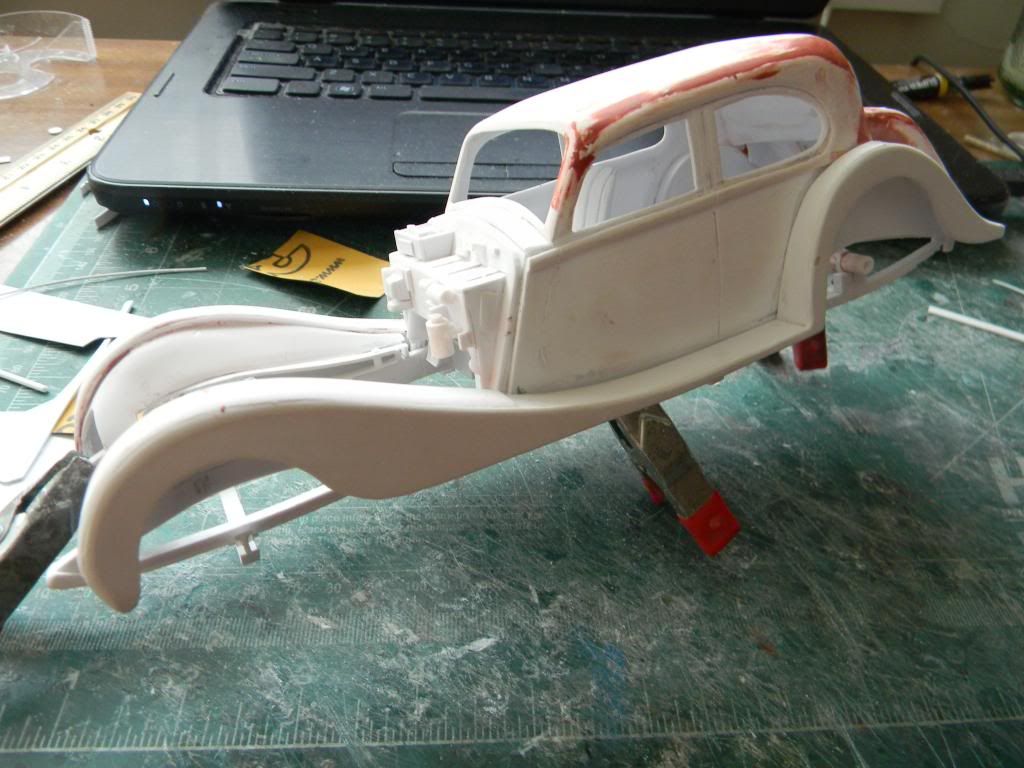

 I found that I had to fit the front fenders to the inner fenders before I  can do the front suspension.
I heat up .20 plastic and started to form the ineer fender by hand and eye. I reheated and formed several times until
I had the shape I wanted close to the origional, There is still some additional fitting and reshaping of the hood panels but
that may be able to wait for now, I rework things as I go along as more parts are fitted since I negleted to fully look at things before
I build them up. I have the same problem on the carberators in as they ended up too high to clear the hood so I will have to rework them.
That is one of the things that happen when you have no drawings to go by and only eyeballing off the photos. Things are close enough
for most people looking at them and it serves the purpose to give a credable model.
Kenn

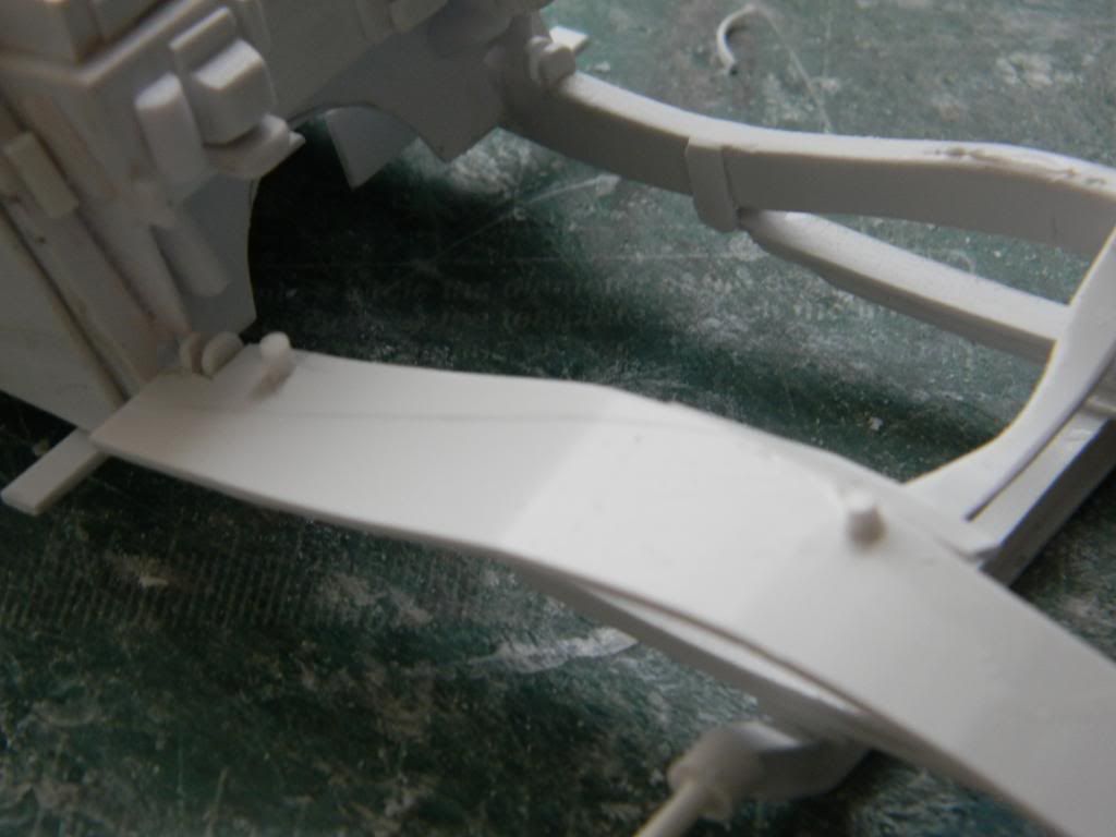

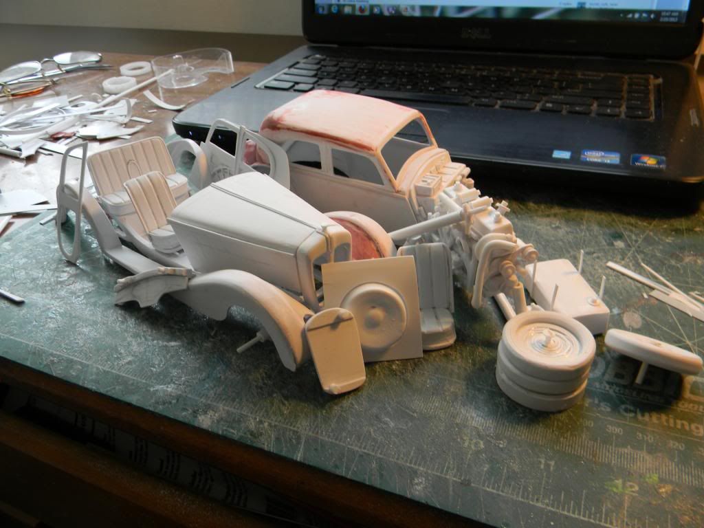

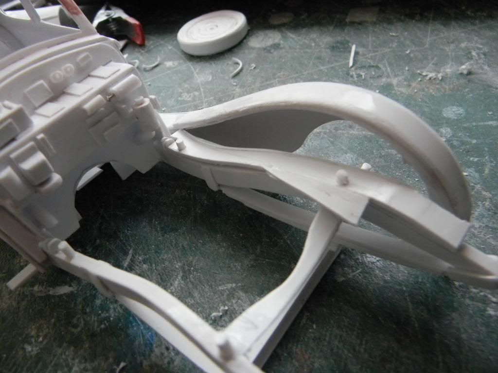

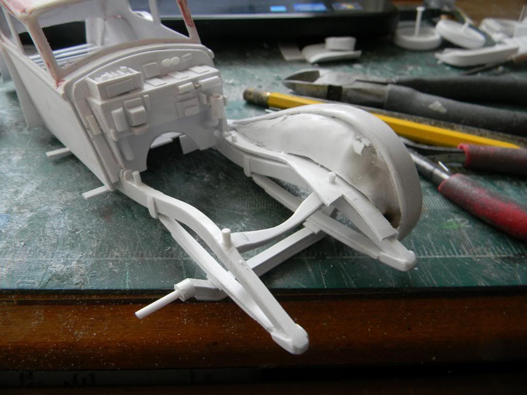

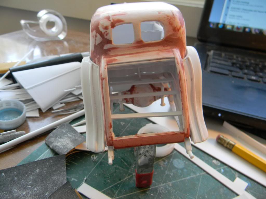

have the springs roughed out and the front and rear axel built up now. It is starting to come together now. Just have to finish the wheel and get the thing put together for the test assembly to make sure the part are all going to come togehter properly.
Kenn

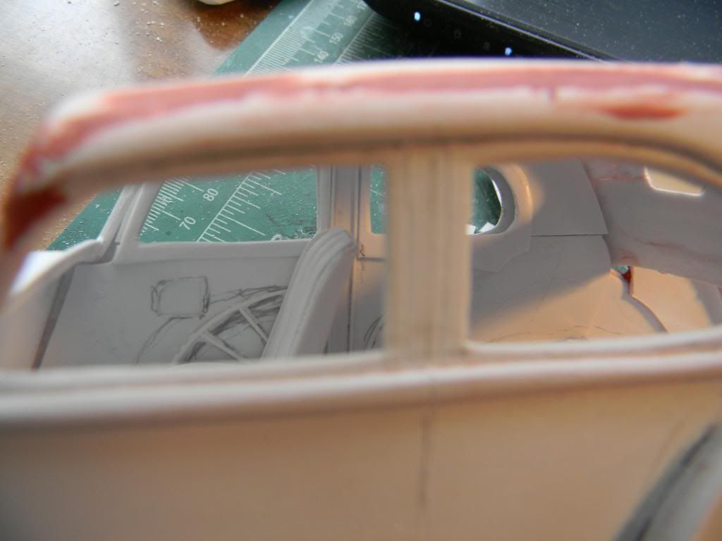

  • Full Name:Kenneth Borst

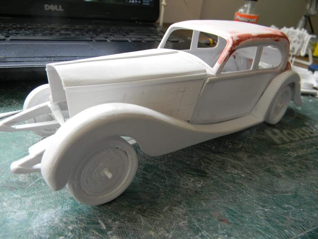

Posted 19 February 2013 - 01:31 PM
Temp wheels are on.Syance worked about right and jut needs some little tweeking.
Kenn
#70 Grant
Grant
    MCM Regular
  • PipPipPip
  • 58 posts
  • Location:Grand Blanc, MI
  • Full Name:Grant Powers
Posted 19 February 2013 - 02:40 PM
Holy moly! This build is incredible!
#71 GeeBee
GeeBee
  • 1,124 posts
  • Location:Solihull, England
  • Full Name:Geoff
Posted 20 February 2013 - 01:06 AM
Absolutely brilliant work, you certainly have some skills in bending and forming styrene ....
#72 kennb
kennb
  • 686 posts
  • Location:Minnesota
Posted 20 February 2013 - 05:39 AM

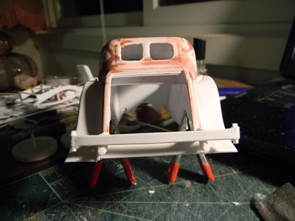

Thank you for the comments. I have been working on the chassis and have the fuel tank done and located, the rear jacks in place,(this car had built in jacks that woulf totally lift the car off the tires), and the rear floor pan in place. I also have almost 200 photos on my photobucket page that I have a link to below.
Thank you for taking the time to view my efforts.
link to additional photos
http://s126.beta.pho.../1936 MG Saloon
Kenn
Edited by kennb, 20 February 2013 - 05:40 AM.
#73 Davewilly
Davewilly
  • PipPipPipPipPip
  • 481 posts
  • Location:Surprise, Arizona
  • Full Name:Dave Wilmore
Posted 20 February 2013 - 10:09 AM
Man that is impressive!   Cant wait to see some more!
#74 kennb
kennb
  • 686 posts
Posted 20 February 2013 - 11:19 AM

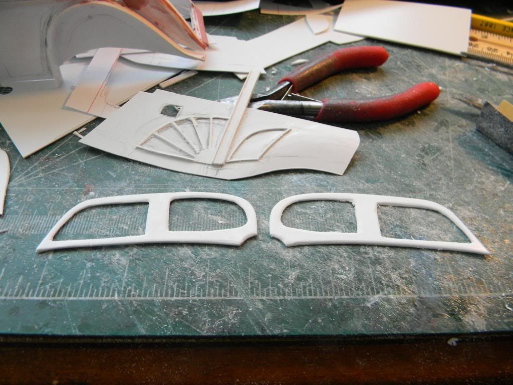

Some additional detail photos.
thank you for the comments and looking
Kenn
#75 W-409
W-409
  • 4,560 posts
  • Location:Vantaa, Finland
  • Full Name:Niko Lindström
Posted 21 February 2013 - 02:04 AM
Other's (Me) build what they can, but this guy definetly builds what he wants! B)  That is impressive scratchbuilding. I never had luck of bending styrene that nicely.
#76 kennb
kennb
  • 686 posts
Posted 21 February 2013 - 05:56 AM

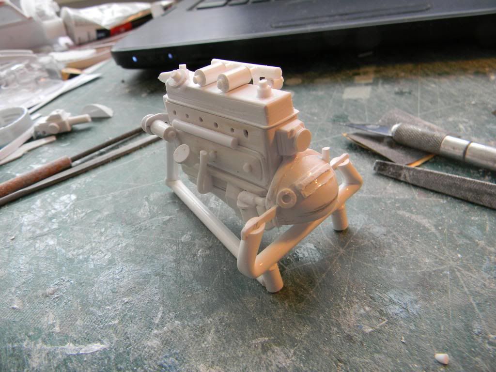

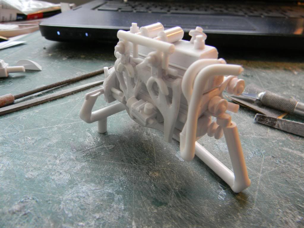

The bell housing has been formed by heating the plastic and forming with a bottle cap for the female mold and the handle to a exacto wood holder for the male mold.
I added some bits just so it is more interesting even though you probably will not see them on the completed model.
water lines have been added to the front also.
Kenn
#77 Ira
Ira
  • 3,627 posts
  • Location:Sonoma County
  • Full Name:Ira Dahm
Posted 21 February 2013 - 05:58 AM
Real Nice Work Kenneth!
B)
#78 Deathgoblin
Deathgoblin
  • 660 posts
  • Location:Columbus, OH
  • Full Name:Brian Wilson
Posted 21 February 2013 - 06:22 AM
This is amazing work.  The car is gorgeous.  :)
#79 the4thlord
the4thlord
    MCM Regular
  • PipPipPip
  • 32 posts
  • Location:India
  • Full Name:Gaurav Kapahi
Posted 21 February 2013 - 06:39 AM
THIS is what i call SKILL!!!
What a true artist you are!!!.... I'm absolutely AMAZED by this build!! :D :D
#80 kennb
kennb
  • 686 posts
Posted 21 February 2013 - 03:20 PM

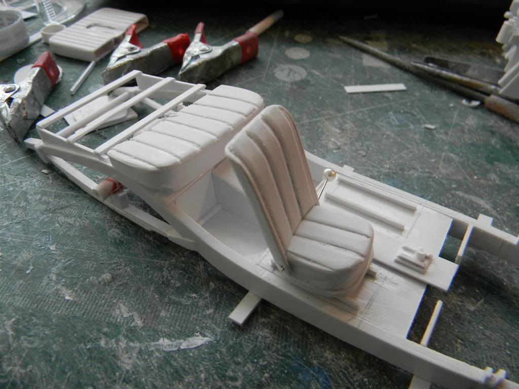

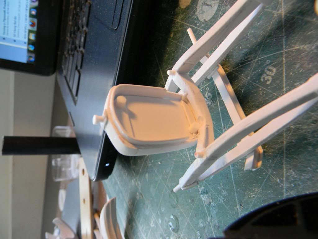

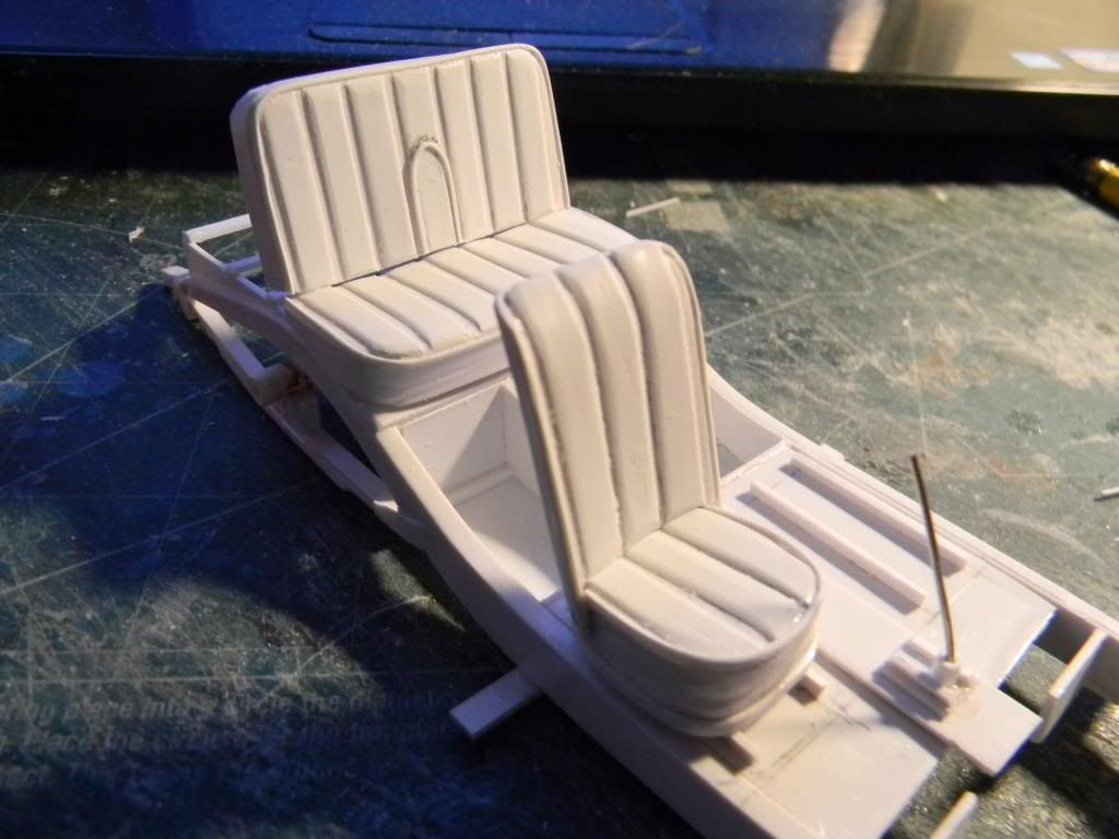

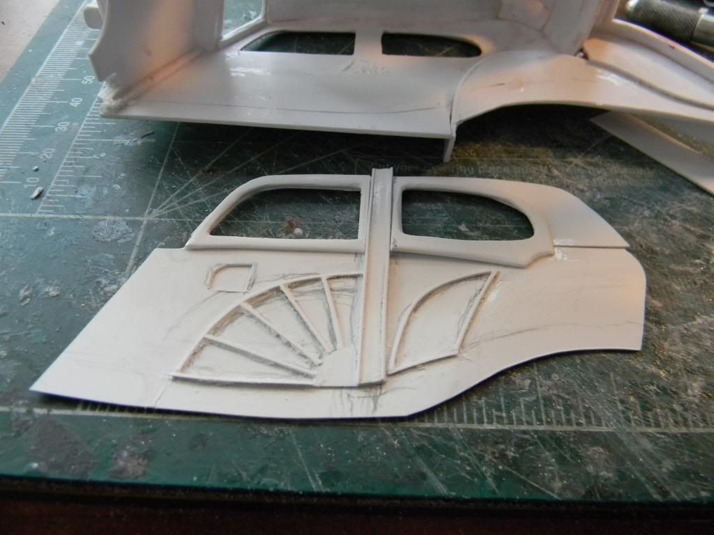

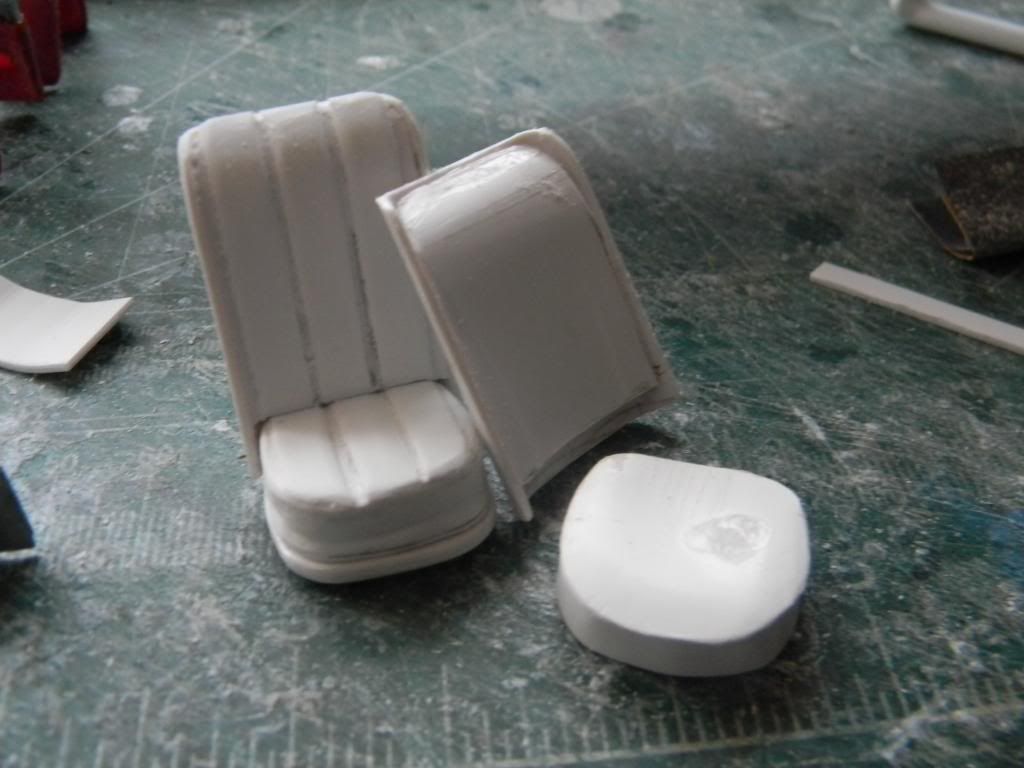

A quick shot of the interior start. The seats are all hollow heat formed backs and made with .40 and .20 plastic.
More to come on them. Seat tracks are in place so I came get the height correct.
Thank you for the comments and for looking.
I would put something in the scartch thread but since I scratch build everything and use no commercial parts.
I try to add progress pictures everyday the model is about 2 days ahead of the pictures.
I now have about 200 pictures on the photobucket link. I dont post all the pictures i have on photobucket.
Kenn :)
