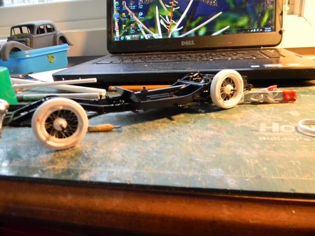

Sending the frame off to the paint shop today. Had to do a few last minute things. I installed the wiring harness to the rear lights to make sure all the fasteners were in place properly and all the holes were drilled to run it through the frame. The main body will go to the paint shop this week end for priming, maybe the fenders also.
That is the color of the wiring so it will show up on the black. Most of it will not be seen but to make sure it is right I ran the entire harness.
Thanks for looking and the comments :rolleyes:

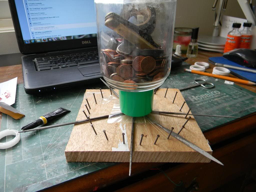

#133 kennb
kennb
  • 1,131 posts
  • Location:Minnesota
  • Full Name:Kenneth Borst
Posted 02 March 2013 - 05:37 AM
Paulo. Thank you for the kind words. :)  I am pleased that people find bits and pieces they can use.

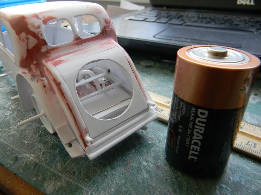

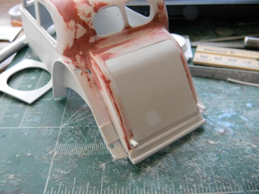

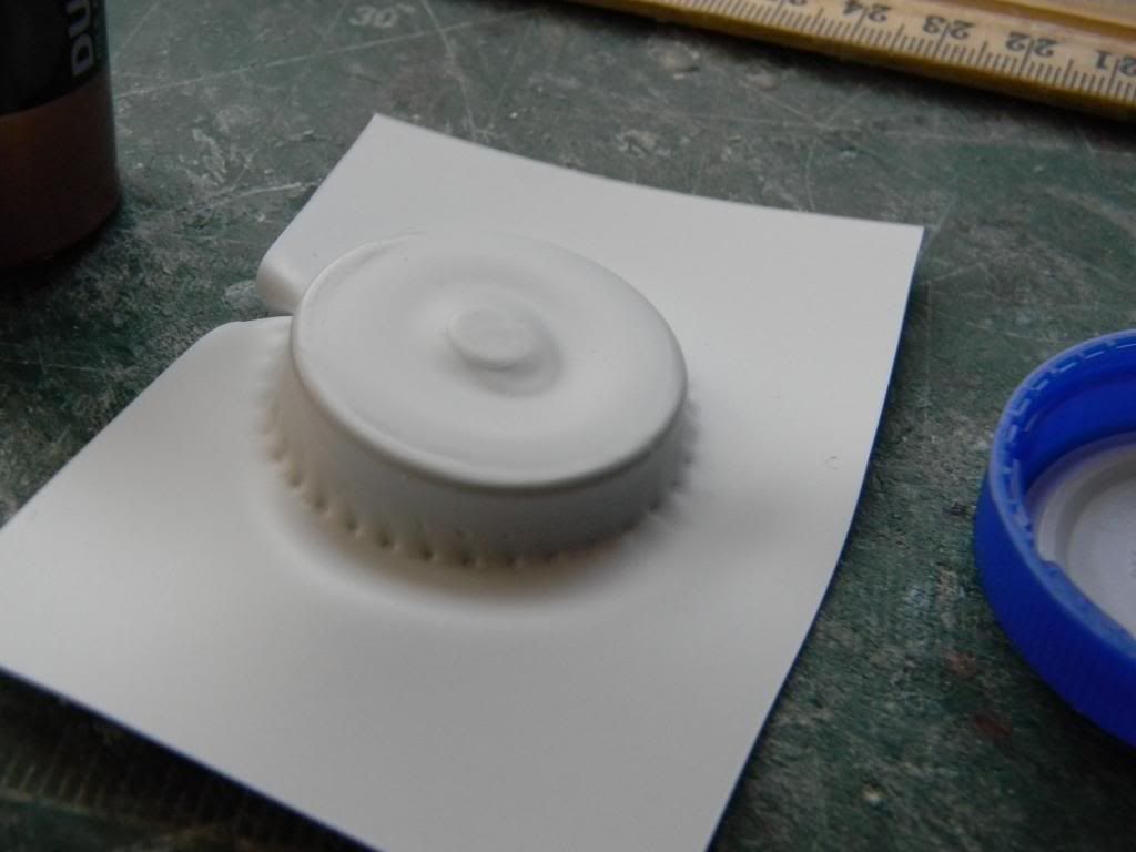

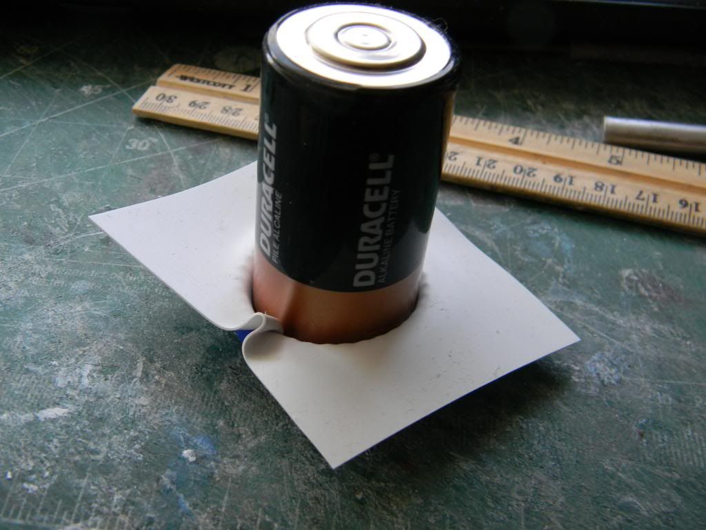

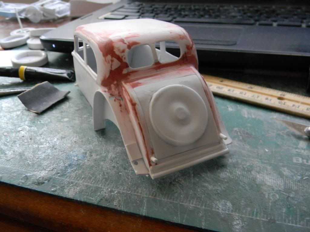

One of the things I do not mind doing is going back over parts of the model and redoing them to make it better as I go. I see things in the pictures and as I look at the progress and find things that I need to change, fix, or just do better.
The boot lid has been a thorn in my side since it never looked right and had a crack in it so I did it over. This time to make the spare cover more in tune with the size of the tires on the car I used a size D battery fo the male mold and a large bottle cap for the female mold.
You can see a fold on the side but since it is going to be cut off it does not hinder the final look.
A little sanding on the top left corner and we are good to go. <_<
Next time I will have part 5 of the history,,,,,,,,,stay tuned ;)
Kenn :rolleyes:
Edited by kennb, 02 March 2013 - 05:38 AM.
