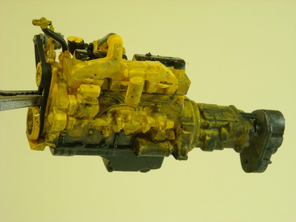

The upper parts of this engine have a black wash (cheap black acrylic paint thinned with water). The oil pan area is gloss black enamel, with some baking soda added in places. Hope you have fun weathering your engine.
