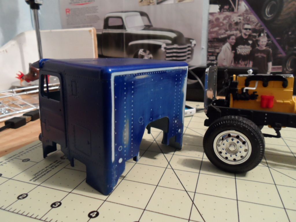

Anyone have an idea on how to get this cab and sleeper to line up so it can be glued together? Why its not a one-piece ill never know lol.

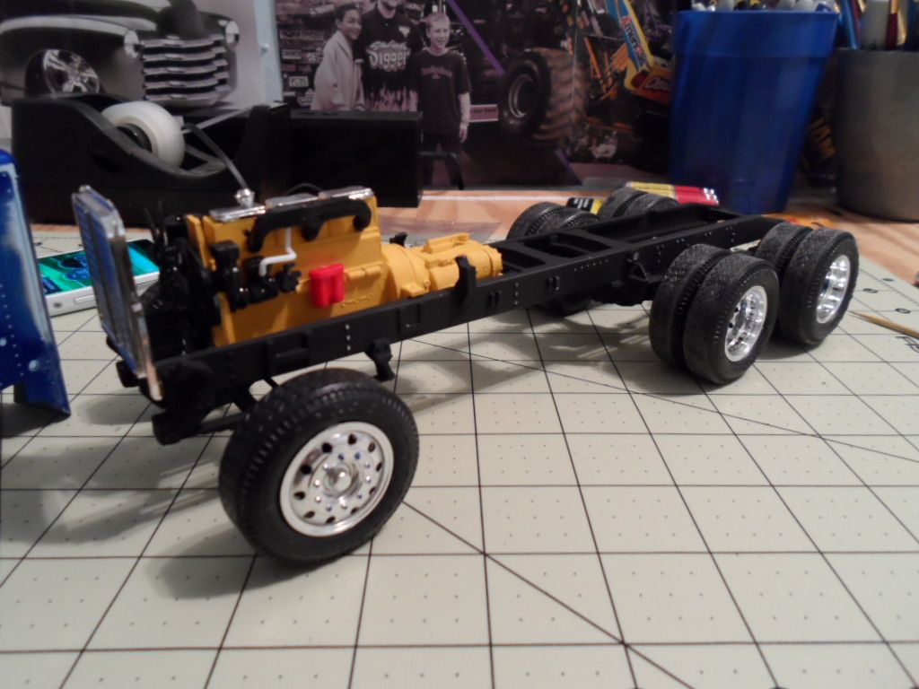

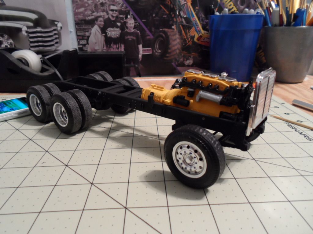

For some reason i cant get into my other account lol. Anyways here are a few update pics. I did have it painted Testors Star Spangled blue but I have to redo it since I glued the rear wall in after i painted it. And well it needed some work. But other than that its coming along
