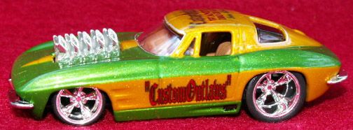

Here's a Black car with some of my Flame Decals that is ClearCoated using a little Emerald Green Pearl.
The Decals are hardly affected but the Black background suddenly changes completely to an Electric Emerald Green.

Here with the Purple version using Lavender Pearl Powder over a Black background,
And another Emerald Green Convention car I created,
A little Pink Flamingo Pearl in the Clear over Purple,
Shimrin Gold Pearl in Clear over HOK Tangelo Pearl,
You can see how the Pearl show more intense at different light angles,
The same Gold Pearl in Clear over Tangelo Pearl combination showing how the colors shift,
HOK Zenith Gold and Limetime Pearl ClearCoated with a drop or two of Pagan Gold Intensifier and Aztec Gold Pearl Powder,
Silver Competition Stripes and HOK Strato Blue, Cleared with a couple of drops of Oriental Blue Intensifier and Electric Blue Pearl Powder.
