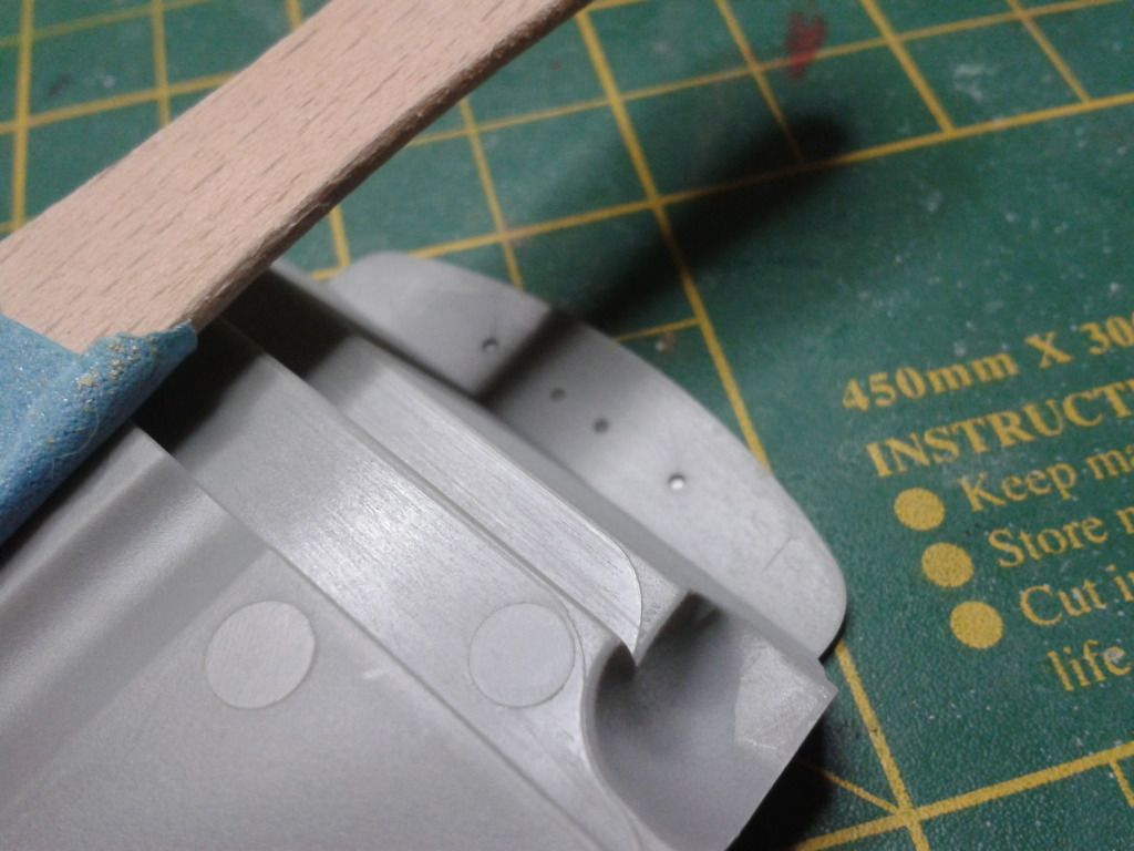

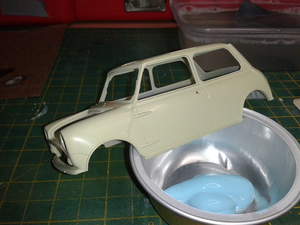

As always, I started with the body, not sure why, but I've always done it this way, one thing I noticed on the body was a moulding line on both front wings, the L/H side was slightly worst, and the line goes through the panel line that goes through the front valance and also goes around the top of the wings by the headlamps, it didn't take long to remove with a sanding stick, then smoothed out with a finer sanding pad.
Before
After
That was the worst part of the body and apart from just cleaning off a little bit of flash, the body is pretty good, there's a lot more mould lines to remove on the Tamiya version

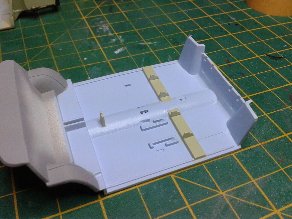

After removing the bonnet and roof from the parts tree, and getting ready, I started on the engine, which goes together real well, I've left of certain parts until the engine has been sprayed green
Although it tells you to fix in the engine first then fix on the inner wings, the Tamiya version has these moulded as part of the floorpan, I dry fitted the inner wings in place then tried to fix in the engine, which it did without any problems, so the inner wings and bulkhead were fixed into place, it will make painting a little easier and will of course look better

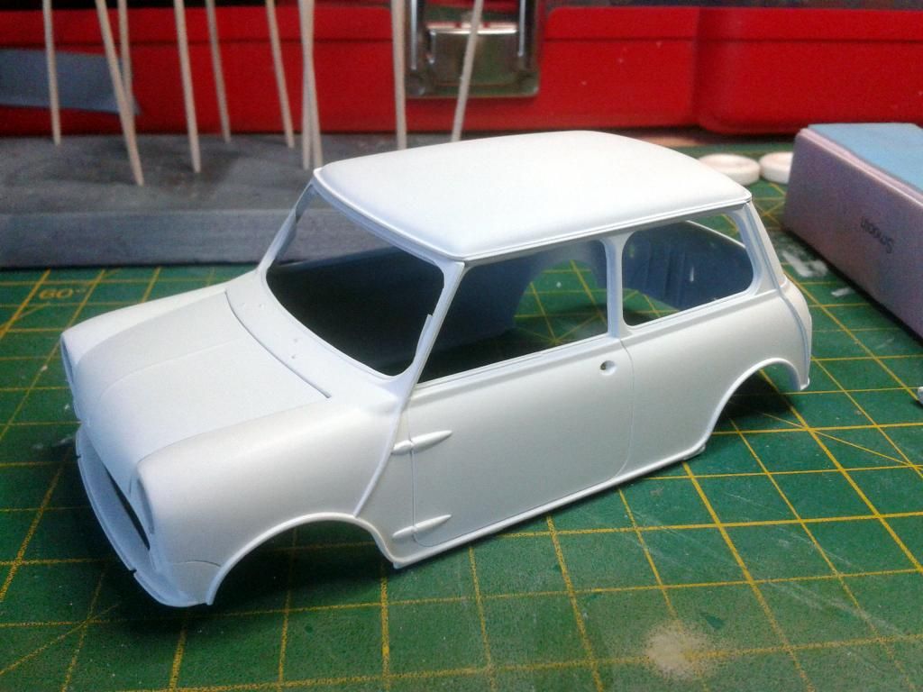

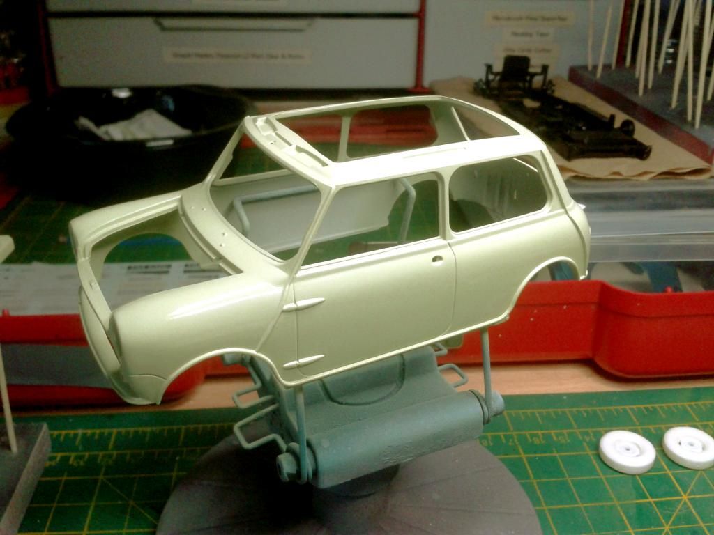

Got the body parts in primer this morning, a bit of block sanding this afternoon, and then I managed to get them in body colour, it will be left for a few days before getting wet sanded and polished up
Edited by GeeBee, 19 February 2013 - 08:46 AM.

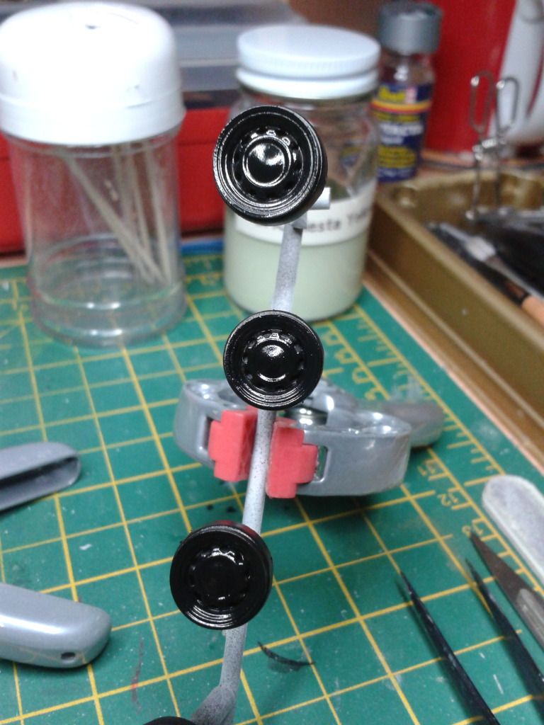

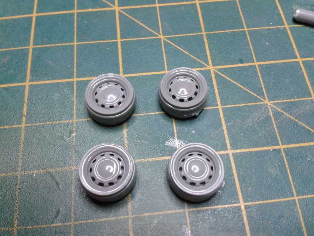

A little more progress on the Mini, the wheels were stripped of there chrome, as I think the chrome looks a little thick and of course the originals were made of polished stainless steel, so they were soaked in household bleach for around 20 min's, and then rinsed under cold running water, they were then primed, and then given a couple of coats of gloss black lacqer ready for the Alclad.

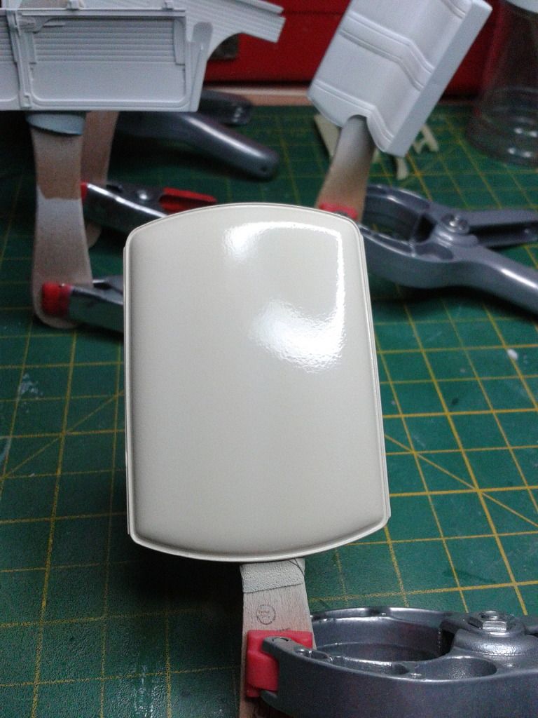

The roof panel was airbrushed in Old English White lacquer, it will wet sanded and polished out before painting the gutter rail in body colour

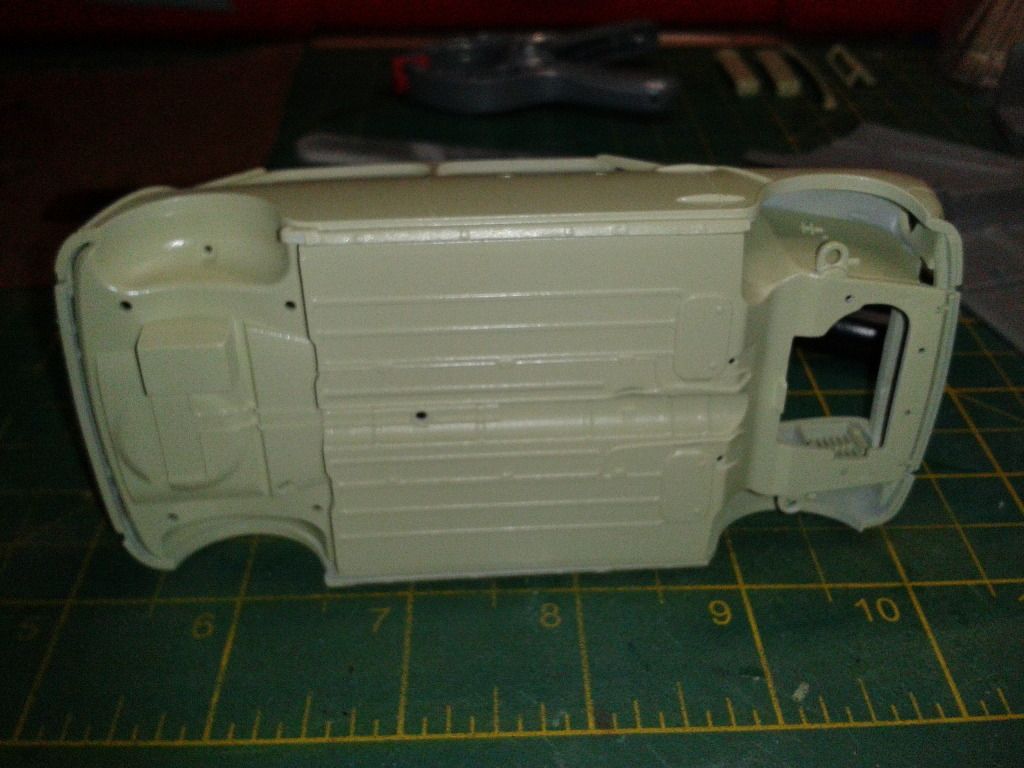

Now that body has had a bit of time to dry off, I thought before I do any polishing and then the BMF for the chrome trim, it was a good idea to see just how well the body and the chassis fitted together, as after building quite a few of the Tamiya versions, which can be a little tricky in getting the two together without a lot of bending etc, well I can report that the Revell version just falls together, there are two locating tabs at the front, but everything lines up absoloutely perfect ...

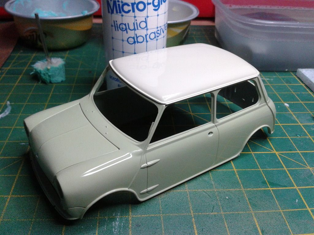

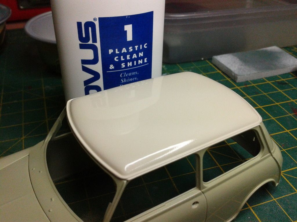

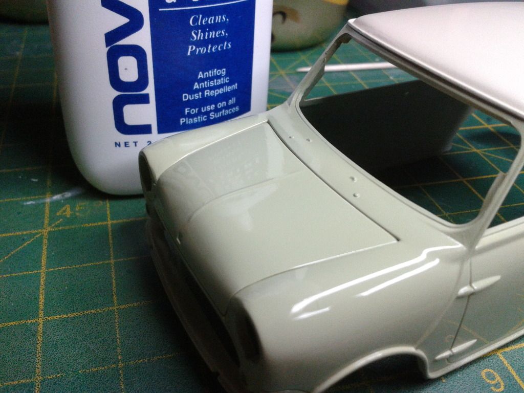

Did a little more to it today, the body, roof and bonnet got wet sanded, and then machine polished, followed by a hand polish, then a wipe over with Novus # 1

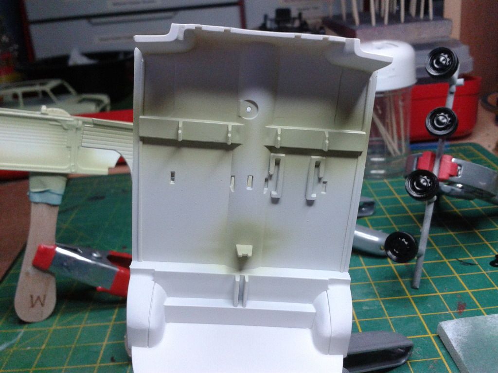

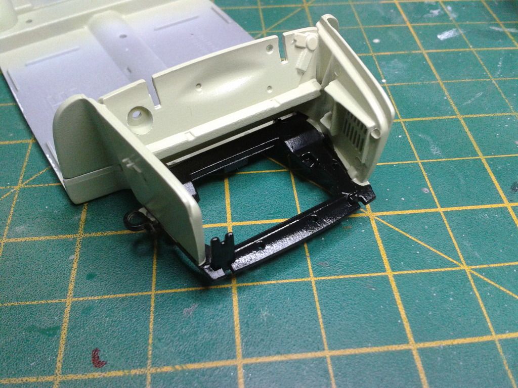

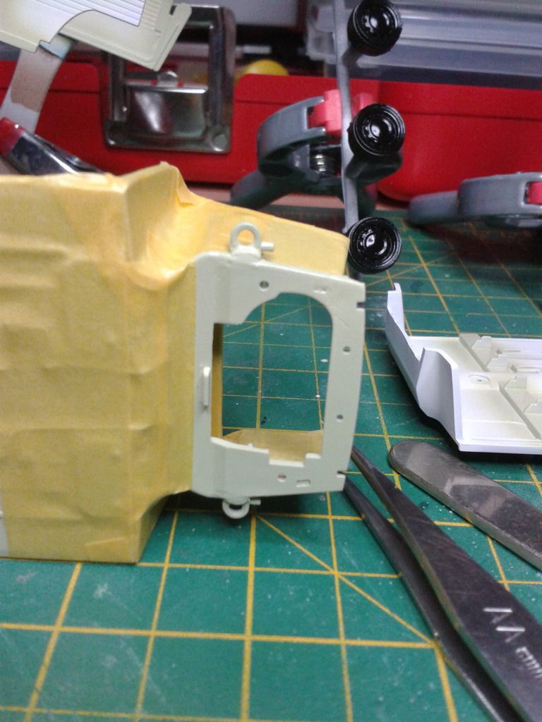

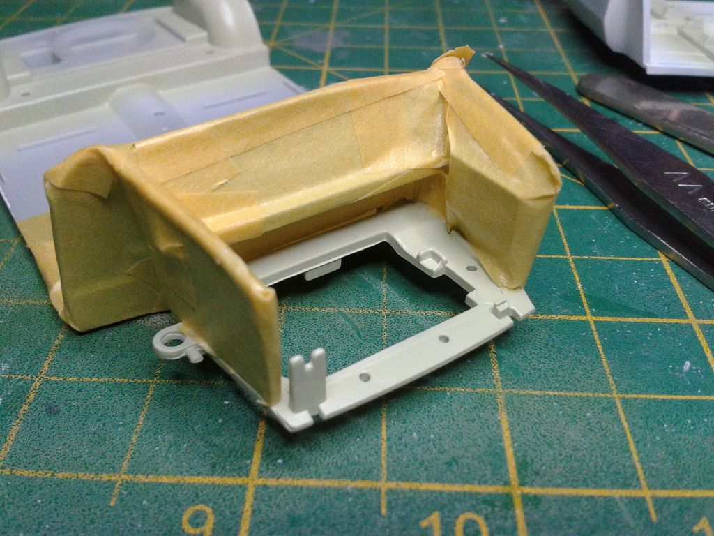

Not a great deal done today, as I had to do a bit of grocery shopping, then a visit to see Mom, but a little bit of masking, so I can crack out the airbrush tomorrow.
As I had built the front end up, and not follow the instructions, it needed masking as the base would be the subframe on the real thing, and these were black, or that's the colour they started off at, a few months, and they were usually covered in engine oil ....

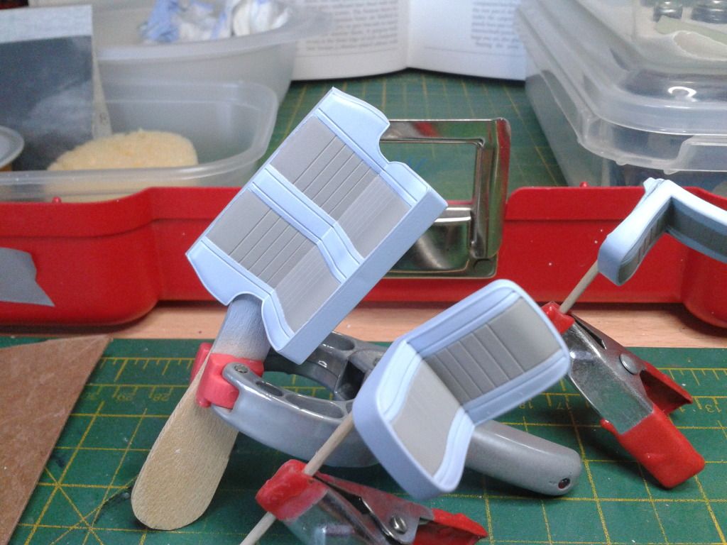

Also got the interior panels masked up ready for the light grey

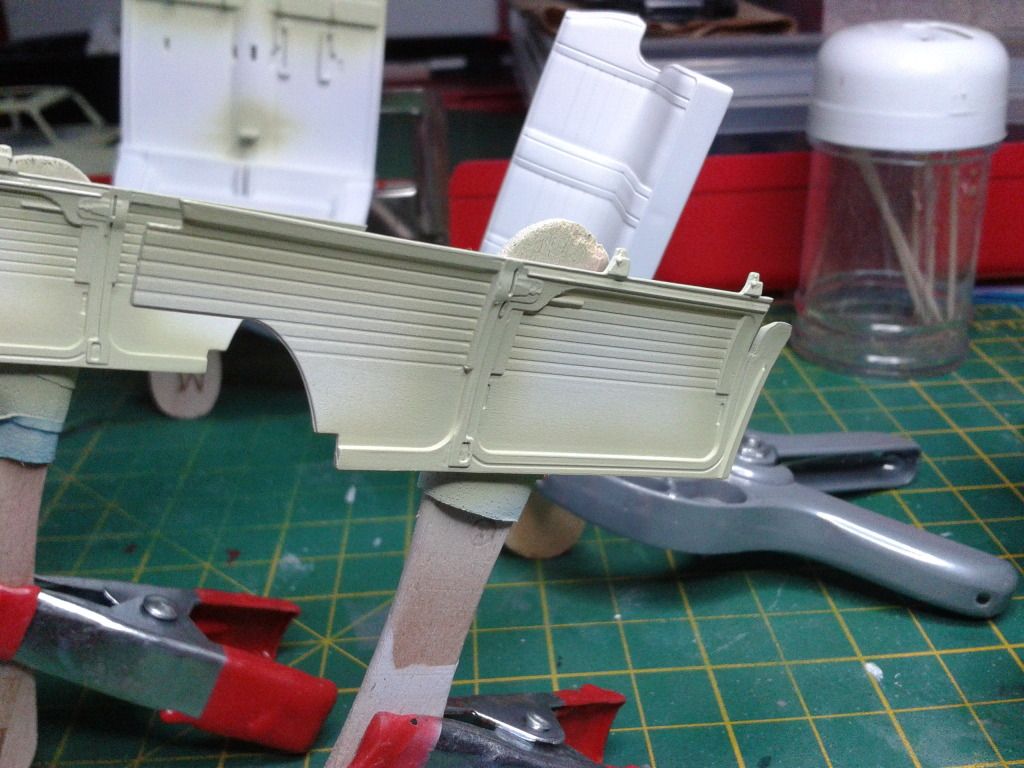

Got the parts airbrushed yesterday,
2013-02-26141818_zpscc251f59.jpg?t=13619
The interior was painted using acrylic artist paint, thinned to use through the airbrush

This build is looking good Geoff. I like your idea of using artists' acryclics - are they quite durable or do they need some clear over them?
