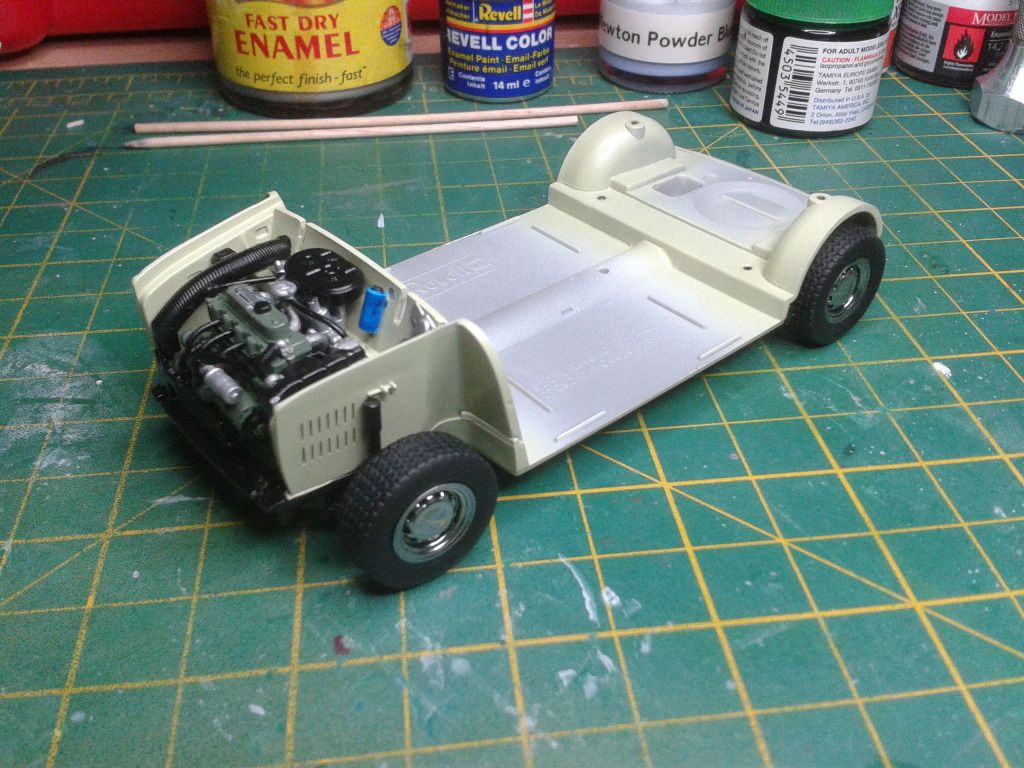

Today I decided that it was about time that the interior was built up, the cubby boxes were fixed to the side panels, the front door boxes have a couple of locating points for the boxes to fix into, the rear one's don't, but it's a simply job to fix them on, as they follow the shape molded into the side panels, a few drops of 5 minute epoxy along the sides and bottom and clamped into place and left to dry.
Once they had dried, the side panels could be fixed to the floorpan, they fix along the front edge, along the bottom of the floorpan and at the rear around the wheel arch trim and a small tab at the side of the rear seat backrest, 5 minute epoxy and a few clamps held all the parts together while the glue dried, once the clamps were removed the seat belts were fixed in, there is a small locating point at the bottom of the seat belt and also at the top of the side panel, a few drops of Cyano' glue at both points and the seat belt was simply put into place, there are some black decals to go over the decals, but looking at my reference material and my memory of the Mini back in the 60's, at least in the U.k, the seat belts fitted at the time would have been a silvery grey material, and not grey, so they were airbrushed with a mix of matt aluminium and grey, the mounting points were picked out using chrome silver fast drying enamel.
The next small item that needed detailing were the window locks, they were simply picked out with Revell semi gloss black enamel, the only thing to fix into place now was the dashboard, but this still needed finishing off, the clocks were fixed into place, the chrome trim that goes above the dash padding was picked out using chrome BMF, the switch panel was picked out in flat grey and a decal fitted that replicates the heater controls.

Got the dash fitted, a simple job, it's fits into tabs located at the top of the side panels, almost didn't need any glue, the fit was that good, also got the BMf applied on the wheel arch trim and sill trim ...

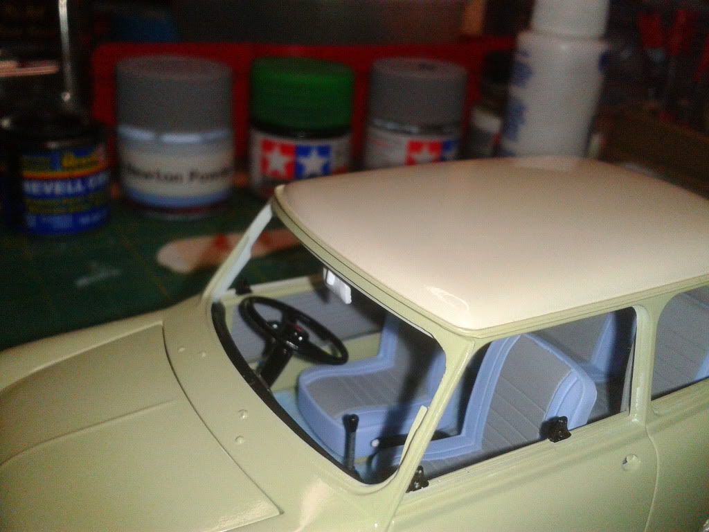

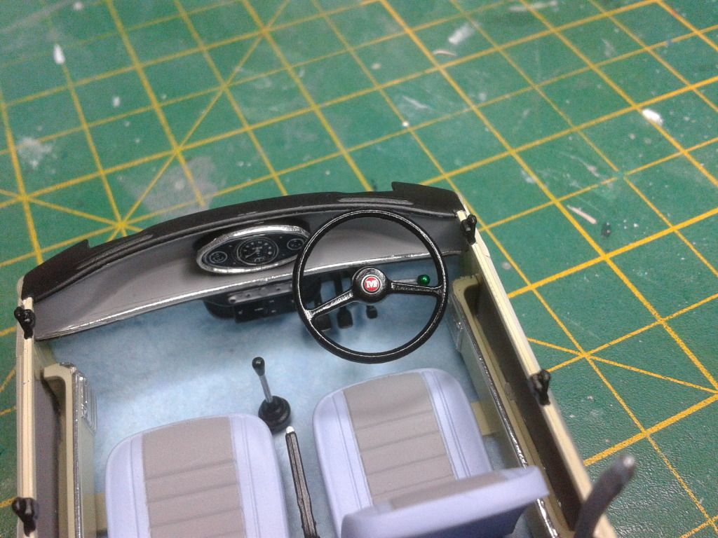

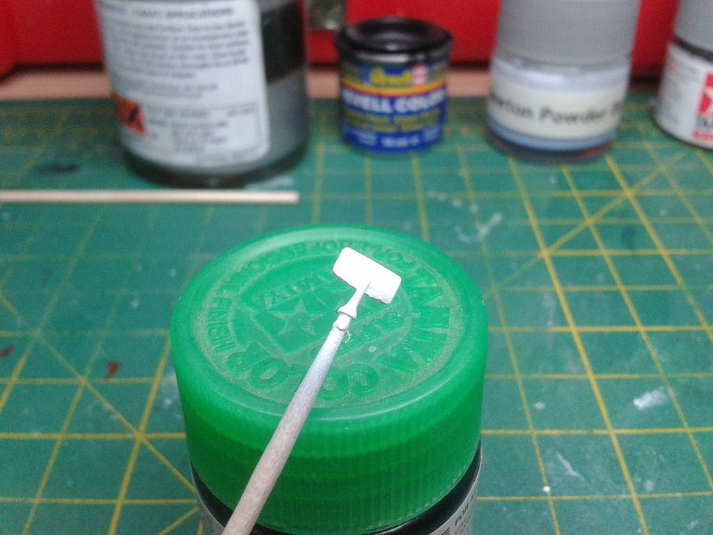

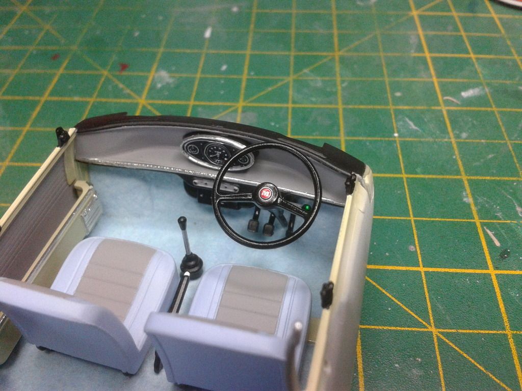

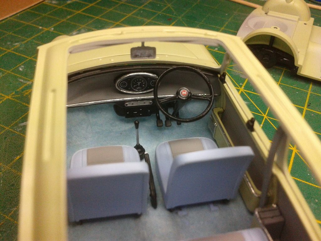

For the time I have spent in the hobby room today, it really doesn't seems like I achieved a lot ... got the steering wheel and the column fitted, painted the rear view mirror flat white, the instructions say to paint it satin black, but BMC changed them to white plastic in the autumn of 1964, also masked the body up to paint the interior matt white, took longer to do the masking that it did to actually paint it ...

dont you love those ejector pin marks? at least they are a little inconspicuous up on the headliner...but right next to the molded in sun visor!
great build by the way, i just always get bitten by those dumb pin marks too.

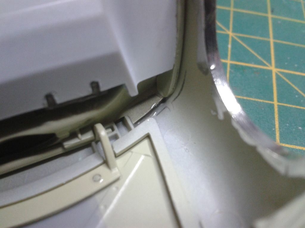

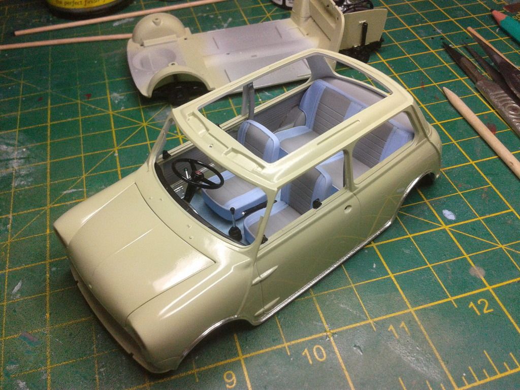

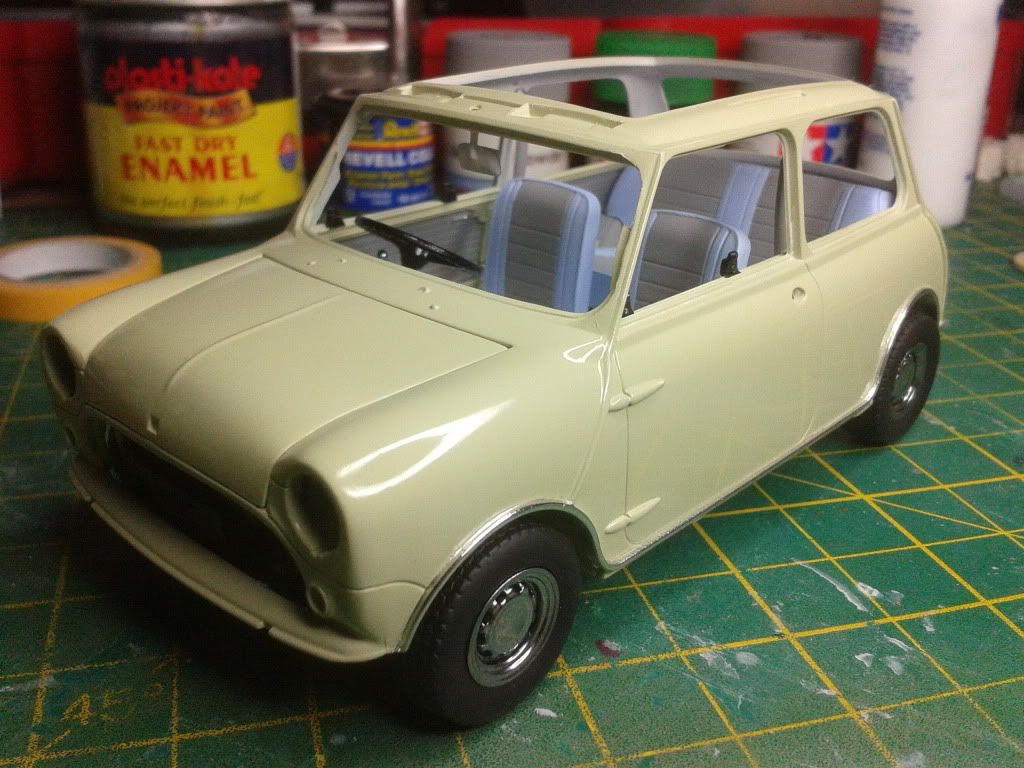

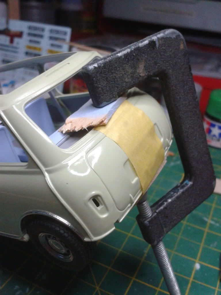

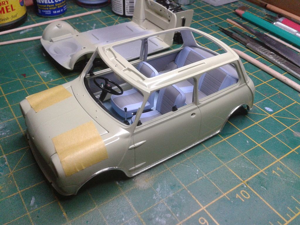

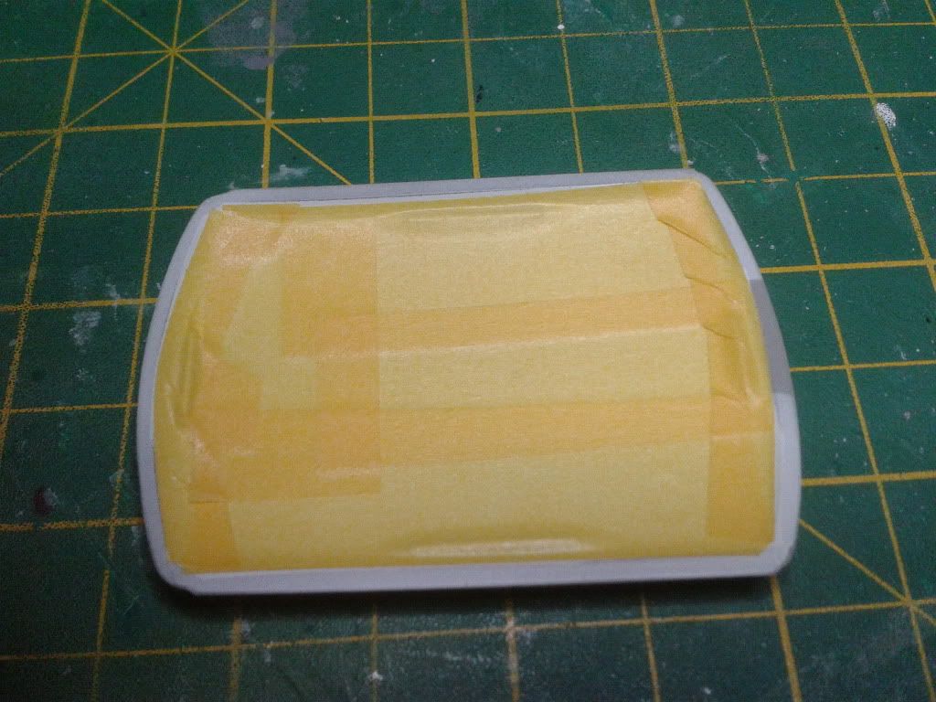

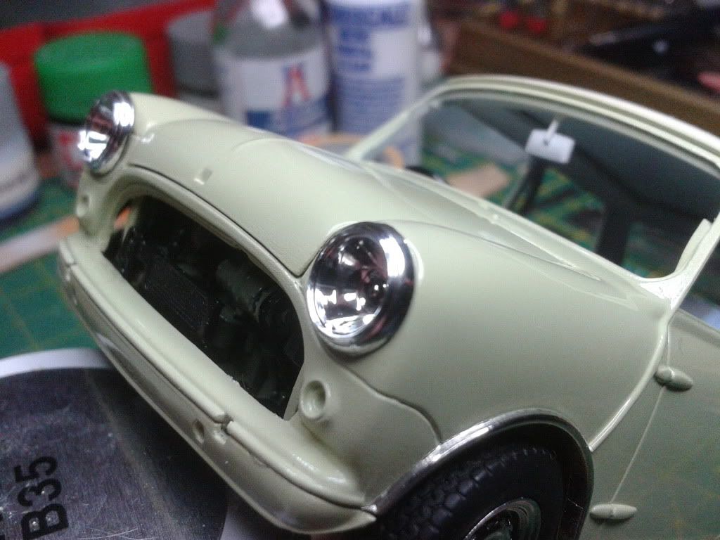

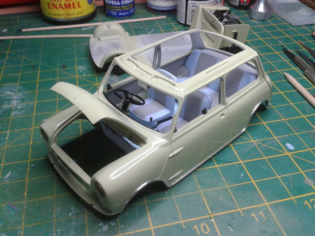

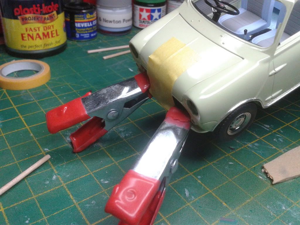

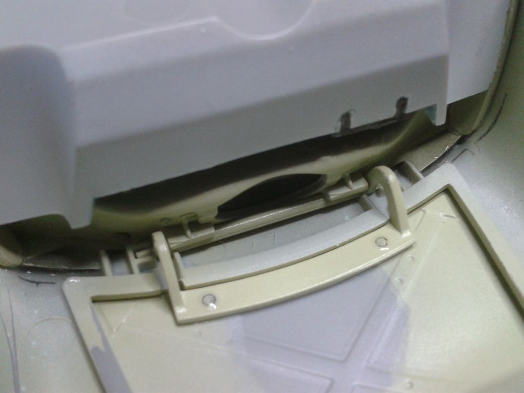

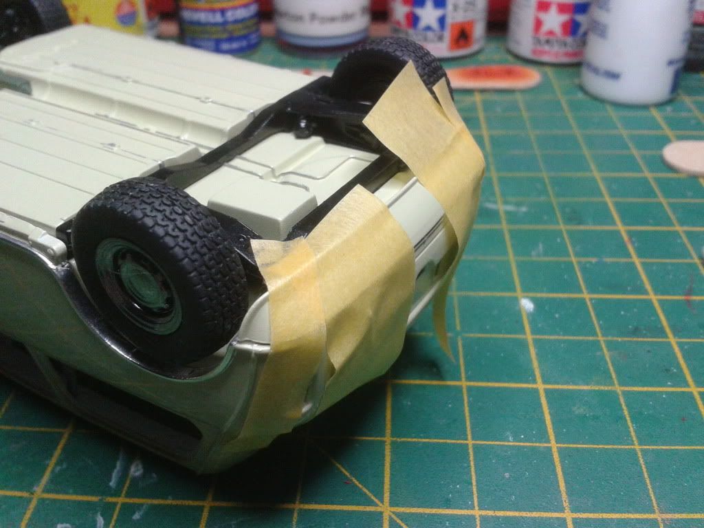

Today the interior mirror was finished off  using a small piece of BMF to replicate the mirror face, then the mirror was fixed onto the inner roof panel, before the interior goes in the bonnet needs to be held in place by a couple of pieces of masking tape, then you can turn the bodyshell over and fix the bonnet hinge into place, the only part that needs glueing into place is the part of the hinge that fixes onto the bonnet itself, the other side of the hinge is held into place by the interior pod, before commiting any glue to hold the interior into place, as always I did a dry run, and made a few marks on the inside of the body using a pencil, this gives me the locating points were the glue needs to be applied, with the interior in place (without being glued) I tried the chassis/floorpan to see if everything lined up, luckily it did, so the chassis and the interior were removed and a few spots of 5 minute epoxy were applied to the marks I have marked out with the pencil,the interior was now fixed into place permantly and held in place while the glue set, once the glue holding the interior into place had dried, the masking tape holding the bonnet into place was removed, one nice thing about this version of the Mini, is the bonnet can be opened and the way the hinge is held into place, the bonnet stays open on it's own ...... Looking inside once the interior fixed into place, the dashboard lines up perfectly with the bottom of the front window sill, Revell have really worked hard engineerring this model to fit together so well.

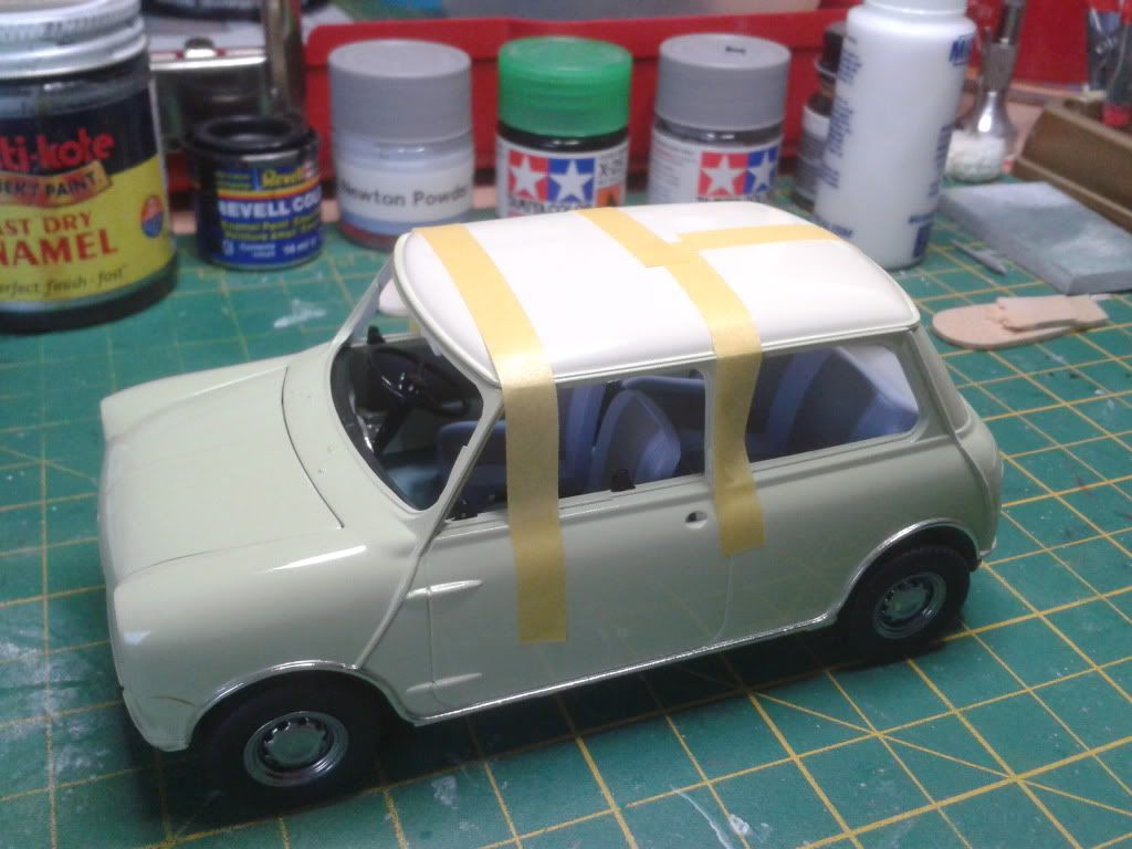

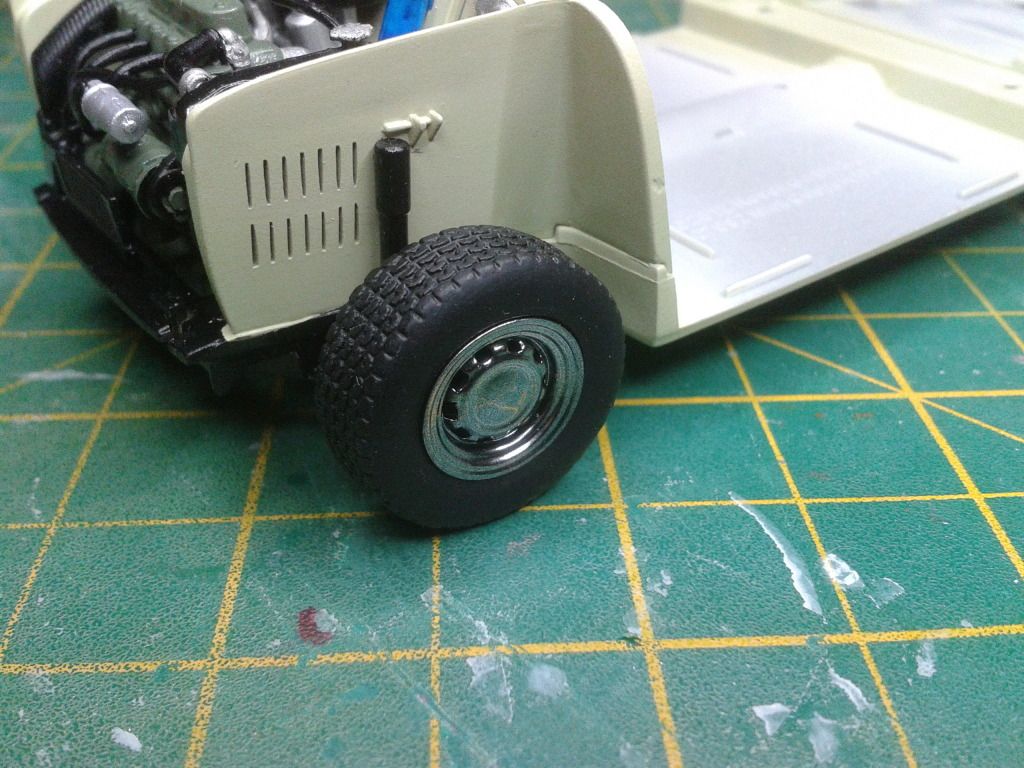

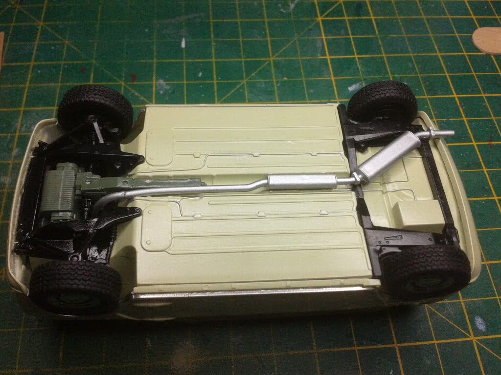

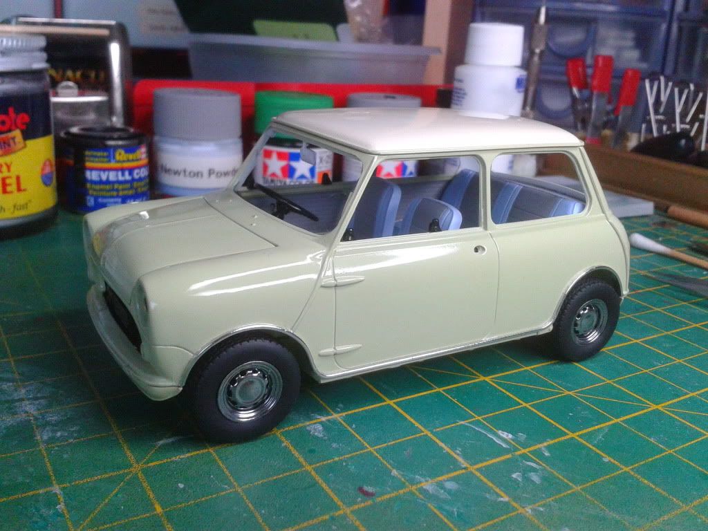

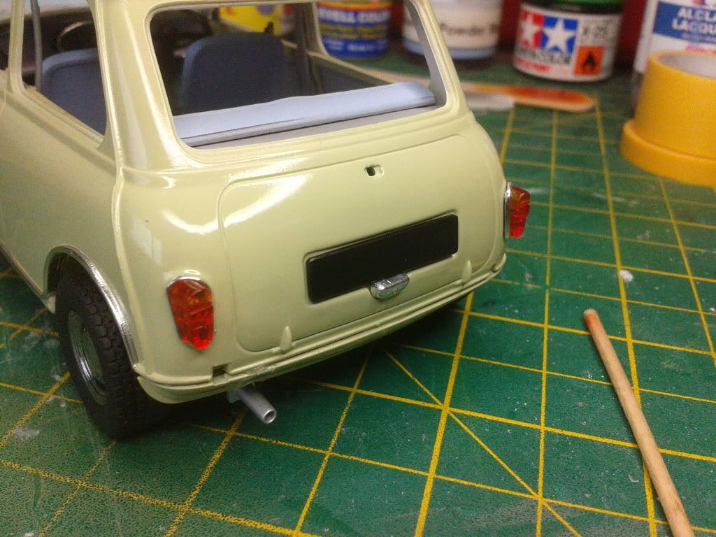

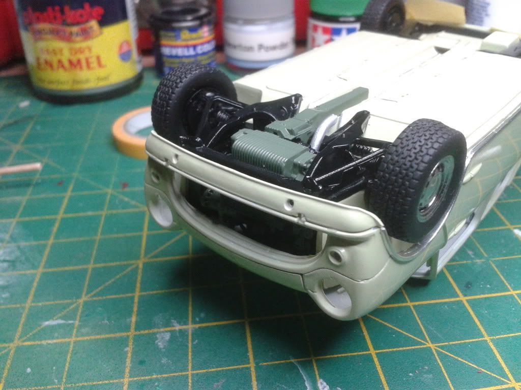

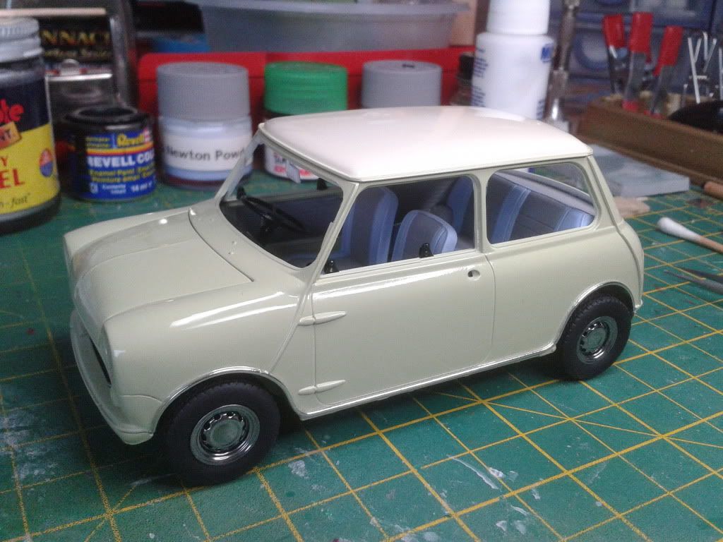

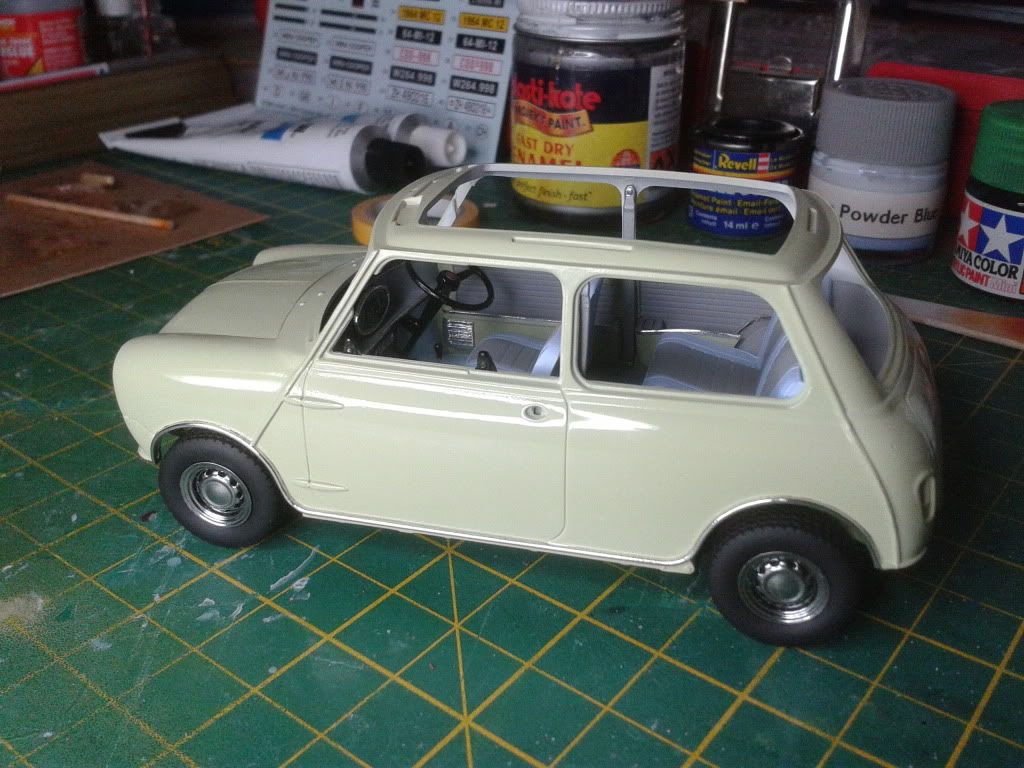

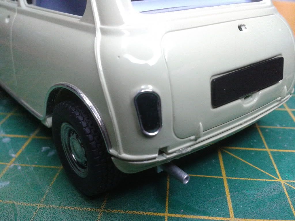

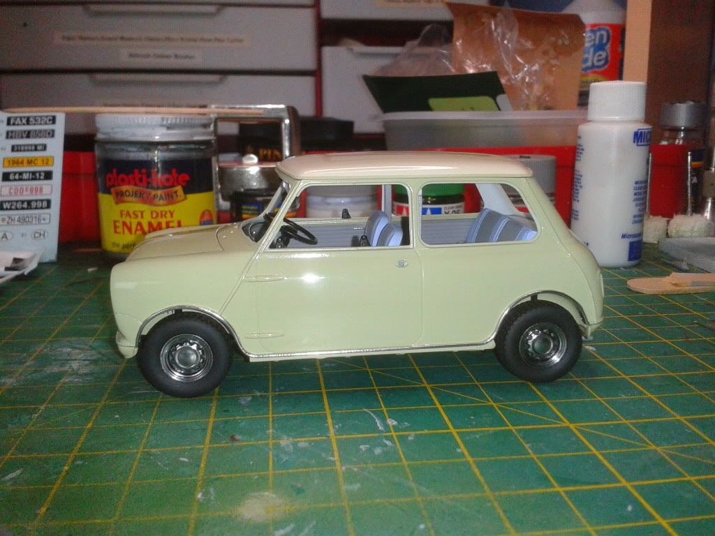

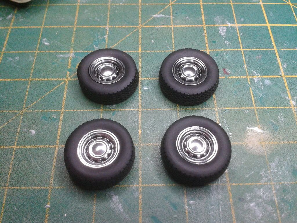

Got the wheels and tyres fitted before I finished in the hobby room, the tyres are a great fit, I'm pleased with the way the Alclad went on, second time lucky, used 5 minute epoxy to fit them to the axles, and I was pleased to see that all four wheels sat on the floor ....

Looking very nice. I really like the colors you have chosen.

The green on the interior now looks good ... with the interior mounter in the car. :)
#58 GeeBee
GeeBee
  • 1,120 posts
  • Location:Solihull, England
  • Full Name:Geoff
Posted 19 March 2013 - 01:59 AM
It's powder blue, not green
#59 Foxer
Foxer
  • 5,608 posts
  • Location:The Berkshires, Massachusetts
  • Full Name:Mike DeRagon
Posted 19 March 2013 - 02:27 AM
I meant the green "metal" trim on the interior sides. It seemed weird with the blue interior when sitting alone.

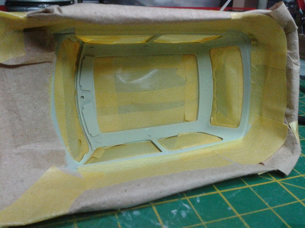

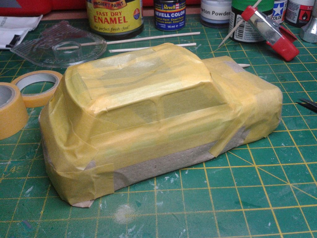

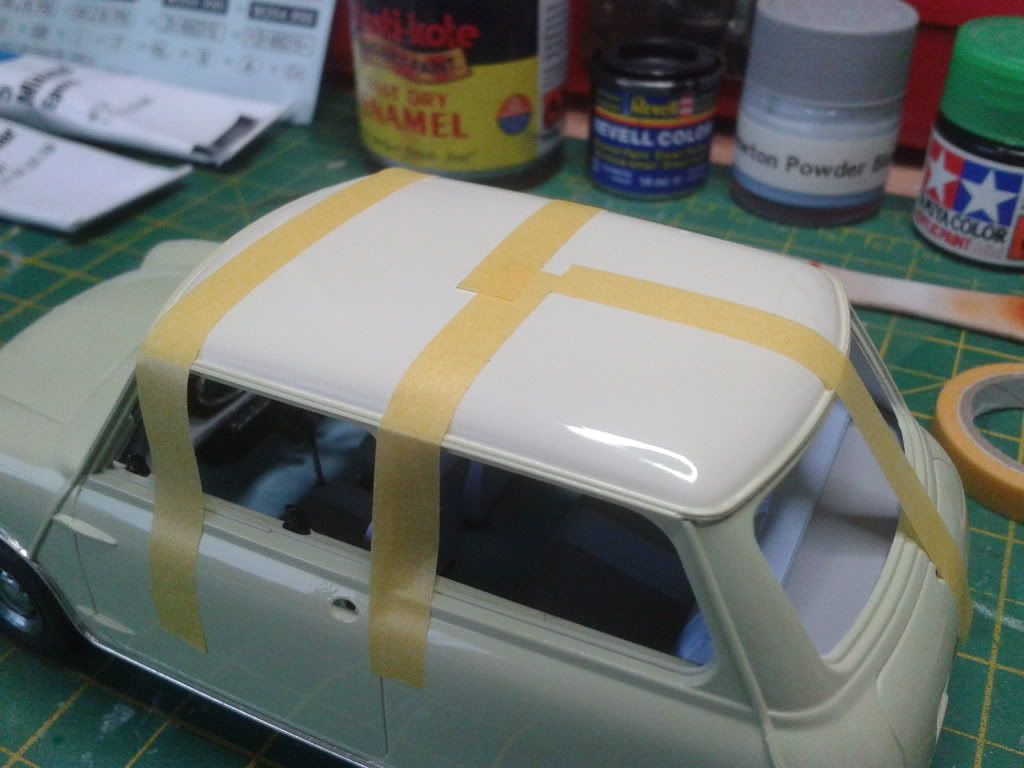

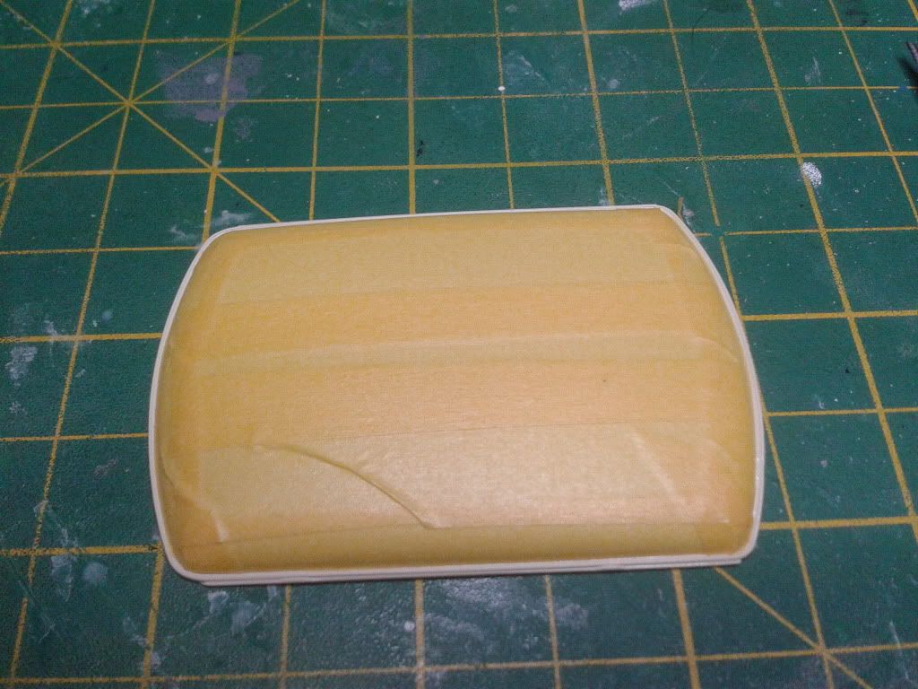

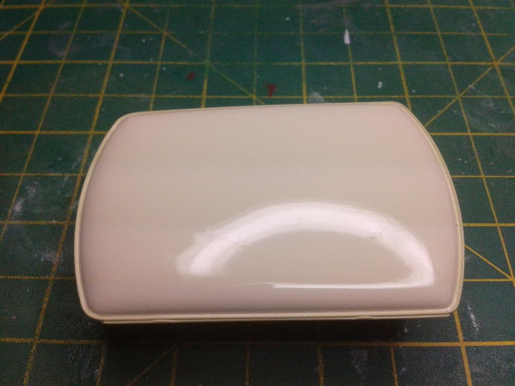

I was surprised that you painted the inside of the body after everything else.  I usually do the inside first and then mask the inside so the window areas are uncovered - that way there isn't a build up of paint along the edges when the tape is removed.
