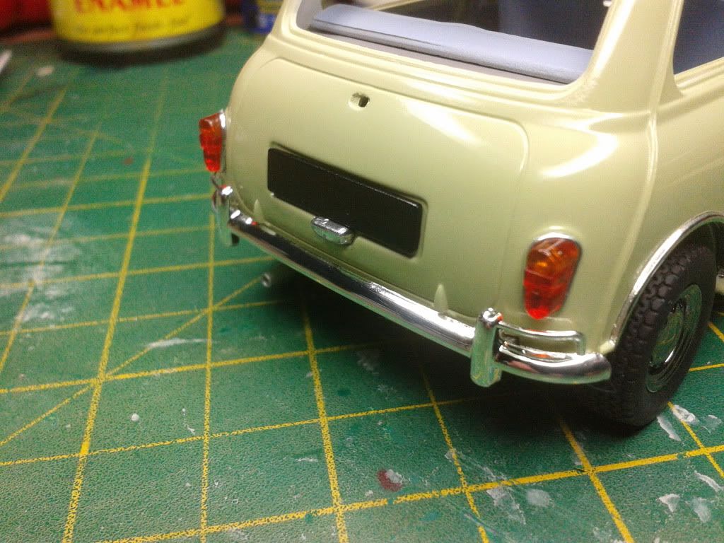

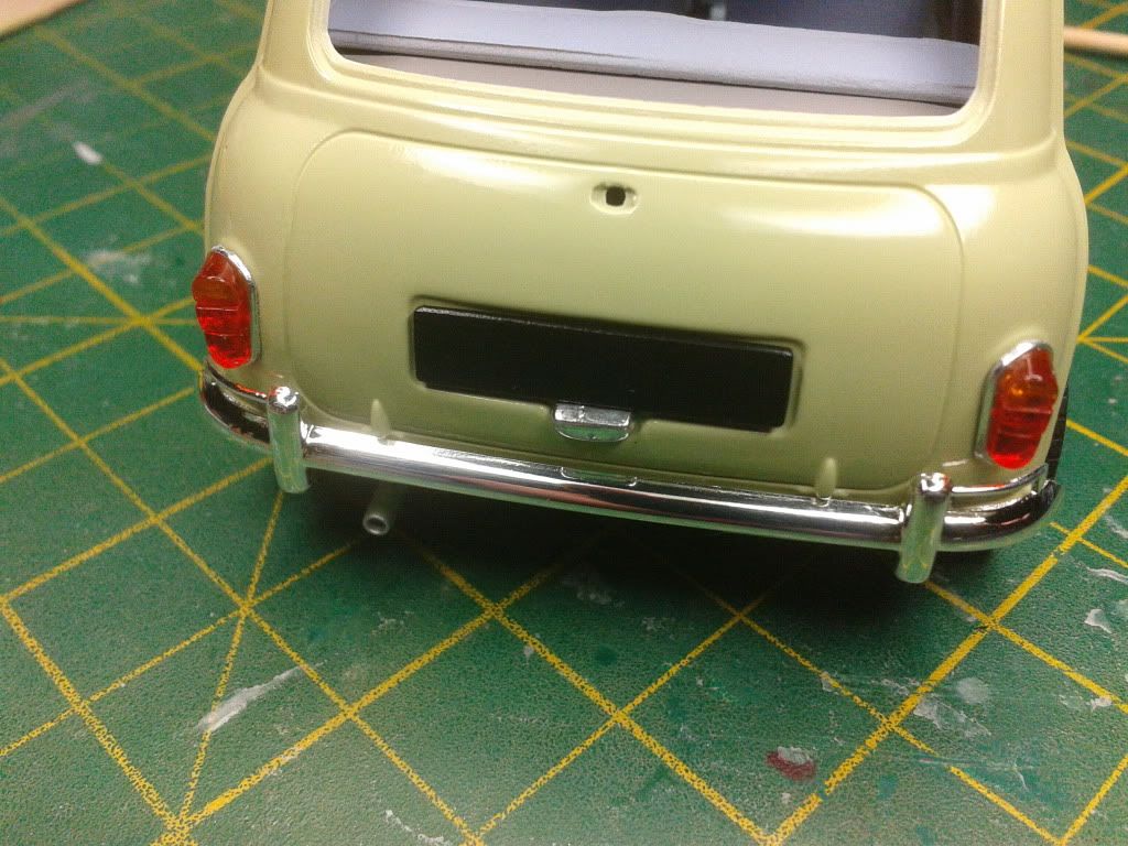

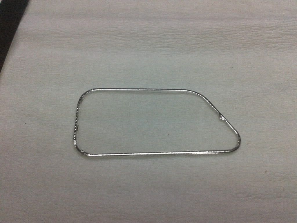

Not a great deal done today, but after watching the F1, I did a little bit, cut the chrome lamp surround off the sprue, touched up the marks where they were cut off the sprue with a little Alclad, and fixed them into place, on the Tamiya version, the chrome ring around the rear lamps are part on the lens, and are a PITA to cover with BMF, the Revell version is totally different, the chrome part goes onto the body then the lens fixes onto that, leaving the chrome ring showing, also gives the lens a chrome backing making the lenses look a bit more realistic.

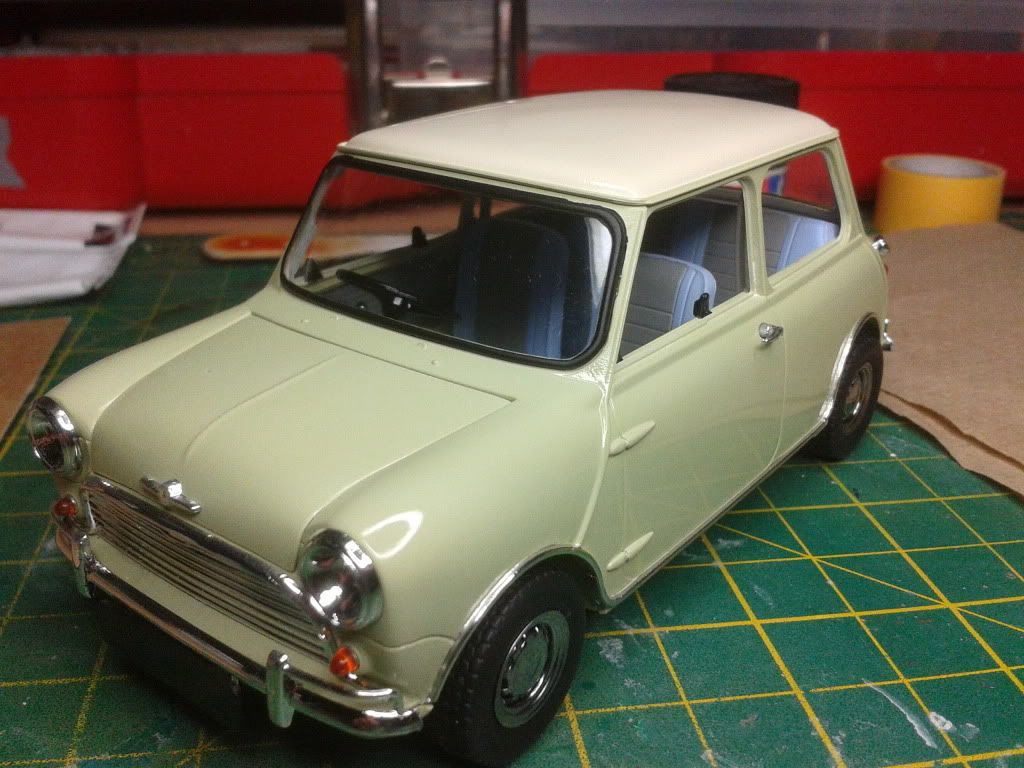

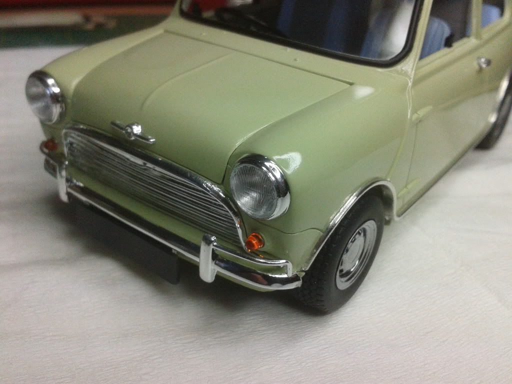

Got the rear lights fitted today, plus the rear number plate light and front headlamps, apart from the number plate lamp which needed it mounting tab trimming down a little, everything else fitted fine.

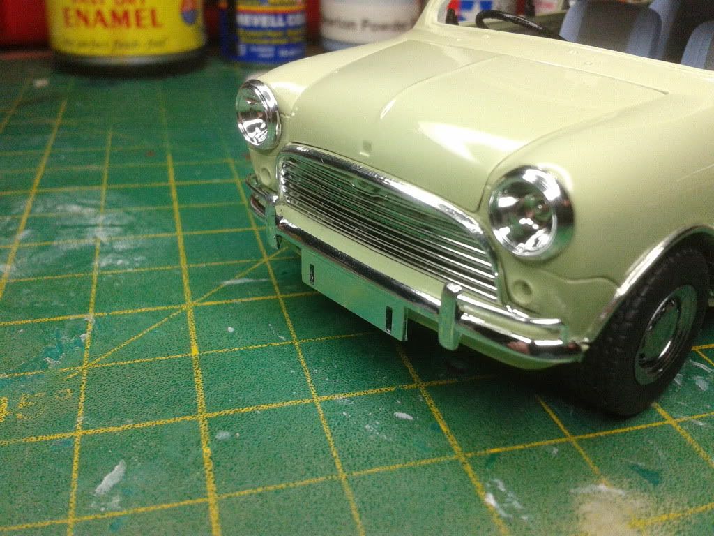

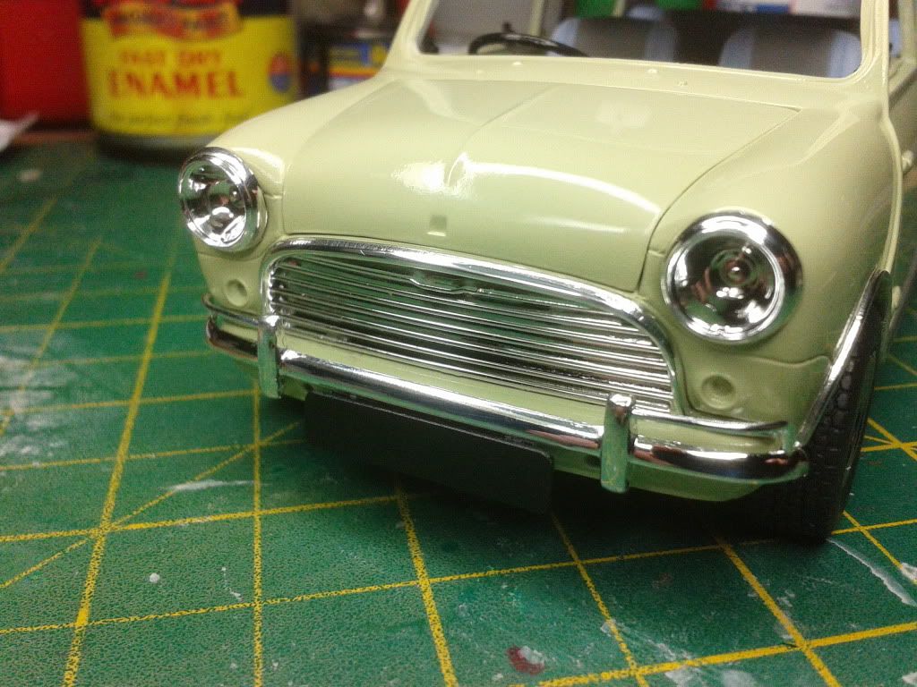

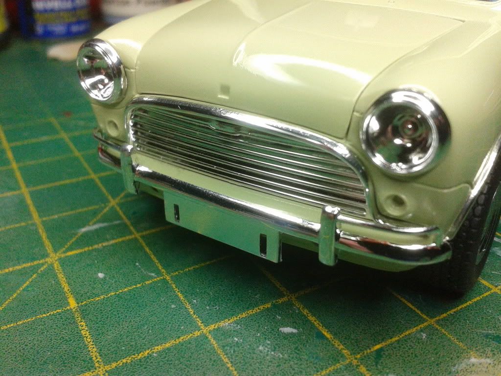

Well I got a little more done today, one of my pet dislikes is model companies putting the chrome parts on the sprue where you are going to see the cut off mark once it's removed from the parts tree, Revell are guilty of this with there chrome parts, the front grille is fixed onto the sprue in 6 places, 3 of them are right on top of the grille, so a small piece of BMF was cut to size and burnished down, you can just about see if if you look hard, the only other way would be to strip the chrome and redo it using Alclad, but the quality of Revell's chrome in the kit is pretty good, there was the same problem with the front bumper, four cut off points, two right on top of the front overiders, again BMF came to the rescue, luckily the rear bumper is only affixed by two points, and both of them at the bottom of the bumper, I did cover the marks with BMF, but your not going to see them .....
Another thing I like about the Revell version is that the grille extensions are cast as part of the front grille, where was the Tamiya version they are molded into the bodyshell and are very fiddly to cover in BMF.

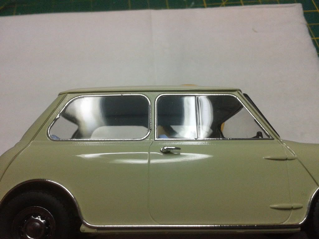

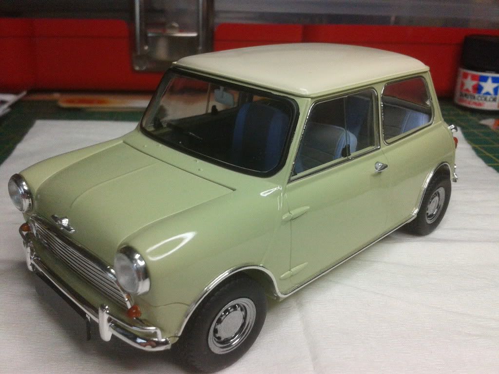

I got quite a bit done today, got another day to myself tommorow, so should have this finished very soon .... got most of the smaller chrome parts fitted, the bonnet badge was a simple job, as was the rear boot handle, the door handles were a little tricky, the chrome needed scraping off the mounting tab, but once cleaned off they fitted just fine, also did the chrome trim around the front indicators and fixed them into place.

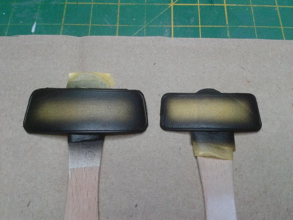

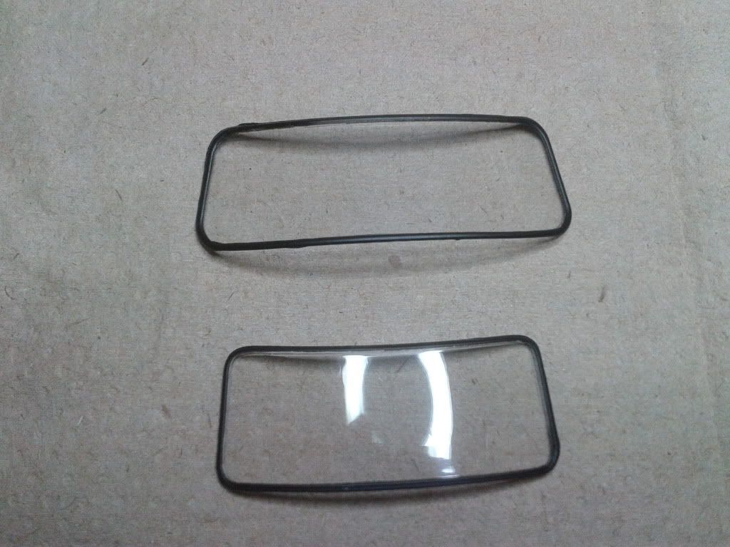

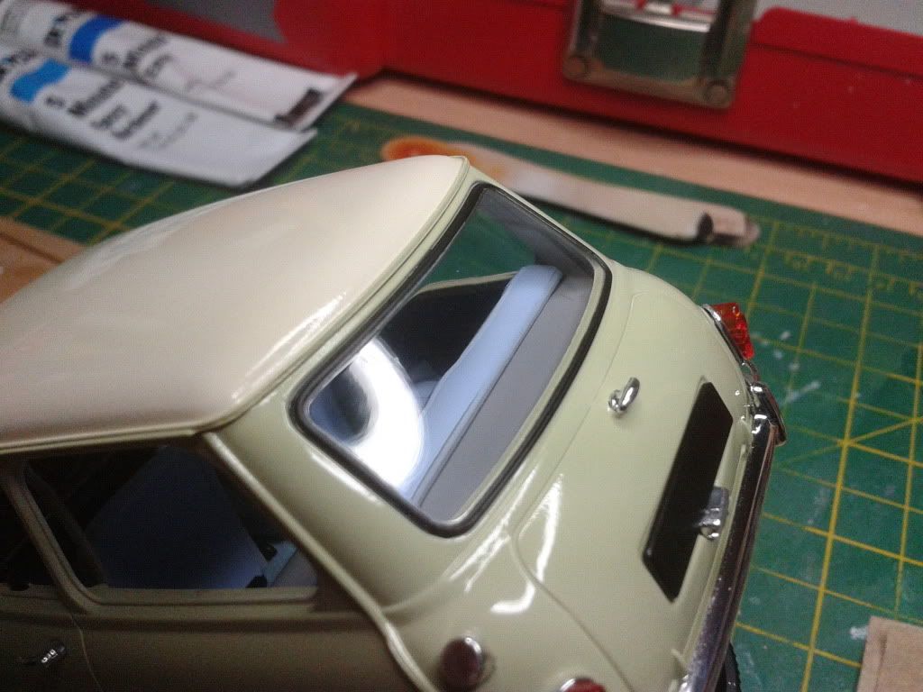

The front & rear screen needed masking off as the rubber seal is molded as part of the windows, they were masked off using Tamiya 18mm tape, and airbrushed using Tamiya semi gloss back, they were fitted into place as soon as the paint had dried, using 5 minute clear epoxy

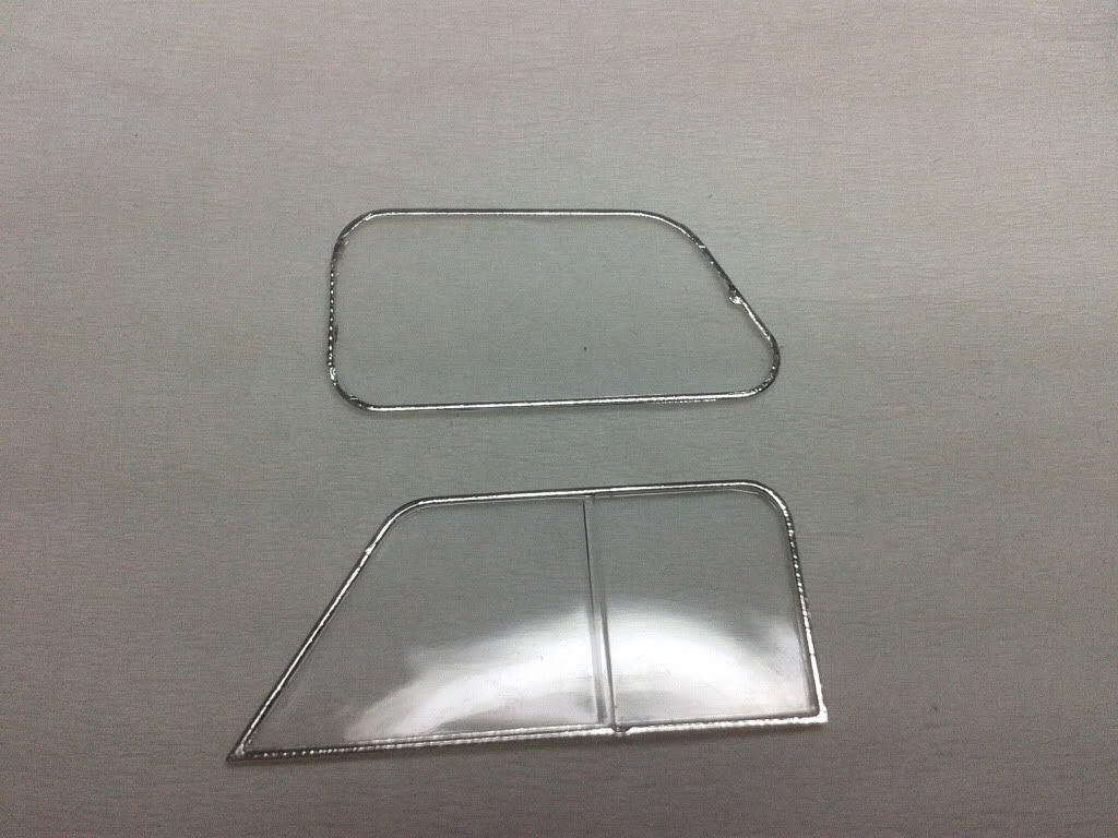

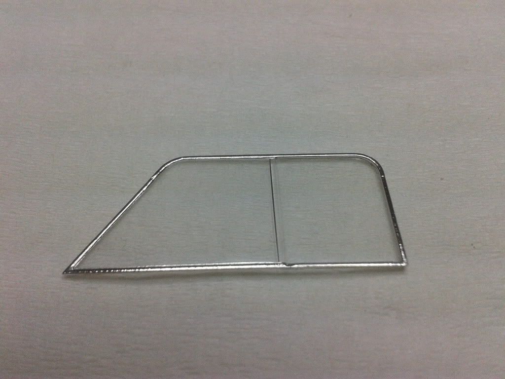

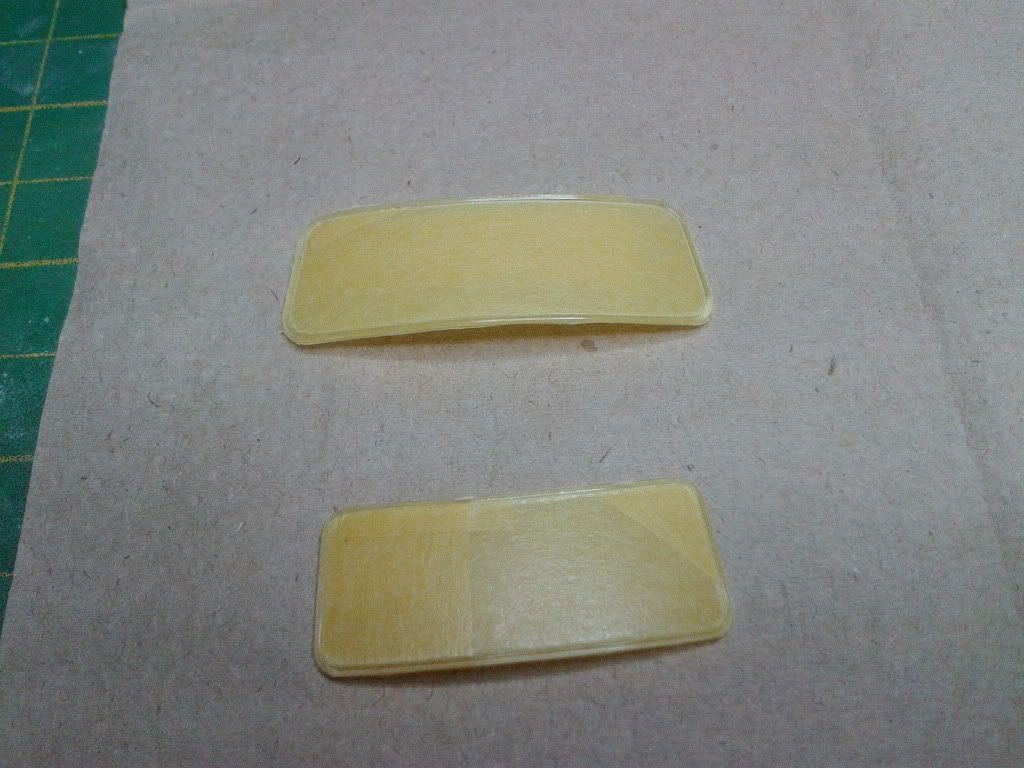

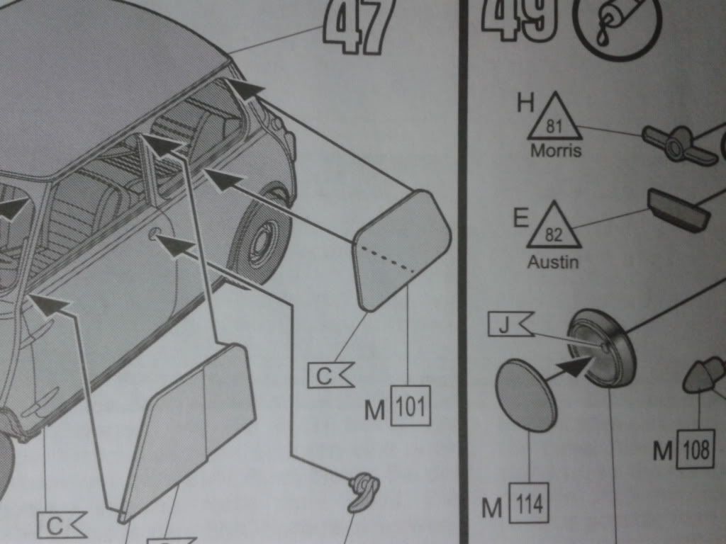

Before I finished for the night, I took the time to remove all the side windows from the parts tree, as they need the molded in frames covered in chrome BMF, but doing a dry fit revealed that the instructions are slightly wrong, as they should part # 101 being fitted to the left hand rear side, it doesn't fit as you need to use part # 99, and use part # 101 on the left hand side
