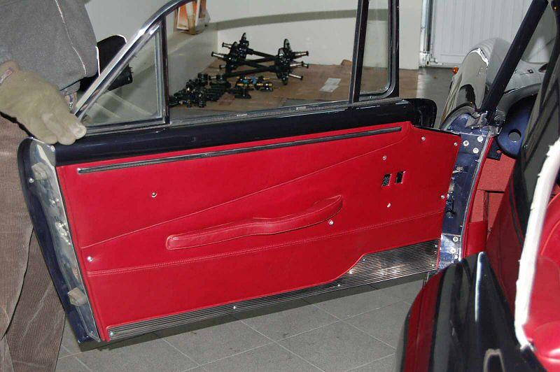

Just a little preview of what's coming up with the kit interior (I'll also get shots of that from my built-up reference model), the kit's steering wheel projects out too far from the dash at a straight angle, and the seat backs and bottoms are about half as thick as they need to be, which looks very odd.
Door jambs on the body and on the doors need to be chrome. Speaking of doors, the hinge arms will snap off easily, simply by looking at them.
PS: it's not just the door hinges that can snap, this is an old kit with VERY brittle pieces and cannot stand an ounce of pressure anywhere, trying to line things up. You can also easily snap off the wheels. NOTHING can be forced.
Based on that pic, more likely to be polished aluminium - that's what is used on the Superleggera bodied Astons.
The seats are seriously anemic, and they'll certainly need those BIG metal side braces/hinges as well as bulking up the bolsters and backs.
They look like the Keiper / early Recaro recliners as fitted to quite a few European cars in the '60s such as Ferraris, and even Volvos, so depending on what level of detail you want to add, they could be made functional....
 - Polished aluminum in the real world, chrome in the model world.

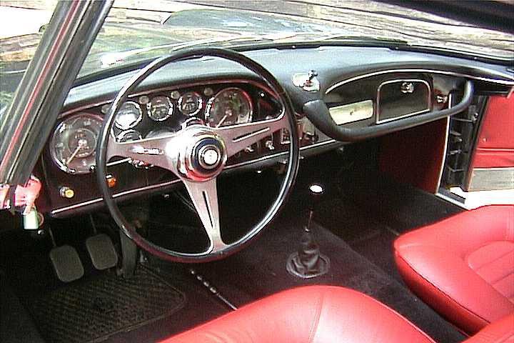

- I have pictures of all the Jaeger gauges, but the kit is so small, I don't know how you'd use them. Let me know what you need. I have the Aurora and Monogram kits but no decals.
Attached File  Picture 11 copy.png   691.73K   32 downloads
This is the most typical seat hinge design, which can be either on the outsides only or both inside and outside of both seats. Just flop the design.
Attached File  3500 int seat hinge copy.jpg   68.85K   35 downloads

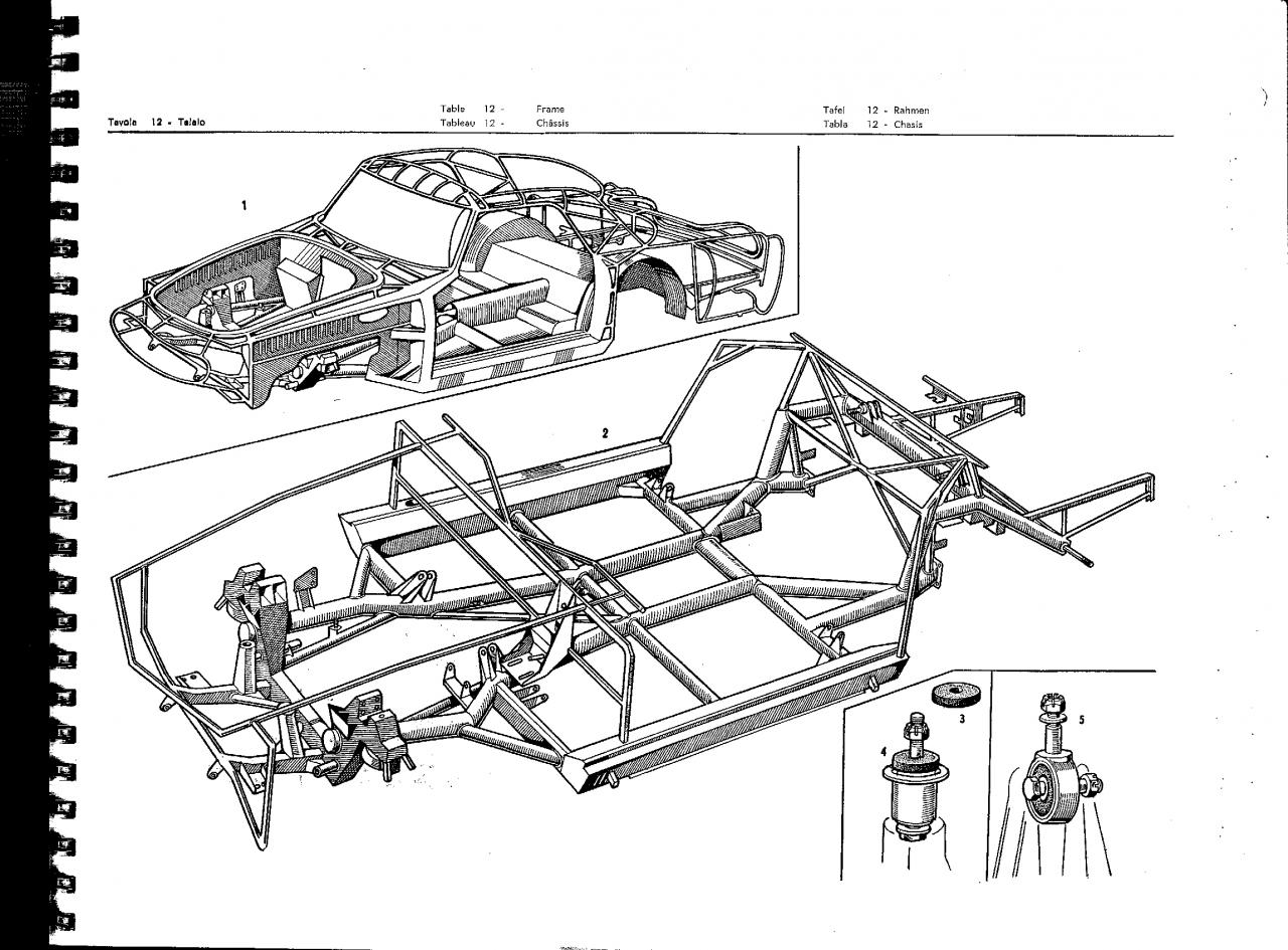

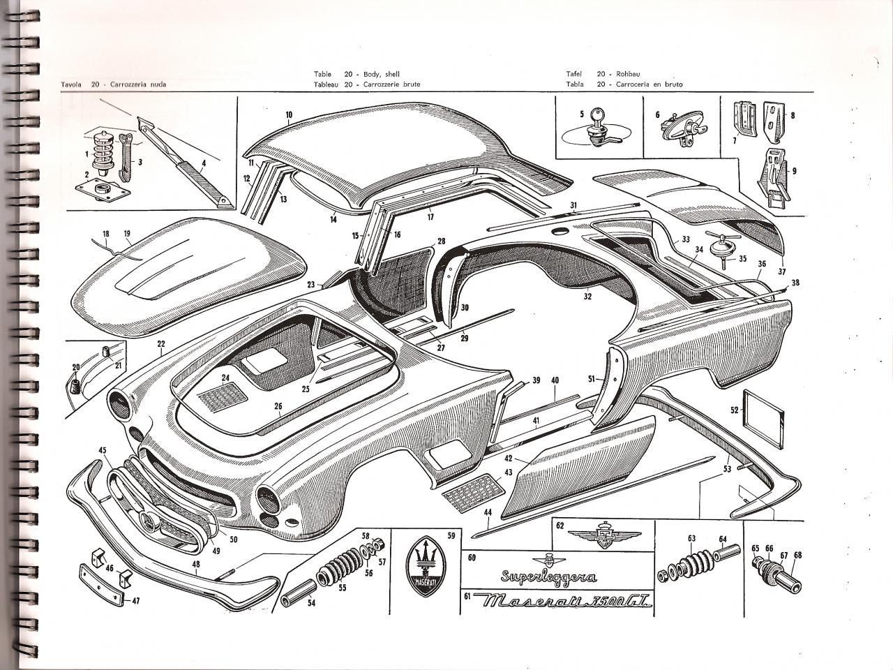

Don't know how helpful this stuff will be at this stage. I can probably come up with pictures of any details/parts you need to know about. Llterally any.
Attached File  Body panels copy.jpg   238.04K   37 downloads
Attached File  Chassis-frame copy.jpg   191.32K   37 downloads

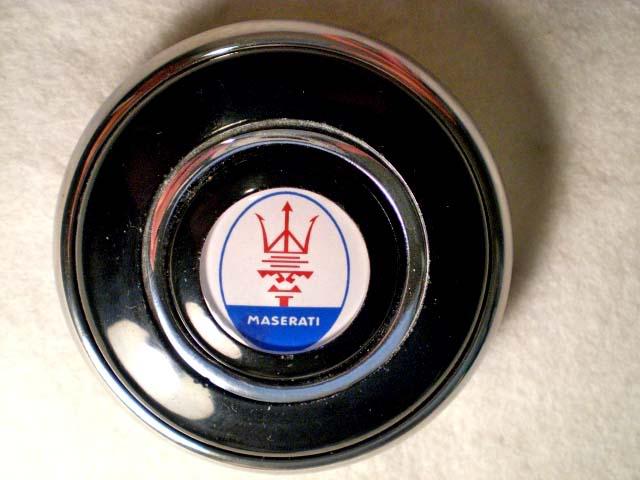

The kit steering wheel is pitiful, isn't it? I'd go for a PE Nardi. Bear in mind that the wheel spokes bend forward from the hub.
Attached File  steering-dash.jpg   70.45K   16 downloads
Attached File  3500 horn button logo copy.jpg   41.54K   21 downloads
Attached File  Steering.jpg   60.29K   17 downloads

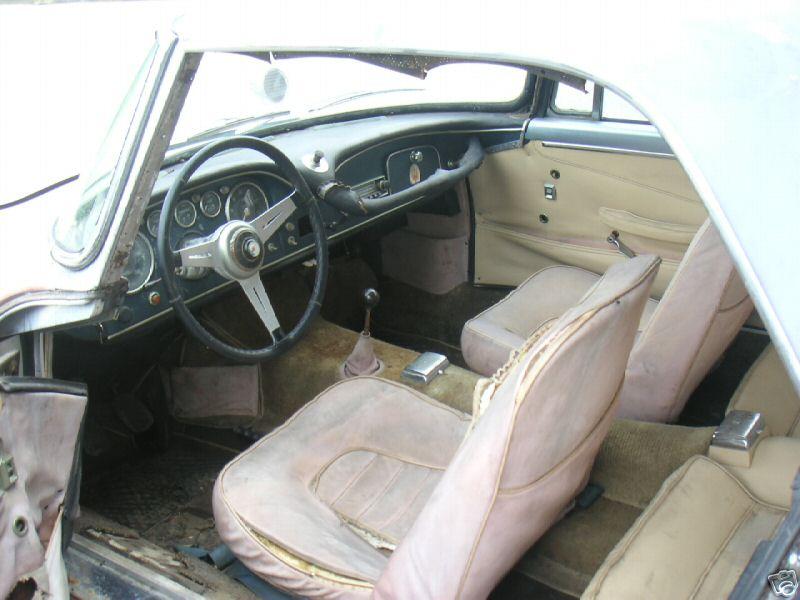

Posted 01 March 2013 - 08:40 AM
Random additions...
This is the best I could find of the firewall. Note the two red coils mounted at top left.
Attached File  eng-firewall.jpg   127.66K   34 downloads
This is a nice touch found on many but not all models -- a Ferrari-style kickplate at the bottom of the door.
Attached File  door interior kickplate.jpg   69.15K   38 downloads
Typical headliner, this showing blue-tinted glass visors. A traditional European touch.
Attached File  head liner.jpg   23.49K   22 downloads
