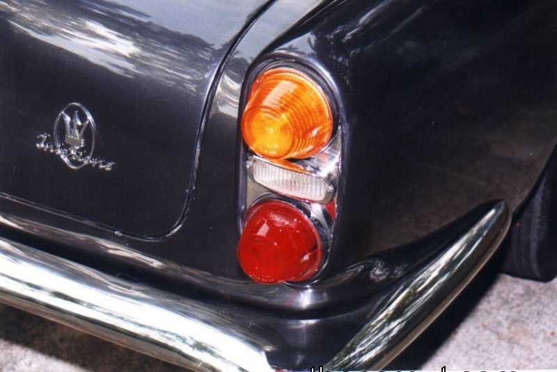

I decided it was definitely better to get everything fitting properly BEFORE I painted it! The bonnet and boot have some issues -- the boot at the sides, and the bonnet at the windscreen end. And there's some serious gappage around the doors at the "shoulder".
I also decided that the rear lights as provided in the kit are pretty irredeemable. There's an entirely different style with a one-piece coloured plastic light unit which has a chrome "hood". It seems quite common, so I'll go for that instead -- I made a similar set-up for the DB4GT,  so I know that it can be done, and how...
Time to break out the plastic card.

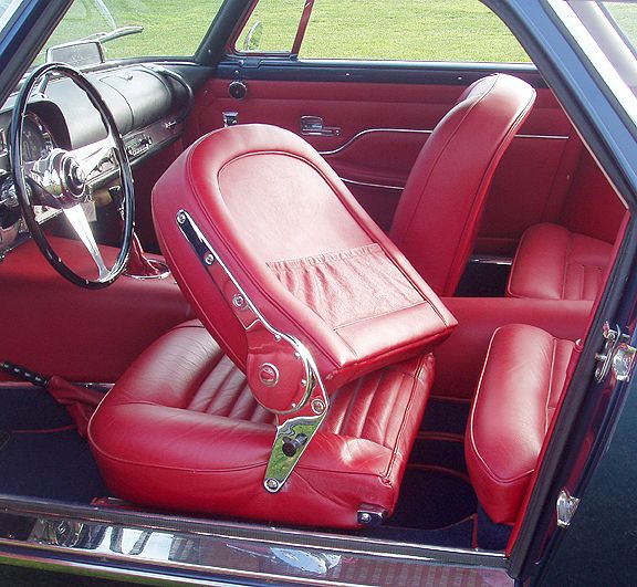

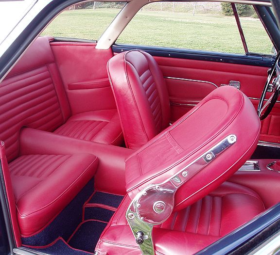

The seats are way too skinny, so I have bulked them out with plastic card:
The next stage of detailing is the interesting hinges, which allow the back of the seats to fold forward and twist inwards at the same time. Mine won't do that, but it accounts for the complicated "Flash Gordon" shape...
