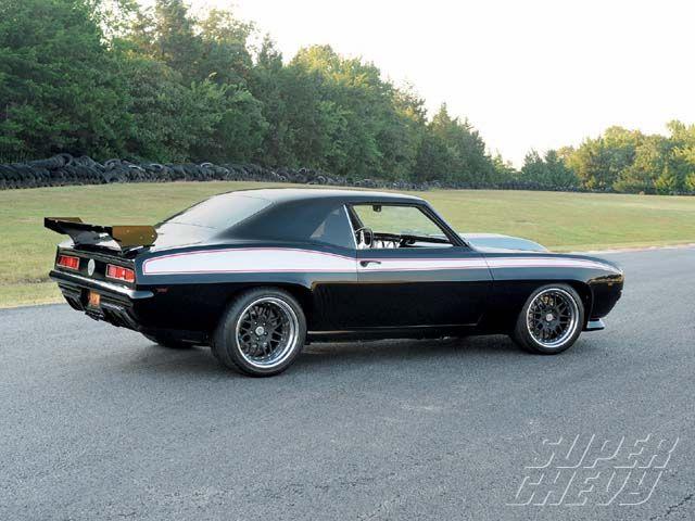

The car is a Dale Earnhardt Intimidator Camaro that I would like to try to build, but I don't know waht to do for the wheels. I know that somebody on here will have an answer. Please don't lead me to aftermarket , as I would prefer a kit to work with. Thanks in advance.Attached File  sucp_0907_10_z+dale_earnhardt_1969_camaro_rcr_3_special_edition+passenger_side.jpg   55.22K   100 downloads

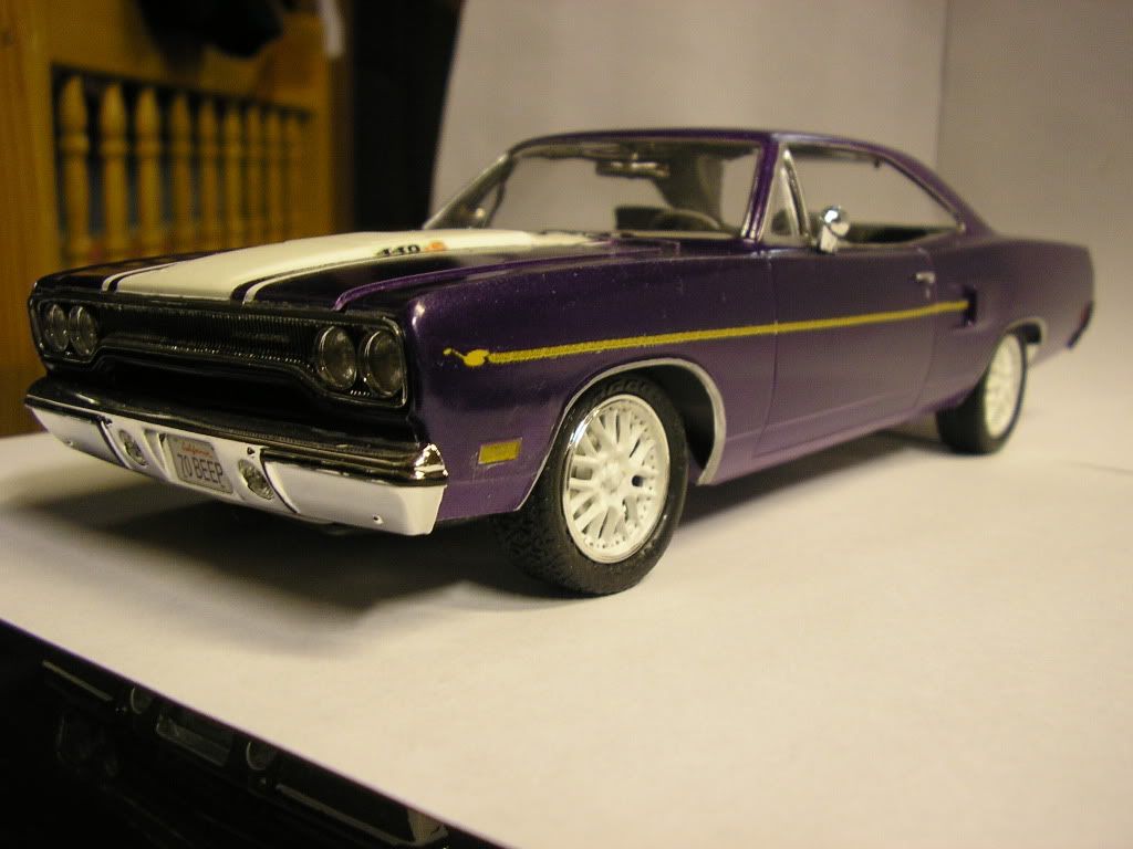

Sorry I lead you aftermarket... they were the closest looking thing I remember seeing. On the flip side Pegasus stuff is generally priced very well. Around $10. The wheels on the Road Runner look sort of close in spoke design but the positive offset is way off

Jason... not my build. I wish I could aspire to that quality. From another builder on here. More info on the model is under the link in my original post.

These wheels lok pretty close, but it's a chunk of change to buy a Tamiya kit for the wheels...

The wheels on the Porsche are probably 18s and/or 19s. The wheels on the Mustang build are 22s. My bet is that the wheels on the OP's Camaro pic are at least 20s.

The Camaro kit that i already have is 1/25th, while that Tamiya Porsche is 1/24th, how well would that scale out? The kit is Revell's Yenko if it helps.
