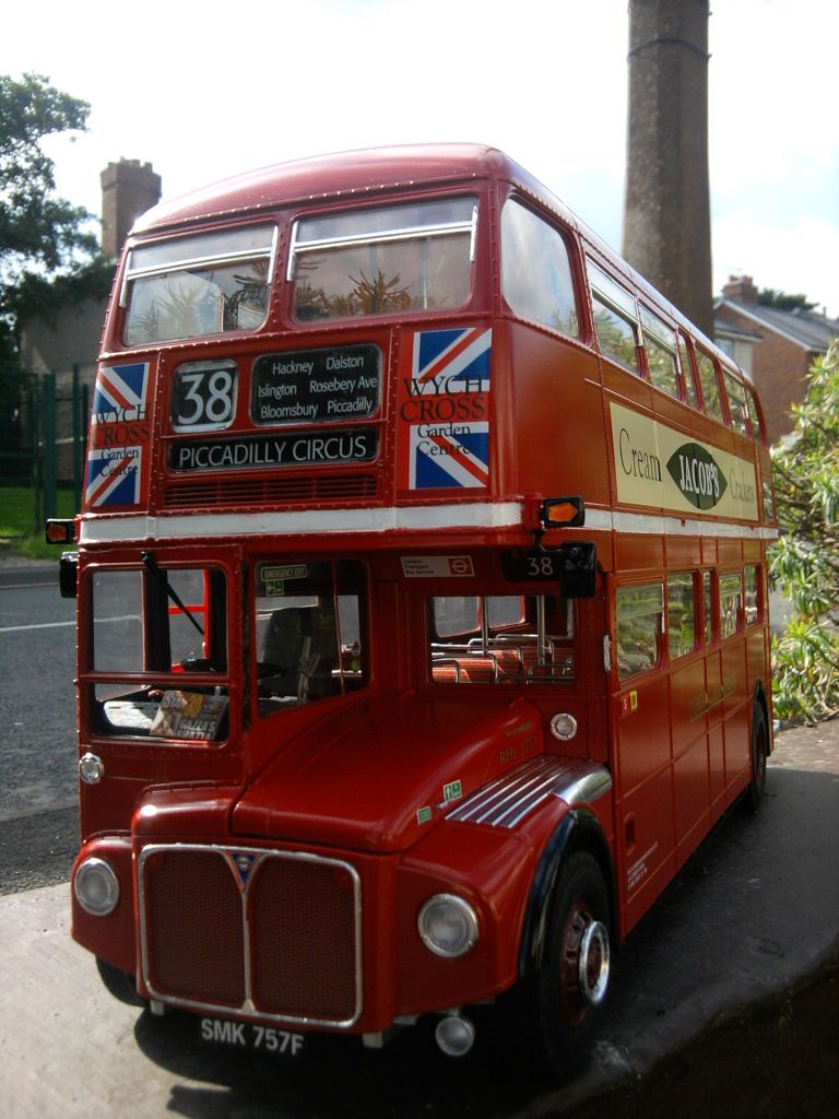

Posted 18 April 2014 - 08:33 AM
Hey there, London doubledecker bus is back. And I had to go pretty far way back in history of this forum to find my thread. I left the project resting for a while. Somehow I was not able to come up with a decent quality of the paint job. I won´t go in details. Nothing seemed to work for me while I tried to get a nice and shiny coat. So, I took a few months off but I couldn´t stand the shame anymore. I said, one last shot  and let´s keep on riding no matter what.
So, here I am with the best coat I could get and determined to finish this London pride.
The "Piccadilly Circus" sign in the back is not quite straight but I´ve noticed it too late. The front part with the grille broke into three parts the other day and it needs some more treatment. Here it is with the PE details.
And the tail part with lights and license plate.
That´s all I got for now. This and the hope in a smooth ride.

Posted 07 May 2014 - 09:14 PM
I guess I´ve just killed this project. I forgot to paint the yellow stripe beforehand, so I did over the red coat. I had to run the masking tape over the rivets and other surface details and decals. I was afraid of bleeding colour under the masking tape. So, the first layer was clear. Then the white base to kill the red. And finally the yellow. Unfortunatelly, I´ve never done this before and when I peeled the tape off, I got this:
I should have used decal instead. Now, I don´t know. I don´t think I´m able to fix it unless I strip the coat completely off. Suggestions are welcome.

Posted 08 May 2014 - 03:35 AM
try taking some wax or rubbing compound to the area with a fine tipped swabbed. They are made just for this purpose but if you done have them try making some by cutting a swab down with an Xacto knife take your time.  I've rubbed out worse than that before

To be honest the yellow just looks like world weary paint that has been hastily repair a number of times!!! I have yet to start mine....the kit is intimidating!

Jarda,
Before you strip all the paint off and start again.  Have you considered getting some yellow stripes from Microscale Details www.microscale.com These would cover all the imperfections in the yellow paint and give a very crisp fine edge to the yellow stripe.  I have started using their stripes on many of my builds, the quality is excellent.
By the way excellent work so far!
