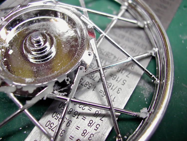

This first pic' then is simply drilling out the spokes ready for replacement. There has already been some work carried out though - in as much as the chrome has been coated with polyurethane which has been in turn tinted with a smidge of black gloss enamel. Several reasons - firstly protection during the heavy handling stages, secondly the addition of black negates the age old problem of yellowing, and finally it imparts a very "Hard chrome" look to the surface, removing the plastic "white chrome", which I utilise for a polished alloy look - see the crank case cover earlier.
Here you go then.....................
Posted Image
You can easily see I've drilled with the spokes in place enabling me to place the holes accurately, the hub is drilled to my wire size [0.45mm] but the rim has been drilled much larger. This was a tweak I worked into my previous spoking.
Using the sleeve off of telephone wire, I place a short length over my new spoke and once it's located within the rim - I slide the sleeve down and into the hole, this centres and locates the spoke, and by leaving a little proud it becomes the spoke ferrule - to be touched in with brass once complete.
Here's the idea on my old Triumph build - it's a bit crude on this one because I was after a theatrical look to the whole build, but should serve to give you the jist of what it is I'm after??
Posted Image
Here's hoping this piques your interest?......................... Andi.

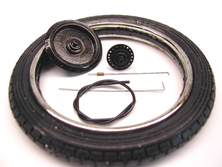

Here you go then, a further dribble into the Triumph wheel spoking update.
As you can see minor progress with the component parts displayed and ready for assembly. The style of build is becoming evident here with the emphasis not on a super restoration look but rather a machine that's used regularly but kept in tip-top condition as a well loved tool. Ergo we have paint finished parts that you would normally expect to see chromed such as the hub in this instance - it should view better once complete.
Something that is becoming very evident to myself is the lack of finesse. This I'm no longer able to bring to my builds since the unavailability of the Yadster, this also being the reason I'm now happy to sign myself as Andi, and try and bring the "Fun" element back nto my building; in fact can anybody tell me whether it's possible to change my old sign-in handle from Yad' to Andi? - it's a bit embarassing working under the name of Yad' now.
Anyhoo........... this is where we are at the mo' - I'll dribble in the assembly pic's as they happen.
Posted Image
The spoke ferrules are a little clunky I know but I can live with this nowadays.
All the best for now lads............... Andi

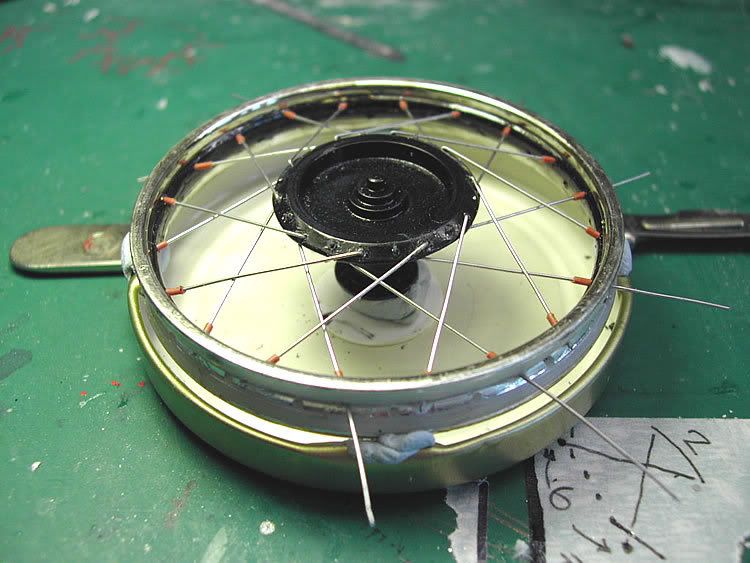

Posted 13 October 2007 - 04:26 AM
Hi all.............
Sorry the progress has been a little slow, especially if you've been waiting for an update?
Anyhoo............ here's a pic' of one completed side, I've left a few of the spokes visible as they protrude out of the rim to clarify the assembly. It's all pretty simple as you can see. Even the jig is simply an old jar top that's been pressed into service. It was only needed for the initial set of spokes in order to establish the offset of the hub within the rim, this once complete is enough [so long as you have a reasonably delicate grip] to complete the spoking in "the hand".
The pic' should make things pretty clear though........................
Posted Image
As ever should anyone need further details just
sing out!!
All the best.................... Andi
