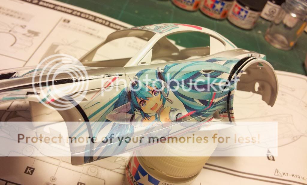

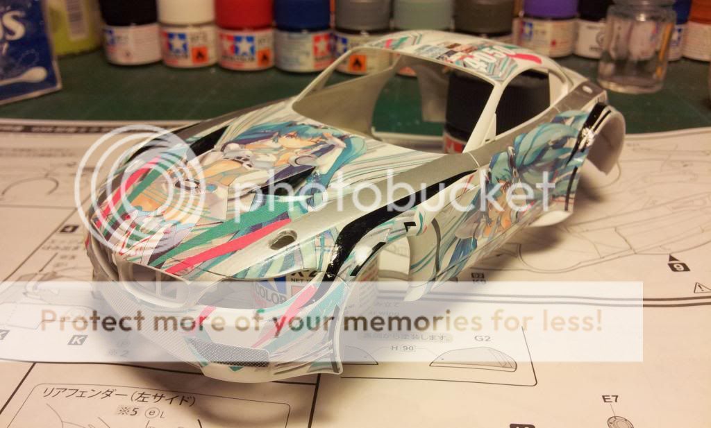

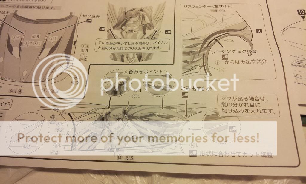

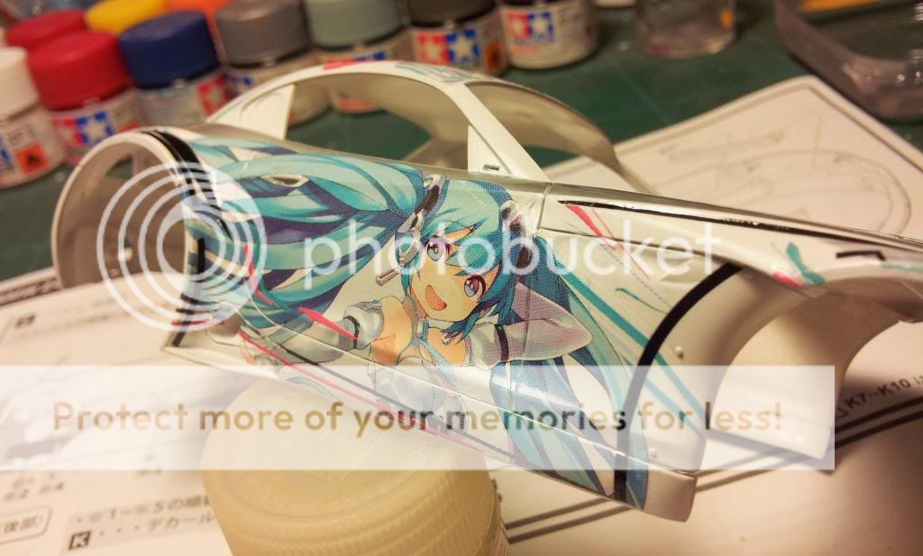

Side panel time!!
This one was the most tricky part IMO. Just have to be careful once you get to the rear wheel fender.
For the instructions, just like the hood, follow the number sequence "again" and apply the corresponding decals "again" lol.
I found that when you get to the rear wheel fender, cut a few slots at the end so the decal can sit in the bend properly and not ripping.
This is what I got after, I also did both sides.
After everything dried, I used my modeler's knife and cut into the panel lines for the extra realistic look.
And here are 2 shots of the whole car covered, without the sponsors.

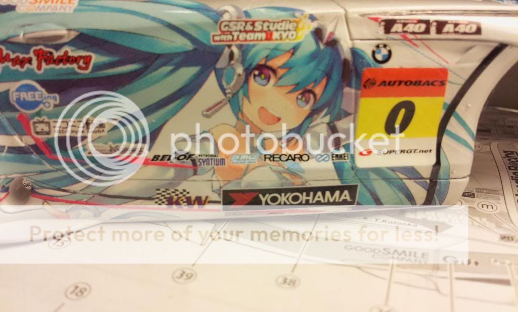

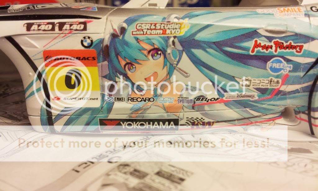

The sponsor decals are pretty straight forward, but there is one that you'll need to cut into a few pieces.
The one with Enkei RECARO P.MU SYNTIUM BELLOF
On the left side is normal, but once you go over to the right side, you'll need to cut each sponsor separately and place it in reverse order.
I guess FUJIMI was too lazy to printing a flipped side of it :angry:
Here's what mine looks like after:
I'll be doing the body accessories next, stay tuned!
