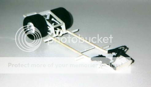

First off I don't think many builders out there build rear diffs they mostly steal from other kits as for what type of suspension it comes down to research. Many older like the 68 charger had a duel leaf spring set up and to upgrade that to a modern suspension you would most likey go with a multi-link suspension. Research how such a suspension works and get the correct evergreen or plasitrut. I've build such a set-up in a studebaker so I could tuck a big set of slicks under it. Sorry no pics though. Each type of car though can be different. There are guys with a lot more knowledge who will be able to answer your question better I'm sure.
#3 mnwildpunk
mnwildpunk
  • 589 posts
  • Location:Minneapolis
  • Full Name:Dave isle
Posted 16 March 2013 - 01:03 AM
