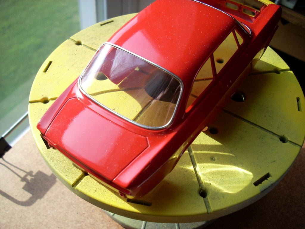

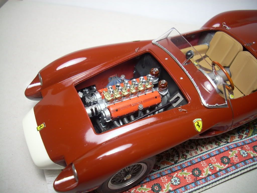

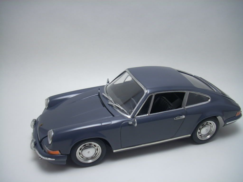

Posted 19 March 2013 - 08:29 AM
These are all done with Alcad:

But he used metal foil to mask it.   :lol:  :lol:  Just kidding, I've always wanted to see how Alclad would look on trim. Thanks Curtis. I certainly see the realism, but I just couldn't trust my skills. If you get it wrong it's gonna look really wrong.
