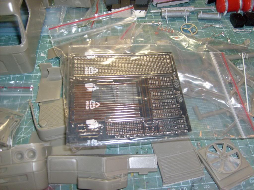

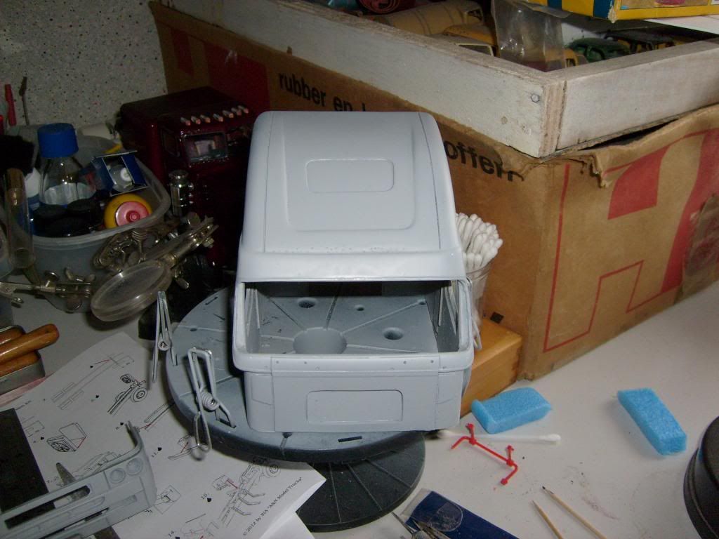

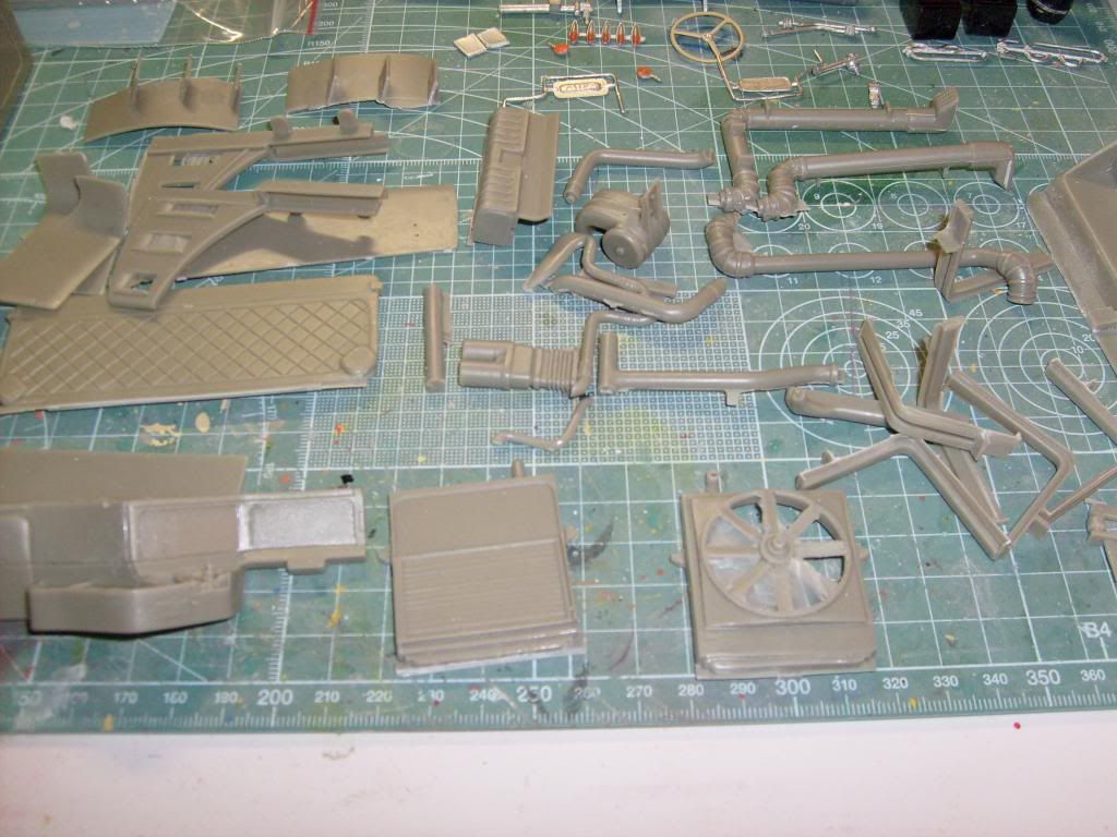

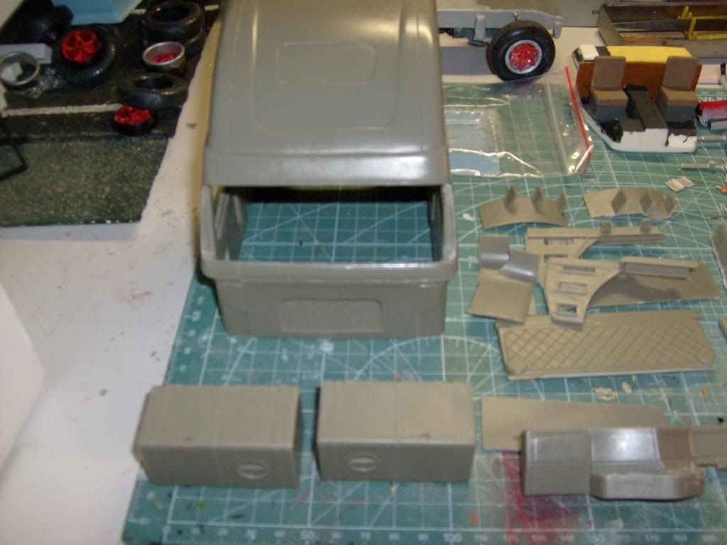

beside the 2 projects i start whit this australian coe
its a resin from a&n and donor chassis wil be the freightliner fld 120
there a lot things in this conversionkit and instructions
jacobus

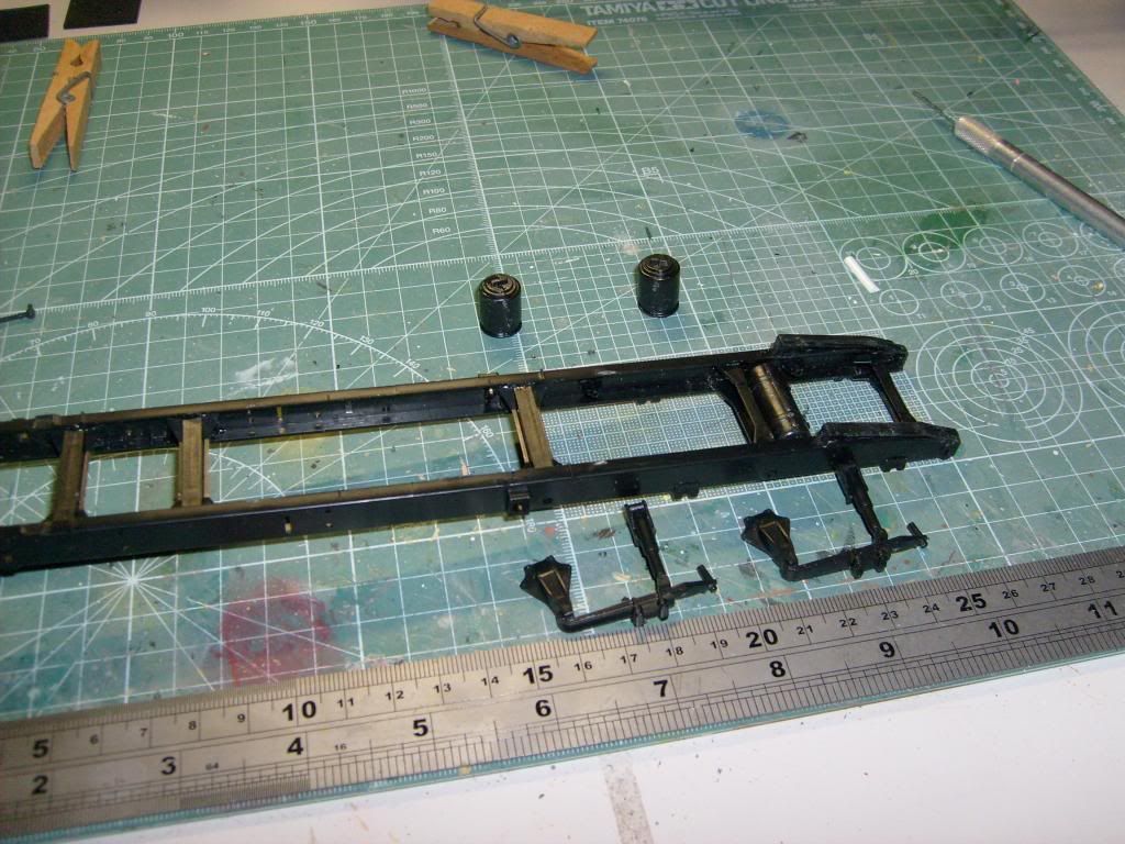

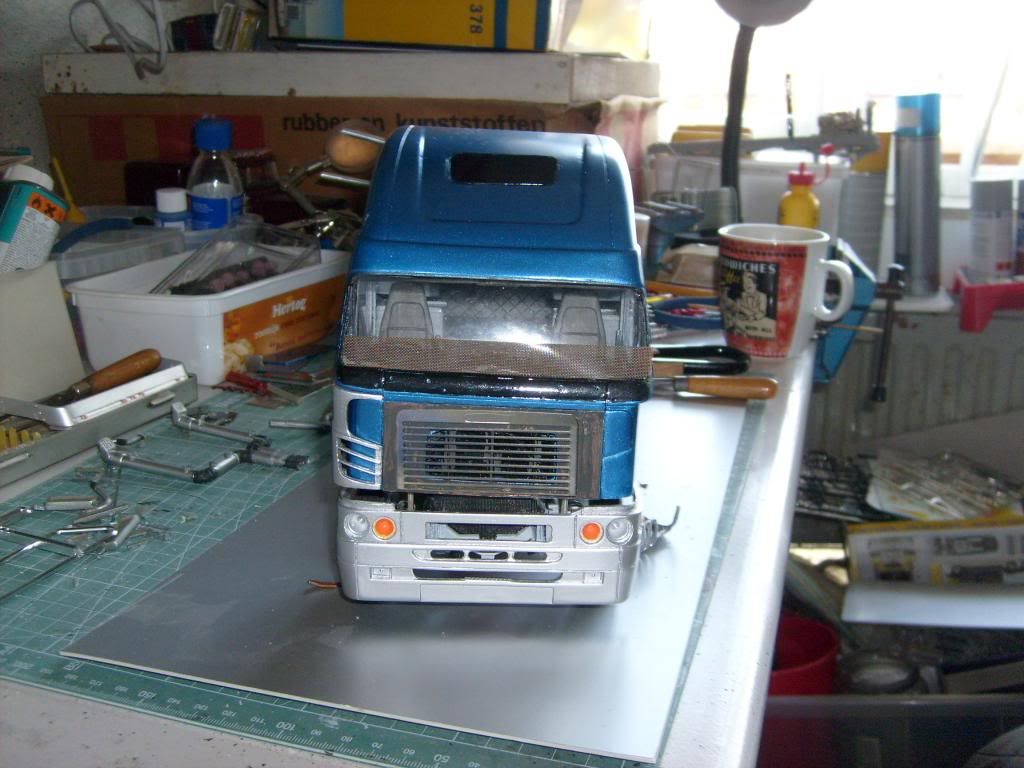

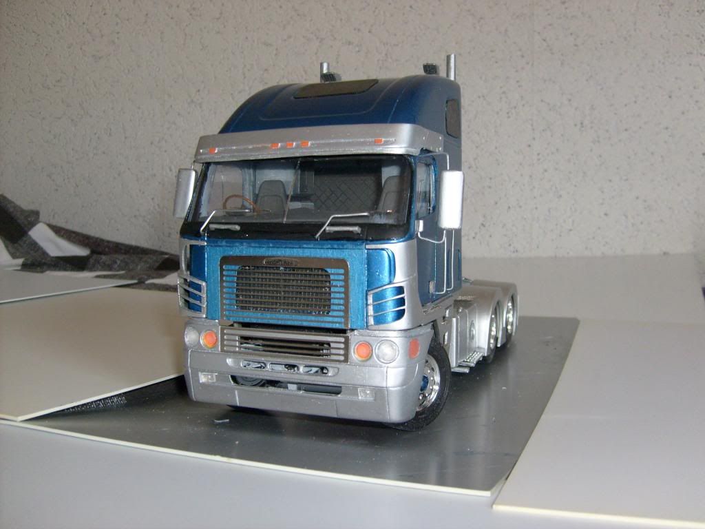

chassis built and make it short on the sizes [its calcullated,]
cleaning cab and first primer and test spray [mettalic blue ]
so its drying now look now for interior colours
jacobus

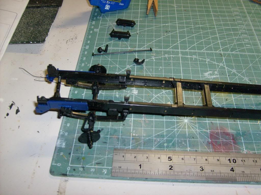

Hi jacobus,
this is a great transkit, I have built and finished one, and started a second.... It looks to me you have made a mistake in the positioning of the front axle. With the FLD chassis, remove the 'blue' extensions and measure 36mm from front of chassis to the centre of the steer axle, (or 40mm with the supplied bumper mounts installed).
Kelvin

Posted 23 March 2013 - 10:07 PM
thanks for the tip
have already take it of after the picture was taken
the size is in his instructions , but this is better to see
thanks kelvin
jacobus

Posted 24 March 2013 - 11:44 AM
No problem jacobus, just trying to help.
Another tip - You may notice I have assembled the steering tie-rod to the front of the axle, depending on what engine you use it may foul on the oil sump, If you intend to display with the cab tilted, no engine parts can sit more than 20mm above the top chassis rail before hitting on the cab floor.
Kelvin

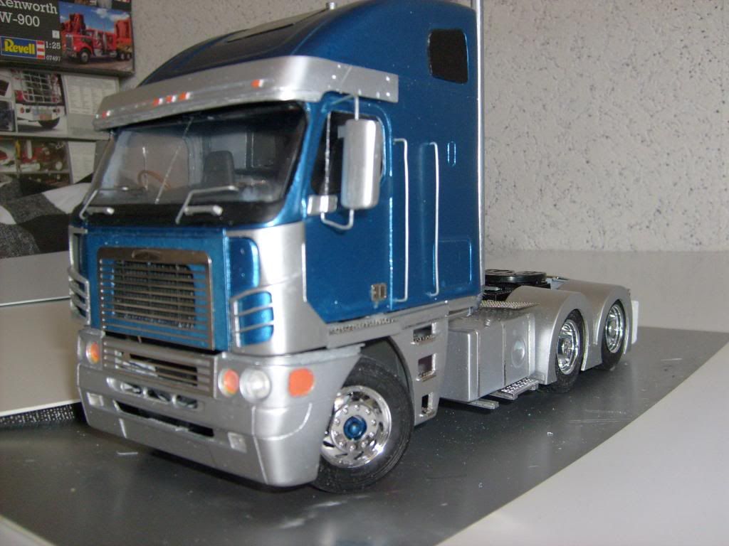

As this is not my thread I have posted it here -
http://www.modelcars...showtopic=72788
BigBad, I sent you a mesage...
It will be good to see some more builds of this kit coming through!

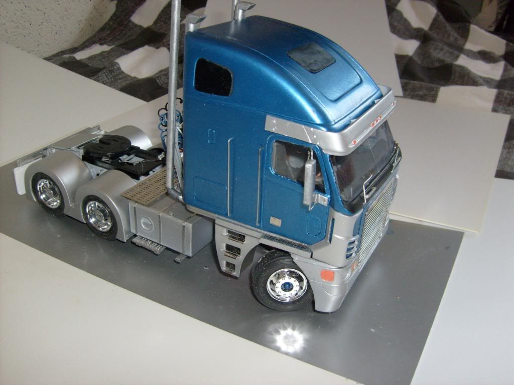

after primer and sanding his first coating of metalic blue and silver
this only a mock up
jacobus

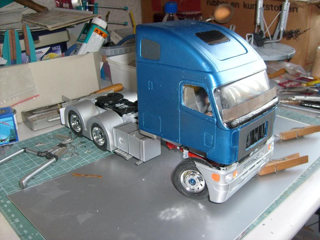

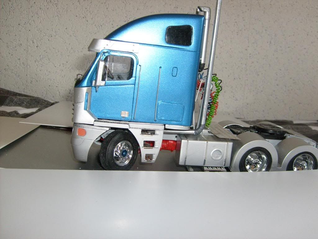

Posted 28 April 2013 - 07:05 AM
a little update
progress gettin slow [ work,work ]
so everything is not glue yet just a mock up
and messure etc
makin a eiffeltower for exhoust en dryfit
so we go on and on to make this truck finishd
he is very heavy for a model [weight]
