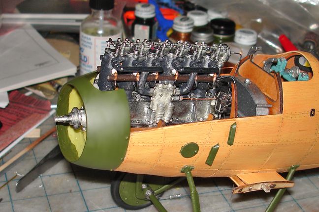

It's not ready to fly... but it's ready to taxi!  :lol:
The landing gear struts, axle, wheels, hubcaps, etc. are all cast metal parts. The reinforcing cables are silver thread supplied with the kit, and the turnbuckles are also kit supplied (cast metal). I painted the landing gear with Model Master paint. Since this model is meant to be built as a "skeleton," with the structure exposed and no skin, all of the outer detail parts on the fuselage do not come in the kit. I used my reference photos to create the small fuselage surface details, like the small squarish plates near the cockpit, the round flaps near the nose (made of the "pupil" of "googly eyes!!! and a "hinge" of styrene rod) and the vents that I made of strips of thin aluminum, bent to shape, and glued onto "flanges" made of this sheet styrene:
Also finished up the tail skid:

BTW... all along, I've been thinking about how I was going to form the metal parts of the fuselage... the cowling over the engine and the cone shaped piece between the front of the engine and the propeller cone.
For the cowling, I'm thinking sheet brass or aluminum. Should be straightforward enough. If Gerald Wingrove can make body panels out of brass, by god, so can I!  :lol:
But the conically-shaped piece up front... I wonder. I'm talking about the piece in red on the plane on the top, between the propeller cone and where the wooden panels begin (and actually, the propeller cone itself, I guess):
I'm thinking that a section of a L'eggs pantyhose egg could be just what I'm looking for. Does anyone know if they still come in those plastic eggs? Or is that a thing of the past?

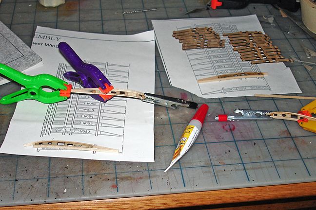

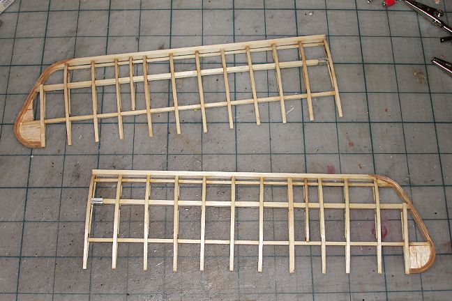

Posted 02 May 2013 - 07:29 AM
On to the wings for now...
Each separate wing rib has to be assembled before you can start assembling the wing. In other words... you have to assemble the individual parts before you can assemble those parts into a structure!
Each wing rib (for the upper and lower wings) is made up of several parts: the rib itself, the short vertical stiffener pieces on each side of the rib, and the cap strips that get attached longitudinally to the top and bottom edge of each rib. Multiply all of those parts for ONE rib, and multiply the ribs by how many are needed to build the upper and lower wings, and you come up with a long, tedious process.
First step is to glue the short vertical stiffeners onto both sides of each rib, and then trim each stiffener flush with the top and bottom of the rib:
Then, each rib gets a cap strip on both the top and bottom edges, like this:
I'll be at this for a while...   :rolleyes:

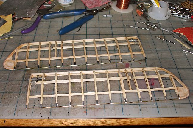

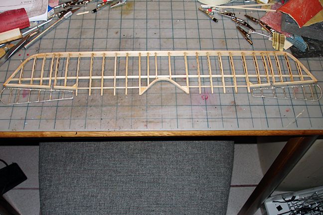

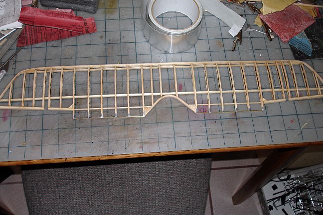

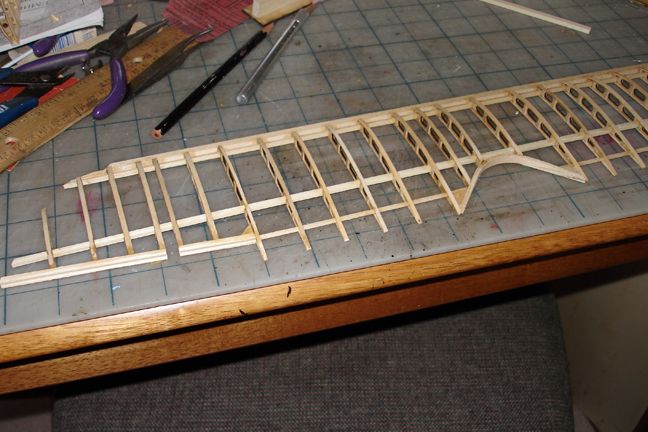

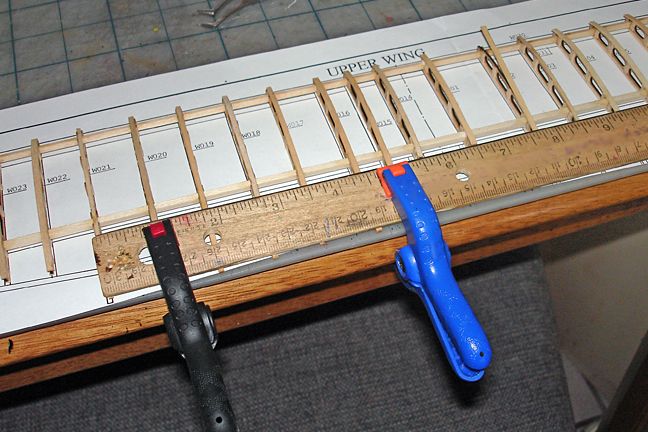

Posted 04 May 2013 - 09:24 AM
Once I had all the wing ribs built (rib, stiffeners and top and bottom caps), it was time to build the wings themselves. Basically all you do is slide the ribs onto the horizontal spars (in the correct order, the ribs have to go on in a particular order). Once all the ribs are in place, I laid the wing down on top of the plan and slid all the ribs into exact position using the plan as my guide. Once everything was in the correct spot and everything was squared up, I clamped the wing assembly to the edge of my work table and added a drop of CA to each rib/spar intersection:
In the photo you can see that one of the rib top caps popped off. No big deal, once the wing asembly is dry I'll just glue it back down. Then it's on to installing the leading and trailing edges of the wings, and the wing end caps, which I have to form by soaking some wood strip and then bending it to make the curves.
More to come...
