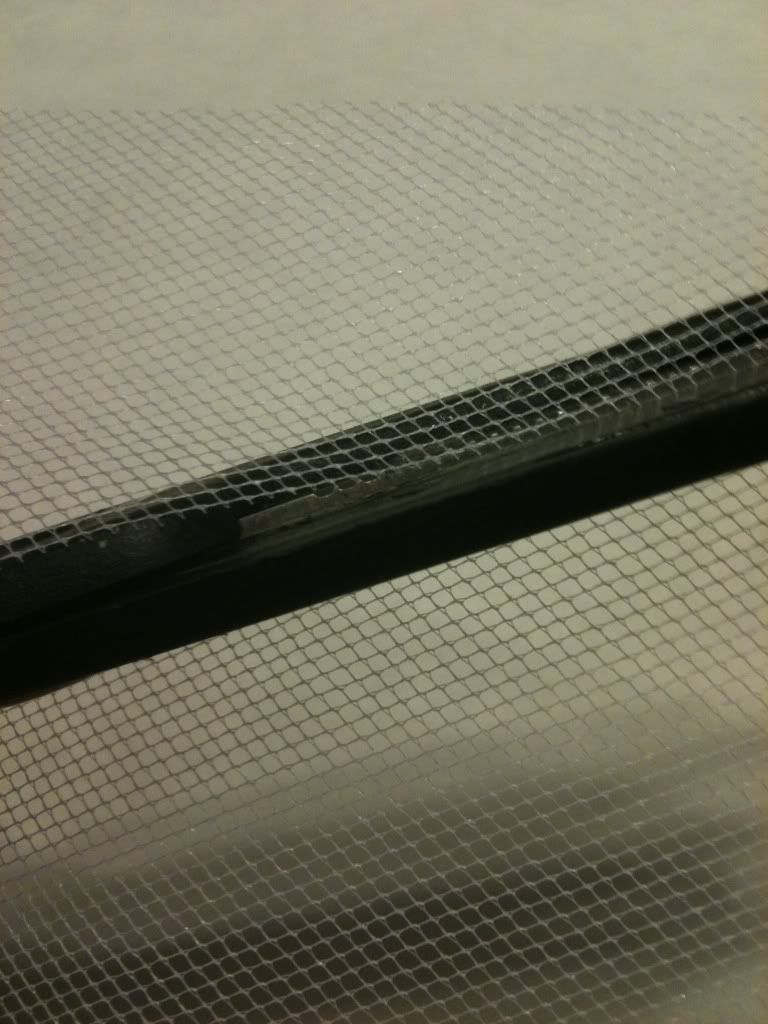

I thought I would share something I did on a viper hood. I wanted the hood to match the spoiler on the ACR viper, the kit came with decals for the spoiler, but I didn't want to try and get decal material to lay down on the hood vents. So I decided to paint both parts together and try to get them to match.
2E11EEFE-B8C7-4A80-B194-78F10DB455BC-118

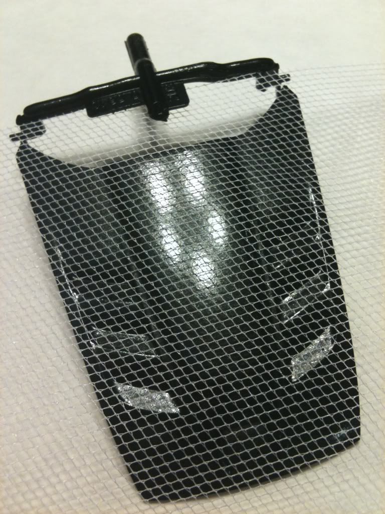

I started by painting the hood with a black crystal. I like this because it has a lot of silver in it already and pops really well.
FC3EAC3F-6835-4986-B28E-8570B42DD746-118
I cut out a piece of plastic window/door screen/netting found in the fabric section at Walmart.
Edited by moparmagiclives, 24 March 2013 - 05:19 PM.

Posted 23 March 2013 - 12:00 PM
0F9D42C5-C394-4C58-AAFD-1F520F5C3C7A-118
I wanted the pattern to run side to side on te hood, not diagonal so I started it with a straight edge across the top
1E60F39E-5A27-4B2C-AD4D-224AB19B14D6-118
This puts the pattern running pretty even across the hood like the real thing.

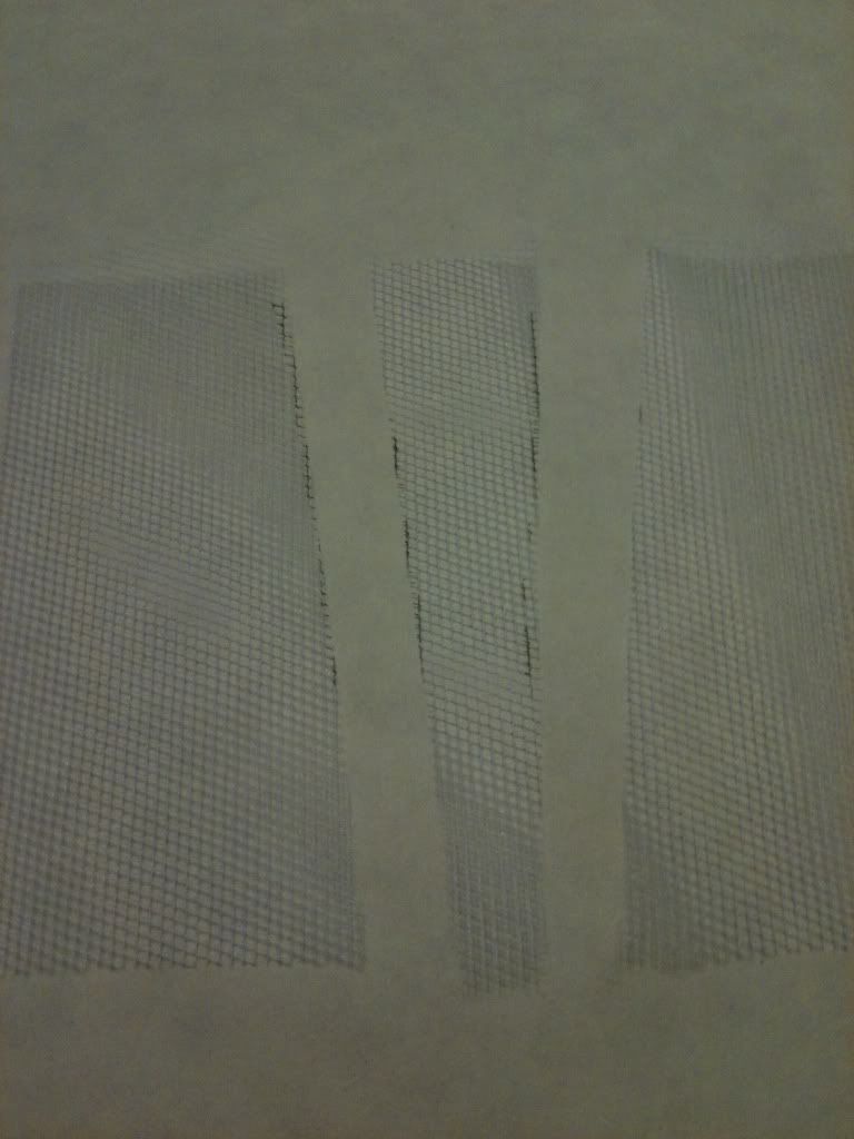

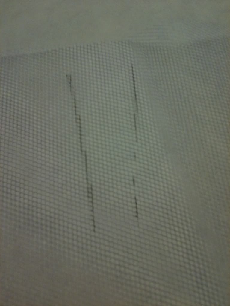

Because of the bulge on the top of the hood, I didn't want there to be to much detail lost from where the material wouldnt contact the hood side. So I traced the bulge on the screen then cut it out.
FAD3F1B1-5806-4FE7-9129-AAB205C8A048-118
3925F5F9-5208-4EB9-8D8E-A784F9CB8613-118
Edited by moparmagiclives, 23 March 2013 - 12:58 PM.

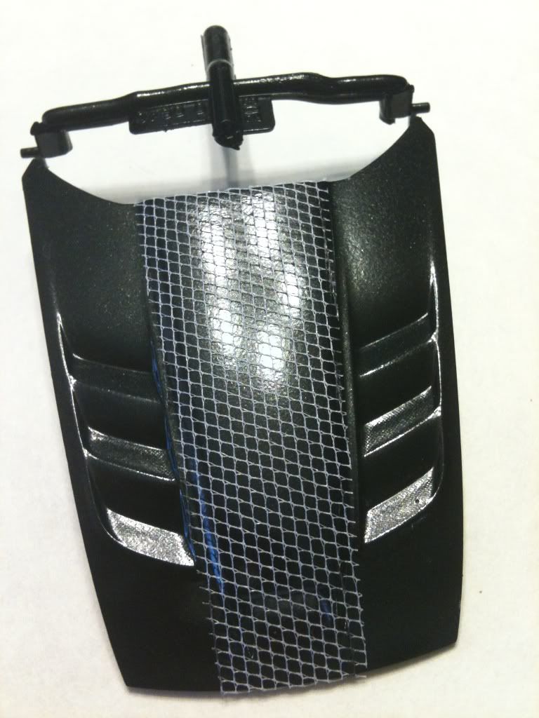

With the center cut out, it's stretched and taped to the back side of the hood.
D8FA2DE2-6785-4AA7-BC88-D127B995130D-118

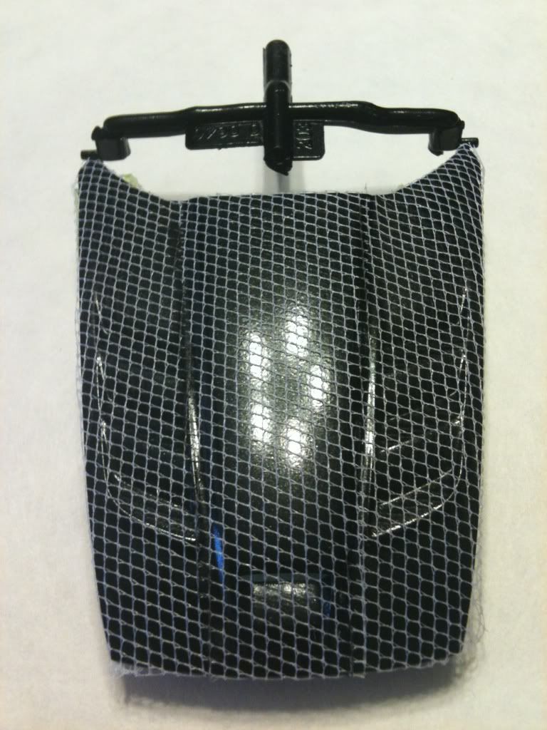

Fallowed by the sides, butted up as close as possible to keep a gap from forming when the paint is applied.

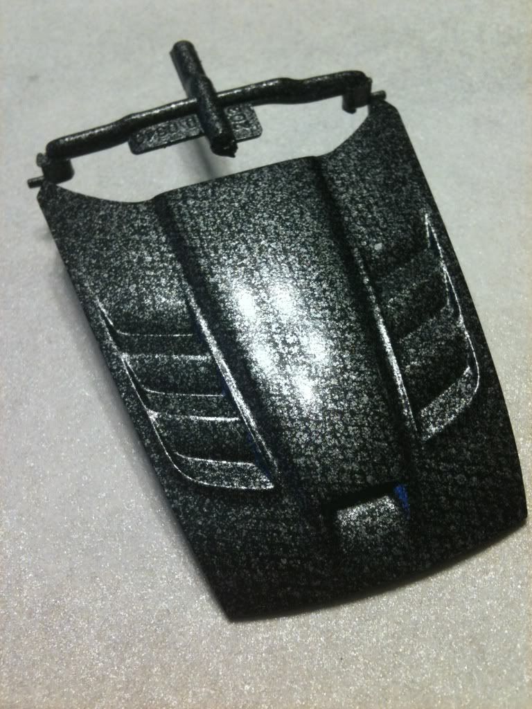

Posted 23 March 2013 - 12:09 PM
8FE7F805-0B81-4C1D-B47F-F3E375D512A5-118

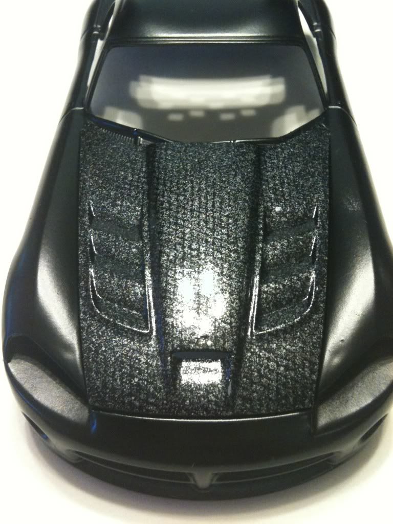

dusting with silver and gold, it gives a pretty good representation of the fiber pattern.
6498454A-105B-4CC9-A78B-AB53E3A76FDE-118
Once cleared, it has a pretty convincing effect.
A little wet sanding and some more clear will give it a very nice smooth finish over the sprayed pattern. It's not totally true to scale, but it gives a good representation.
I hope this helps someone, and I hope I'm not reposting someone else's idea. I looked but didn't find much on it. So I thought I would share mine.
Thanks for looking.

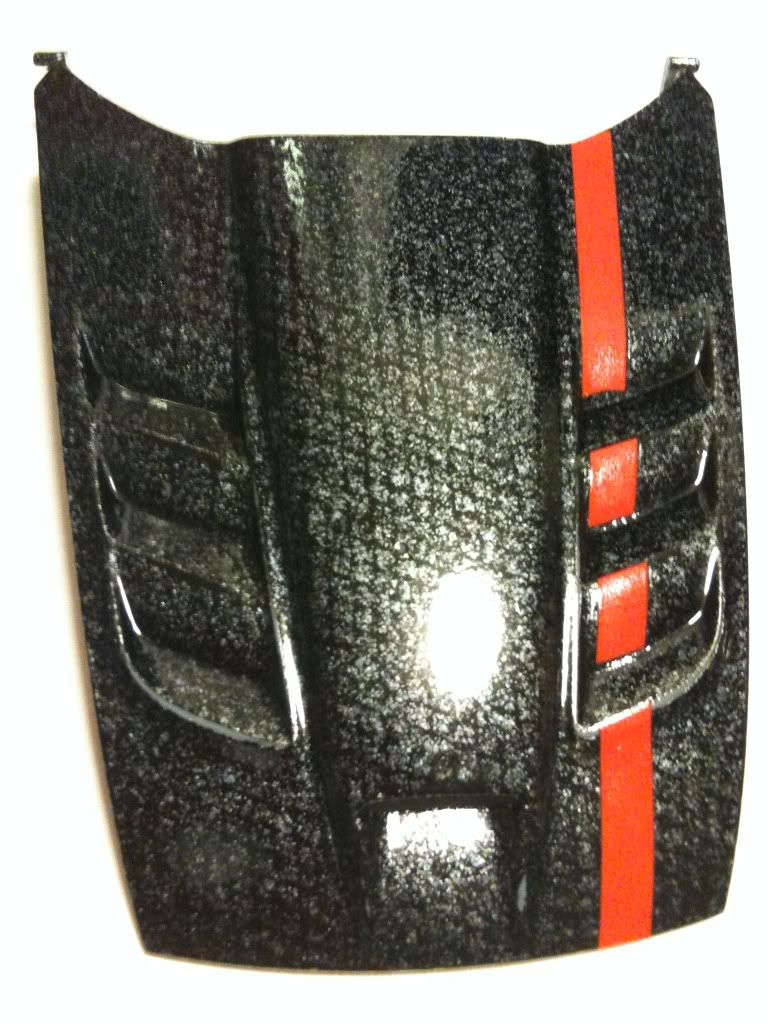

Posted 24 March 2013 - 05:07 PM
Little update, here she is cleared, color sanded, cleared, decaled and cleared again.
64958EA8-3945-40D0-8B4A-944E753FC9D1-444
