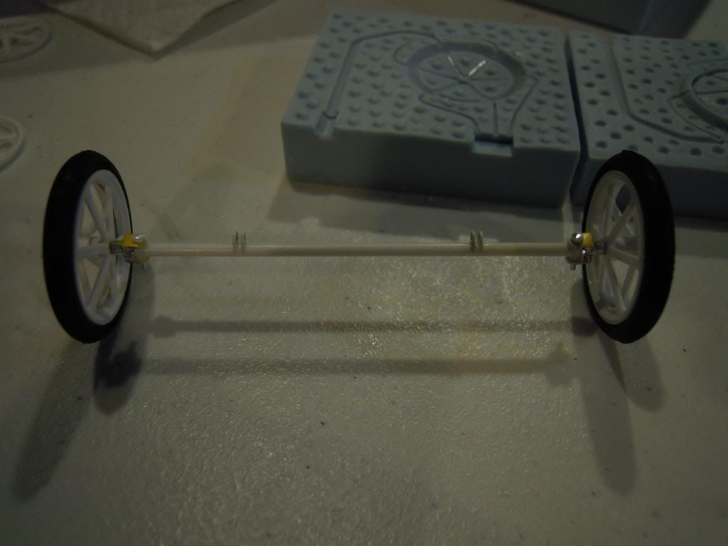

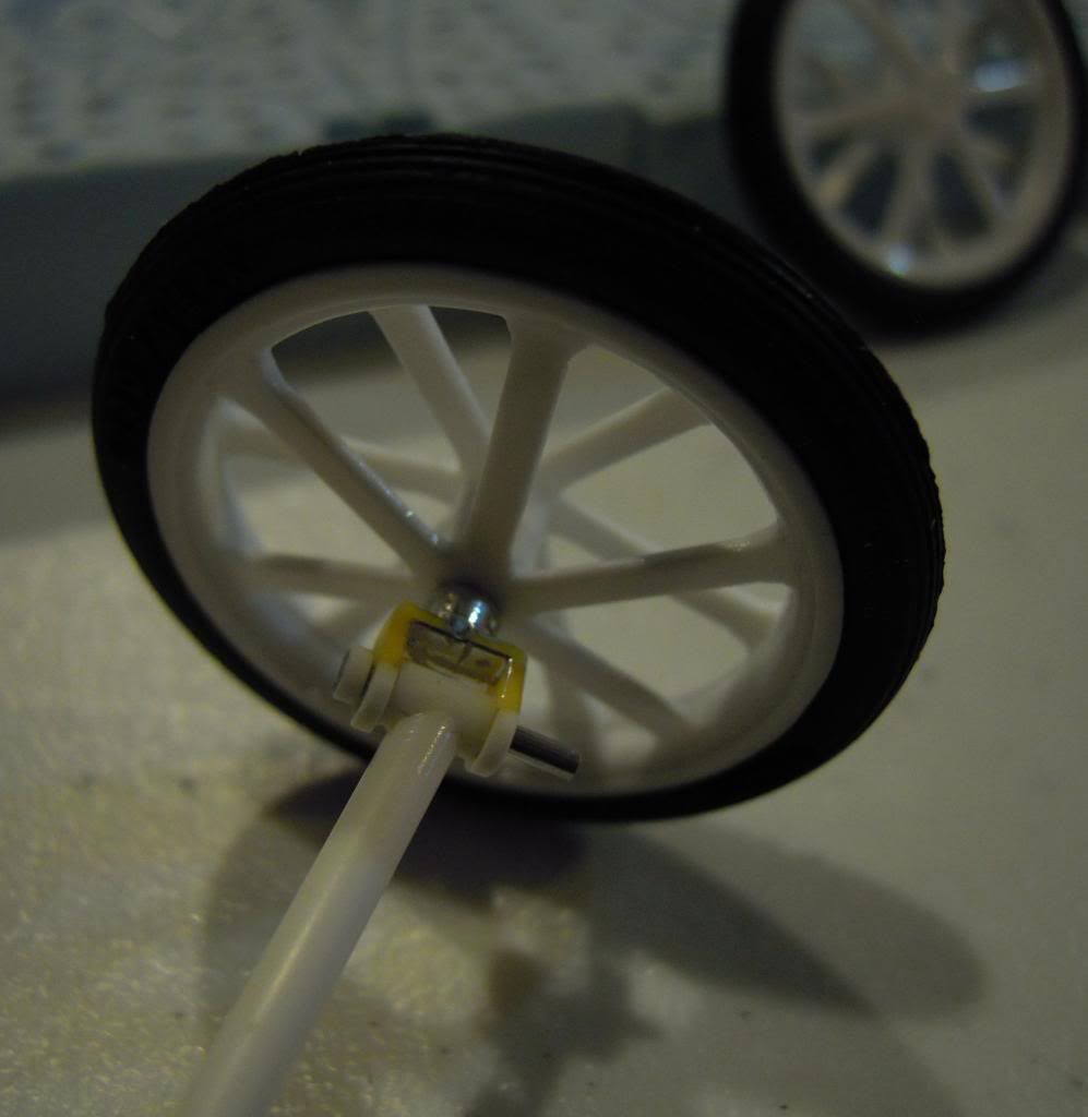

Molds are complete and here are the resin parts for the rear end. Also included are the wheels I developed and with some mods will be using them for this build. Next step is to add the attachment ears to the rear end so the ladder bars can be properly placed on the frame. This will help me locate the rest of the uprights for the frame.
Drum & backing plate placed in the wheel.
Fit up of the wheels to rear end assembly.
Wheels and rear end assembly

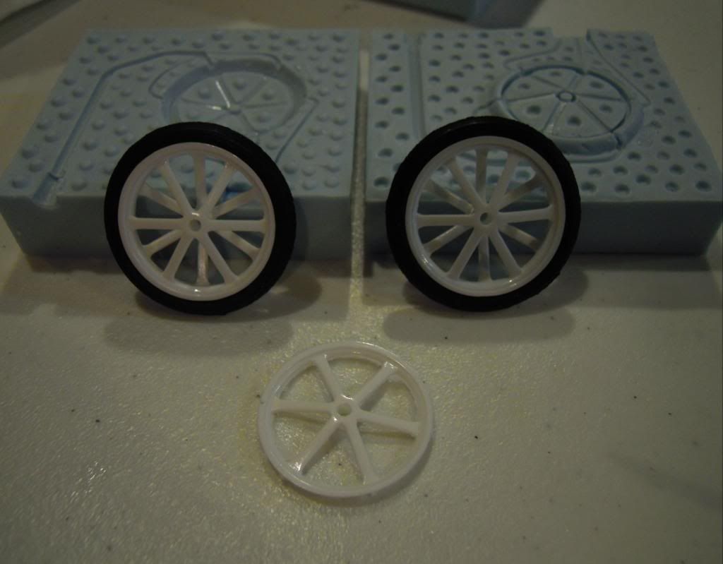

Posted 28 May 2013 - 06:18 PM
Working up the 12-spoke wheels and have the first half completed. Created a master spoke, then did a mold to get six exact copies and prepped a Revell dragster front wheel rim to accept the spokes. I still have to cut off the back side of the rim and then size the half wheel before doing yet another mold. Putting two halves together will yield the 12-spoke I'm after.

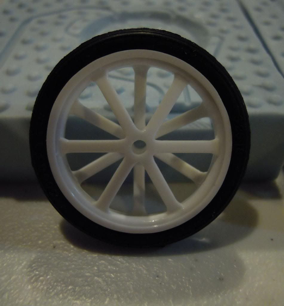

Posted 08 June 2013 - 04:07 AM
The mold for the 12-spoke wheels was successful and this is what they look like in completed form. Two halves together, twisted for the offset and these are fitted in the Revell tire without any mount surface adjustment. Some minor sanding may be done before they are glued together though.
