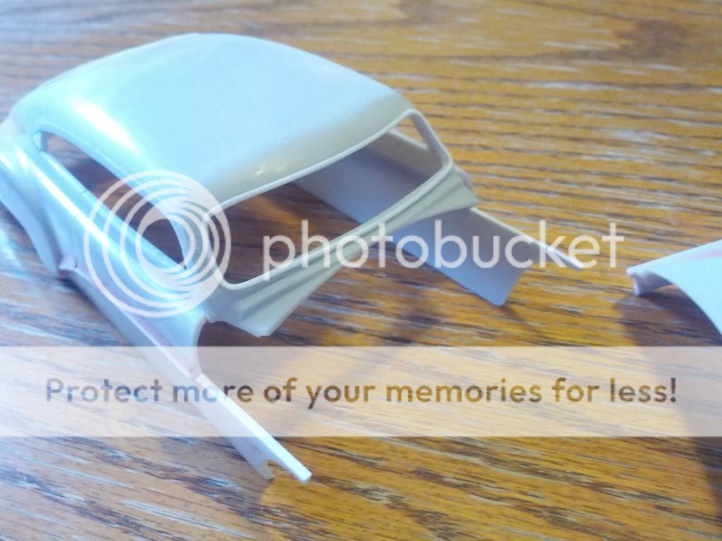

So, as some of you may know from my 56 Windsor build link, in conjunction I am building a 51 Fleetline similar in style to the "Voodoo Creeper". Here is a link to the 1:1 on Youtube. Don't worry, the video is only 40 seconds
Here is a photo from a magazine of the tilt front end in progress.IMG_20130205_134257-1.jpg
Here is where I am at as of tonight.
I've gotten the top chopped, the front end extended and cut free and I have the grille roughed in. For the grille I used the custom grille parts from the AMT 57 Chevy and bullets and a center grille bar from a parts pack. I'm going to try to extend the rear fenders a bit and modify taillights from a 57 Chrysler 300, if I can locate a set somewhere.
That's all for tonight. Thanks for stopping in.
Later-

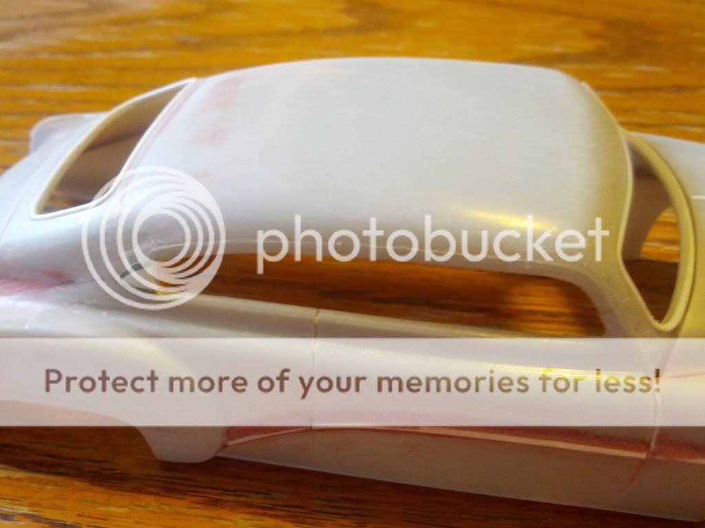

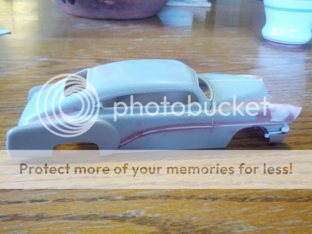

Posted 07 April 2013 - 08:03 AM
Got a bit more of the little, yet important, stuff done this weekend. I managed to clean up the edges between the hood/fenders and the body. I had to glue some styrene strips in yo close up the gaps a bit. I removed the windshield and rear window trim and replaced with .040 half round and sanded off the door handles and beltline trim. I will replace the trim with more .040 half round.
I also filled in and reshaped the rear side windows and filed off the drip rail and filled in the top of the door frame.
Lastly, I removed the stone guards in preparation for some custom fender skirts.
That's it for this weekend. As I said, a lot of work on this one this weekend, but not much to show for it. I will hit this soon with a coat of primer to see where I'm at.
Comments welcomed.
Later-

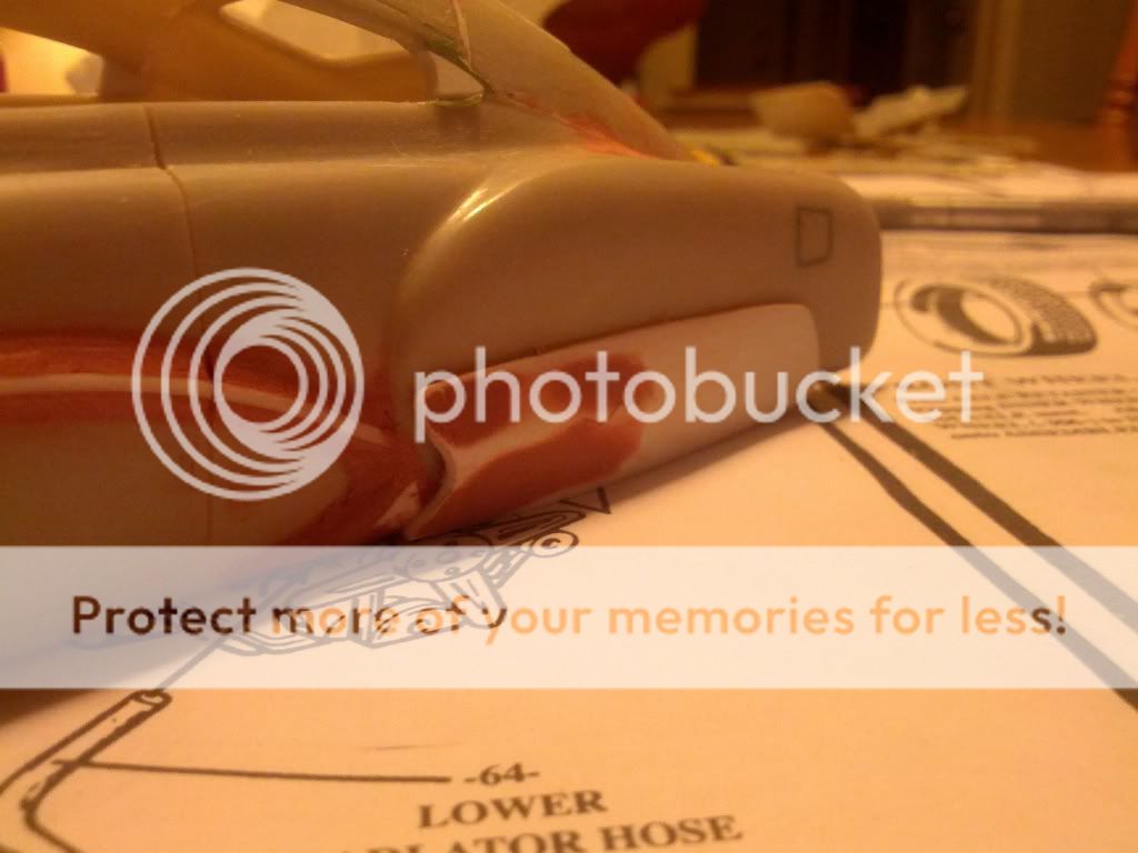

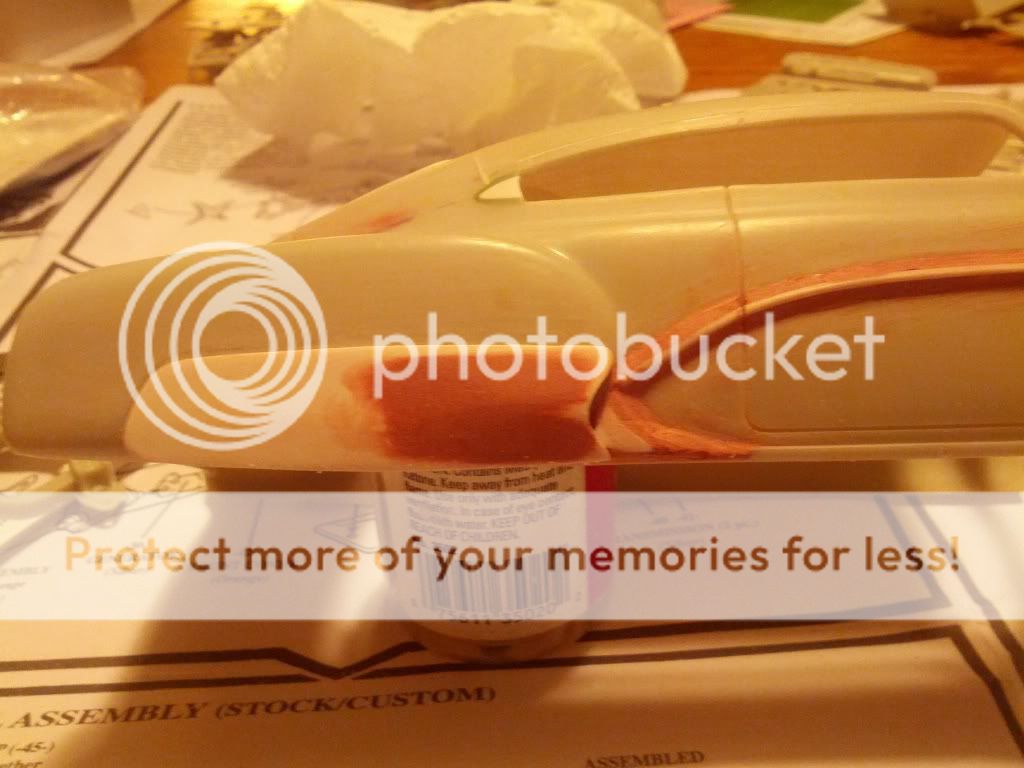

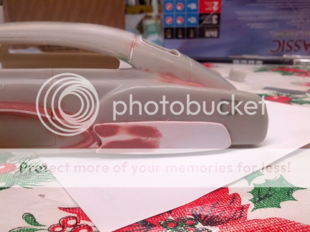

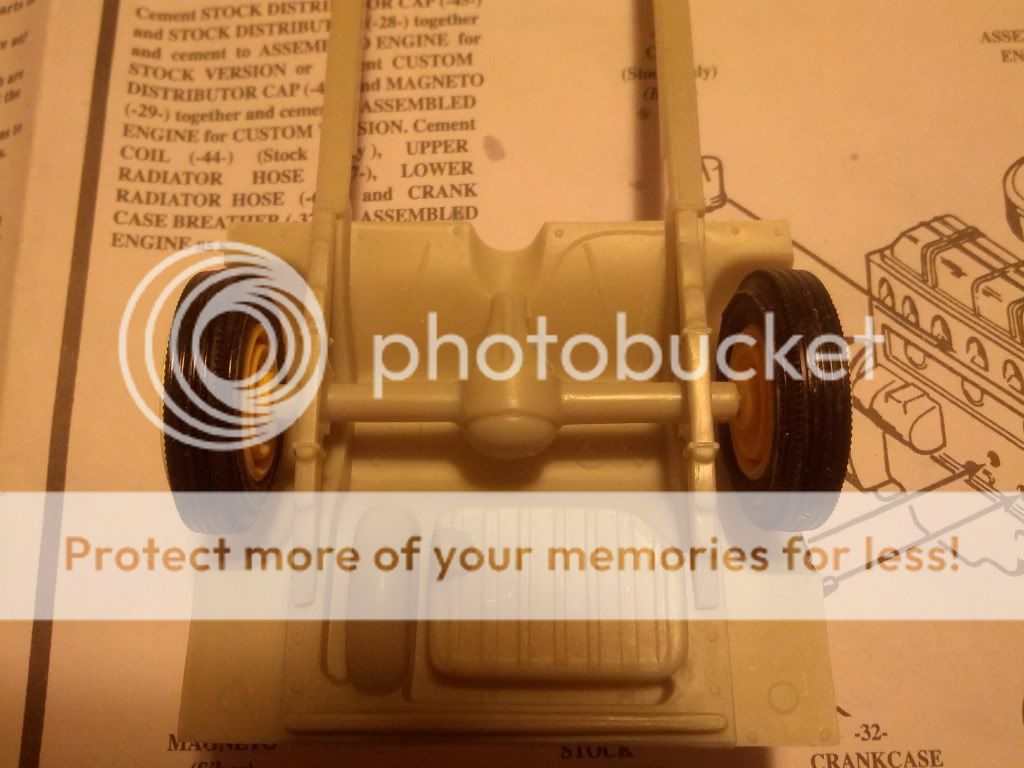

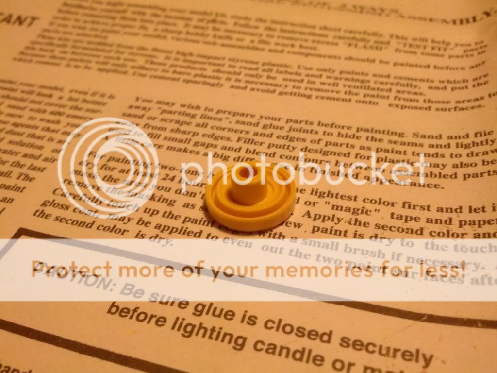

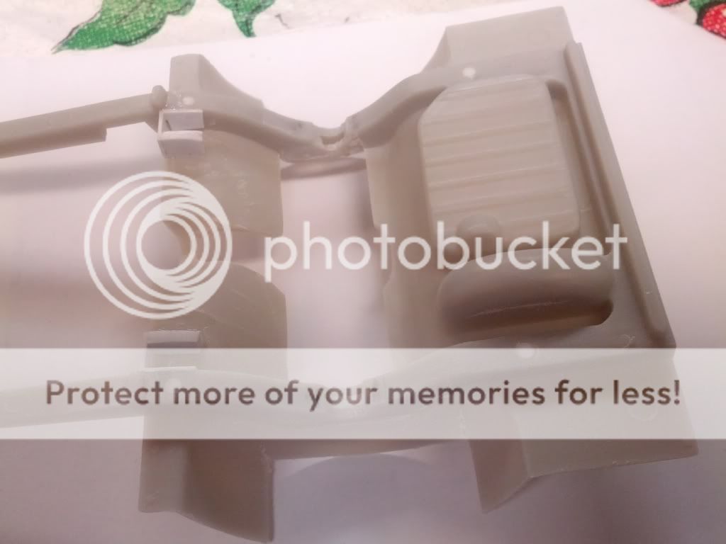

I did a quick bit of work tonight on this. I made some fender skirts similar to the ones on the VC and did a bit more molding and shaping on the bottom of the side trim.

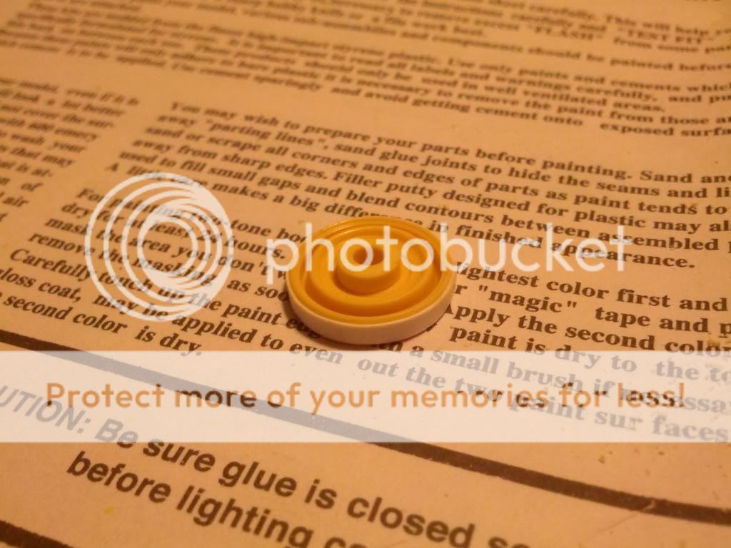

Next, I added some styrene strip to the edges of my wheel backs to tighten them up in the tires. While at it I shortened the wheel mounting point a bit to narrow the rear axle width to fit in the rear fenders.
Here are a couple of shots to compare the original width to the narrower width.
I've got enough room now for the tires to fit behind the skirts now. Next is to lower the rear suspension. I've got to go low enough for almost, if not all, of the rear tire to be hidden. I'm probably going with Modelhaus 57 Caddy caps in the front. Anyone know where I can get some small chrome bullets for the center of the caps? PM me if you do.

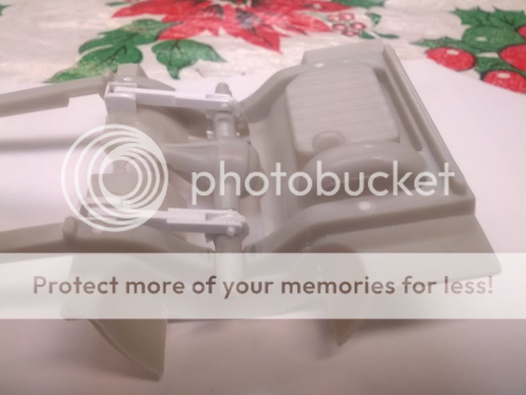

Posted 18 April 2013 - 10:49 AM

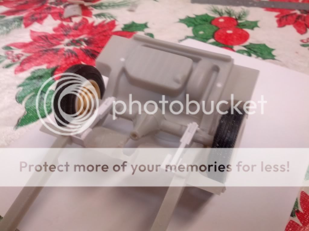

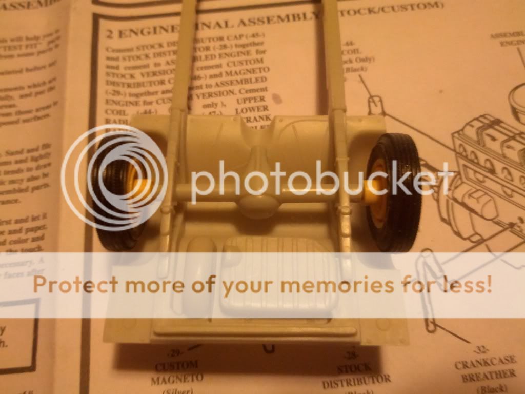

I did some work on lowering the rear end. I cut out the floor and C notched the frame.
Before this the ride height was such that the fender skirt JUST covered the bottom of the wheel.
This is closer to the ride height I'm looking for.
I will be making an airbag system for this once I get the floor repaired.
Later-
