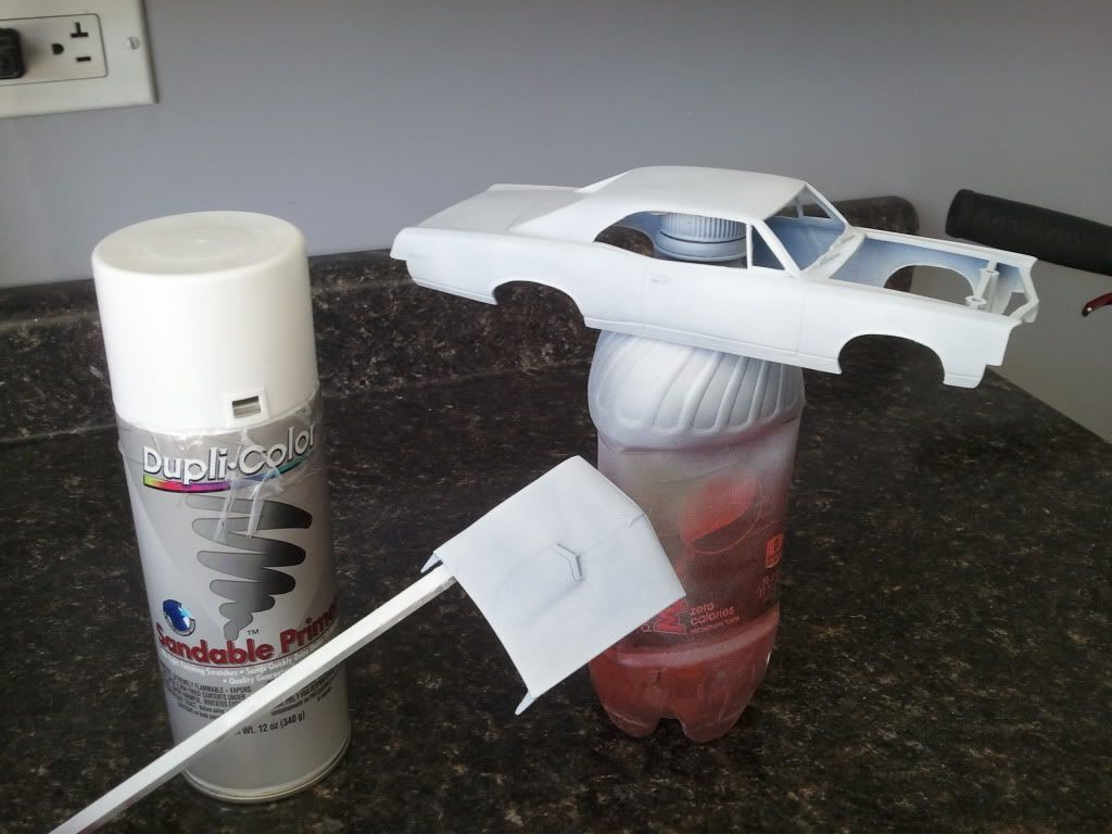

Here is the body and hood after 3 mist coats of Duplicolor primer
I will let this dry over night before sanding some more areas that revealed themselves after the primer was applied.  The A pillars need some attention as it looks like they have been cut and modified at some point of the molds lifetime.
I have seen several members apply BMF over the logos and badges of bodies and then using the appropriate thinner on a swab remove the paint to reveal the BMF after every coat of paint.  I would like to do this on this car and wanted to know when to apply the BMF.  Should the BMF go on over the bare styrene or over the primer?

Generally, the foil should be applied to bare plastic
BUT....
With a decent paint job, you can foil the primer and still have it work. The idea is give the foil the best adhesion possible.

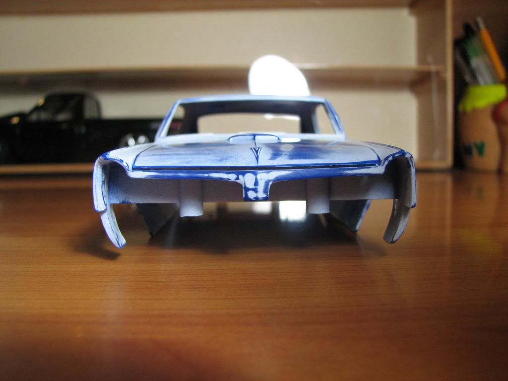

Small update -
Body and hood filled and sanded where needed.   Also had to sand the hood and fenders a bit to get a nice flush fit when closed.

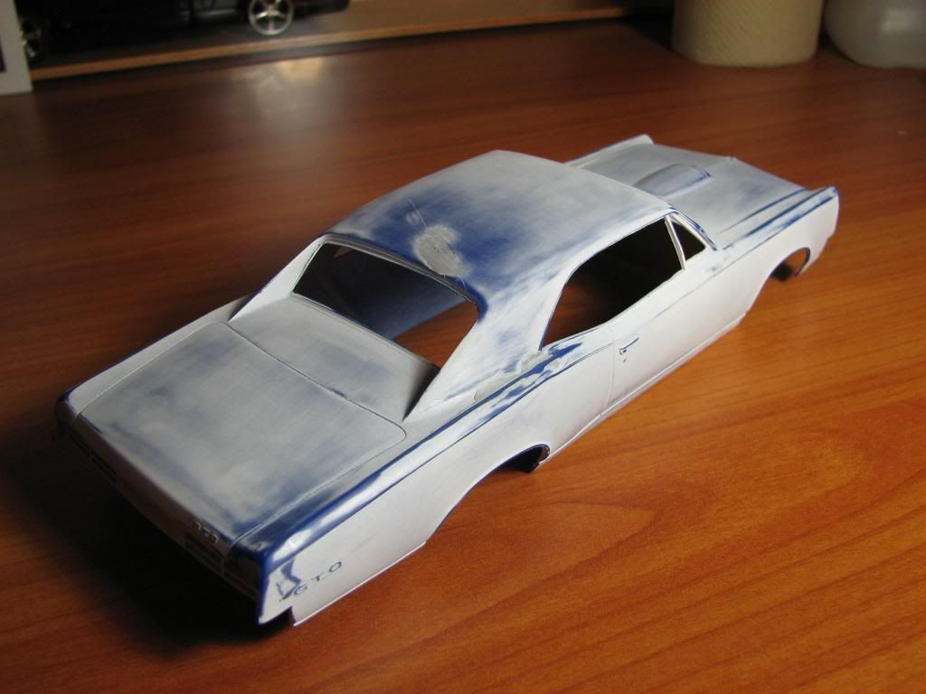

I wasn't happy with the work I did on the mold lines coming off of the C pillar.  So sand, sand and more sanding!

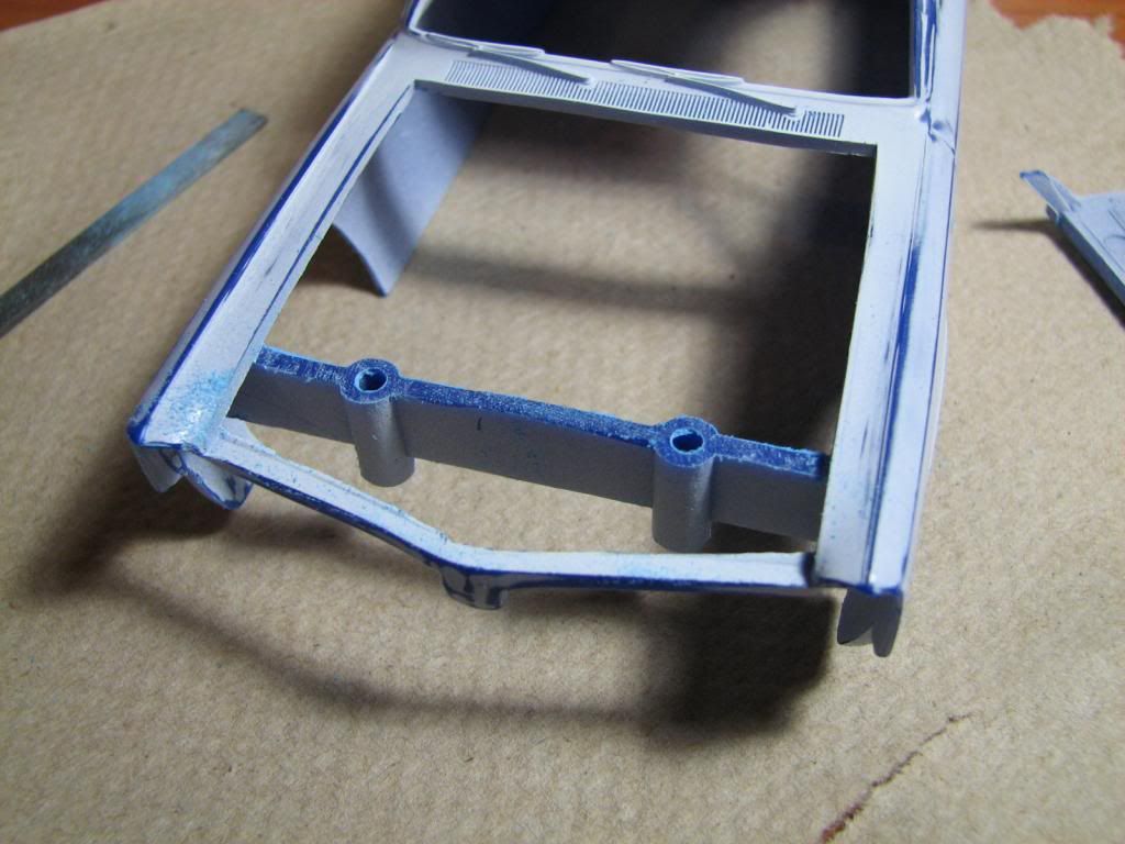

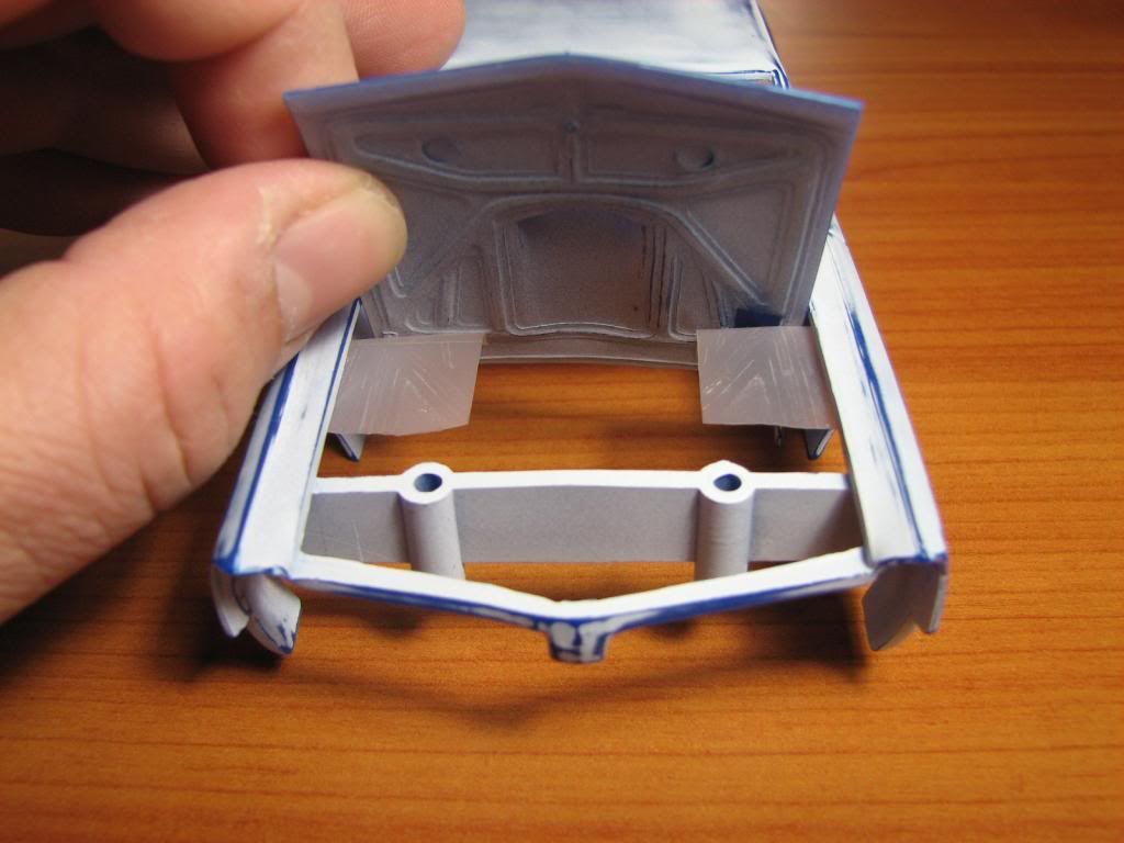

Also worked on the hood some more today.  The hood wasn't laying flat on the header panel -
A closer look revealed that the brace was not letting the hood sit flat -

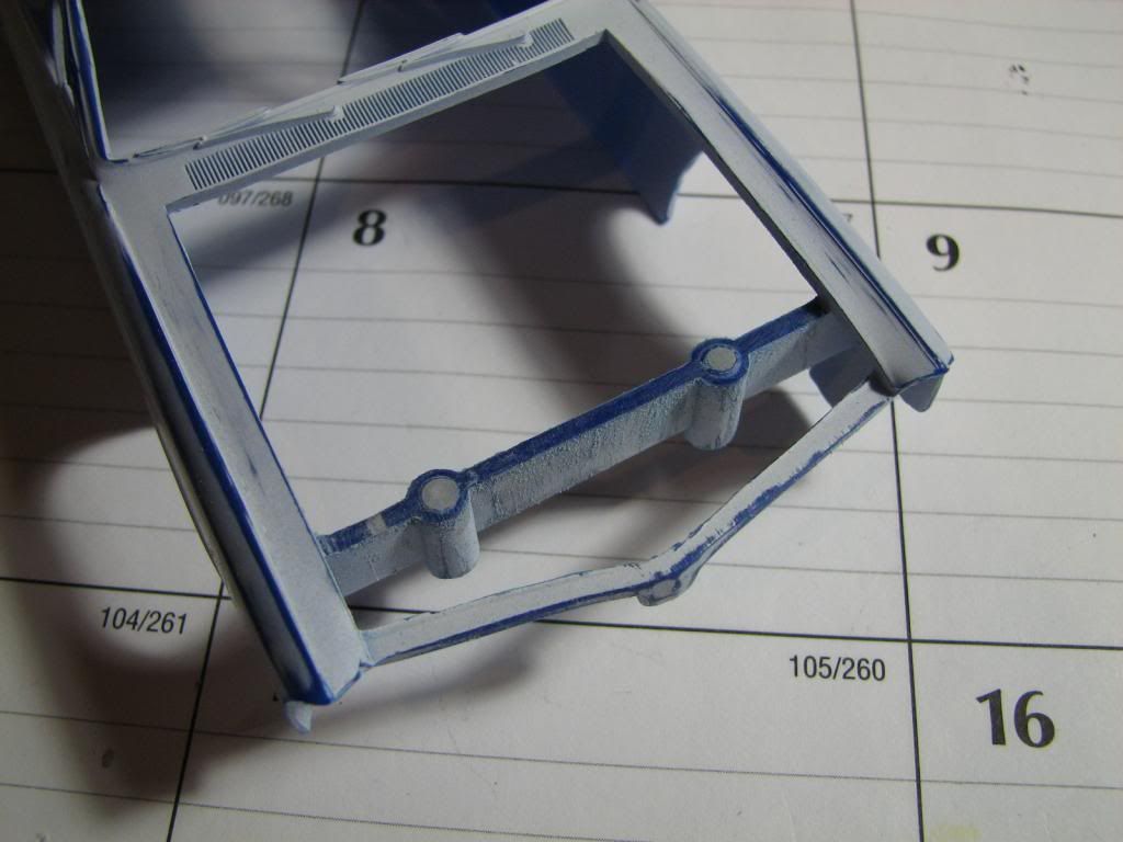

Filed down the bracing (the passenger side needed more work) -
Much better -
Filled in the screw down bosses and sanded down.
