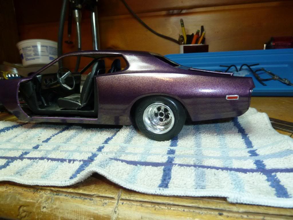

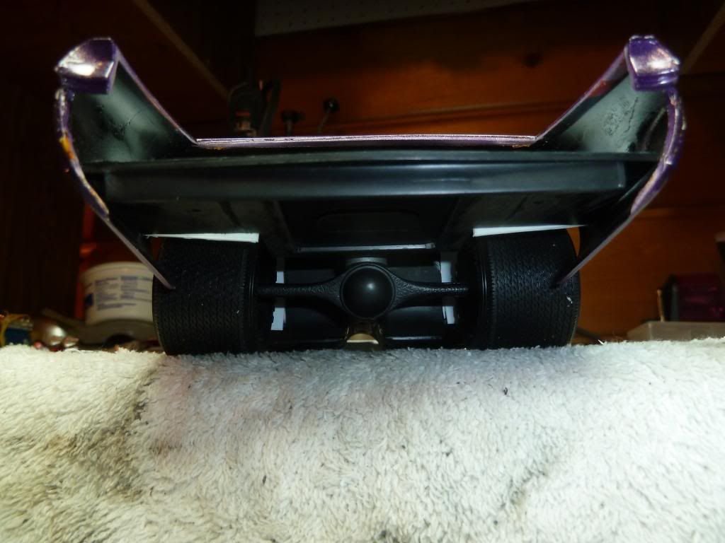

This is the rear height i'm shooting for. The front end will fall in later.
There's a lot of work ahead on this one.

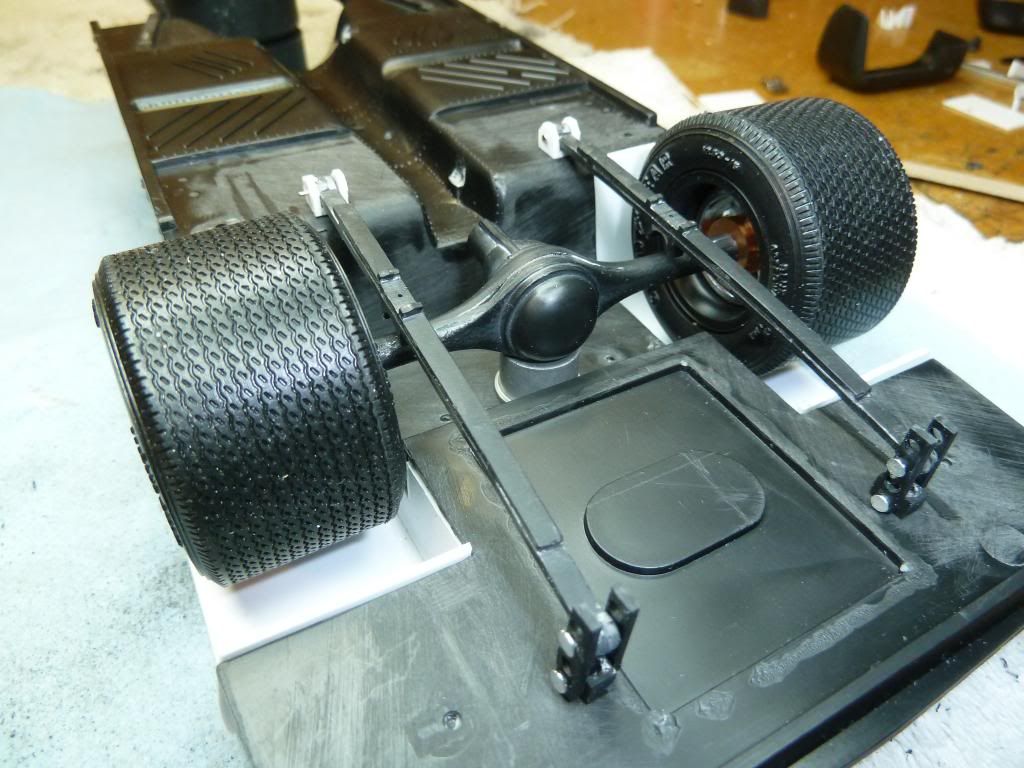

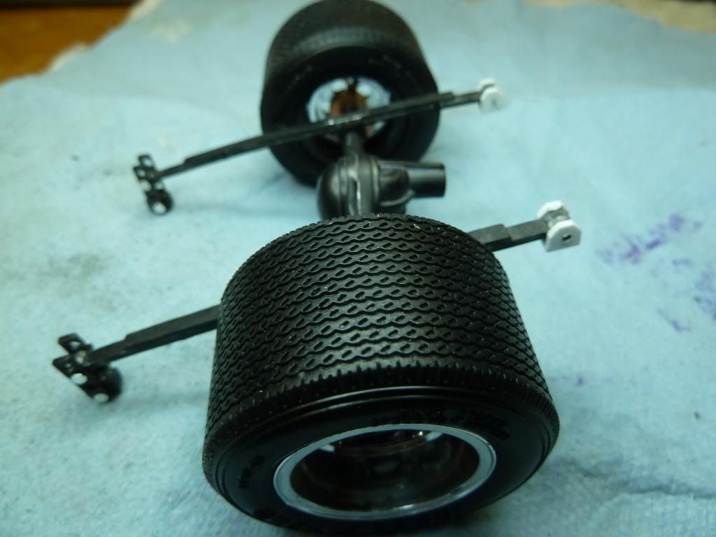

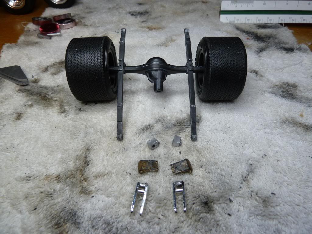

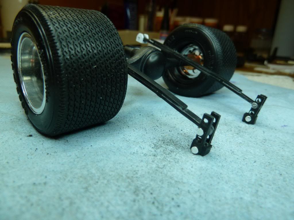

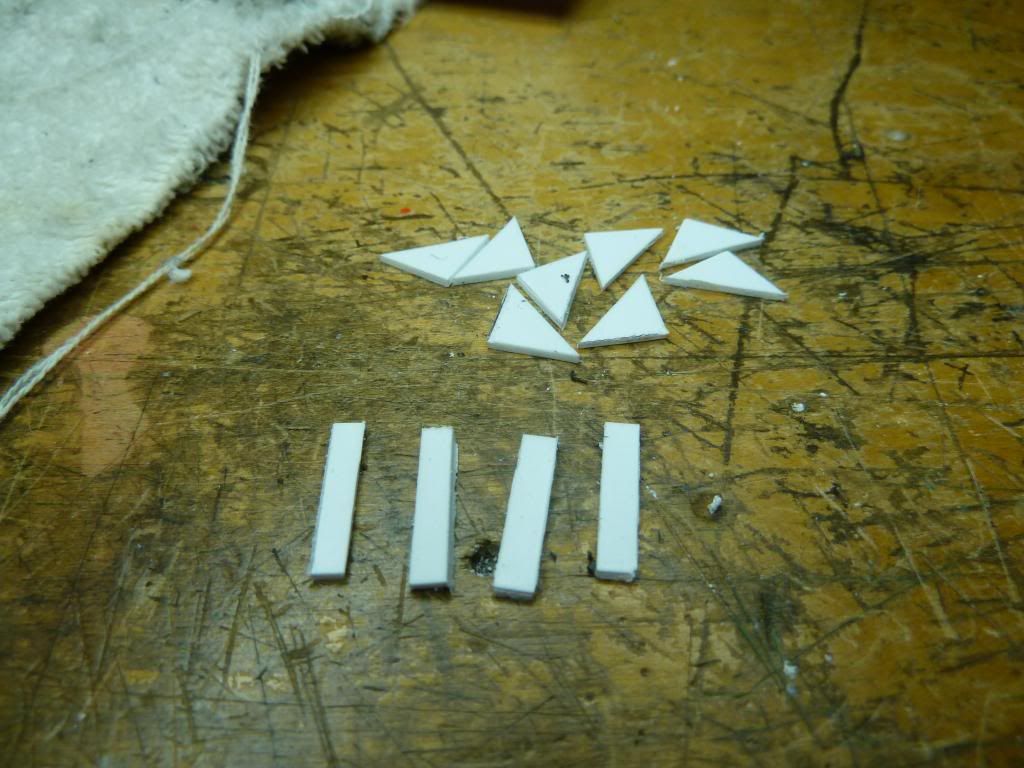

So. I got some time on the car after the "Honey Do" list was handled. First task was to shorten the rear axle. Then see if it was going to work out.
I am trying to keep the old school approach on this car by moving the leaf springs inward and building another set of coil overs then re-fit the shackles rather than building a pro stock set up to replace the suspension. I cut the old tubs out and am making a mold out of wood to bend some new styrene tubs (only wider) to replace the stock ones but keep the same depth.
Here's some photos.
Stock rear hardware.
Looks like it's all going work out.

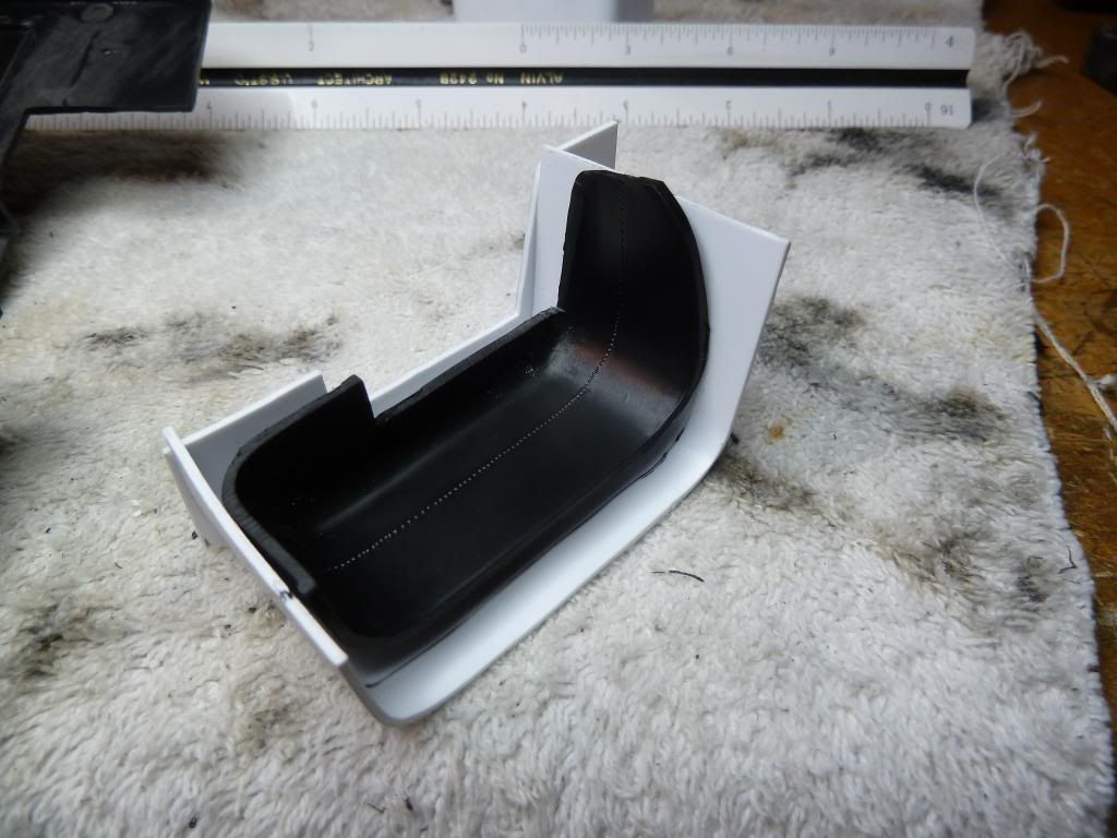

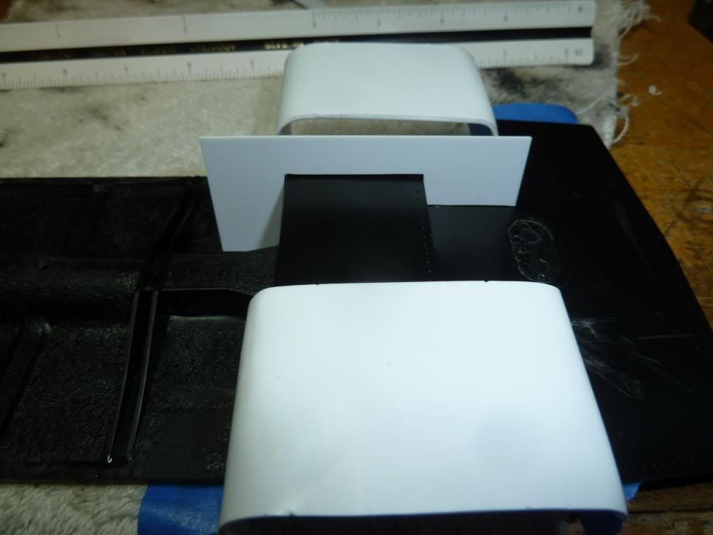

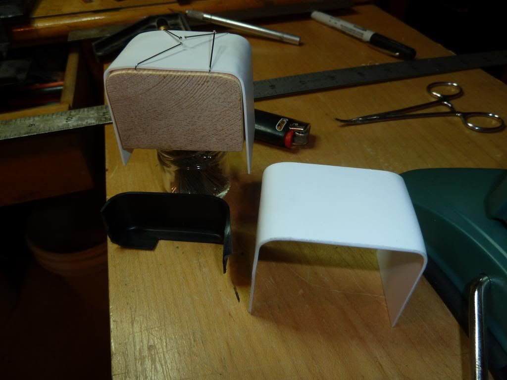

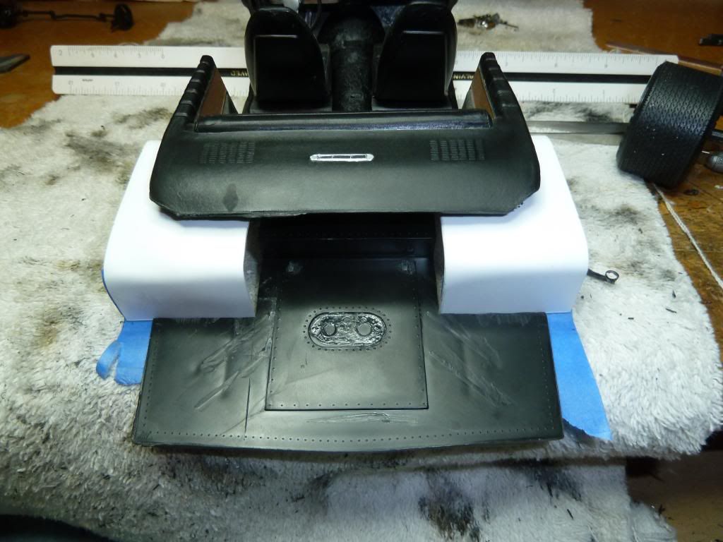

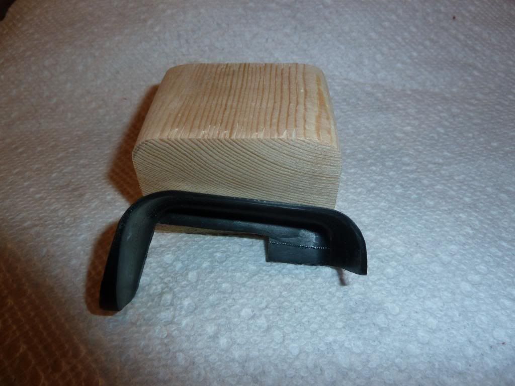

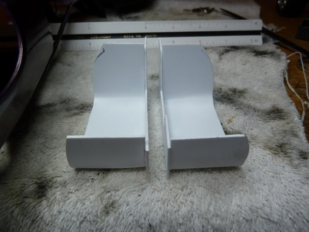

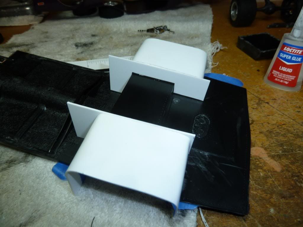

Lots of progress today. I started by using the old wheel tubs to make a jig out of wood for the new tubs. Then cut some styrene, layed them out on the block and carefully heated them with a torch till they bent.
A test fit proved they would work nicely.
Then I cut 2 more strips to fill the gap. They came out quite well.
I'll be using the old tubs to scribe the angle on the new tubs so they form tightly to the body on the inside of the trunk since the lid is hinged and i'll be putting some detail in it also, probably the battery and a nitrous bottle also be able to see the top of the fuel cell in there too.

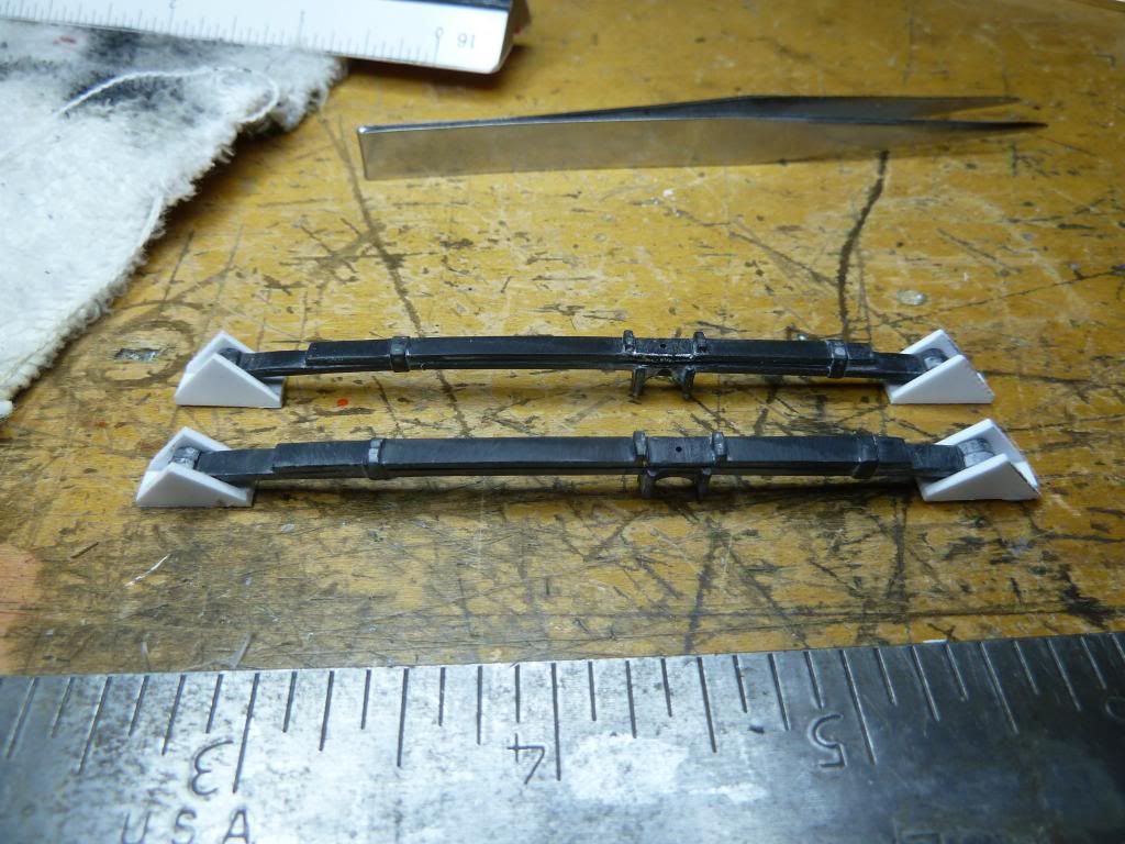

I also started working on the new leaf spring mounts.
A little bit of cutting and sanding should get them ready.

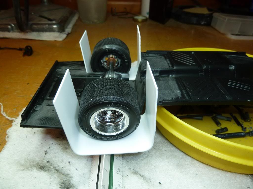

The one and only thing I want to point out is that having worked on and been around many "tubbed" pro-street cars, I've never once seen a square tub. They are always round. I only point this out because the trunk is hinged, and if you want it to be "correct" the tubs should be round. Not that yours look bad at all, you did a great job building them.

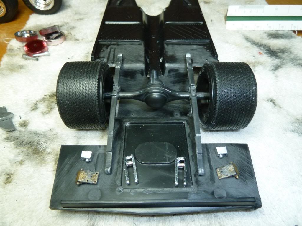

You're gonna need some movement in those rear springs as well. With both ends solidly mounted there will be no room for the springs to move as they flex. You need some shackles. DSC_6108.jpg

Gregory: Yes I haven't forgotten about the shackles. I thought that they would fit differently than they do so i'm going to re-do 2 of the leaf spring mounts. Thanks for those reference photos though. That first one is a sweet build. What are you putting it under?

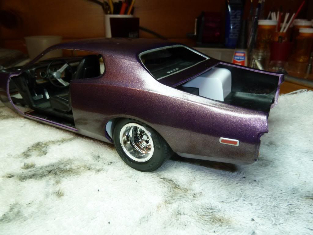

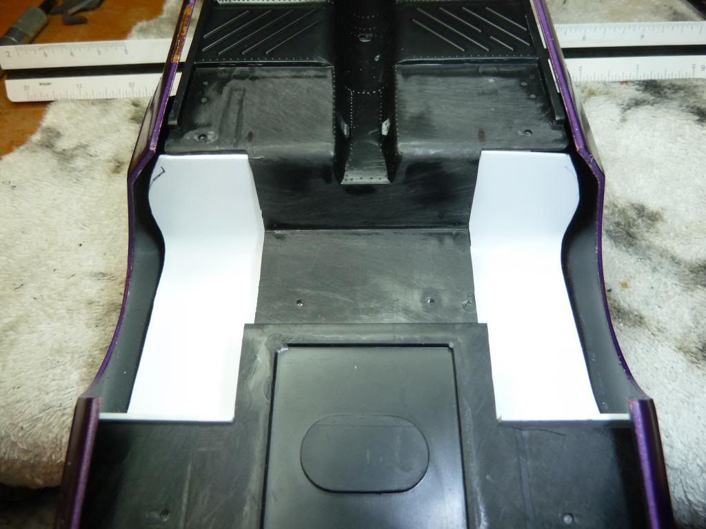

So....not a ton of progress but I was able to get a little bench time in. It's funny that as soon as I decide to do another build that the honey-do list appears. I was able to cut down the new tubs and contour them to fit inside the body. I ran a bead of glue around the inside now that I am sure of the fit. Next will be some primer and bondo to fill in the gaps (which I anticipate will be few)

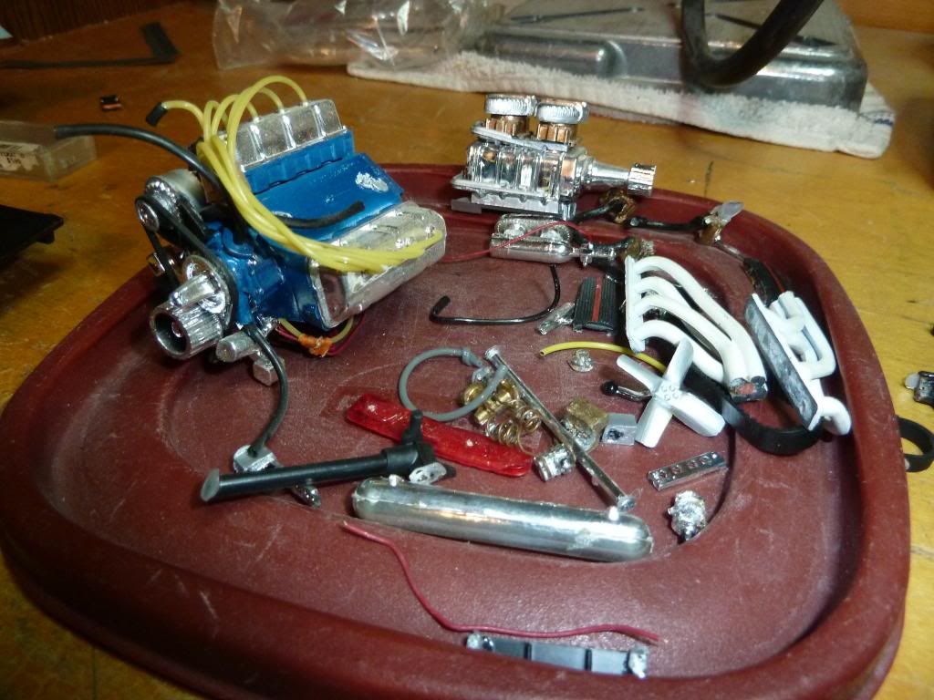

I started to sand and form the leaf spring mounts and soaked the chrome off of the shackels. Been wondering about the coil overs though (Sorry for the lack of photos). The original kit had a pair on each side (total of 4 on the rear and 4 on the front) I want to keep the same design but not so sure of my confidence in scratch building them. If any one has some photos I would appreciate them for reference. The issue is that they will be shorter than the originals. While waiting for glue to dry I started on the battery and nitrous tanks that will go in the trunk also..
Hopefully I will have the whole weekend to play around...Weather man says "SNOW" tomorrow...Sounds like a basement day to me
All traced and ready to cut
Cut and ready for a trial fit.
I guess it'll work?
This is what i'm shooting for..
Pretty wicked view of the what second place would see. Minus 200 hundred pounds of chrome...
Leaf spring mounts roughed in..

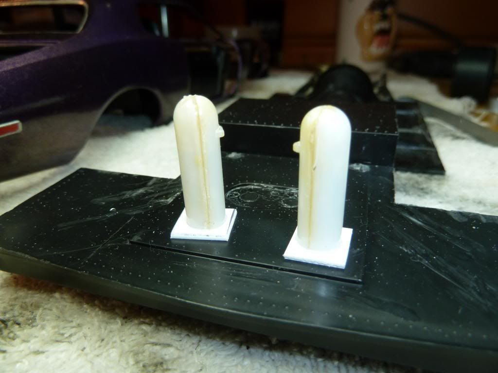

Starting on the nitrous bottles..
Soaked the chrome off the shackels. Not sure if I can use them or have to build new ones. They are pretty thick for a realism..
