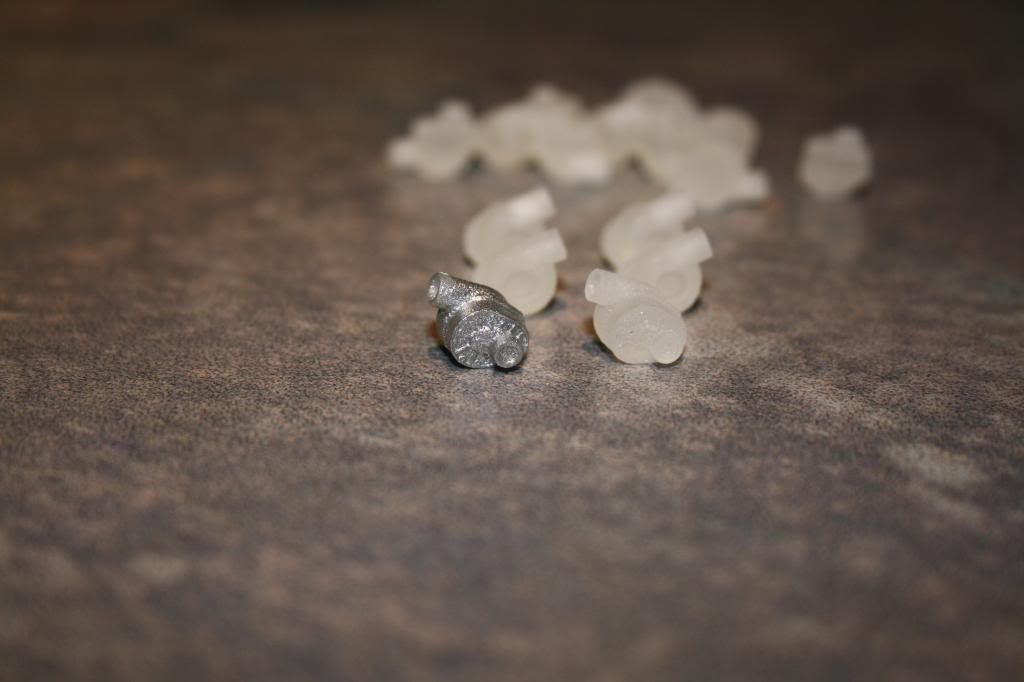

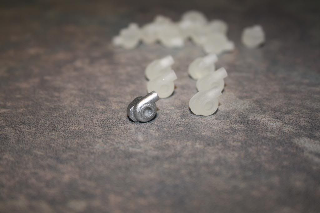

first few attempts werent great
but i fixed it got it close without pushing shapeways limits, the airhorn is for show so are the turbo splines.but i got it up on my site

Frank I give you credit for trying this and coming up with what you did. However, IMO at this scale parts this small 3D printed are a fail. The grain/texture on a piece that small will kill its visual appeal after paint is applied. Also, trying to smooth out the texture on an item this small with any level of detail remaining will be next to impossible.

Thanks, true but theres stuff being printed smaller than this and theyve come out great but this wont be hard to clean up found out they sell sanding sticks with points on them thats why i returned to making small items im also looking at a sand tumbler for projects like these

something looks really wrong with the clocking of the discharge tube to the gearbox. it needs to be turned more. would be nicer if it were 2 parts so you can clock it where you need it. most 1:1 units you can

There are tons of items printed smaller than this, looking great as a highly detailed model part in this scale? I have yet to see such a thing. I have seen 3D printed turbos, intercoolers, manifolds, etc. in 1/25 scale and while they look cool during "mock up" they are more a "novelty" in reality with the grainy surface texture they exhibit. You cannot yet achieve very crisp highly detailed pieces of this size in this scale right now (think injection molded or resin cast quality). A turbo or procharger like unit in 1/25 would be very small and highly detailed. Trying to rid the printed piece of its texture in this size would simply remove any of that detail you did manage to print and ultimately be a waste of time and effort. You will essentially wind up with a sanded down unrealistic blob. Gook luck with your endeavor however.

VERY LITTLE clean-up is needed. there is a bit of a texture, but that could be knocked down with a sanding stick in minutes. For the price /amount/ and quick turn around...... Very well worth it.
