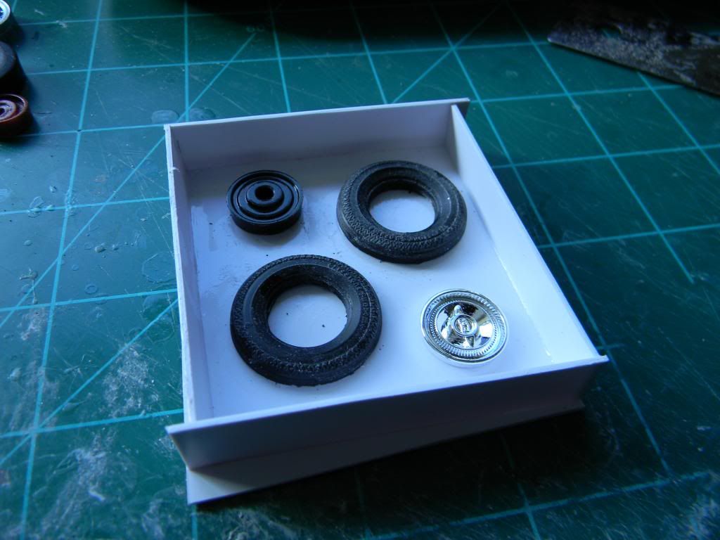

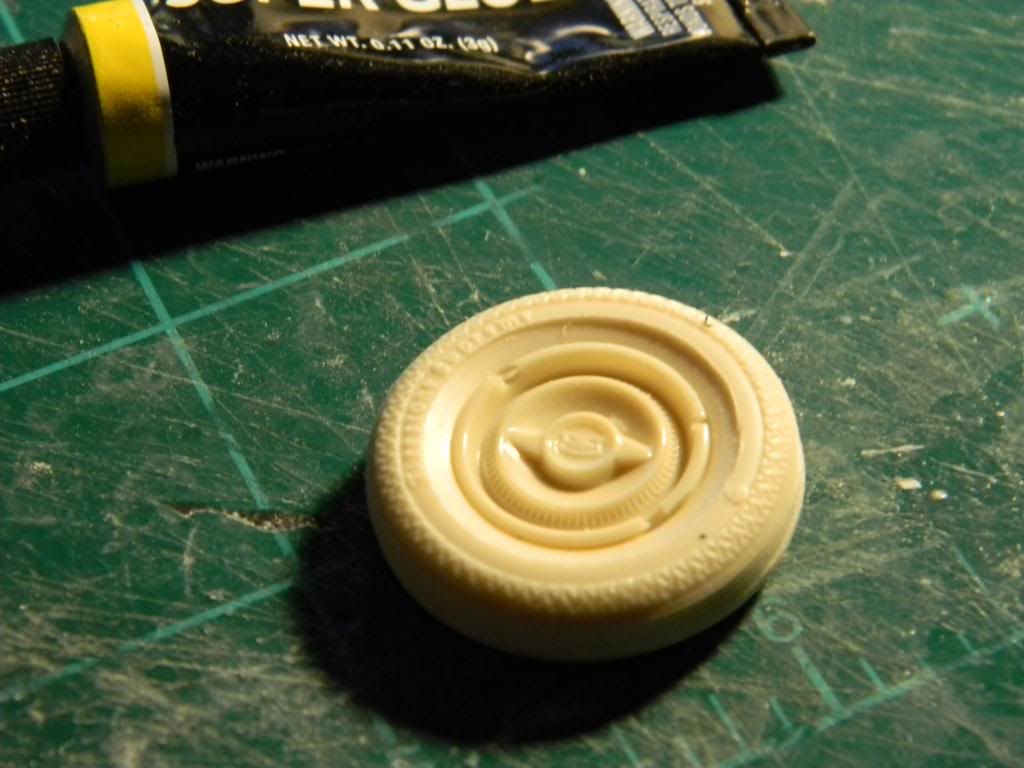

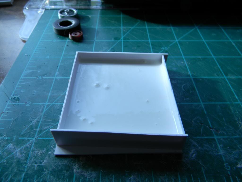

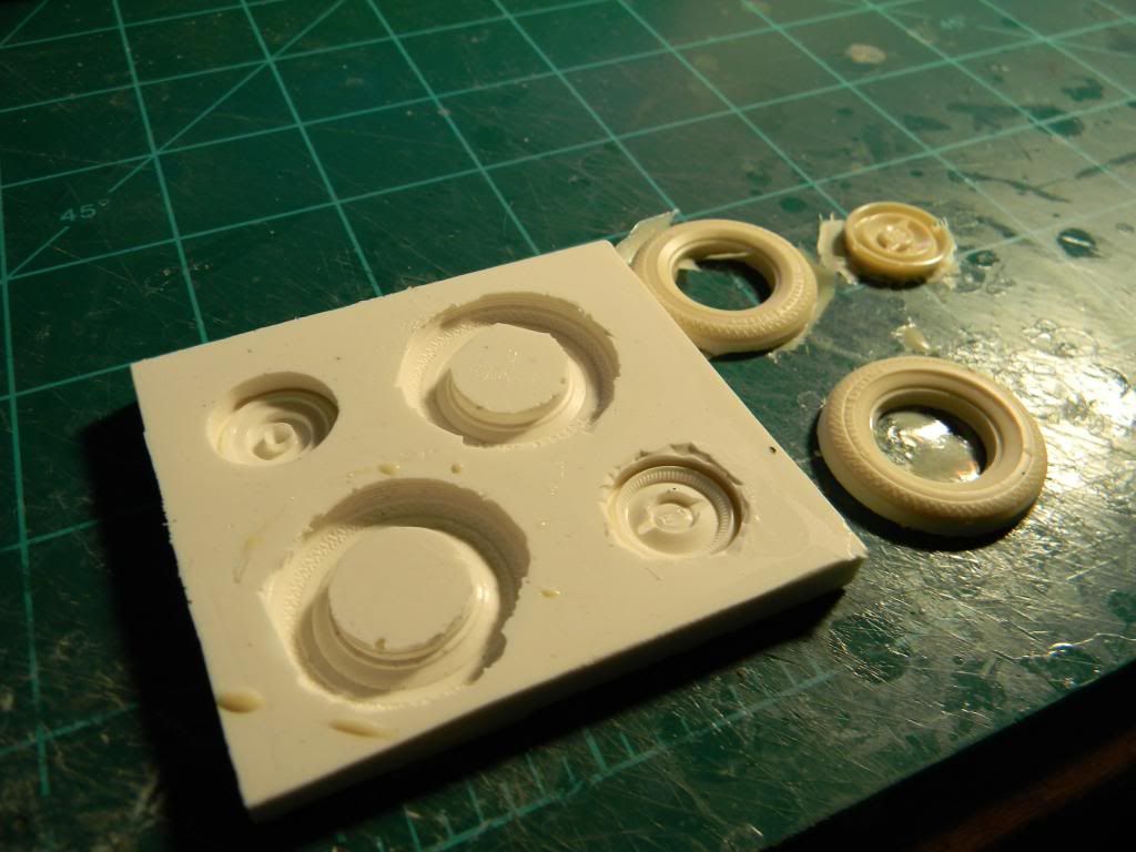

Posted 29 April 2013 - 03:56 PM
Here is a quick down and dirty tutorial on the casting....Masters,,,,I cut the tire in half and put the inside and out side rimes together and mounted them on plastic,,,and glued up some sides. about 10 to 1 mix.
poured in the RTV,,,notice the bubbles coming up.
after the mold dryed I removed it from the master and poured resin 1 to 1 mix and let it set up..about 5 minutes.
I sanded the backs on a sheet of sand paper until the flash fell off and glued the wheel halfs together for finished project ready for paint shop. Notice the spots on the rim that will have to be fixed on the next pour,,,,a quick swipe with a tooth pick in that area before the resin sets will fix it.
the RTV set up in about 3 hours and resin about 5 to 7 minutes.....You can make parts you need and save origionals for later. Or if you only have 1 part and need several for a project you can do them quickly. This is good for all small parts on your desk top. No special equipment was needed...
I hope this helps you out..Anne................... B)
