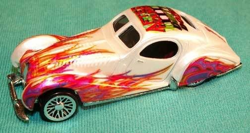

I normally don't even use MicroSol, MicroSet or Walthers exept in extreme complex curves,
Like this,
MicroSol will weaken after a few years, and Walthers is so strong I thin it with older MicroSol.
In most cases neither the Set or Sol is necessary.
