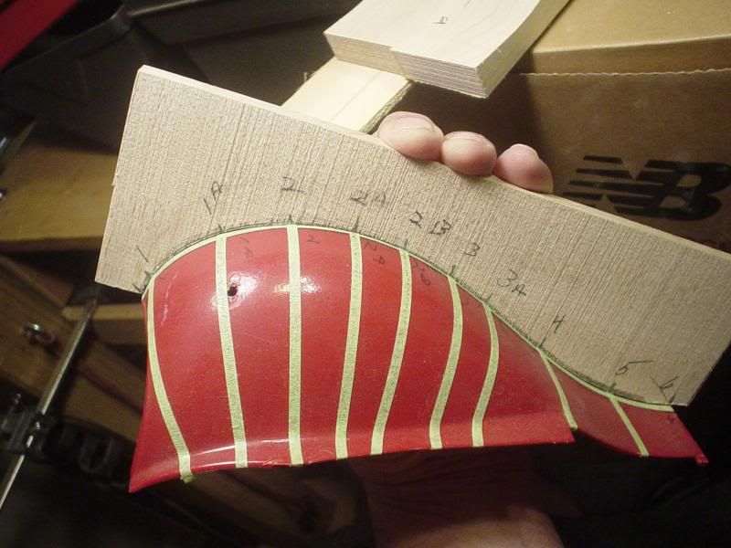

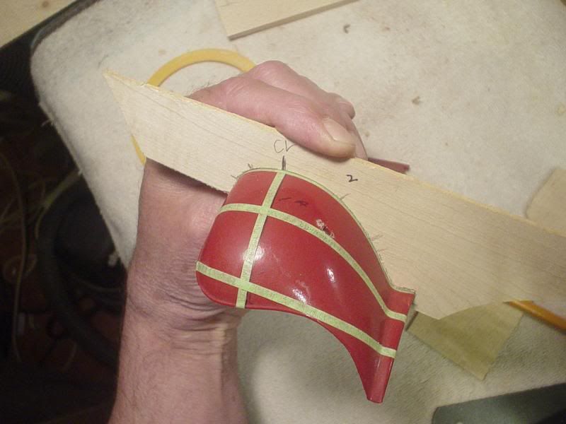

Posted 10 May 2013 - 02:00 PM
So here's what's fixin to happen.
I've got a shape.
I've got a piece of flat sheet  metal that I want to conform to that shape.
To accomplish this the metal will have to be either stretched or shrank.
Folds in the paper represent where the shrinks will need to be, in order to accomplish the final shape.
Rather than just a few pleats in the paper, the metal will recieve a series of smaller shrinks all along the edge of the fender.
On this side, you'll notice that the folds go very deep into the paper.
The metal shapers who's work I've studied, all buid a panel of this nature in two pieces.
By doing this, a series of smaller shrinks will be pulled to the seam line where the two will be welded together.
An easier, more controllable way to work the panel.
Edited by Ognib, 11 May 2013 - 02:46 PM.

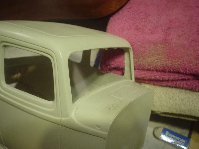

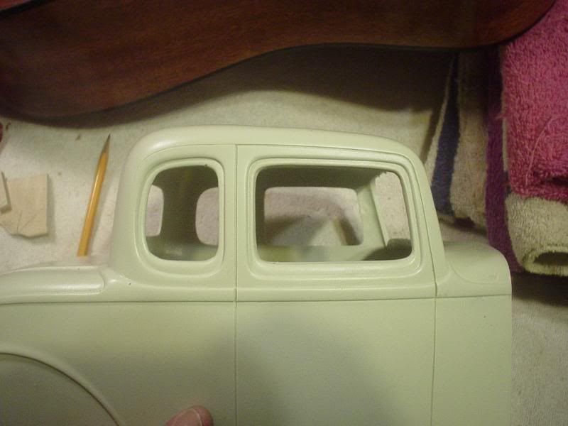

Posted 11 May 2013 - 04:55 AM
Started out looking for a 3 window, but I've got a roadster & roadsters are cool, so that's what I'm going with.

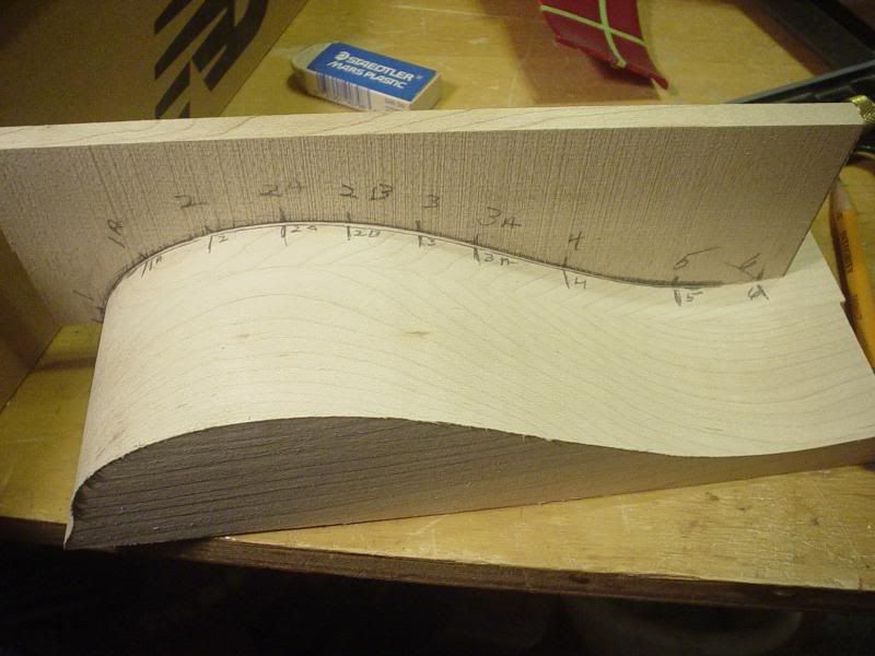

Posted 11 May 2013 - 02:30 PM
Laying out the grid for cross templates & inner fender edge profile.
What a great design!
The pure elegance of simplicity.
Gonna be tricky carving all of this in to the maple, crisply, accurately & with proper perspective & relief.
A worthy challenge!
Edited by Ognib, 11 May 2013 - 02:42 PM.

  • Full Name:Ray Haines

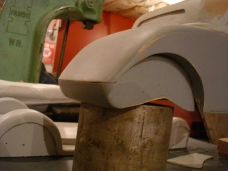

Posted 12 May 2013 - 04:46 AM
I jigged the body so the tops of both 1/4 panels are square with the template material & then transferred the centerline, which is the high point of the body, down.

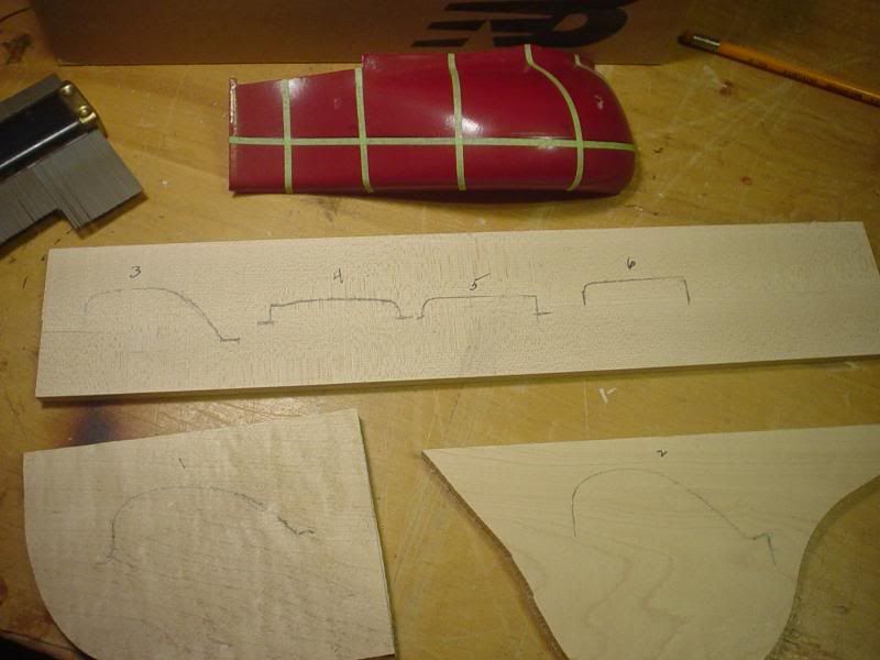

Posted 13 May 2013 - 03:51 AM
I've been thinking about the feature lines on this body.
They are only .030" or so tall.
My thoughts have been to use .016" for body skins, & I'm wondering how crisply this will form around such small dimensioned feature lines on the buck.
If I tig the body together, I could safely solder over previously welded panel join lines without fear of "de-bonding" previous work.
So my thoughts are to perhaps solder aluminum wire to the body skin & final shape the feature lines with dremel & files.
It would certainly shorten the length of time required to do the bucks...not having to carve in such delicate features.
Any feedback on this will be appreciated.
Edited by Ognib, 13 May 2013 - 09:12 AM.
#74 vintagedragfan
vintagedragfan
  • 2,641 posts
  • Location:Richmond Mo,
  • Full Name:Bill Davis
Posted 14 May 2013 - 01:22 AM
Ray, why not add the body line feature to the buck after it is initially shaped, it would be a lot easier to add it rather than try and sculpt it in to the buck, you could use brass or even wood, then tack it or screw it on possibly, then work the fastener heads last.
just a thought

Posted 14 May 2013 - 11:34 PM
just a thought
Thanks, Bill.
One of the best things about doing this...figguring out the most effective way to get it done.
Educating myself...trial & error...the scientific method.
It's like...how ya gonna know what to do, unless you know what to do.
Edited by Ognib, 15 May 2013 - 02:38 AM.

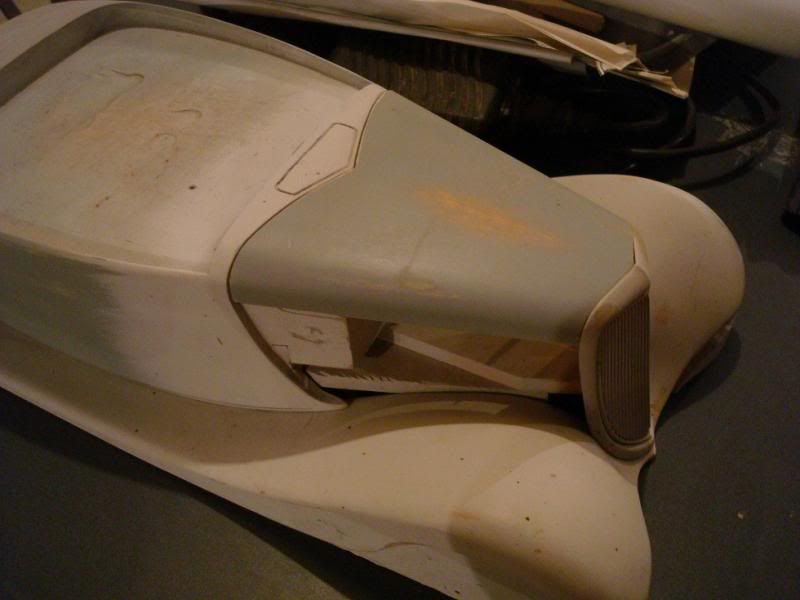

Posted 14 May 2013 - 11:58 PM
Yesterdays results.
You'll notice, that by the 3rd point, the profile is beginning to flatten out across the top, as it transitions down towards the running board.
