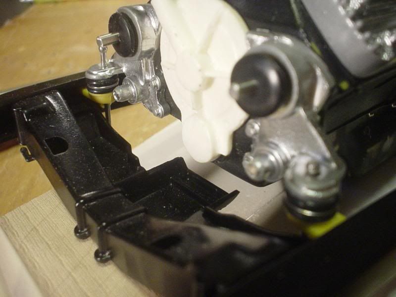

Posted 14 June 2013 - 05:25 AM
I drilled through the lower water pump outlets & then with the appropriate sized drill bits, reached through & marked the front of the engine block for later reference.
Cut through the simulated motor mount cushions & separated the water pumps from the engine front cover with the jewlers saw.
Edited by Ognib, 14 June 2013 - 05:28 AM.

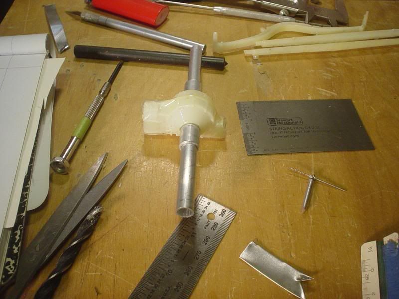

If you'll notice in the first pic in post 121, the water pump has an outside bolt.
The kit waterpump has no bolt boss cast in this location, so I'll be adding a tab here to accomodate that bolt.

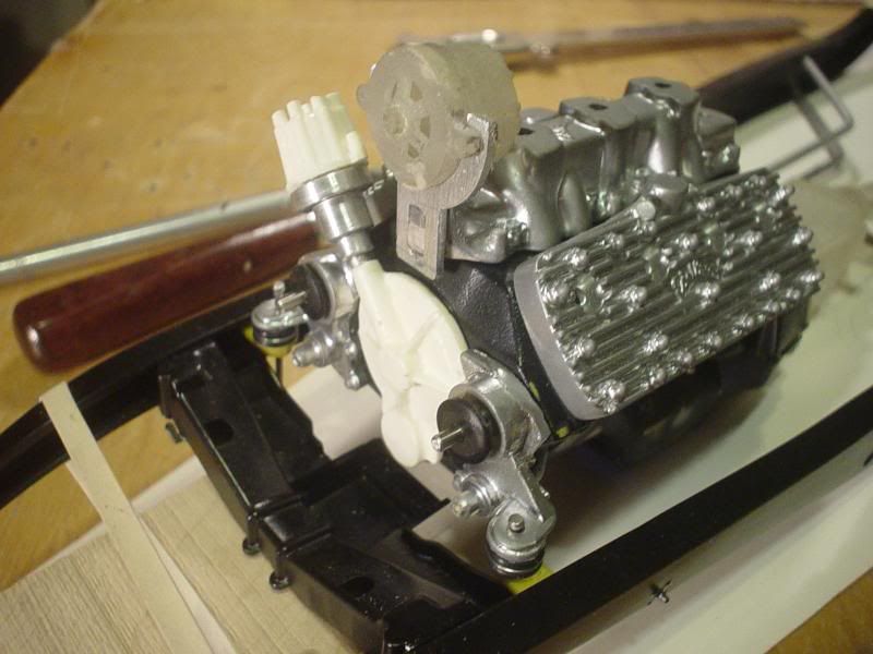

Motor looks better even now, without all that gawdy chrome smeared all over the top.
The magneto, even though it's cast to scale, is too visually large & overpowering for this motor.
Going with something smaller with a tower cap on it.
Rear fenders are going to have to be bobbed a bit behind the tire, which really fills out the opening nicely.  B)

Posted 17 June 2013 - 12:19 PM
That's better, but it still has that plastic engine that's been painted, look.
Humm...

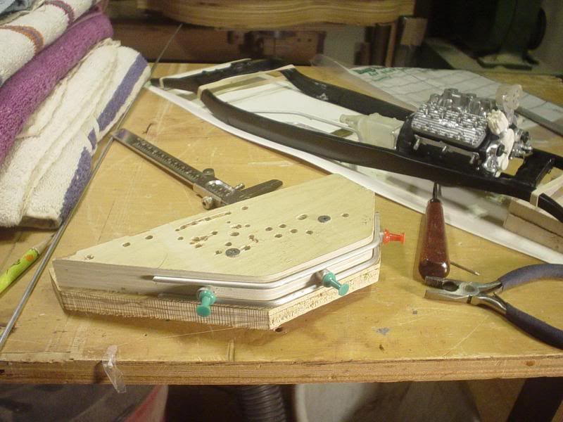

Posted 18 June 2013 - 04:01 PM
Paper template for header base plate.

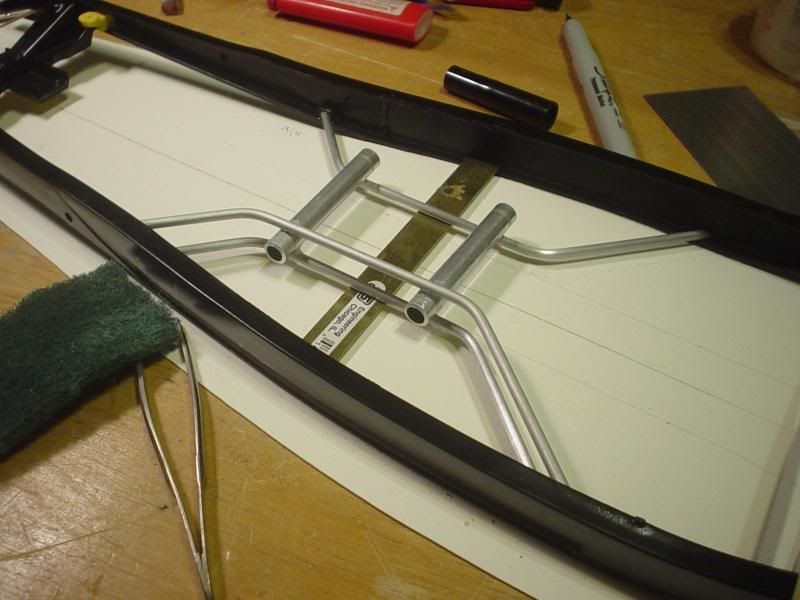

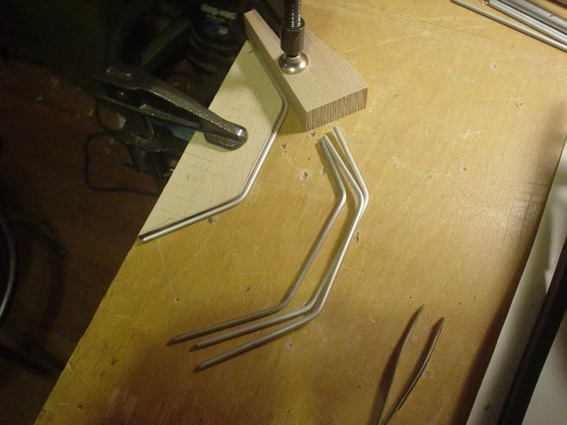

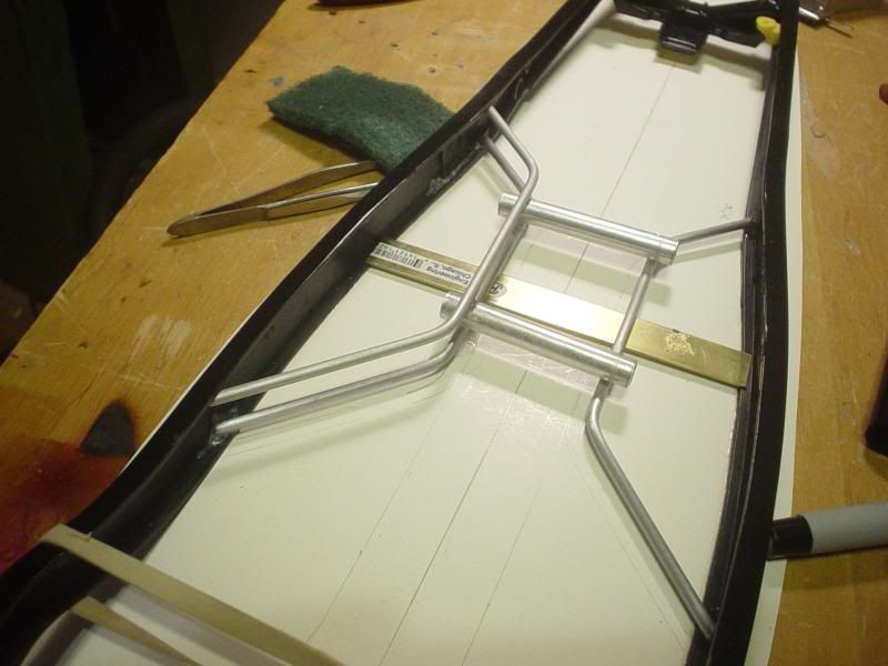

Solid core, silver bearing solder...holds it's shape well, yet bendable...has a nice metal look to it.
It"s 1/8" & that scales up to a 1:1 primary tube of only 1".
I've also got some aluminum tubing that's 3/16, 1:8 of a 1 1/2" tube.
On a 1:1 motor, I'd probably go with the 1 1/2 size, but here, to my eye, I think by the time I got it all fitted into place, it would be too overpowering.
Kinda like the magneto, when I mocked it up on the front of the engine a while back.
Going to get the frame painted & assembled through this coming weekend & get the steering box in place so make sure everything fits nicely.
Edited by Ognib, 19 June 2013 - 03:59 PM.

Posted 19 June 2013 - 02:09 PM

Posted 19 June 2013 - 03:55 PM
Equal length primaries.
