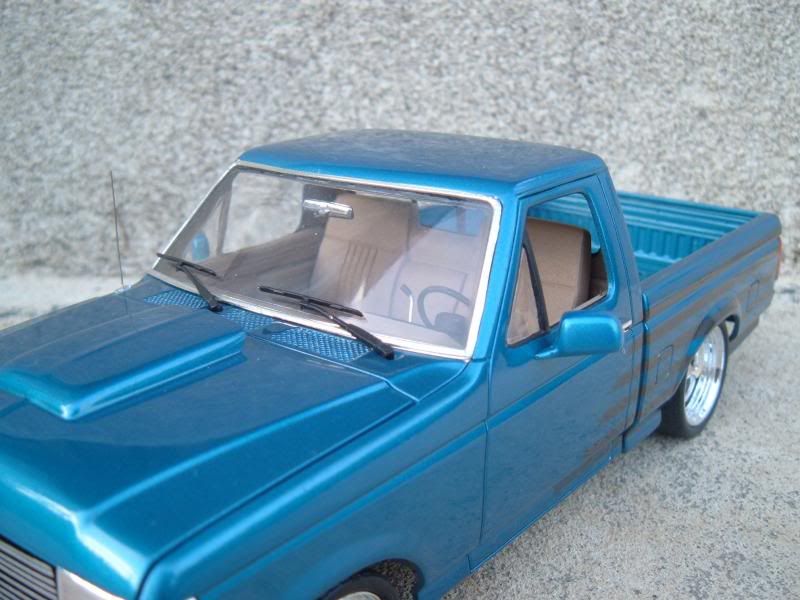

I use the smallest size guitar string for my antennaes.
This is the only photo I have where you can see the antennae very well.
A little tip on installing antennaes: after you make your base, glue it to the body, then drill your hole through the base and the body. Allow the antennae to go through roughly 3 mms, then super glue it. After the super glue dries, bend it over and add more. This will make your antennae super solid and you'll never have to worry about it coming off.

Plowboy, that sounds like sage advice, thanks very much.
