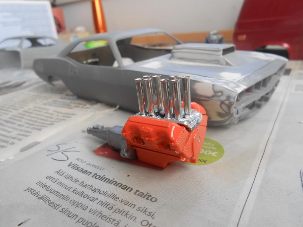

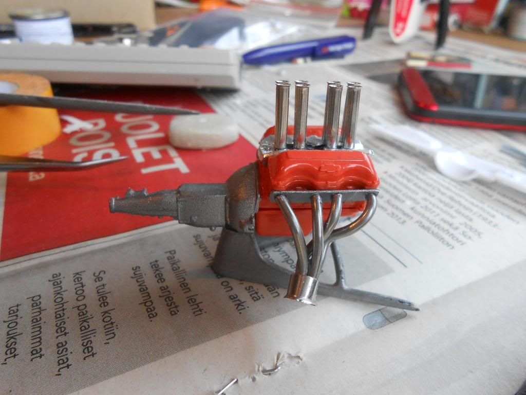

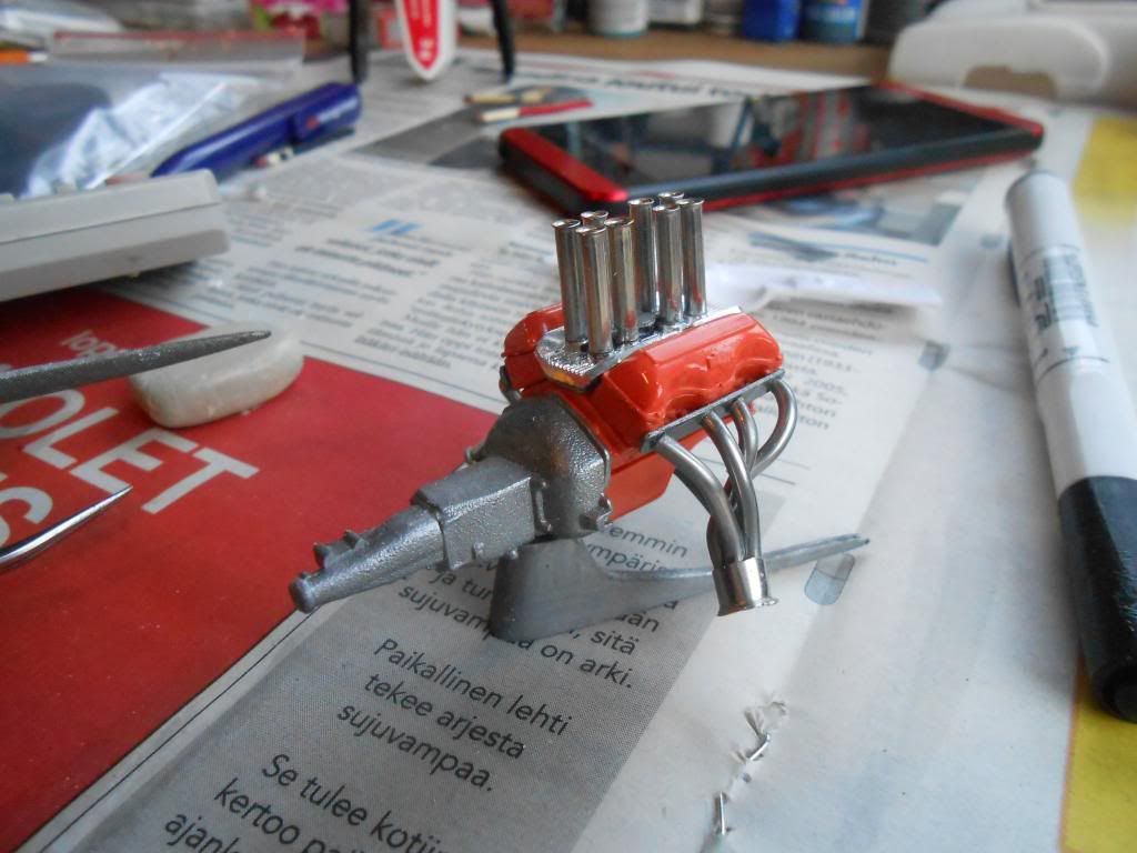

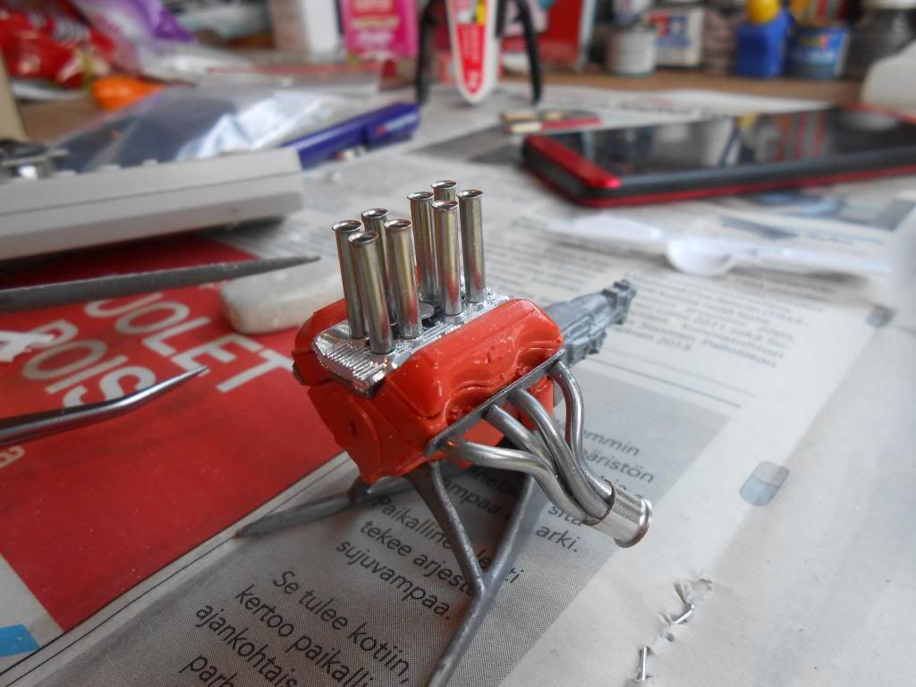

This has been way too long as a Back Burner. I got just the inspiration that I needed when we had a Custom Culture Show here in Finland. I was one of the guys who put together the Model Car-area there. We had three display cases for finished builds and five guys who were building models on the other table to show what this hobby really is. Of course I needed something to fit the theme and I thought "This is it".
I scratchbuilt the headers from solder. Header Flanges are made out of sheet styrene. When I got all eight pipes on their place and glued on, I made the collectors from the same material as I used for those injector stacks, but of course a larger diameter one. I also started building the floor, but it's in very beginning stages and I'll post a picture of it when I get some more work done with it. Anyway, here are a couple of pictures of the headers I made.

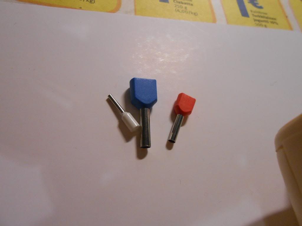

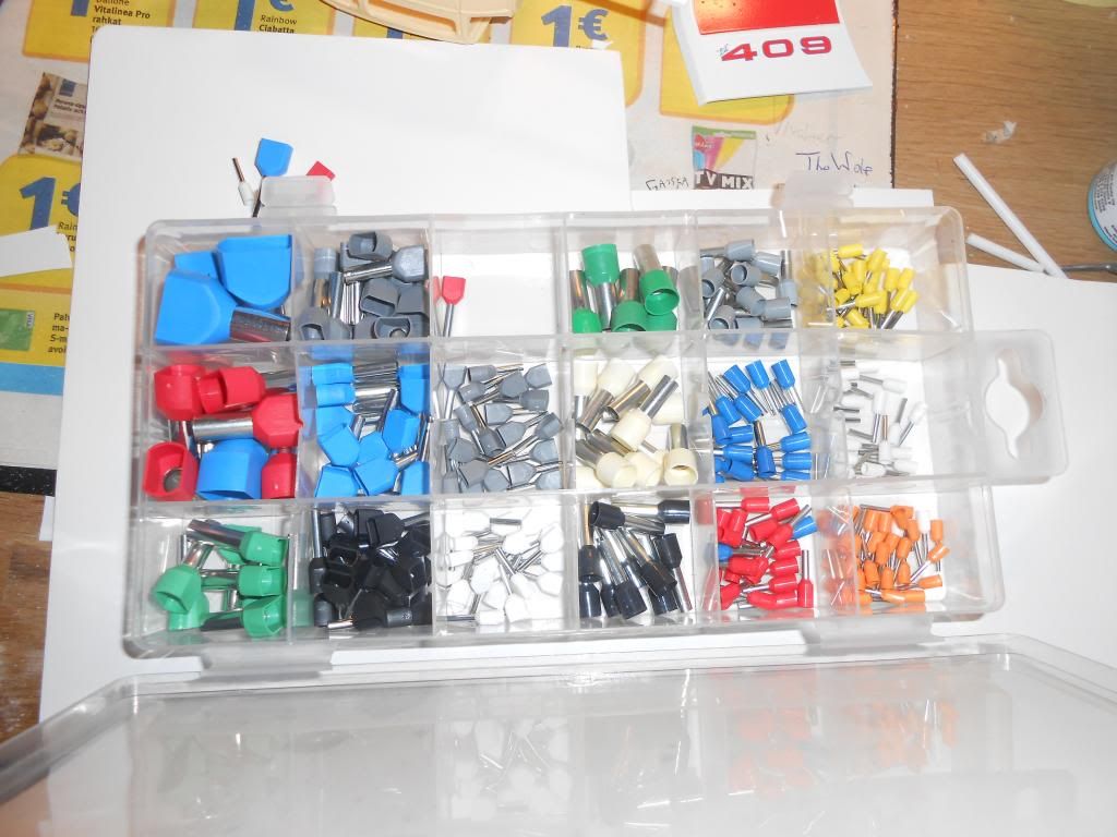

Nice to see you back at it with this again, Now what did you use and how did you make the injector tubes? everywhere I look to buy them is ridiculous expensive and those look spot on!
Umm, I was afraid that someone would ask that question at some point. :lol:  The problem is that I really don't know, which sounds funny, but it actually is true...
But here are a couple of pictures so that maybe someone can tell me what these exactly are. I bought a set of these from a local craft store. I'm pretty sure that they are some parts for electrical components, but I don't know what they exactly are. This set has 300 of them in different sizes and it cost about 7 Euros.
To use them only thing you have to do is remove that colored plastic part. It comes off very easily with a couple of light knocks with a little hammer.
