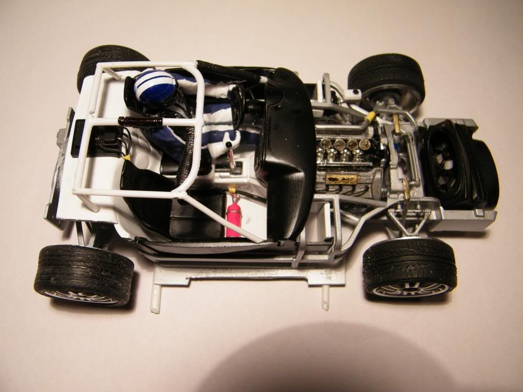

What if Shelby Series 1 Cars had been a marketing success
What if they went racing again....say a GT Championship
Say in an update of the Daytona....With current aero styling....

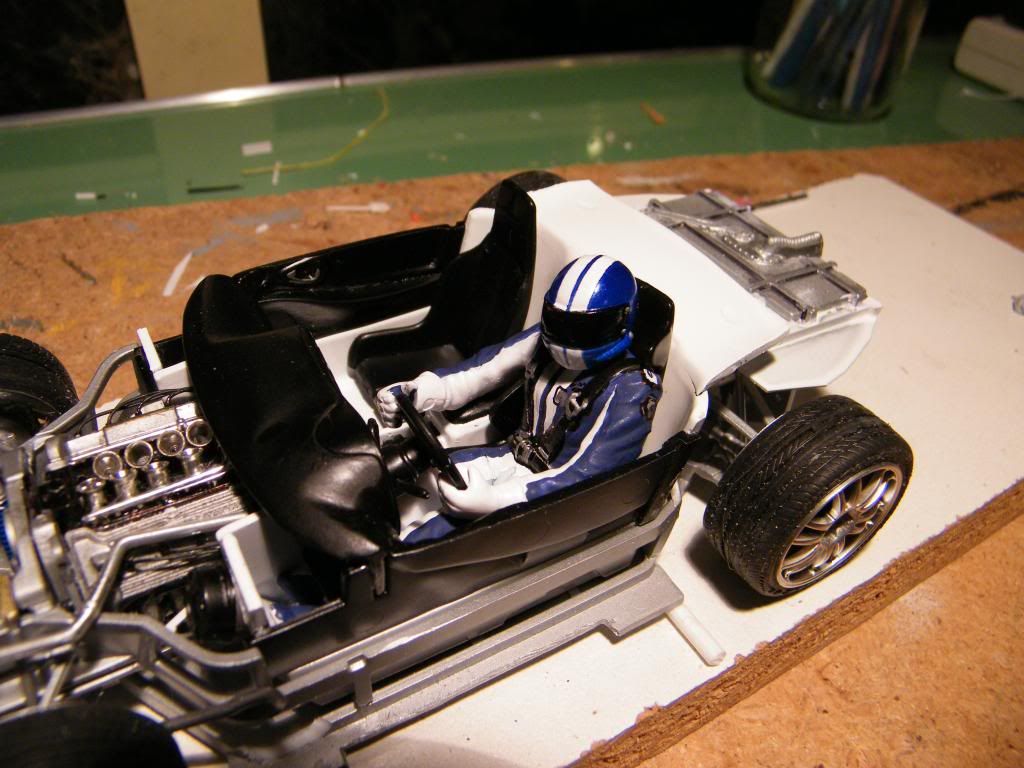

Body almost ready for paint. Working up the interior at the moment
Suggestions welcome but the wing stays, ugly as it is, to keep the GT3 thing going
Hope its of interest
Brian

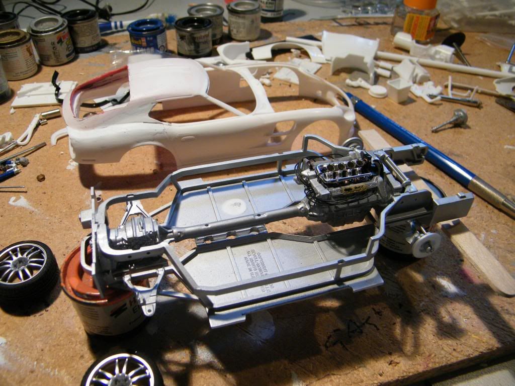

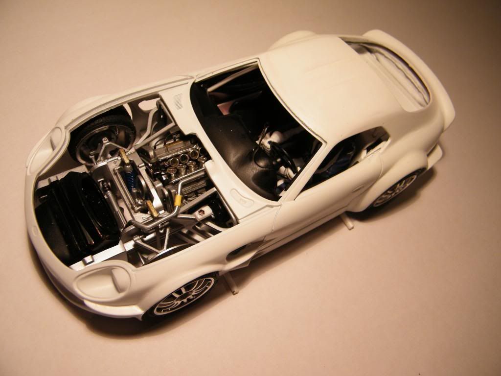

Sorry... its the Revell Shelby Series 1
The Series 1 was only ever built as a drophead so I grafted the roof of an old & very crude Toyota 2000 kit. The roof profile was very close to the original coupe but alll the window lines had to be reshaped.

I'm liking this idea a lot. I considered the same using a Viper roof. What color scheme are you considering? I might consider a wing from one of the Revell C5r or C6R kits instead of the straight flat one. Looking cool!

Following ShawnS again..... If you are not following his build then do it. The craftsmanship on the Falcon is mind blowing & he has done some other incredible builds on our ozautobuilders site. The man is an artist. Good stuff  !!!
Thanks for the comments on the Shelby. Colour will be a traditional blue & white like the original (cos I like it!) but a little darker as per the helmet shown below.

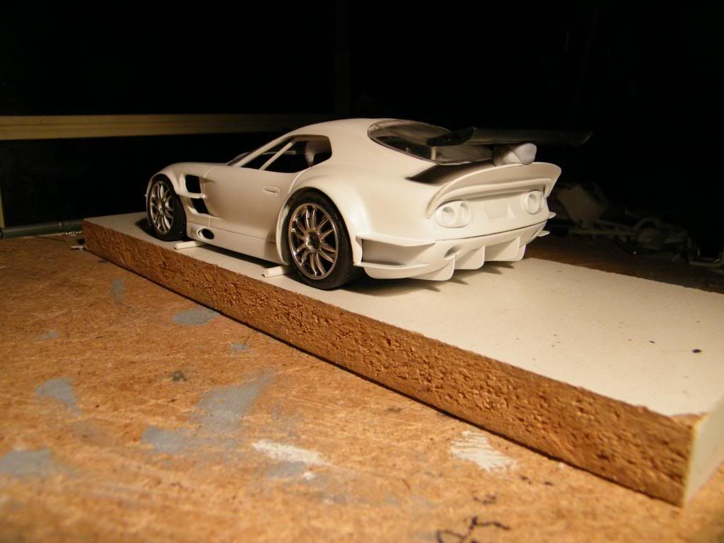

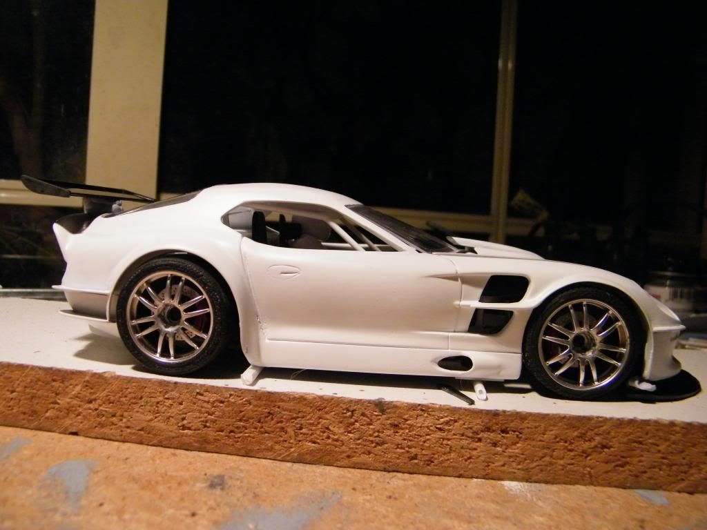

For those who want to have a go...front guard extensions are AMT '25 cycle guards cut in half trimmed & filled. Rear guards are off a very old Bandai 1/20 Fiat X1/9 kit.... VERY old.  Roof & wing were from a weird Aoshima "Toyota 2000GT Turbo Racer' I found at a garage sale. The roof had to be split & norrowed a little but it was spooky how close the front edge fitted the Shelby screen. Mind you, the molding was so thick it could be filed down to fit anything. I'm sure the Viper roof will be cool too, it seems to have the right profile. Bonnet bulge is the seat back from the kit.
And for those who have thought about this conversion, have a go. You don't have to go the GT3 route, I would like to see a road going version & maybe a door slammer (no kidding). How good would a stretched & smoothed door slammer look !!!.  Hmmm now thats got me thinking... might have to go cruzing on ebay after this.

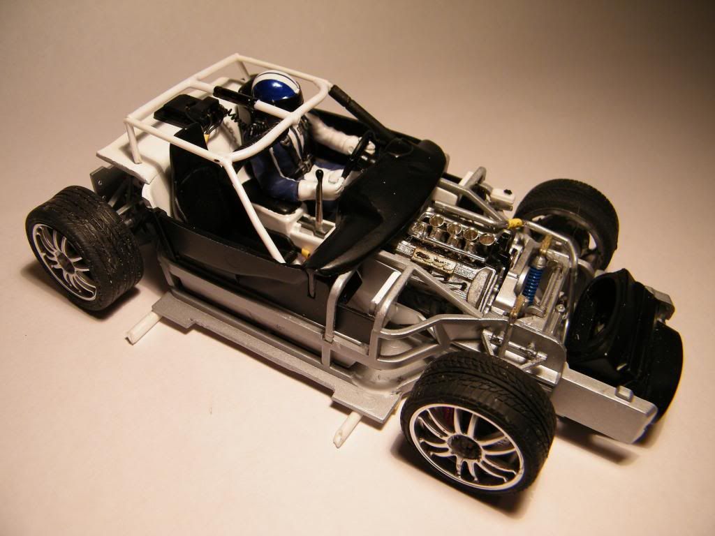

Very kool, where did you come up with the tires and wheels for it? I like the look of them. I've got another project going that they would look good on.

Posted 07 May 2013 - 10:45 AM
Wheels are Aoshima. Great on the outside, pity about the inside. I will have to come up with some inner guards or ducts to cover the lack of detail there. Wheel pack came with tyres that aren't quite wide enough although I have used them on the front. Rear tyres are from my parts box as I needed a slightly bigger section. Brake rotors came with the wheels too.

Man, NICE restyle on that. Really REALLY fine looking mods. I always thought the 1:1 was kinda wimpy / poser looking, but punching out and flaring the fenders to fit some serious rubber gives the car the nads it always needed. Your coupe roofline works well too...got a little Marcos and Bill Thomas Cheetah DNA in there. GREAT work.
