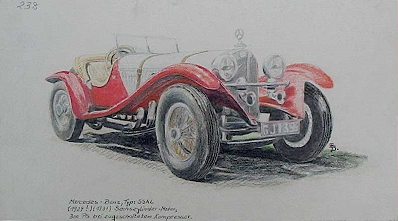

PS: The color scheme on the box is not something you would see (except for white with red cycle fenders), and no one would put whitewall tires on this car.

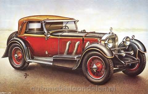

The box art is terrible indeed as are the whitewalls. I am thinking of going to something like this for the final version. but using the fenders from the kit.
I think it is a lot more elegent and true to form on the colour selection. :rolleyes:
That's a 710 SS, which is a more luxo version of the SSK. Some interesting color ideas here:
http://www.google.co...img.UnzQo3MZbPY
The 1:18 Bburago diecast has a nice color combo with a cream body and dark brown fenders, and my 1/16 SS will have a gray body with black fenders and a red interior.
Edited by sjordan2, 07 May 2013 - 05:04 AM.
