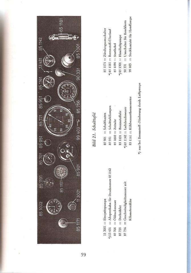

I'm having difficulty posting multiple images, so I'll just go with this from my original owner's manual for SS/SSK/SSKL.

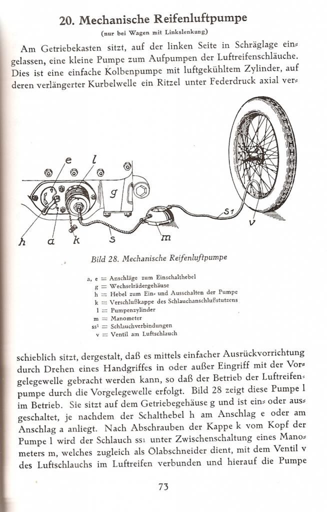

Here's my attempt at a translation of the caption on the diagram above. Perhaps Jurgen can correct it (Interesting to note that there's a remote tire pump on the dash).
INSTRUMENT PANEL
TRANSLATION FROM SS MANUAL
11 3001 = Injection pump
13 431 = Pressure gauge shutoff valve*
85 701 = Oil pressure gauge
85 721 = Tachometer
85 756 = Speedometer & odometer
85 901 = Switchbox
85 951 = Instrument panel lights
85 1002 = Clock
85 1101 = Fuel gauge
85 1142 = Air pressure gauge*
85 1161 = Water temperature
85 1171 = Ignition switch
85 1181 = Fuel overflow*
85 1191 = Starting lever
85 1301 = Hand tire pump*
90 331 = Horn switch
99 403 = Plug contact for hand lamp
* “only with fuel = demand by tire pump”

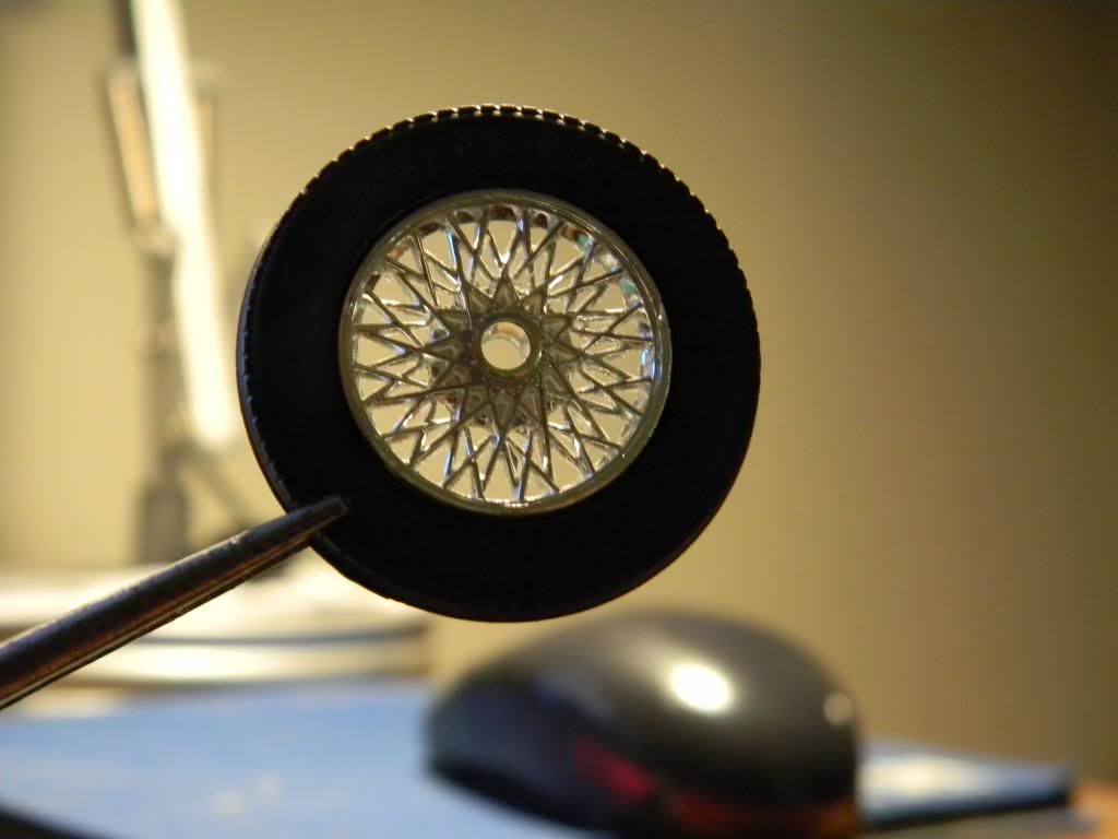

For an experiment I sanded the back of the wire wheel off until all that was showing was the wire,,,,,,vast improvement but not sure. it does have some depth to it and the chrome will match the grill ect.
The lacing is really small and trying to get a decent rim is posing s problem, I might just try to cut out everything other than the rim and cast what is left....same with the hub.

Nice job. However, chrome wheels would not be authentic except for a modern over-restoration -- nothing more than painted silver or body accent color, such as white or red would be period-correct.

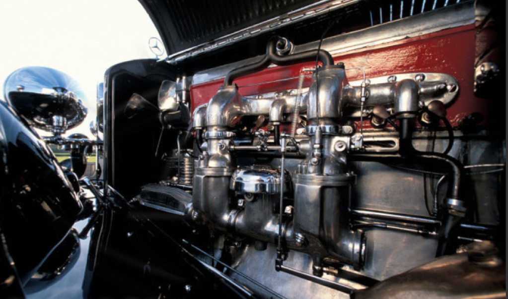

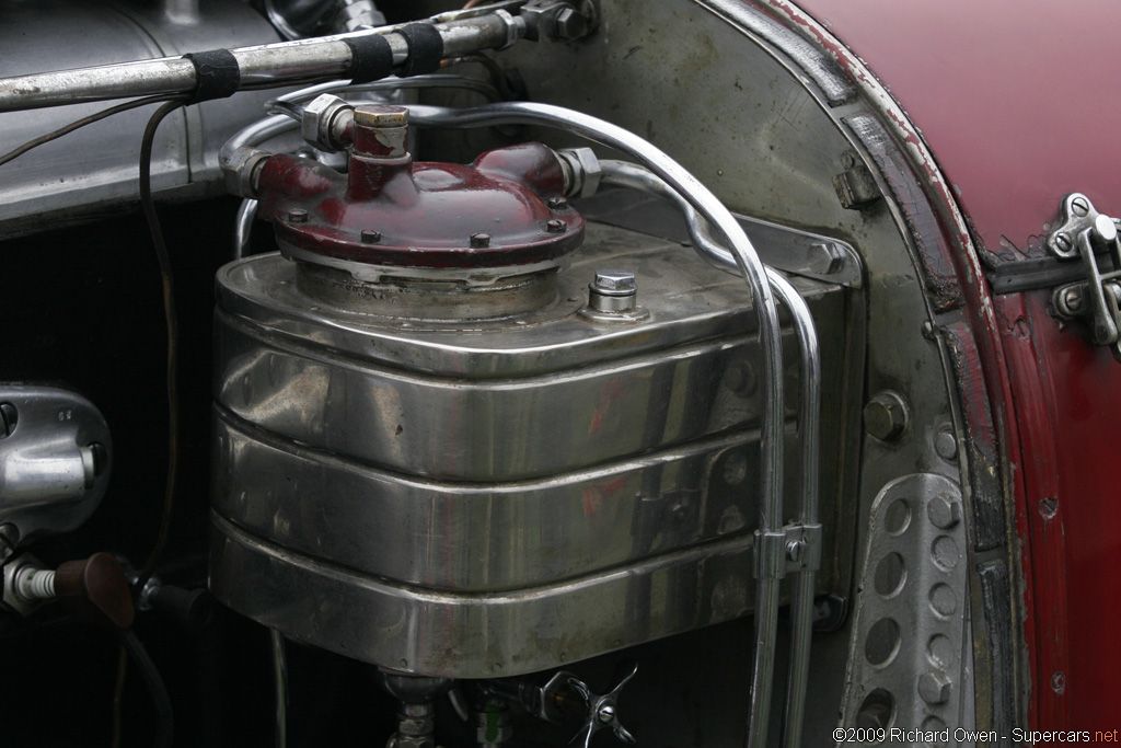

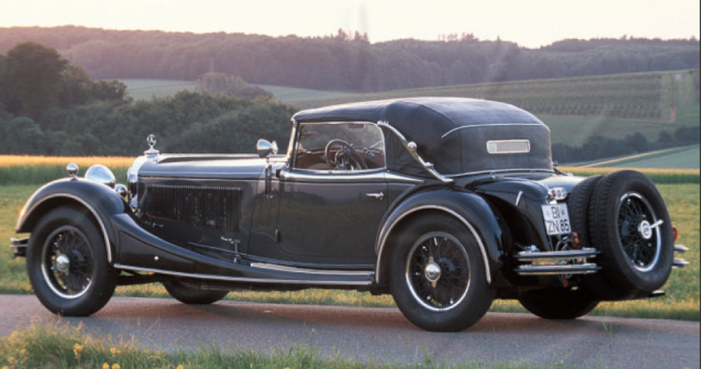

I've uploaded several engine and detail shots here on page one:
http://s827.photobuc...rdan47/library/

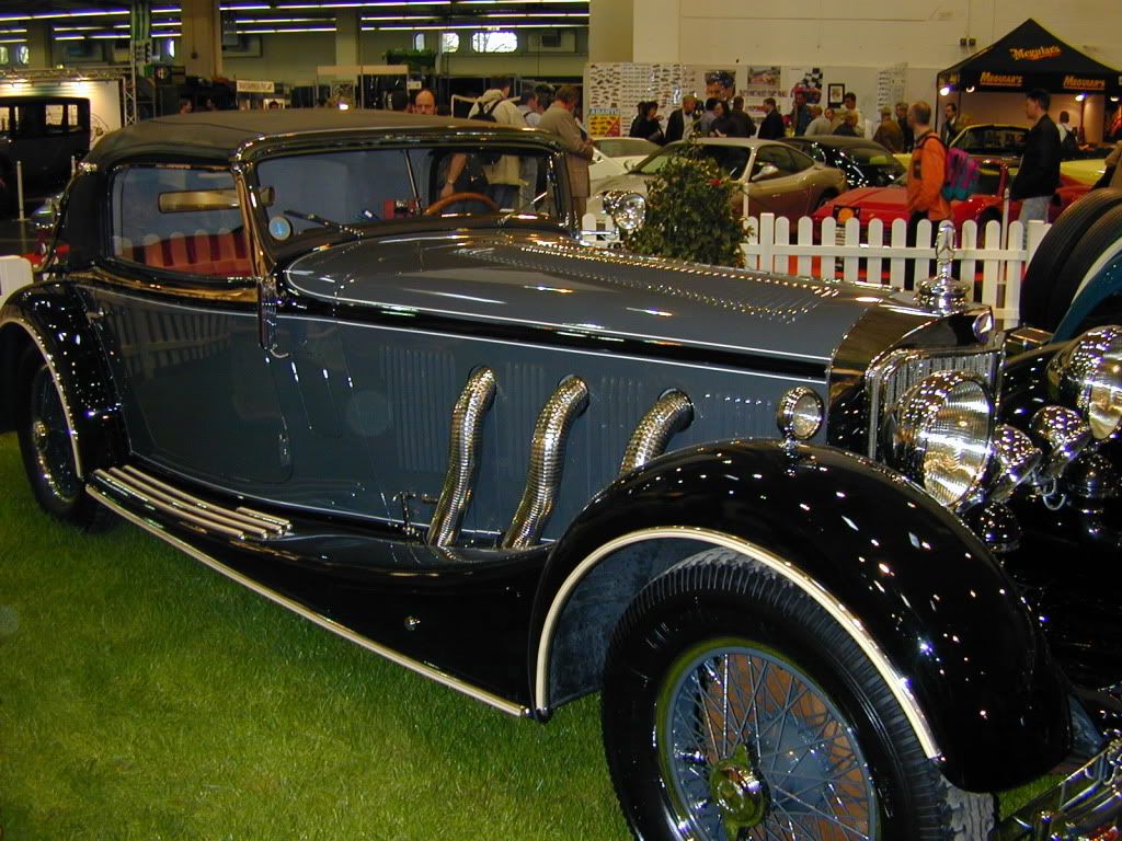

PS: Here's the way I'm going to build my 1/16 SS cabriolet:
Edited by sjordan2, 08 May 2013 - 06:24 AM.

gorgous vehicle (those colours ?)

Dark gray and black with a red interior. The photos have different color balances because one was shot with flash (the top of the hood is closer to the actual color) and the other was shot at "golden hour" at dusk. I talked to the photographer (www.schlegelmilch.com) of the bottom shot and he said the car was a somewhat dark gray, so I'll be using Tamiya TS-4 German Gray, if it's dark enough.
