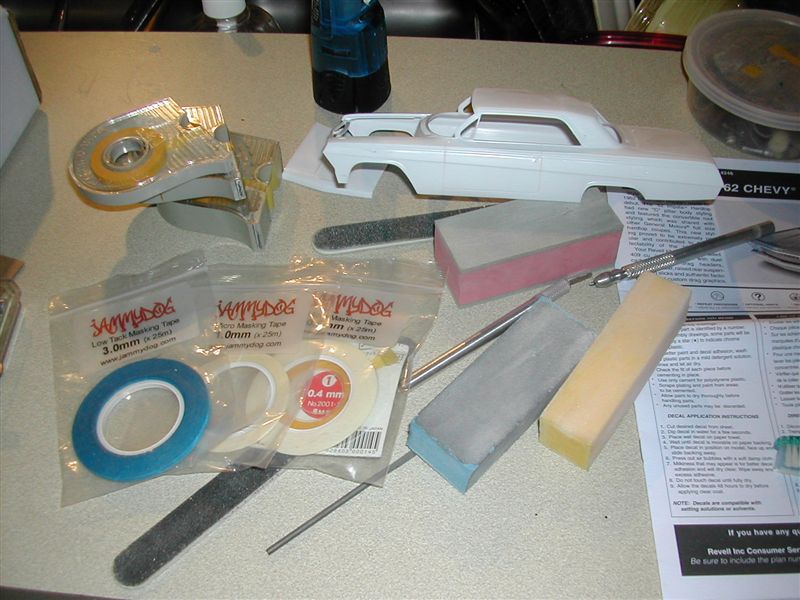

#3. Tamiya tape, Jammydog tape from Scalefinishes.com as well as fine line tape I got from Hobbylink Japan. I don't have the patience to cut fine lines with two hobby blades nor do I care to when there's tape readily available.

I'm with Tonio.....I use the same as him, and our lines are crisp. I don't do the skinny ones like Tonio showed, but his are killer!
