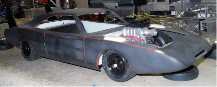

I've bought a few of the Daytona Conversion Kits for the DOH Charger and I like them and
would recommend them without reservation.
I am going to finagle one onto one of the Street Charger bodies at some point just to do it.
I'm sure Mr Magnum just used that pic as it shows pretty clearly the differences in the noses.
I rather sure that purple thing is a 70 charger (by the side scoops on the door) with the wing
and nose put on (which doesn't fit well on those 70 front fenders).
The Daytonas could be had with buckets, the bench seats in them are scarce in comparison.
A bench in a Superbird is even harder to come across.
As far as the nose on the Daytona, I always thought it looked kind of unfinished without the
ridge line coming off the hood being carried down as with the Superbird.
On the one car WIP I actually have the nose grafted on, I flattened out the ridge line on the
existing hood just to make it look more uniform for my tastes.
Attached File  Tona WIP 1.jpg   78.31KB   14 downloads
Making a Superbird out of the Charger would be a bear to say the least.
For that matter, if there were even a stock 70 Road Runner body to start off with, to make it a
Superbird you'd still have a ton of work to do such as the back glass but especially the front
fenders since they used Dodge Coronet fenders to make them.
I sure do hope somebody comes along and does some alternate bodies for these cars, that
would be fantastic.
Surely whomever does it can make some dough on them, I know they would from me :)
Anyway, I do not profess to be an expert on anything here, just throwing my two cents in.
