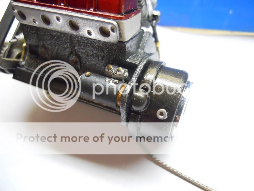

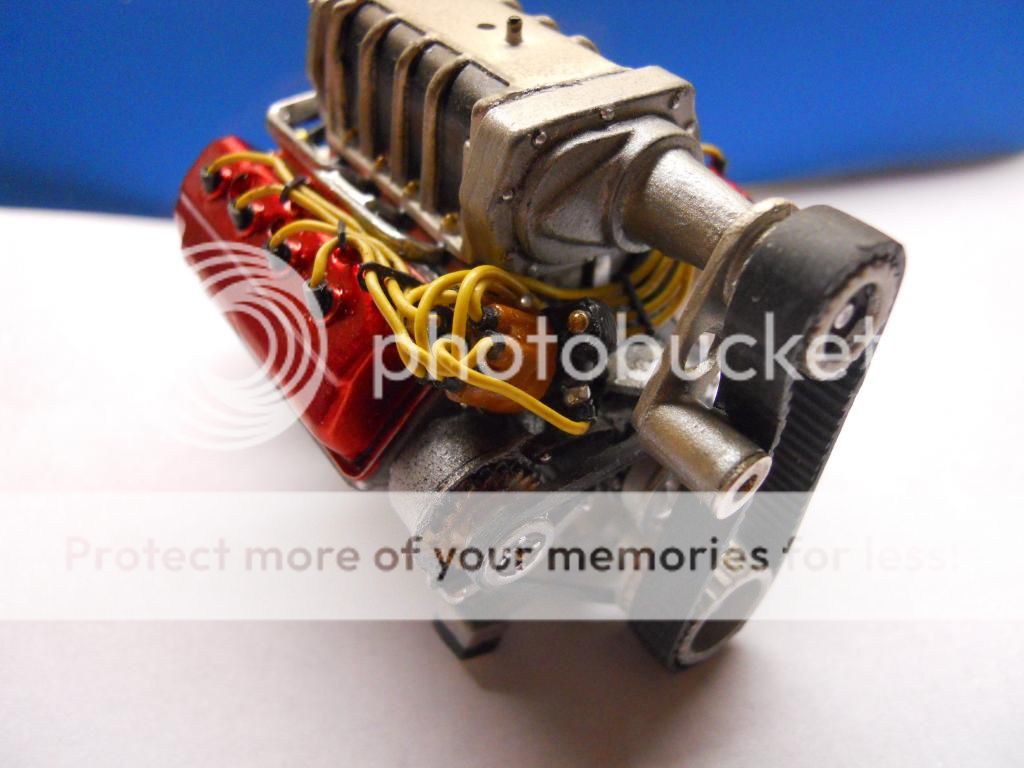

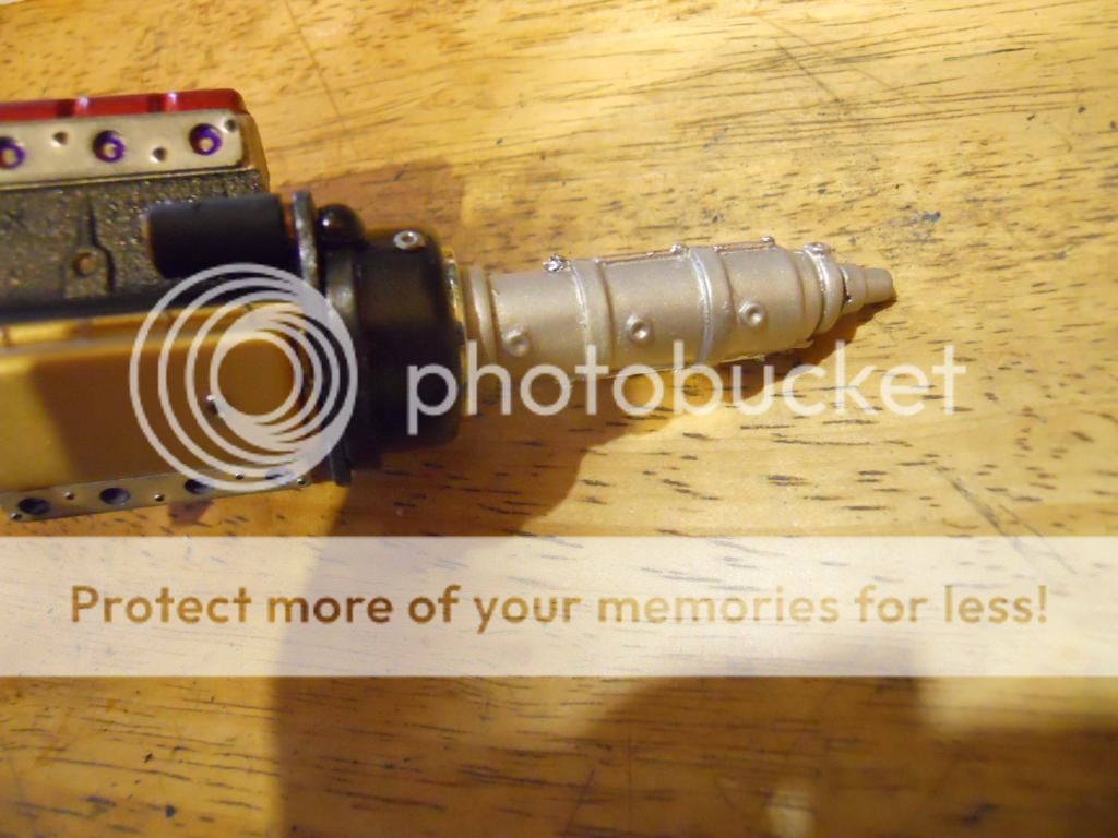

The 426 Hemi that comes with these MPC kits is pretty well detailed to start with (even has a few internal parts), however, I just can't seem to be able to build anything OOB or leave well enough alone....call it a character fault if you like. Anyway, on with the dog & pony show.
I scratch built a clutch can (hydraulic clutch) to replace the stock bell housing, modified the kit distributor to fatten up the sparker, fabricated a blower belt tensioner (the kit doesn't have one...shame on them), and fabricated a girdle for the bottom end. Added the lower injection lines (gonna have to replace these kit pices as they are pretty clunky looking).
The kit supplied plug wire may be fine for most folks but they are so heavy (thick) they hurt my face).
After all...we all know that plug wires aren't the same thickness as battery cables right?
Did some detailing, tweaking and more weathering...this ain't no trailer queen, I want it to look like it's been run a few times. Keep in mind these are large photos and the engine is only 1/16th. Making the wire looms, plug boots, etc. was really straining my tired old digits & orbs.

The molded plastic lines that came with the kit were too toy like......so I removed them and made my own, along with some fittings and a blower intake for a couple of double pumpers ( yes...the kit carbs looky funky.....I'll tweak them when I get a little futher along).
Still have to add fuel lines, oil pan & some more plumbing but it's getting there.

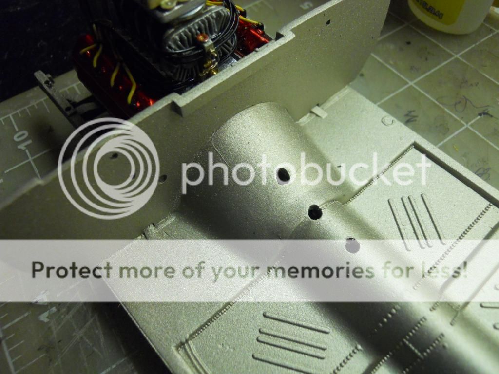

According to this guy......
This is a suitable platform for a Hemi powered street monster (unmolested kit part).........
Well, that ain't gonna happen. This car would twist up like a pretzel running that much H.P. without a full roll cage to hold the rear sub frame to the front. This is a street car and it would be nice to be able to open the door to get in without having to crawl thru the drivers window right?
All that aside, I'm going to be running some really wide meats on the rear and I certainly don't want half the tire hanging out of the wheel well with the rear jacked up so high it needs it's own zip code.
The pics show the rear tire I'll be using sitting in the unmolested pan.....as you can see, I'm going to have to tub the pan, fab a rear half (frame) and narrow the rear.

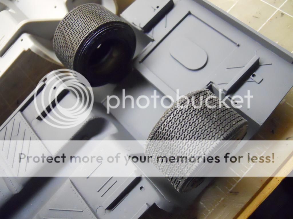

Havin' some fun now huh?
Here's a pic of the kit chassis with the big mutha rubbers in place.....not cool!
I'd need curb feelers with this set up!

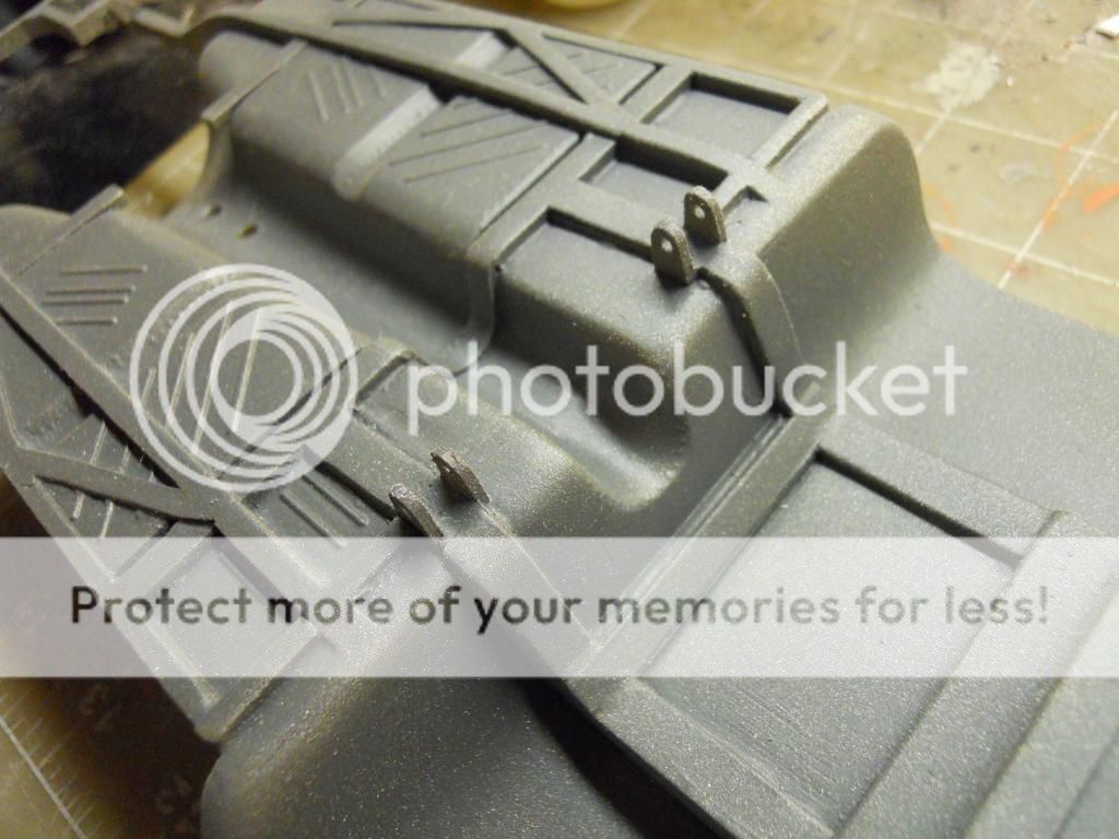

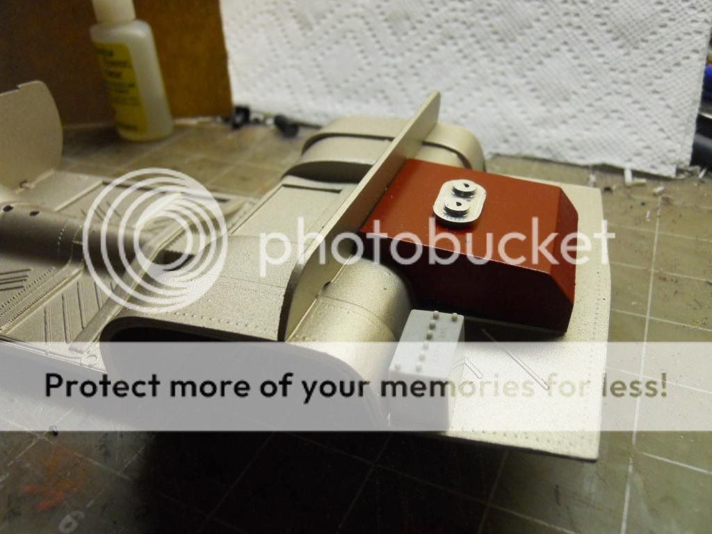

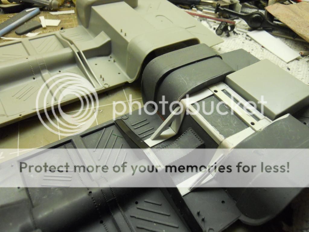

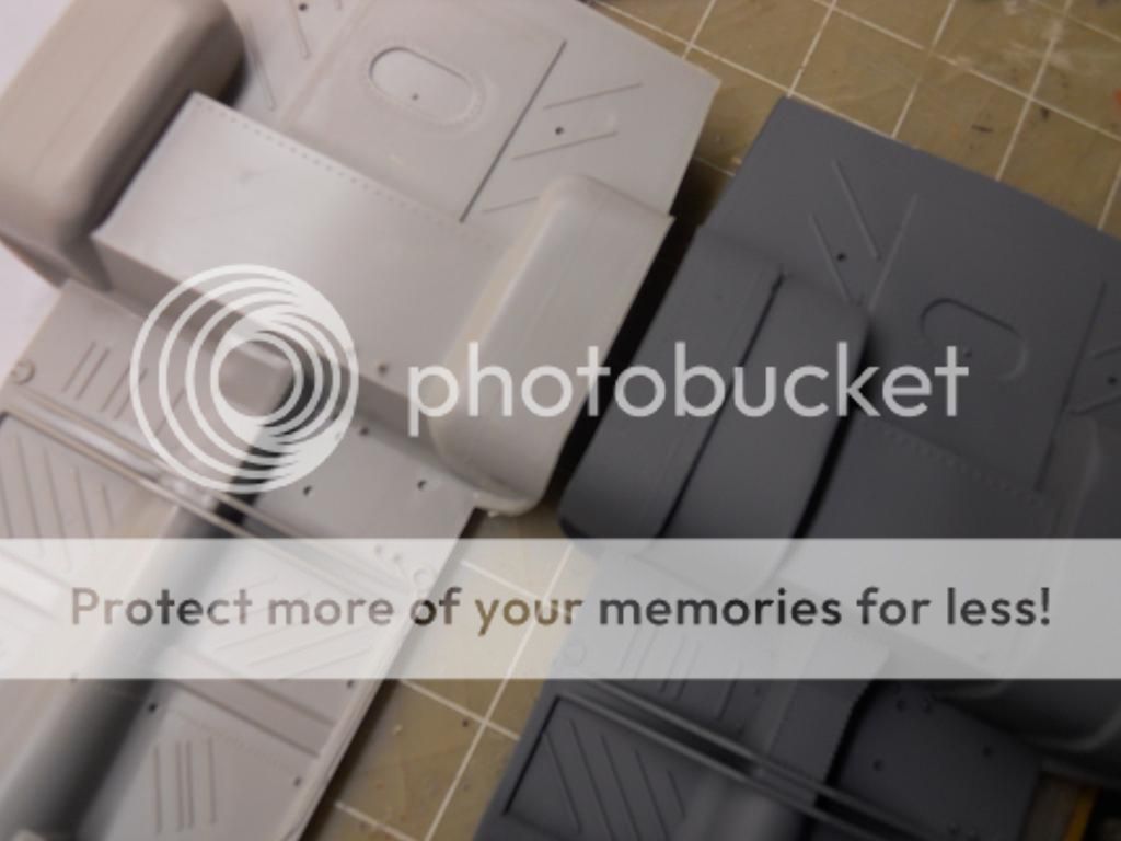

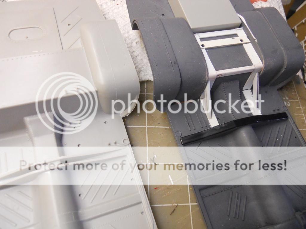

Here's a few shots of the tubs I fabbed up compared to what came in the box, gotta do a little filling and sanding but you'll get the idea....
Whoopeeeee......this last mock up pic puts a smile on my mug....all the rubber will fit inside the the body.
Bye, Bye leaf springs!

nice work on the engine and chassis! Are you going to cut off the remains of the rear sub frame and scratch new ones?

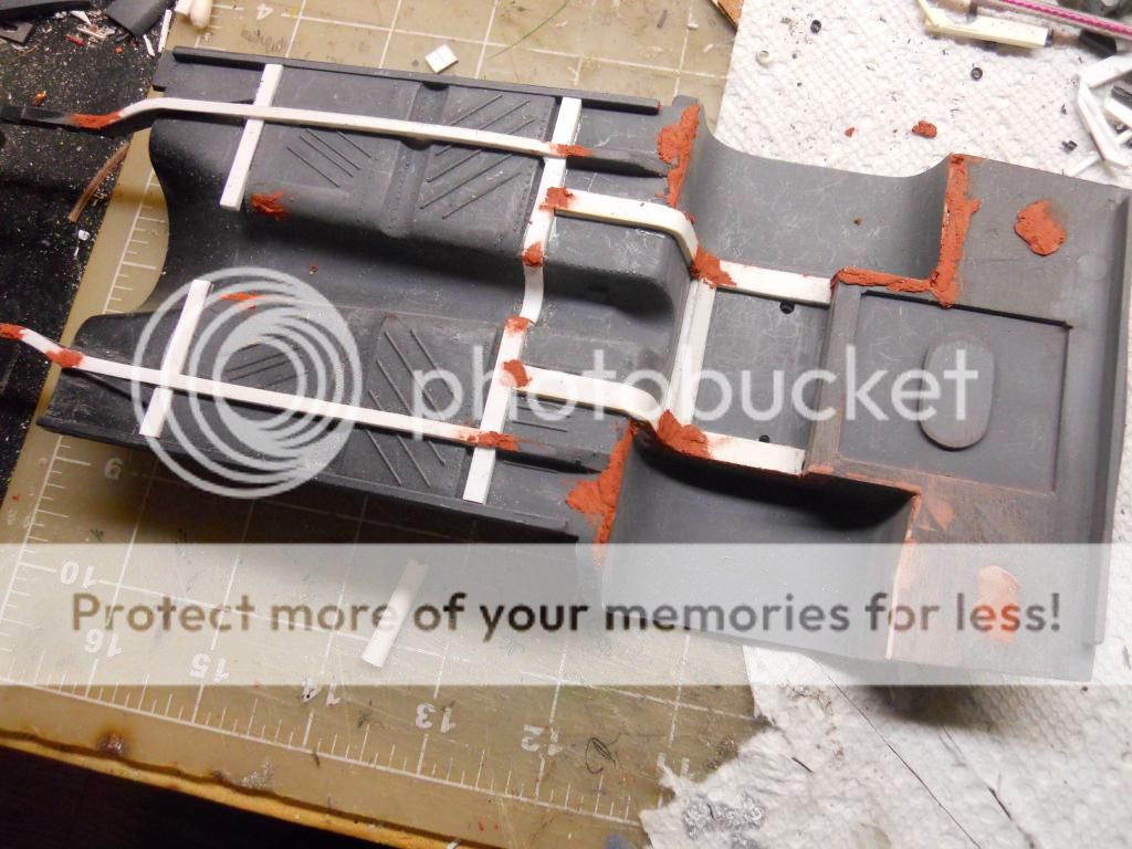

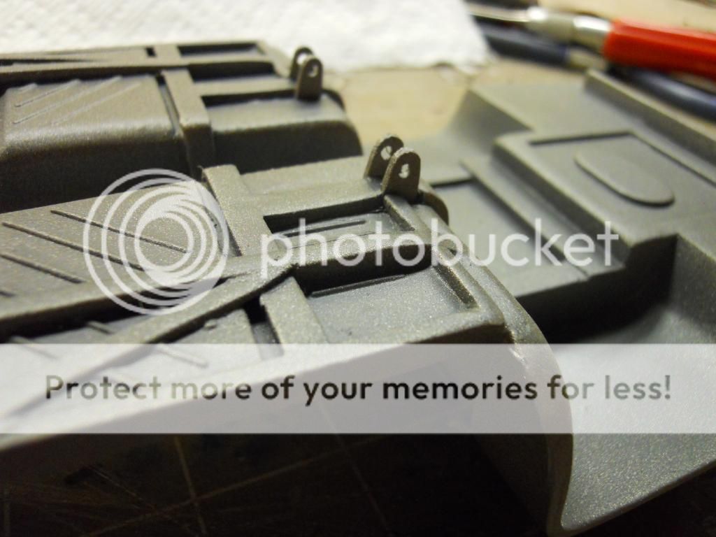

BTW thank you for your service!
Jason, ordinarily I would cut off the rear section of the pan and scratch build and new "rear half" frame..add some frame connectors and call it a day but then I'd have to go back and fit all new "sheet metal" to replace what was cut off.
However...on this model I'm going to take a somewhat different approach, I'll be adding the lower half of the frame to the bottom side of the pan and then flip it over and add the upper half to the top side.
With any kind of luck it, from the side it should appear the the frame sections are one piece with the sheet metal attached to it.
A little filler, some sanding, a few more braces and I can shoot a coat of primer on this thing....flip it over and get the front engine cage started.

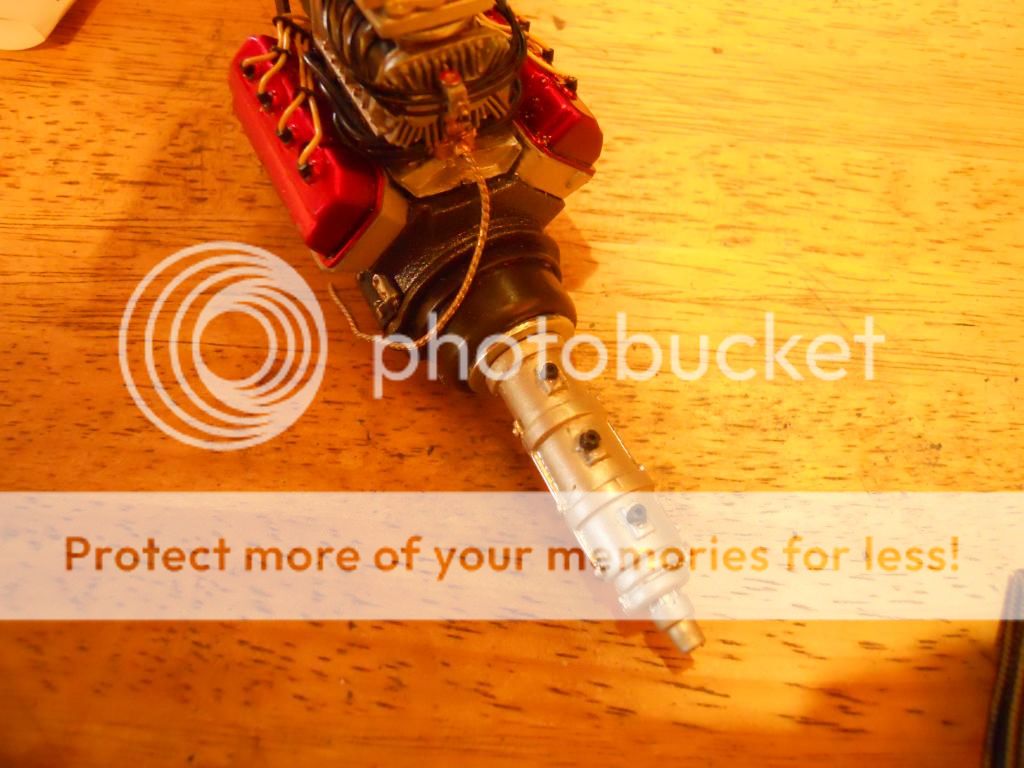

Squint at the pic and guess what this pile of household trash, washers, scrap tubing and half round is going to morph into.

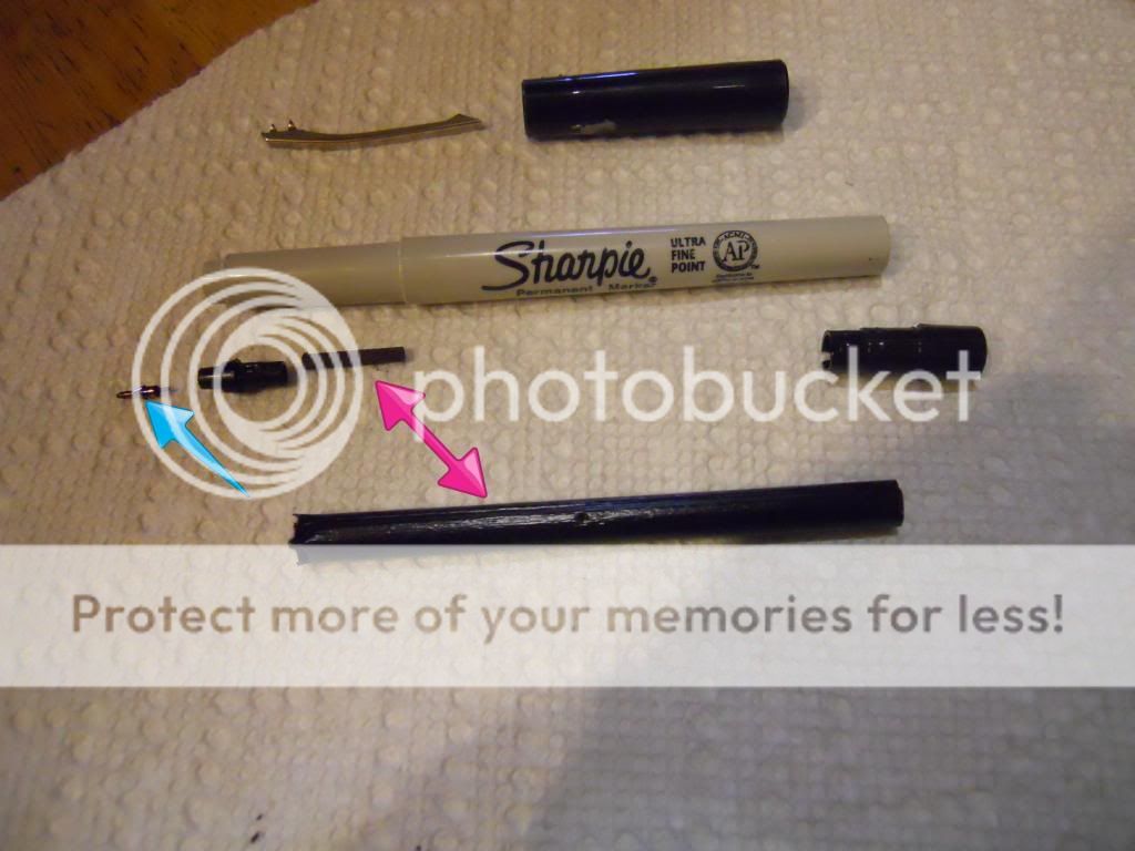

Here's a hint.........
Step 1.........disassemble.
Throw these 2 pieces (ink cartridge and wick) in the trash, if you're fussy about your personal appearance keep in mind they have permananet ink and will turn your didgits black...... :? .
