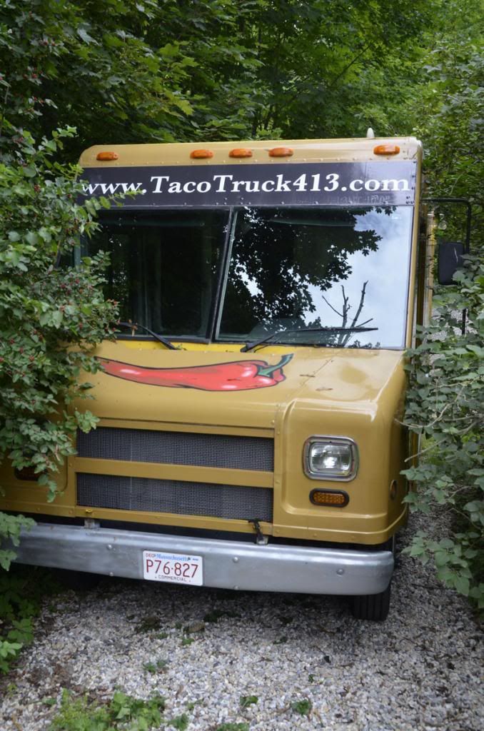

My daughter's boyfriend just bought a 1993 Chevy P30 Food Truck to start a business and I'm wondering how much scratch building it's going to take to make a 1/25 version of one. I expect there will be a lot but I'm curious if there's maybe some resin body out there that could give a head start.
I am really flying blind as far a trucks are concerned and know nothing of what the chassis of a P30 consists of ... something that would be close in kit form I could use.
Any information about the P30 anyone could tell me would be a great help. I'm just starting research today.
I only got one shot of the outside of it today ...
93ChevyP30TacoTruck_DSC4745_zps4fc5719e.
Thanks for any help or guidance!  :)

The one in the picture is a Grumman bodied truck. They used a GM chassis with Grumman's aluminum body atop it.
I can't tell from the pictures but it looks like the wheel bolt pattern is 5/10 lug. That 5 on the front and 10 on the rear. If so, it used a heavier chassis than the pickups did, with a solid beam front axle and leaf springs on all 4 corners.
If its an 8 lug truck, then it used normal SLA independent front suspension carried over from the trucks.
I offer this answer as a person who worked for the Postal Service for a long time doing fleet maintenance and repair on those trucks.

The most significant difference between the resin body on that link and the picture posted above is the front end.
The resin body being earlier has the front fenders parts of the body with an aluminum hood. The later trucks like in the picture above used a fiberglass single piece unit that lifts up in its entirety, exposing the entire front of the truck rather than just a hood opening.
From my perspective I liked working on the later trucks since the large front access the newer design offered to the engine area. My postal fleet had a bunch of them that we had to maintain. They had 6.5 liter non turbo diesel engines with 4L80e overdrive transmissions and 19.5 inch wheels and tires. The earlier trucks like the resin example used 6.2 liter non turbo Diesel engines with turbo 400 transmissions.

I used to sell those. The body on the truck in the picture is made by Utilimaster, not Grumman. If I were doing this build, I would contact Workhorse (the maker of the chassis that was the GM P30), and Utilimastere Corp. They may be able to send you some detailed drawings with the various dimensions. Or, take a boat load of photos of your daughter's truck, and work from there. These trucks were pretty much custom ordered for height, length, and width. One thing about them, they were slab sided, so scratch-building a body should not be all that difficult. All the glass was flat too.
That truck looks to be a 14 foot unit, with a 6 foot inside height, standard front doors, 12,000 GVWR.
This information is for the current truck, which is not very different from the one in the photo.
Body:  http://www.utilimast...ail.aspx?id=388
Chassis:  http://www.workhorse...Chassis/W42.pdf
Also, find out which company did the food coach conversion.
This should get you started.

Just a confirmation that this IS a Utilimaster. I got some more photos and and online info .... the front confirms it.
