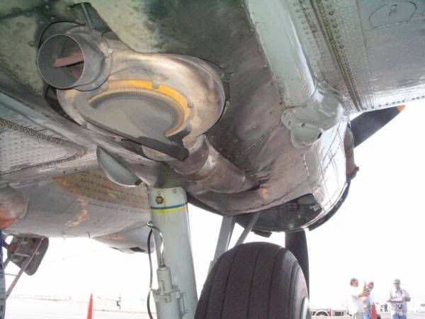

The B-17 had a very distinct underwing appearance too. If I recall correctly, the turbos exhausted under the wings, out of ports behind the wheel wells on the inboard engines, and a bit farther forward on the outboard engines. This is clearly evident in this shot. (Pirated from an open internet source under the "fair use" definition in copyright law)
There is a ring of oil mist residue around the back side of the cowling (just behind the cowl flaps) and a high-time engine could leak a lot of oil. There is also a concentration of oil residue at the bottom of this area, where engine oil would drip into the cowlings and collect while the aircraft was parked, and then be blown out on engine-startup. Steps were taken to channel this excessive oil leakage away from the landing gear wells aft of the inboard engines.

the turbos are a nice molded in detail on the kit so that should be simple enough to detail

Here's a good shot of a turbocharger on the inboard engine. ( Both photos pirated from open internet sources under the "fair use" definition in copyright law )
