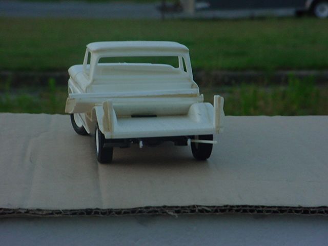

I too have a couple of these.
I was using AMT's Turnpike Slot car tires, Rubber Firestone Darlington Gum Dipped,
on the 64 "Fleetside"  (Now have AMT Firestone Supremes)
but moved them to the 65 I am mounting a Model-King "Deluxe Parts Pack
Open Road Mini-Motor Home on. (Yes I had to Stretch the frame to Longbox specs!
The problem mentioned above about the way the Fleetside box is tooled is that
is a Phantom CAMEO Carrier box and Not a True Fleetside box.
The Cameo Carrier has Fiberglass fenders mounted to a Stepside box.
in 58 Chevy/GM came out with the Fleetside and widened the floor of the bad to the outer "Fenders"
I have done this conversion on both this 64, And AMT's 60
It is not TOO difficult, but will require 2 boxes to do it!!
here is a rear angle shot showing the cut & modified bed of the Fleetside box.
The seam is visible on the wheel well;
Yes those are the Outer box sides in the bed!!
Here is the Mini-Motor;
