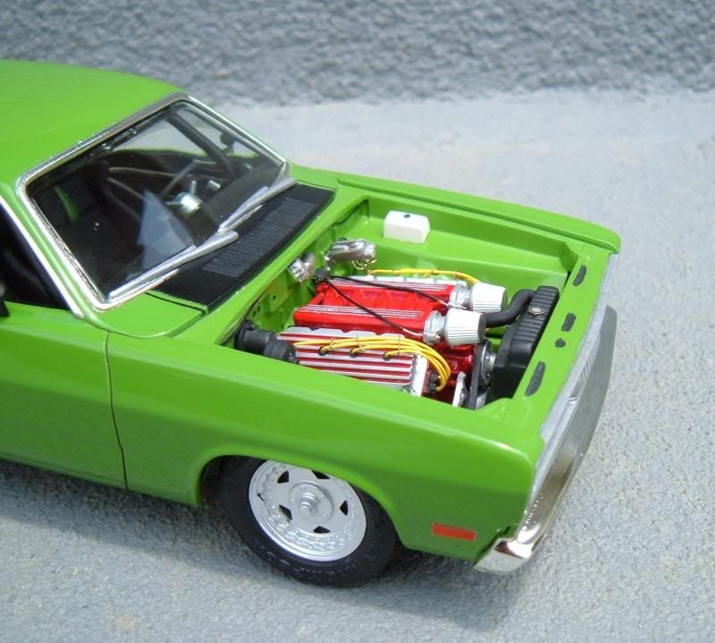

With the body nearing paint stage, I've turned my attention back to the motor. I really like the idea of one of these...
It's a Sonny's 727. With a name like mine - what would you expect! I believe its based on a Ford so it would be perfect.
The closest in1/25 scale I can see is a Ross Gibson 815, but I'm not sure if this would be a good starting point. I'm not afraid of scratch building a few bits, but I am at a bit of a loss about which Ross Gibson engine is which. The pic below shows Boss valve covers...
...and this pic shows what looks like Sonny's valve covers. I'd be grateful if anyone here knows what Ross Gibson engine part number I need. I don't want to order, wait 2 weeks (that's at least how long it'll take to deliver to the UK) and find I got the wrong one.

no the sonny are chevy base you mite need the rge312 that's a boss base big block ford 812 hemi ford

Sonny, why not just buy the recently reissued Revell '55 Jukebox Ford for your base engine? It has the same (maybe not exact. I can check my kit) valve covers as the real engine in your photo. The kit will be cheaper than a Gibson engine. Plus, you'll have a whole pro sportsman '55 Ford body and chassis left over. May be something to consider.
Thanks Roger, but I thought the entire underpinnings of the Revell 55 Ford Jukebox was the same as Revell's pro sportsman '57 Chevy. I have the 57 Chevy, but not 55 Ford. I would be grateful if you could check for me and if the engine is different It will certainly make a lot of sense.
The chassis' are the same. The engines are different. The engine in the Jukebox is a 698 c.i. Boss. It doesn't have the heads like the Sonny's engine in the photo above. This kit came out in '92. So, the engine is a little dated compared to today's engines.

Finally, I have sourced an engine! I'll be using a 429 Boss motor from Monogram's '70 Boss Mustang kit. It's actually a 1/24 scale kit. At first I was not too keen on this idea, but after checking a few measurement I felt that it would be OK. I wanted the 'big' V8 look for the Galaxie and this is certainly achieves that.
It's a 429, but I'm happy to call it a 520 Cu In. I believe that the outer dimension of both engines would be identical ??
The kit engine is 'OK', but it lacks the super-detail I would have had from a Ross Gibson engine. Never mind - I will just have to get busy scratch building details myself.
First job was to cut away the moulded-in sump. The engine is to be set further back in the engine bay than the original, and so the front drop on the sump was no good. Anyway, I want to build a race style fabricated sump for this engine.
Above you can see the engine offered up in place with the beginnings of my scratch build engine mounts. The plates that bolt to the block were created first, then 'tack glued' to the block.
So that I can adjust the lengths of the mounts I have drilled right through the X-member and used extra long styrene rods to meet up with the mounting plates on the block. In the pic above you can see the engine temporarily held in place with a blob of Blu-Tac whilst the glue sets.
You can also see that the hollow internals of the engine have been filled with a lump of putty. This adds a little extra weight (I like a weighty feel to my models - in moderation).

I found this pic of a Boss 520 with throttle body fuel injection and I think this is the kind of look I NEED :D .
To achieve this I've searched my parts box and come up with the 8 air horns (I have no idea which kit they originally came from). I've also found a twin carb high-rise manifold which can be cut down for the job.
And here's the lot just mocked up in place. At the moment I don't know whether to replicate a mechanical injection system (like a Hilborn set-up) or a more modern throttle body set up.
In this picture you can also see how the curve of the top of the fire-wall now matches the back edge of the hood opening (or at least better than before!).
The manifold is a perfect fit in the Boss engine. Again, I have no idea where this part originally came from (after 30+ years of building model cars and never throwing anything away I've accumulated a mountain of spares and extras).
