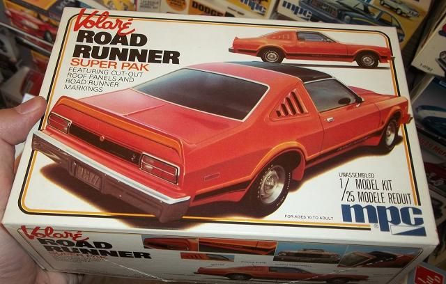

#5 JollySipper
JollySipper
  • PipPipPipPipPip
  • 368 posts
  • Location:North Carolina
  • Full Name:TJ Charles
Posted 31 July 2013 - 05:26 PM
I thought the same thing when I saw this kit, Kyle! Here's a pic of the kit from the Bay of E!  :D
