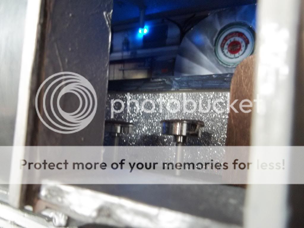

James , actually there are several ways you can do "Interior walls and really CHEAP TOO ! have you ever visited a Michael's Art store ? I bet ya have . Go over to the "Printed Papers " . hey they have all kinds of KWELL Looking Printed paper for about 1.50 a sheet . The sheets , they're 8 1/2 X 11 mostly . Apply with Elmers SPRAY ON CONTACT CEMENT .
finishedinterior4-24-2013002_zpsfa776124
This is Silver Metal Flake paper in a bar scene .
Now you can also visit the Evergreene Styreene and go for several "Tile Pieces . Those sheets run 5 X 7 and usually around 6.25 a sheet . Meanwhile , you can also go to the doll house companies and even get Brick and Stone embossed papers too ! Hey, just look for "HALF scale ", that's 1/2 inch equals a foot.
