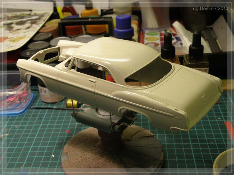

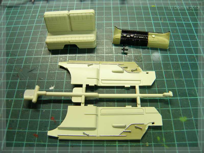

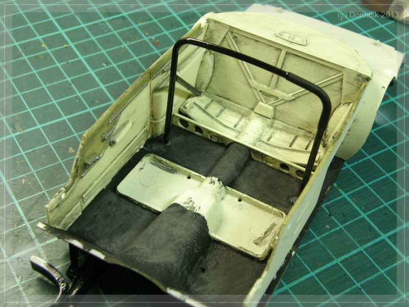

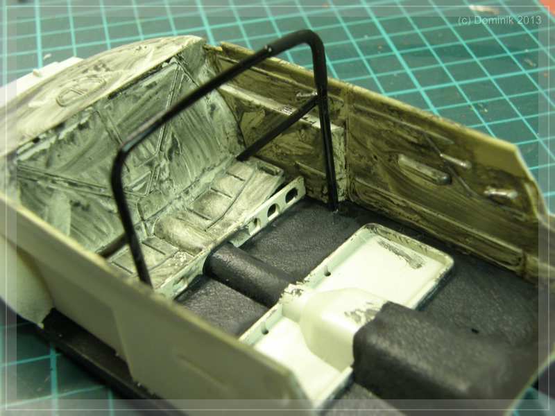

Here we go. After painting the interior in bodycolor, i painted the rollbar glossblack, glued it in place and painted the floor mat black
Also, i painted the sidepanels in two beige colors (now i know, its wrong to paint the upper part darker...), painted the trim with chromesilver. Dashboard and seatbench get their  colors too:

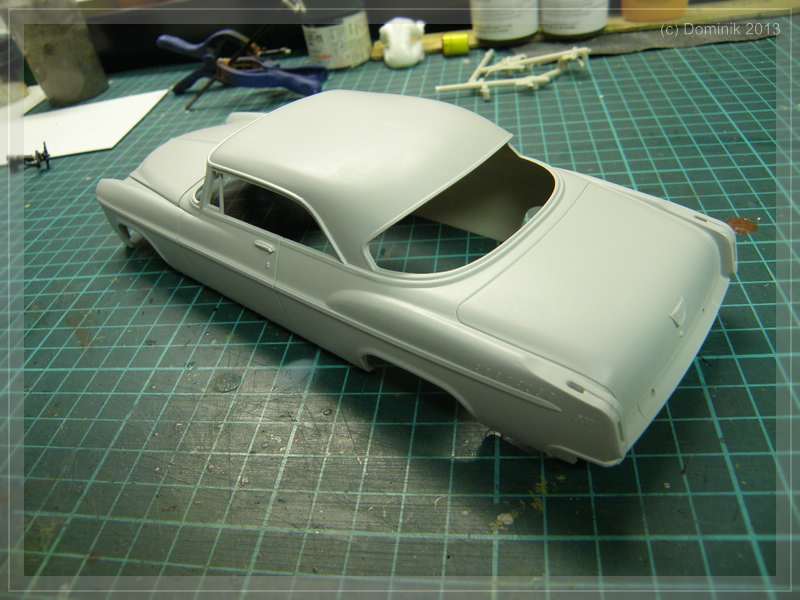

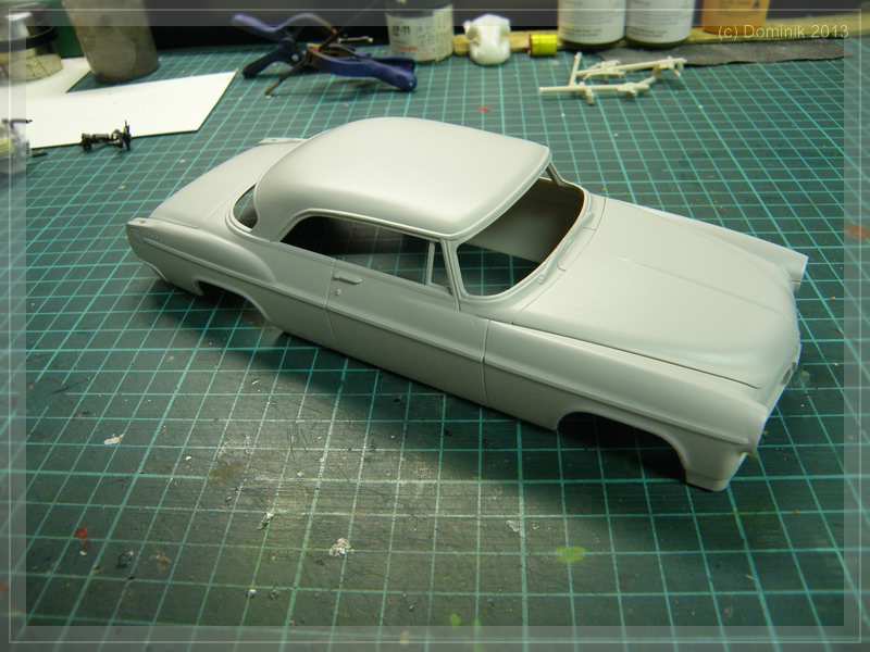

in the mean time, i sanded the body, removed the "Casting fins(?)" and primed the body:
the body goes some days back in the shelf to dry, before i work on it again.

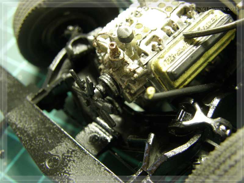

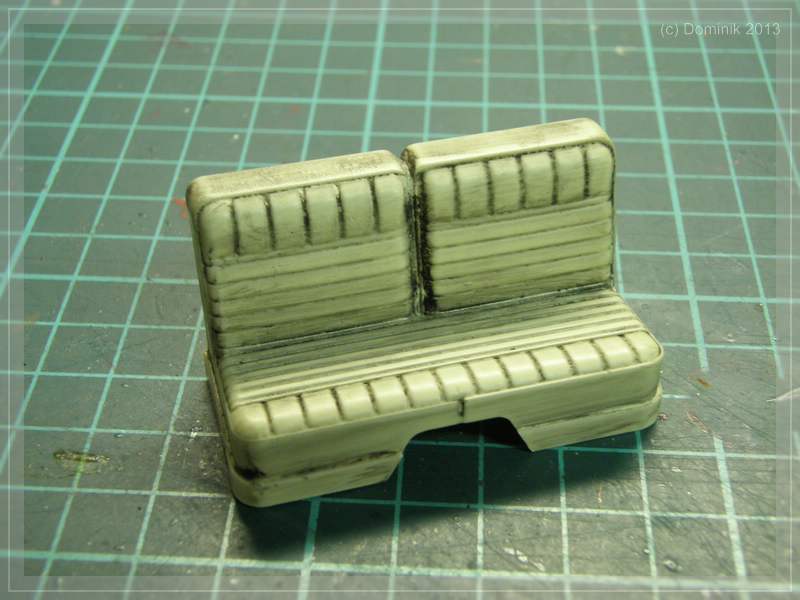

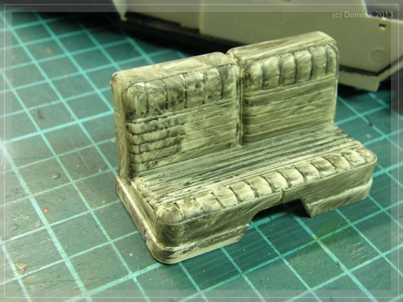

I began to weather the engine. I took watercolors and brushed it with thin black:
the same work on the interior...
...and seat bench:
after it was dry, i took a damp towel and wiped off the excess color:
similar the interior:

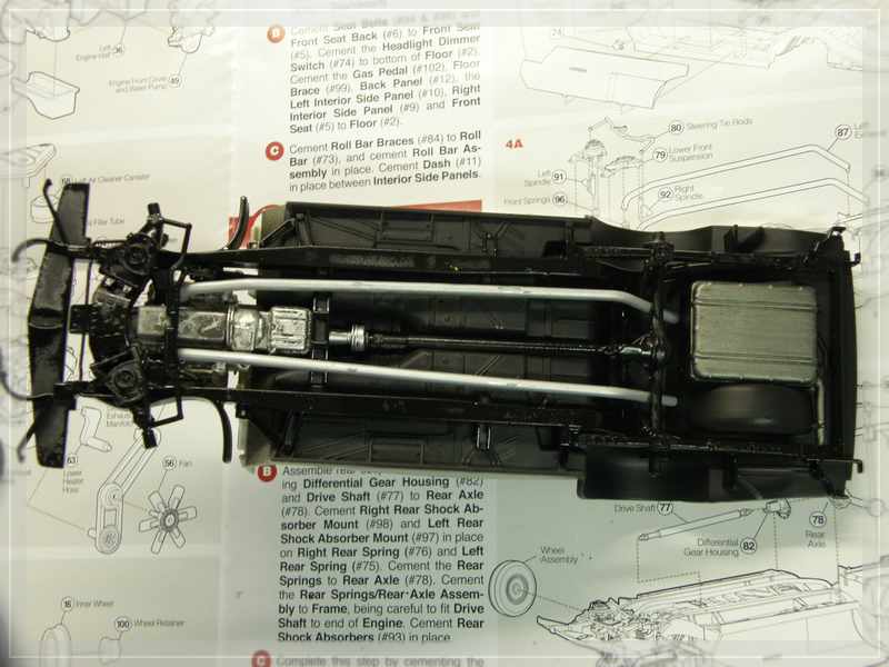

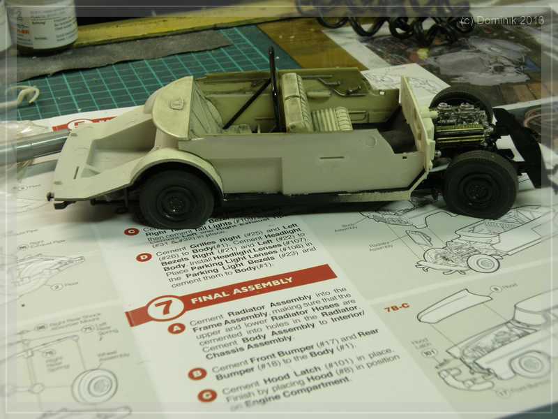

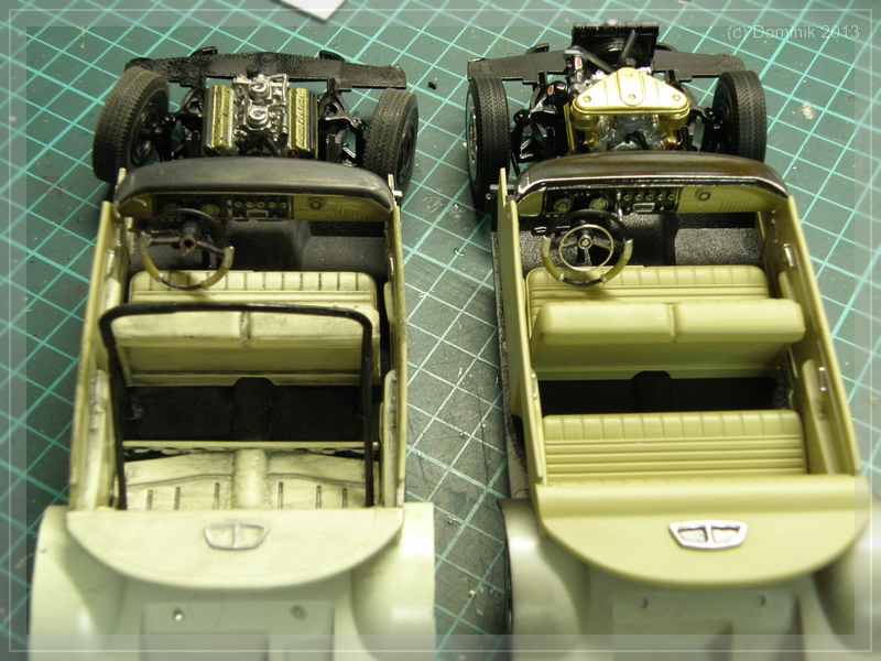

Last step, i completed the chassis with engine and other stuff:
So the work on the chassis is done. Why i didn't weather the underbody? Well, the car will take place on a diorama and there nobody takes a look underneath - and if one grabbs it...you don't want to know what happens then. :D

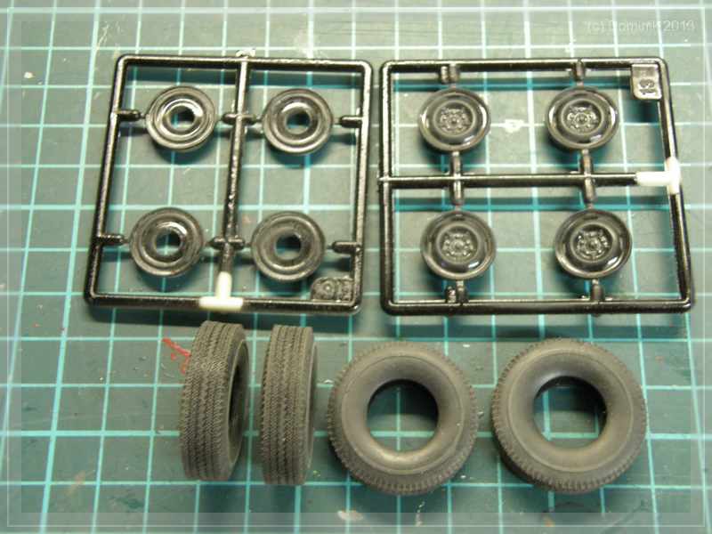

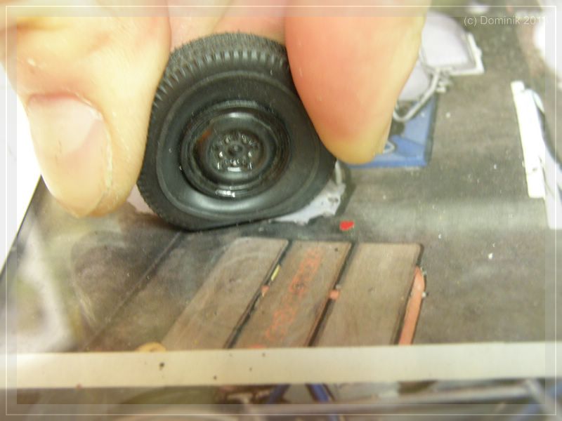

The Chassis is done, lets take a look at the tires and rims.

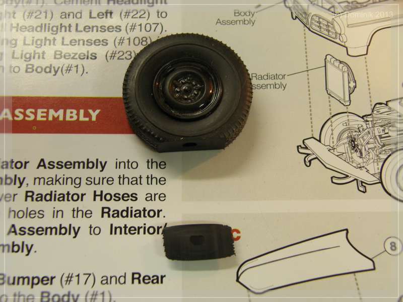

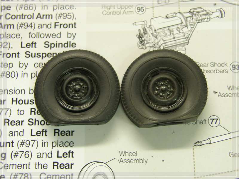

I took a abrasive flowing (? - like really, really fine Steel wool) and rubbed the tires and rims to give them a used, not shiny look:

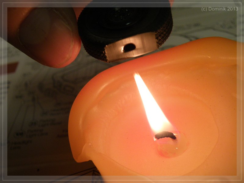

After completing, next step: no junkcar has full pressure in the tire. So i cutted a segment...
...hold it over a flame, till the rubber looks a little bit shiny...
...and fast press it on a glassplate (it always laying on my bench)...
...to get the look of a tire without air:
Mounted on the chassis...
..and fitted body for a look of the stance:
Has the oblique position i want. Well done.

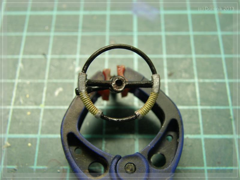

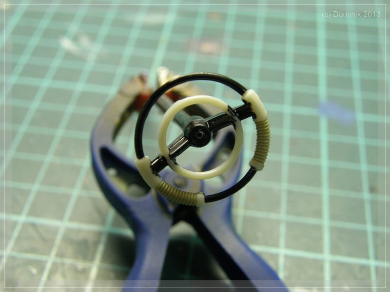

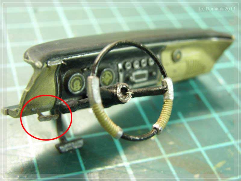

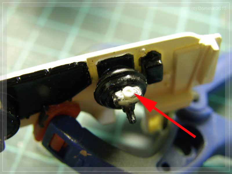

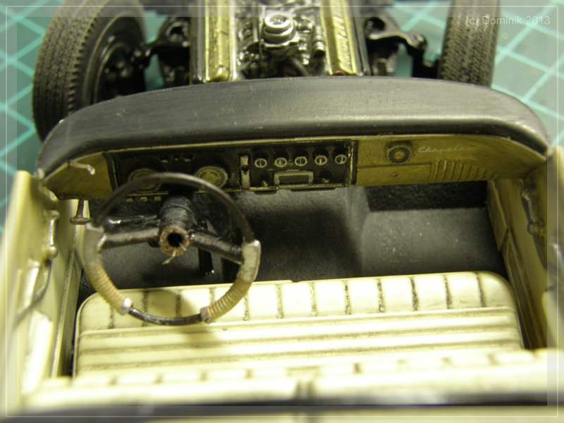

I painted the steering wheel...
...and what i see - i am not amused. The honking ring is tooo thick.
So i cut it off, sanded the spockes thinner with the right angle, removed the honk button...
...and painted a little rust on the hub.

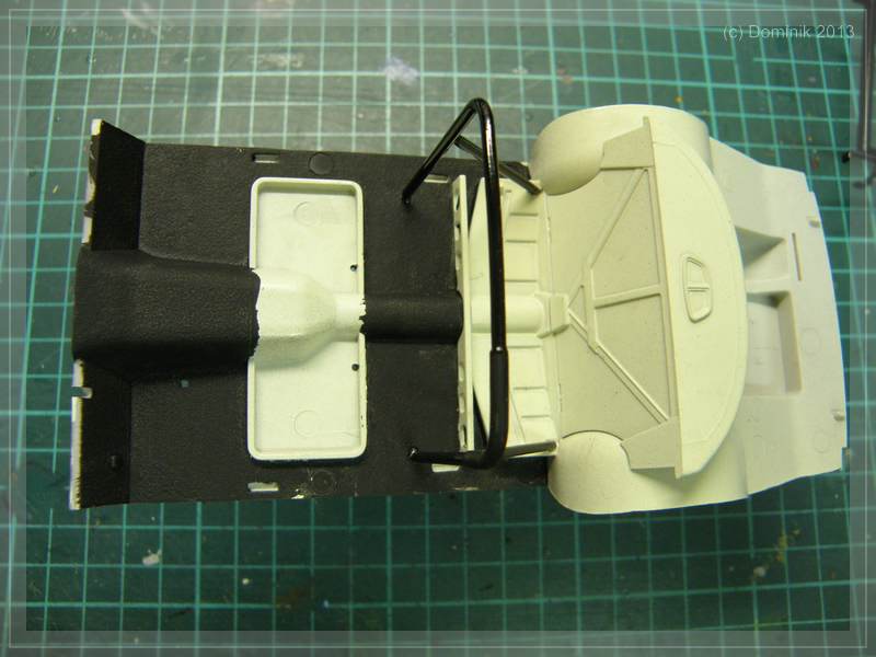

Next steps.

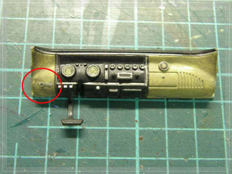

The dashborad isn't ready.
you can see the hole where before hand brake lever was:
i replaced it with a pulled hand brake lever made of plastic sheet:
Last thing, i completed the interior:
For comparison again, the new one: (on the right :D )

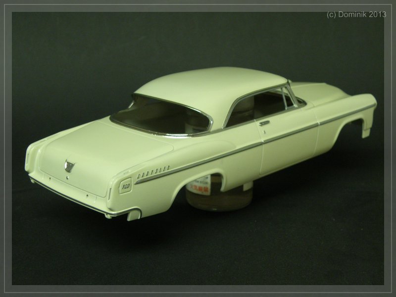

in the meantime, i primed the body as you can see obove.

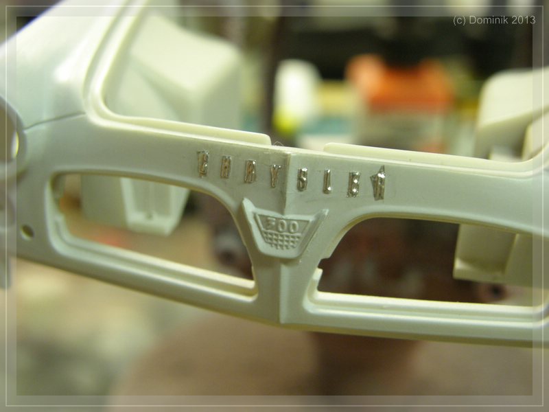

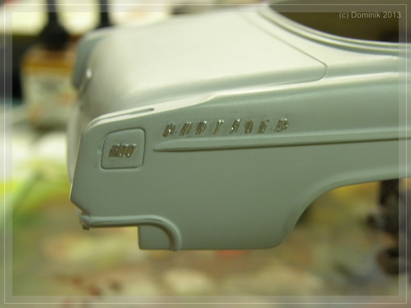

I sanded it wet and made BMF on the letterings on the sides...
...and the front:

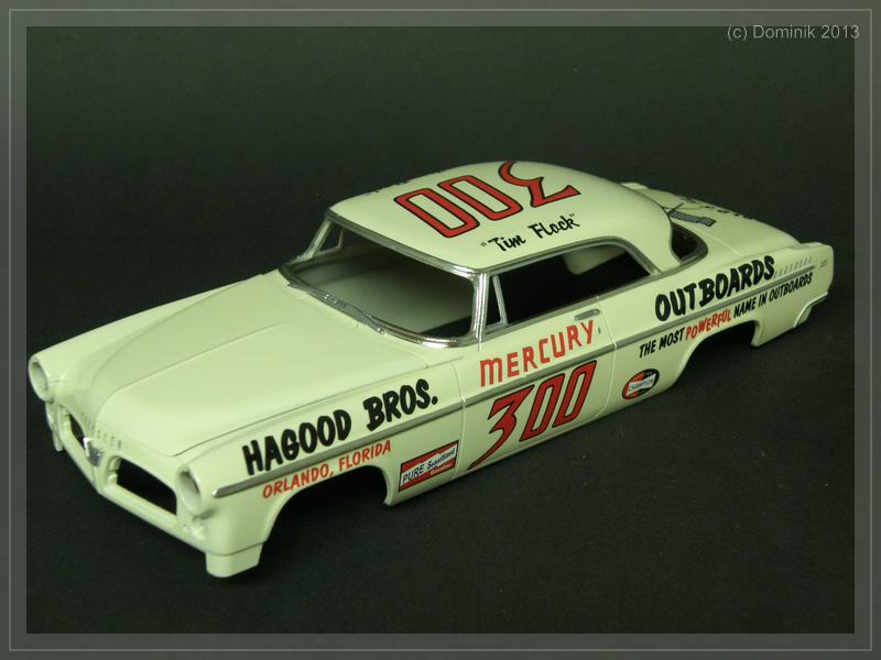

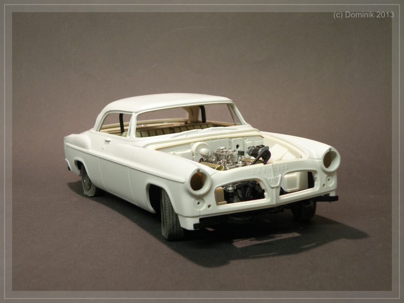

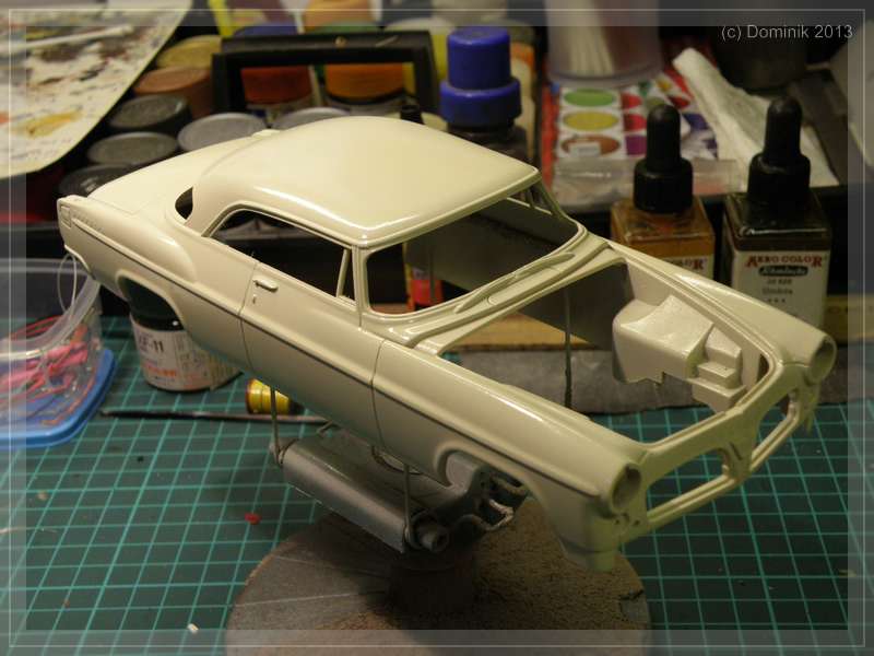

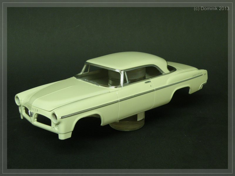

After cleaning the body with silicone remover, i painted it with light ivory out of a spray can:
Time for the body to dry a couple days.
thats it for today, next will be some details on the engine.

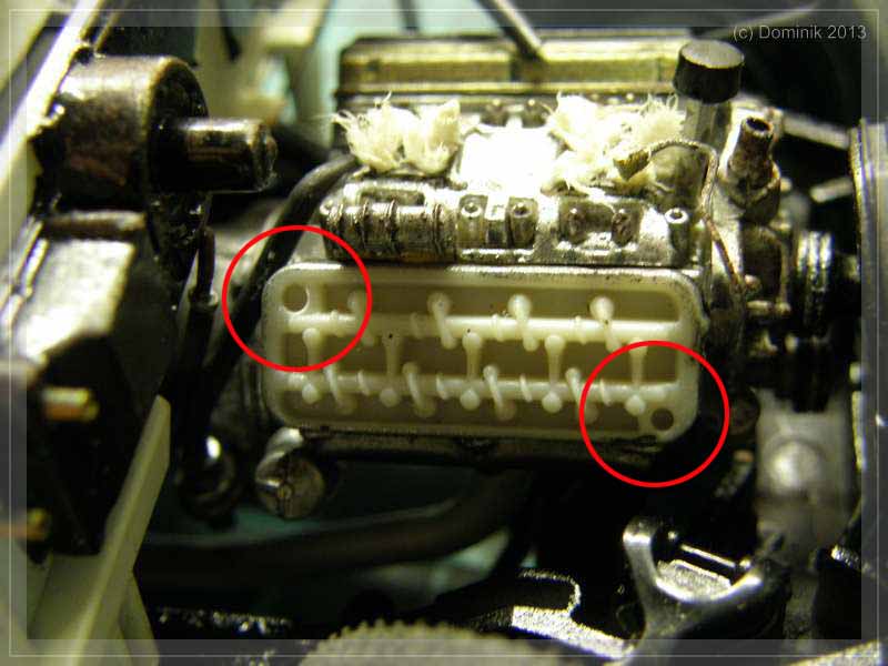

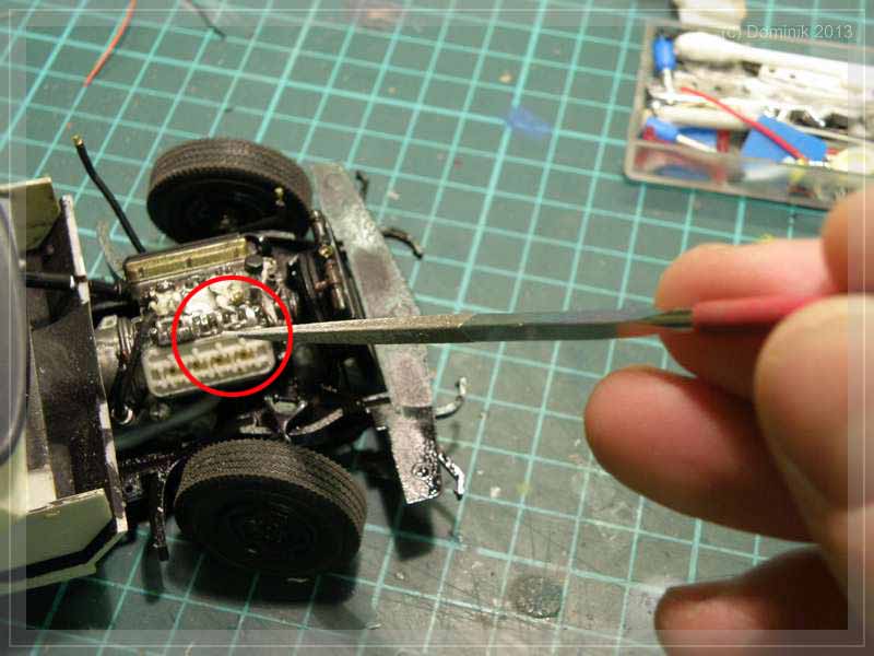

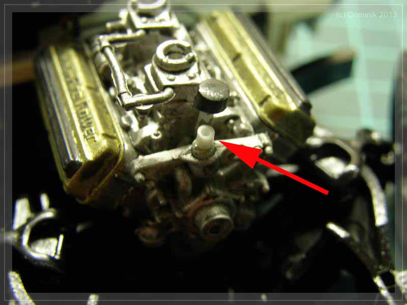

While the body is drying, i made some details on the enginebay.
My goal is, to show a despoiled engine - because the details from Moebius itself are amazing.
in short form:
flange for water hose on the engine...
...on the cooler:
gland from the brake reservoir lid:

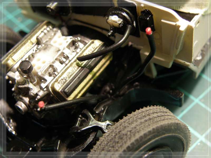

hosepipes from the powersteering and vacuumbooster:
fuelline from the fuelpump:
brake line from the brake master cylinder:

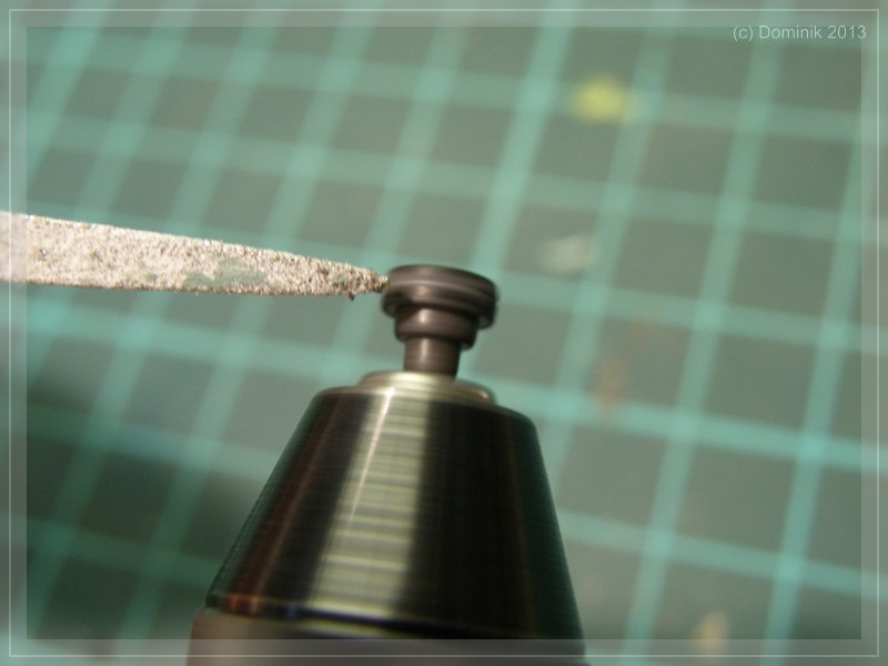

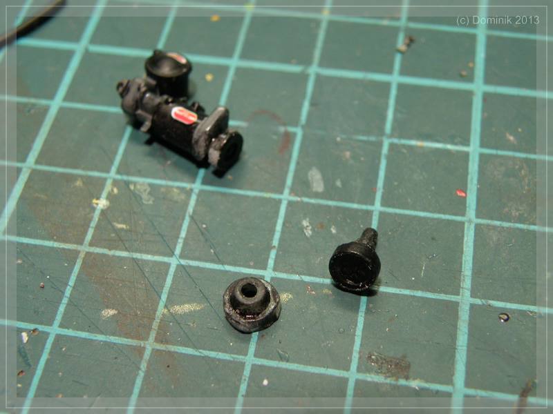

next step, i cutted the belts - (the steeringpump/alternator was mounted off) and removed the rest of the belts on the pulleys...
...to have "real pulleys, i clamped it in my Dremel tool and made a slot:
After attach on the engine - nobody sees it, but i know its there...
...more coming up...stay tuned.

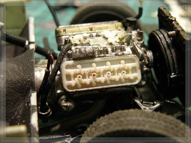

Posted 22 August 2013 - 06:19 AM
...more progress.

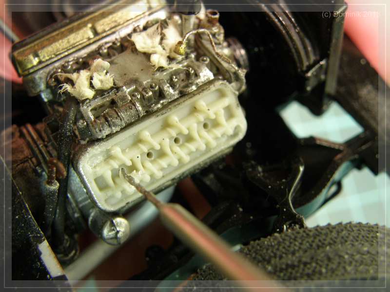

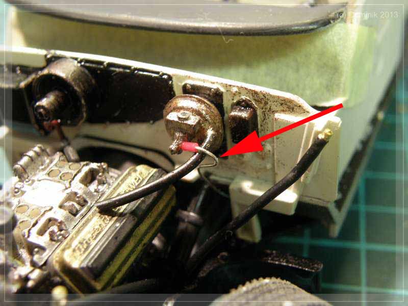

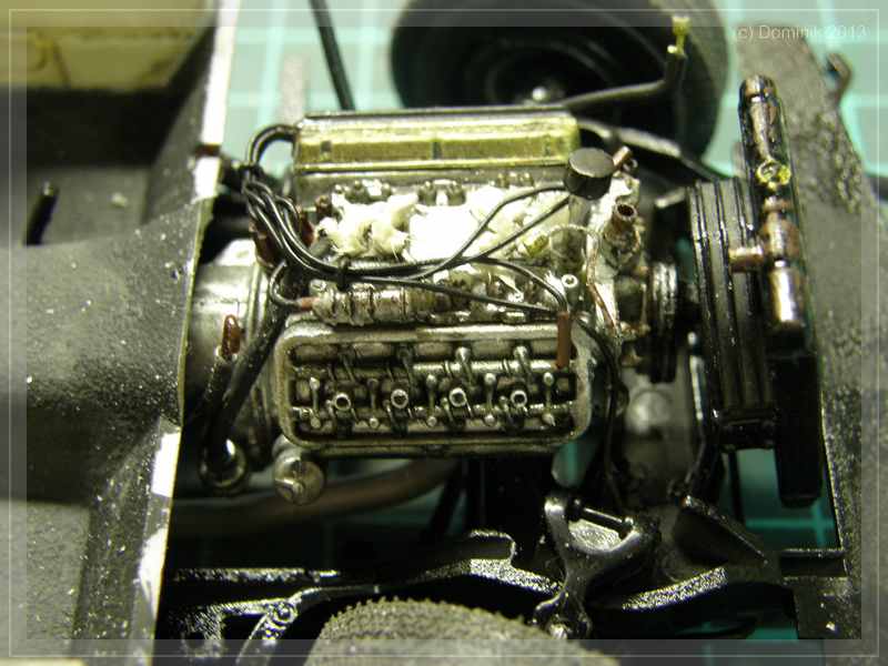

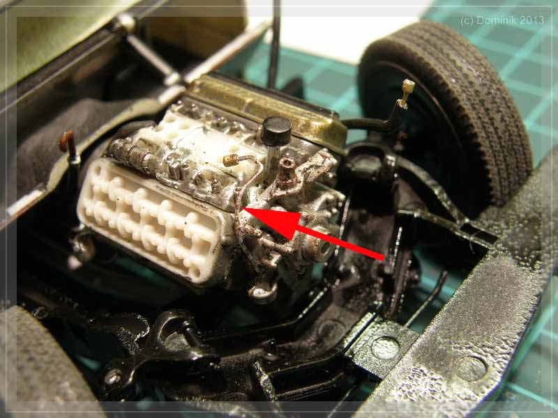

i removed the right valve cover and cutted the fittingholes out:

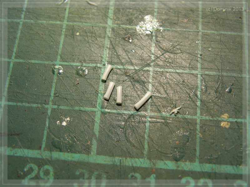

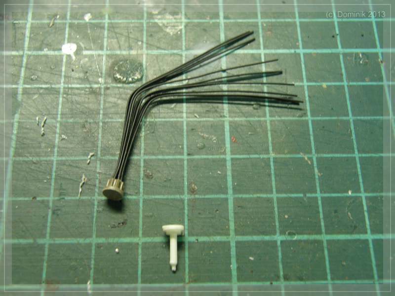

because the hemi has the sparkplugs between the valves and camshaft, i drilled holes on place...
...and made some really small tubes.
I used ear chopsticks (?), i have over a flame and pulled.
To fit it in place, i took my inexpensive....
...and put them in the holes:
for wiring, i used on this engine a aftermarked distributor...
...made the plug caps and glued them:
sure, i painted all at the end.

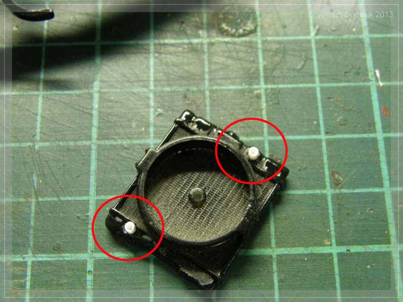

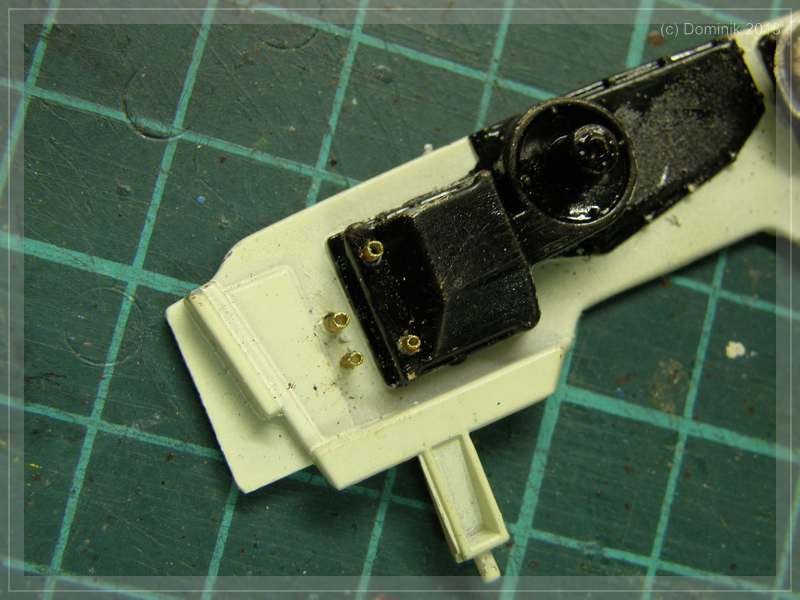

Last update for today, i made the connections for aircondition and heater on the firewall:
Why aircondition? the reference car i used, has those hoses and i first made the holes only for heater on wrong places - think so.

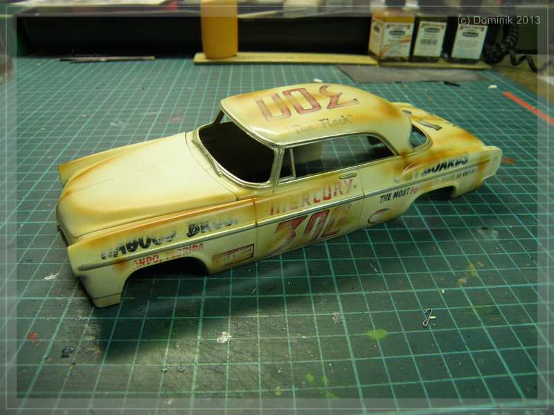

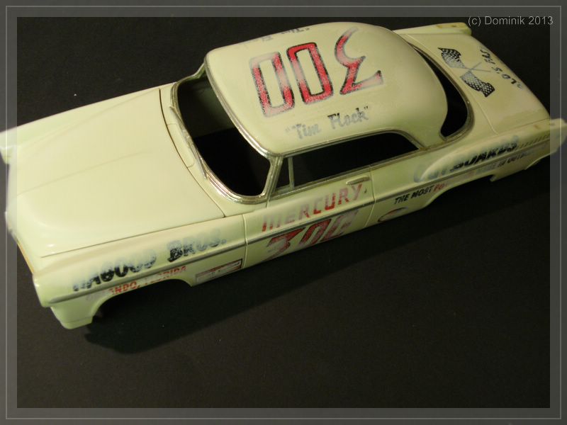

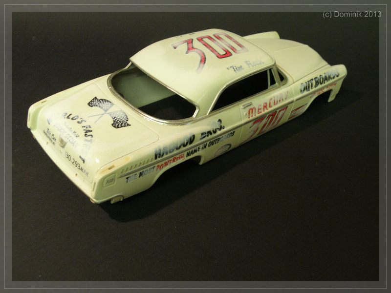

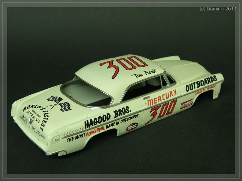

More progress. Time is running, i'm very slow with the updates....

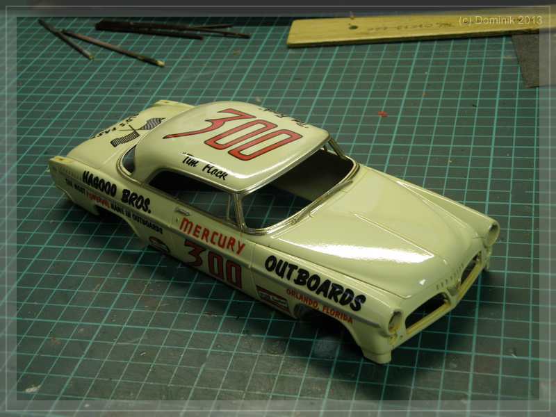

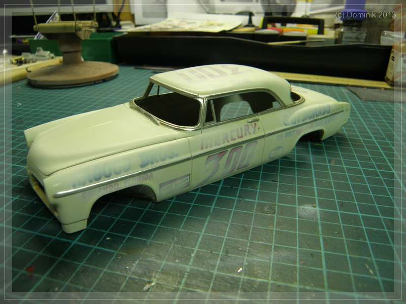

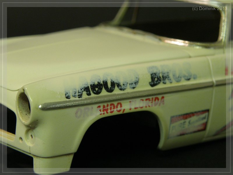

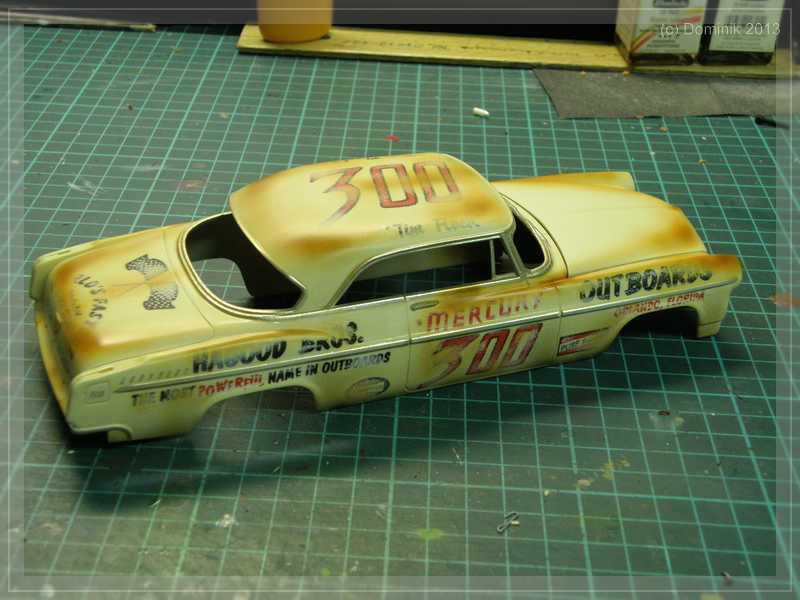

Couple weeks after painting ivory, it is time to do the BMF on it. Felt after hundreds hours, it was done and painted with clear coat:
Looking good so far.

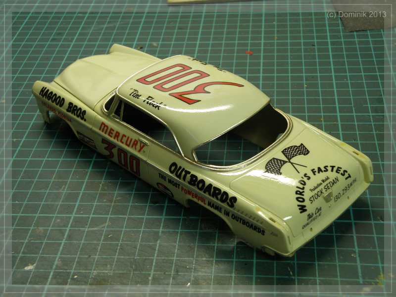

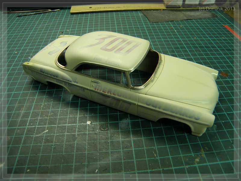

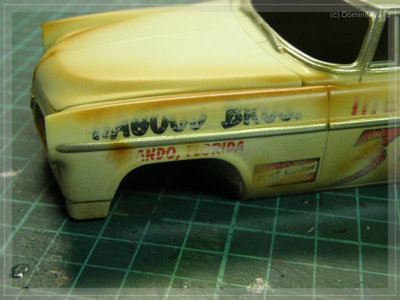

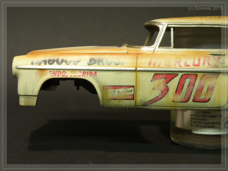

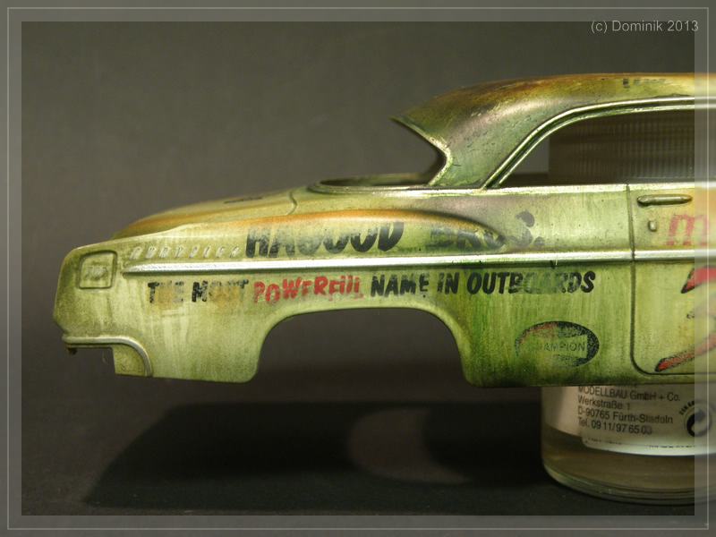

Also after a weeks the paint was certainly dry, i fit the decals on...they are really good to work with! Only the first decal i needed to get the feeling, how to work with it, is broken and fixed again...
...and now - at this point - my girlfriend said, it is too sad, to make it old and weathered. She's right, but there is no turning back.
Lets do the weathering.
In the thread "about weathering decals" you can read my mistake, now a short version of events.
I used colors from Schmincke. There is white, umbra and sienna:

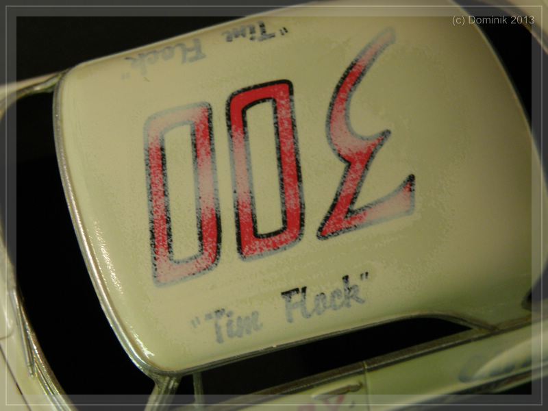

First try, i forgot a thick layer of white and painted as always some bleeched parts with whit, then sienna and some highlights with umbra.
The result:
 a closeup
The fault: i used not enough white.

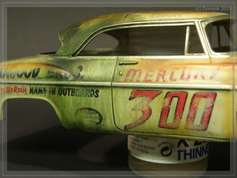

In my view, the decals doesn't look as old as the rest of the paint. The decals are too dominant.

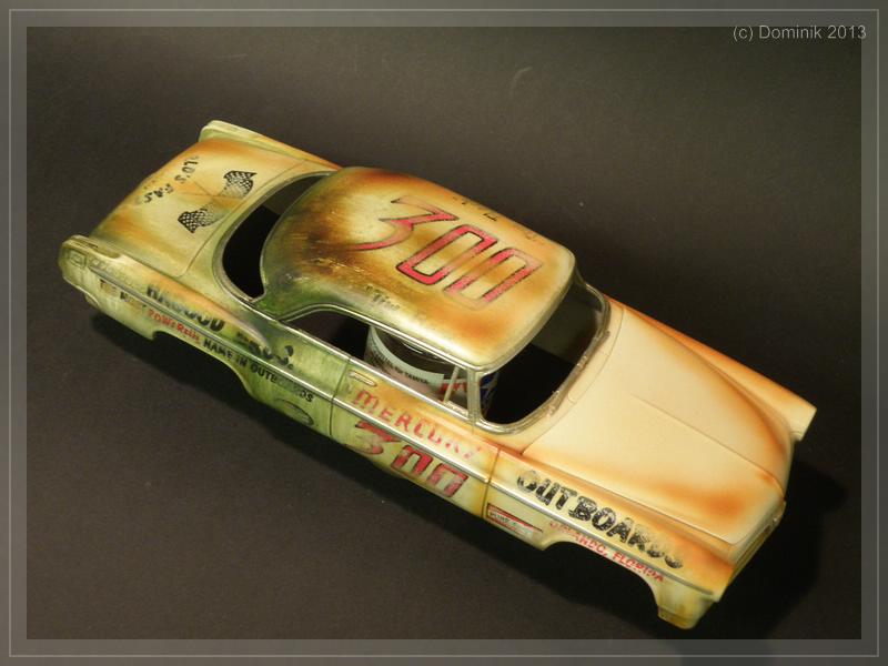

what to do?

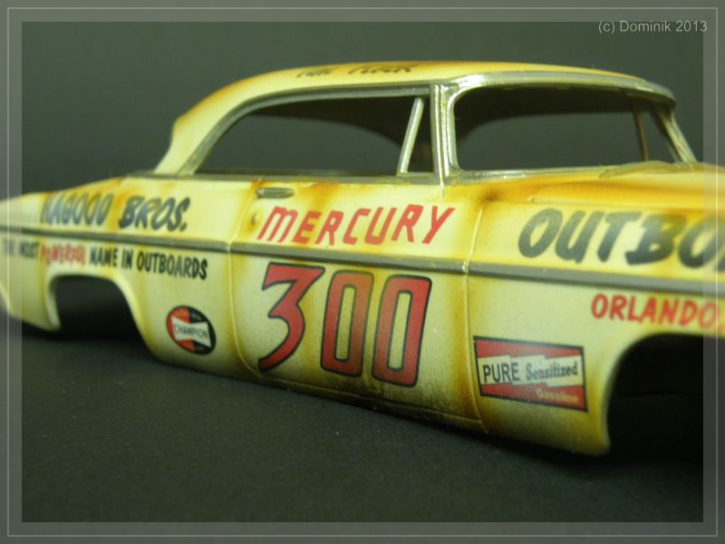

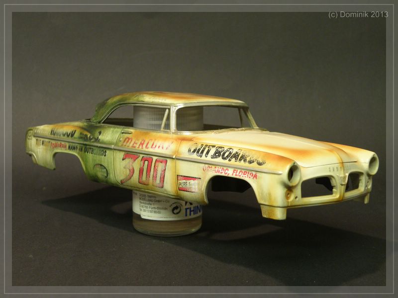

I sanded all the "weathering" wet and made new layers of clear coat:
In my view it is important, to seal step by step with clear coat. So i had the chance, to do it again without ruin the decals, bmf and what ever.
Now i put the body by side for some weeks to dry and start again.

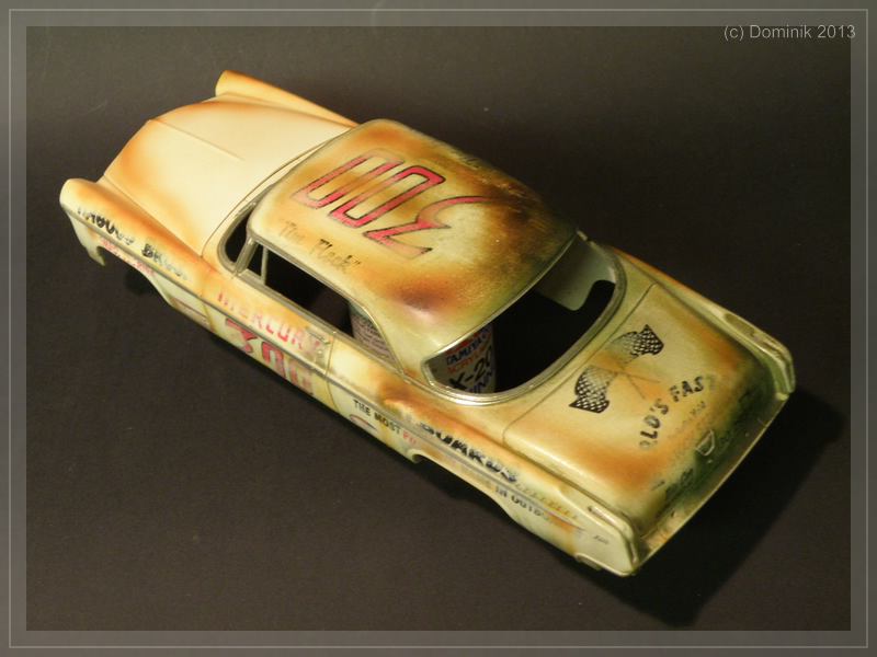

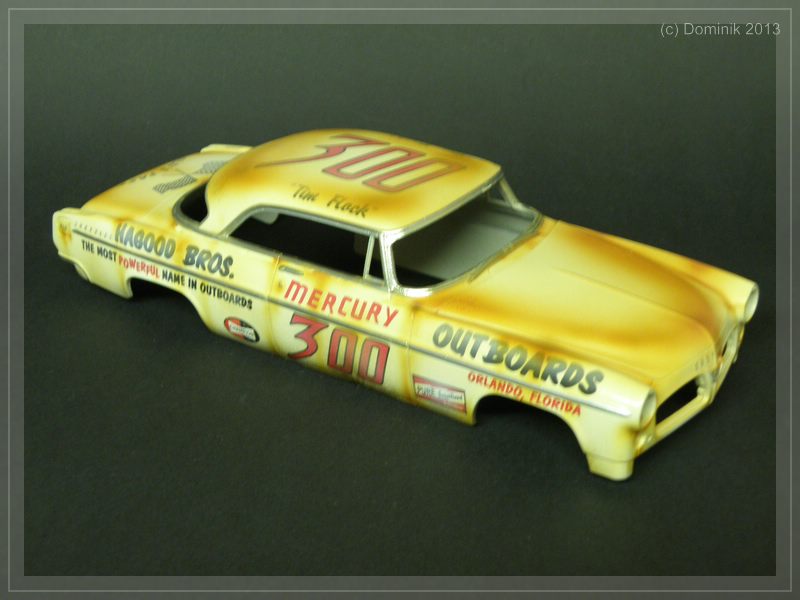

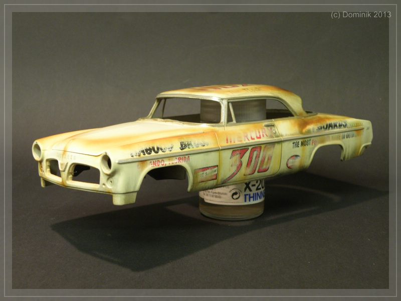

Second (and winning) try.

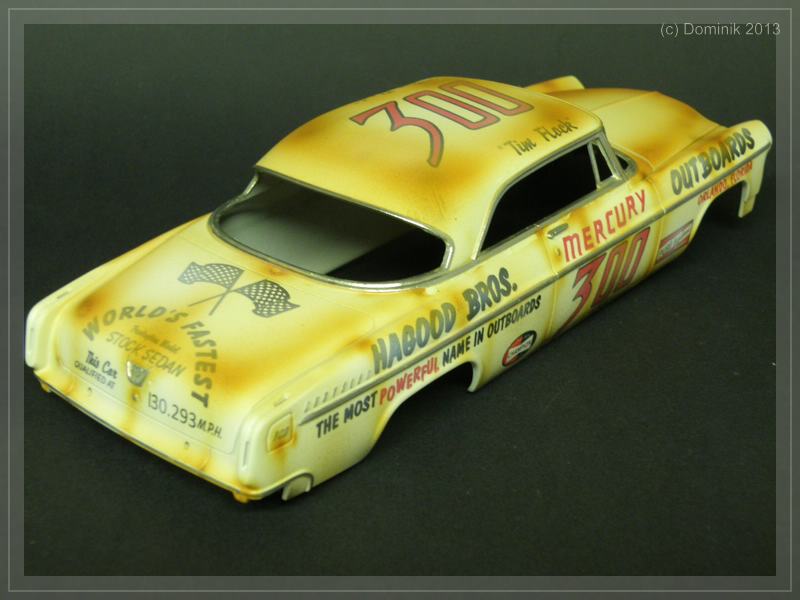

After sanding wet, i bleached the body more then the first try:
Couple weeks ago, i sanded the bleached parts safetly, to "see" i little bit more from the decals. for example the roof...
...and the drivers door:
After that the body get back for drying and waited for my courage, approached me again to venture. i brushed the places similar before i sanded the first try off.

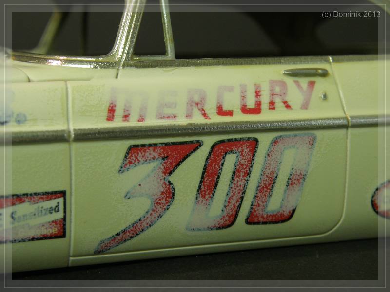

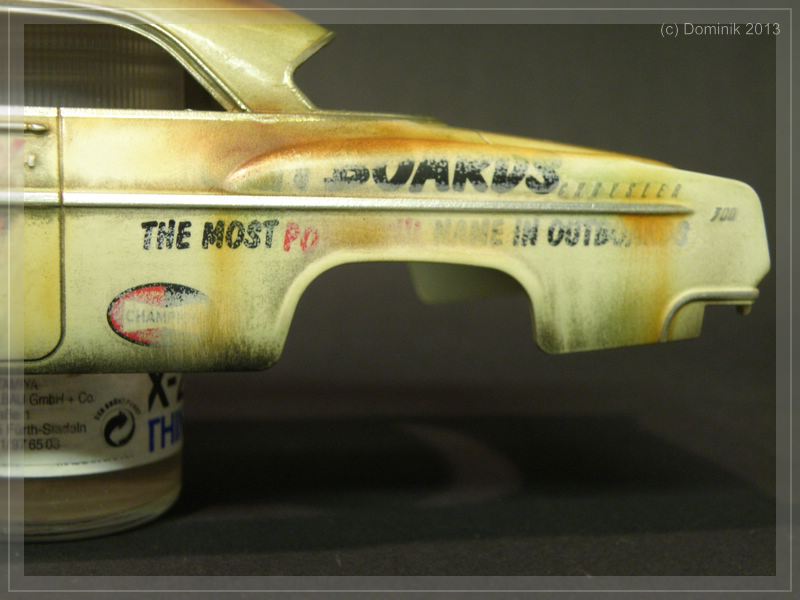

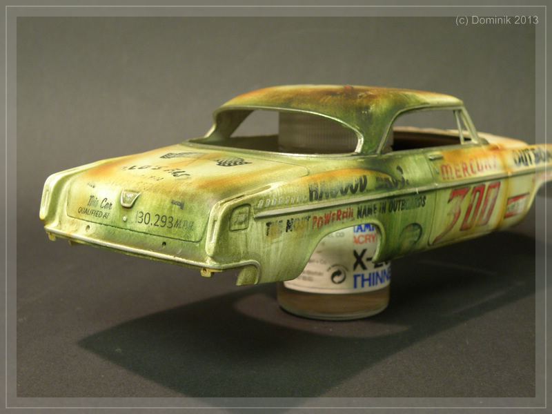

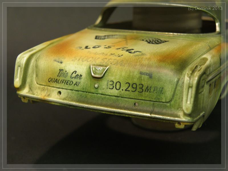

To this point, i was happy with the result. Like before, i painted with Schmincke Sienna and a little bit of umbra.
before...
...after:
the same from the backview - before:
after:
for example a closedup before:
After:
I think, that works better. some more weathering coming up, than its ready to complete.

a closer look:
And now the passengers side. More dirt then left, becaus it will placed with it under a tree:
closer look:
The backend:
At last a overall view to this point:
For the steps of the weathering on the passengers side (my first try!), i try to show you a little bit "step by step" the upcoming windows.
Thanks for attention ;)
