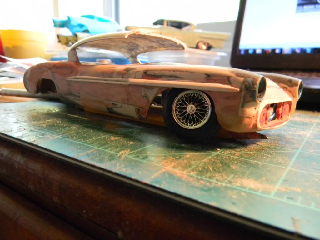

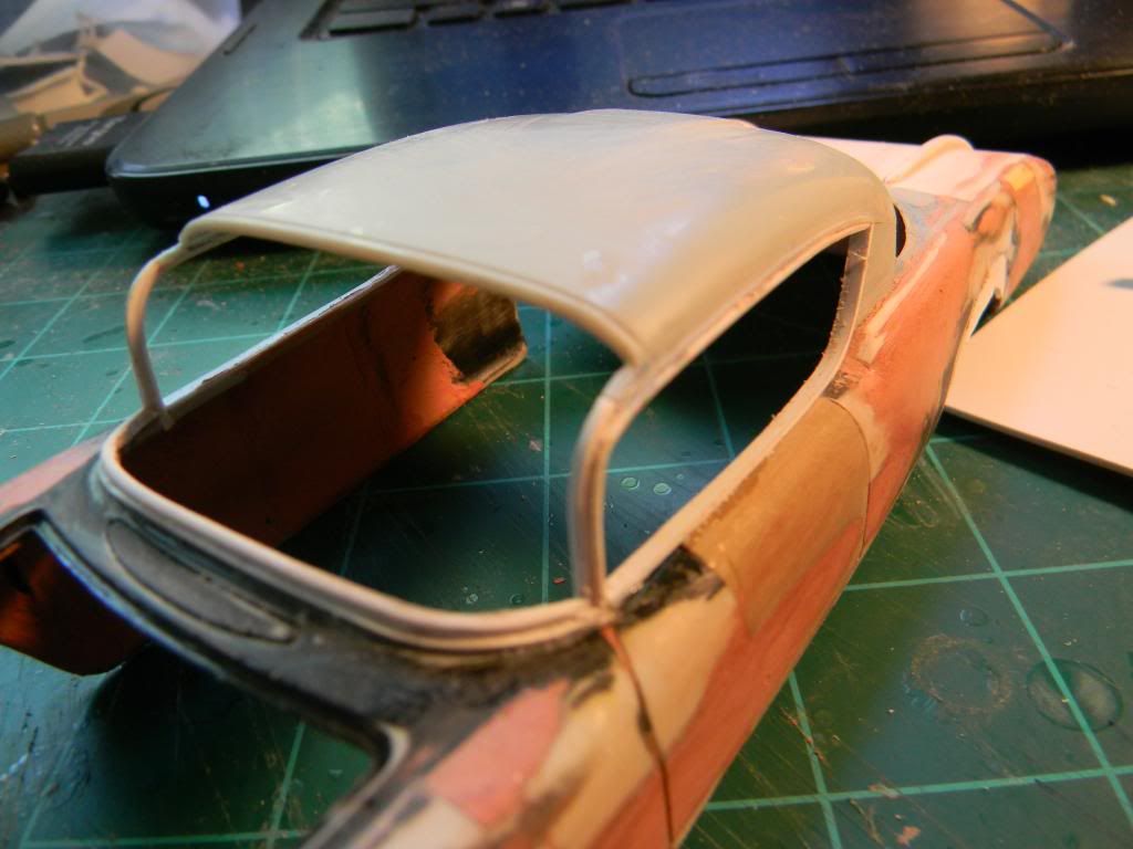

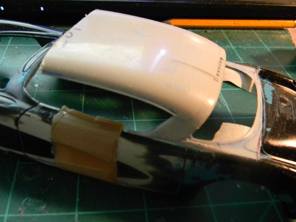

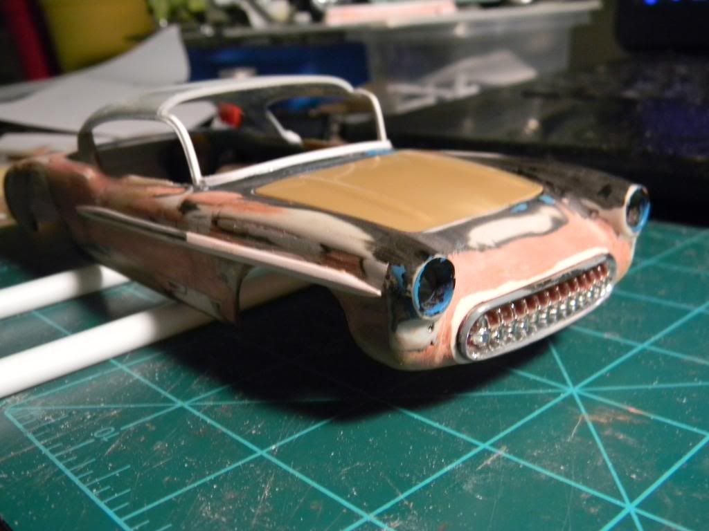

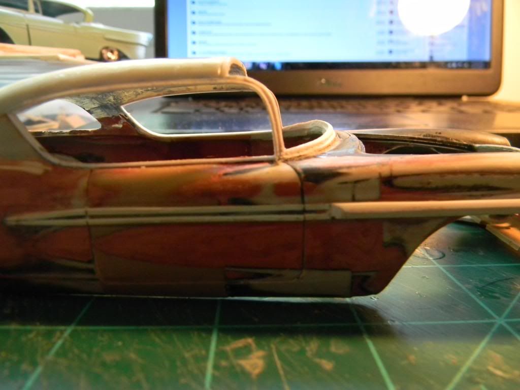

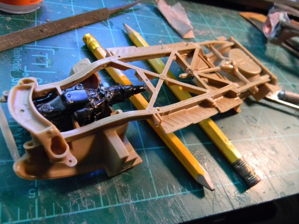

#40 kennb
kennb
  • 1,131 posts
  • Location:Minnesota
  • Full Name:Kenneth Borst
Posted 06 September 2013 - 07:57 AM

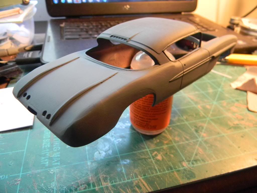

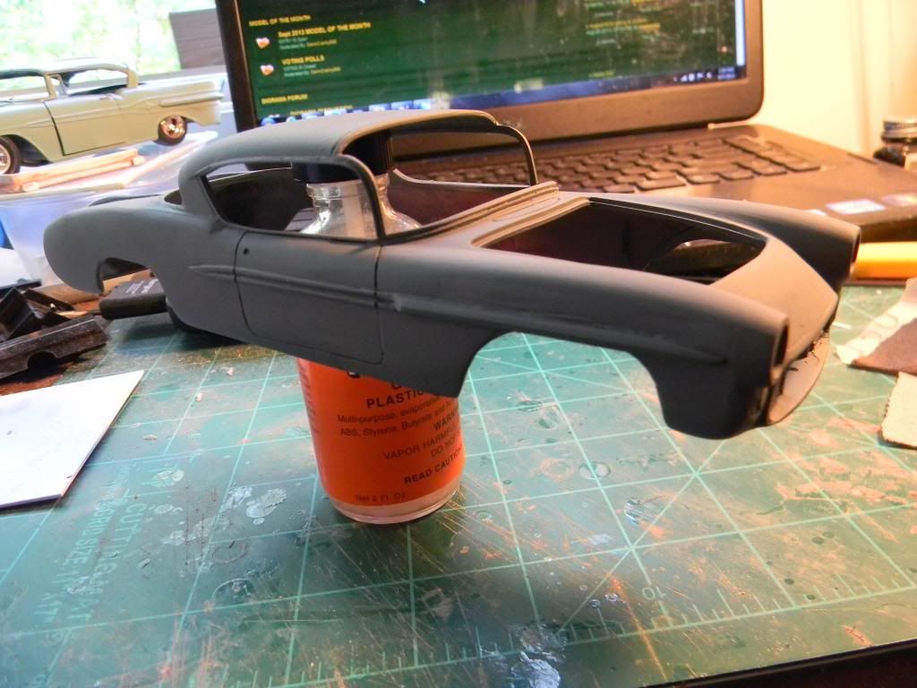

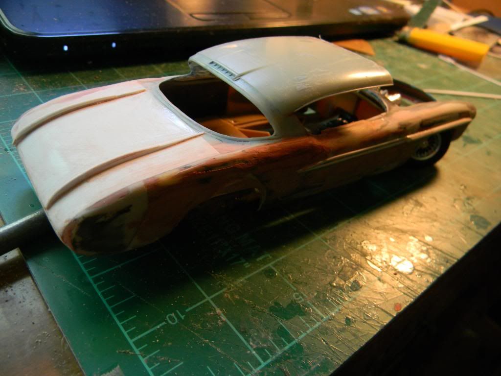

front wheel wells were moved back 1/4 inch and the the space directly behind the wheel wells were cut out and swapped side to side to get the curve correct. the rear clip was cut out as shown and moved back 3/8 inch to bring the overall body length to 202 inches. the yellow panel is from a 53 vette to have the top line of the fenders correct to top was cut out of the 58 chevy donor and is cut into the corvette body. I added a 1/24th 53 corvette grill. It has more meat to it and closer to what is needed.. There are parts to 5 different vettes on this so far,,,,,,,,,,,,,,,,,last post for today...enjoy it is getting closer. Not all vettes are created equal...even in the same scale they do not match up to each other...there are little differences between manufacturers so there is a little fudging to do or filing to get parts to fit.
I have the frame started...I had to add 1 " to the length. I started to do the front steering and found I don't have all the parts,,,,I am missing spindles. Might rob them out of a new 58 corvette kit. The body is taking shape along with the side spears. lot of sanding and filling and sanding little low spots or pin holes....I may have a coat of primer on this week end. Then I have to finish the chassis and the interior...
